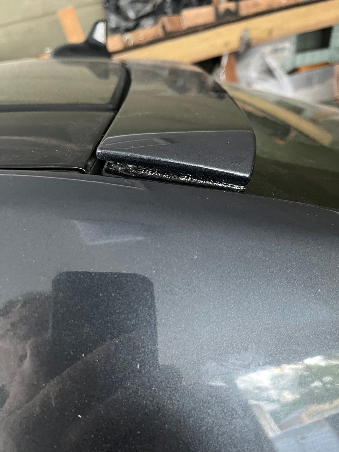

I have the same problem with factory installed spoilers both on trunk lid and rear window. Ends are loose and I have taped them with the best 3M tape I can find several times. The first time I had the dealer do the trunk lid spoiler as it came loose during the CPO extended warranty, but it did not take long it was loose again. Then tried myself, no luck.
The problem here is that taking these parts loose is a big job and then re-installing takes at least two people and it has to go in correct location for the first touch. No easy job. And then it is loose again...

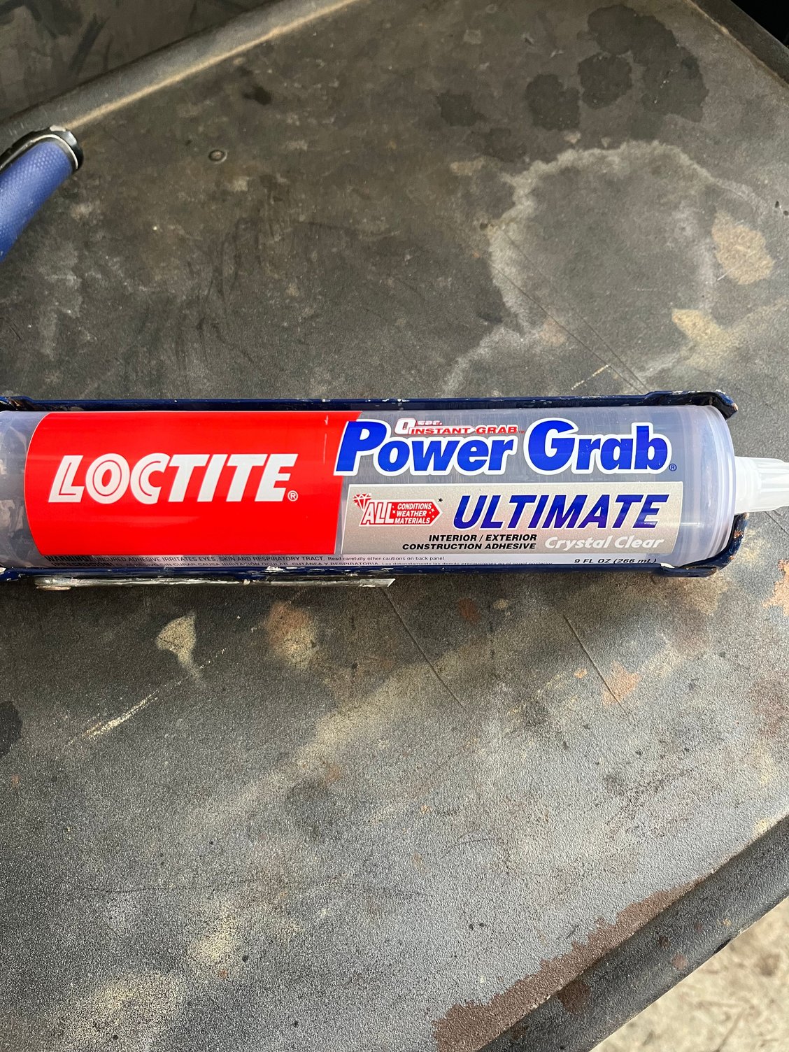

So, I had this 2013 S550 with a very nice trunk lid spoiler. I don't think it was from factory, but perhaps could have been...? It had developed the problem already before I took the ownership of it and as I had bad experience even with the dealer trying to glue the spoiler back on in my 2010 E550 I tried something else: I went to Lowes hardware store and bought Heavy Duty Liquid Nails (or something similar it was). Some very strong building adhesive.
This is applied with the gun and the tip can be cut to very narrow point. I pried the spoiler out just for a small crack and applied this glue in. It made very strong bond and for the about a year after this fix I still had the car (before a young lady decided that it is better to put her car in the front right corner of mine and total both) it stayed like it was part of the trunk lid.
They make several colors of these adhesives, but it probably is not easy to find yours unless your car is black, like mine, but they also make some of this stuff clear that should work for everybody.

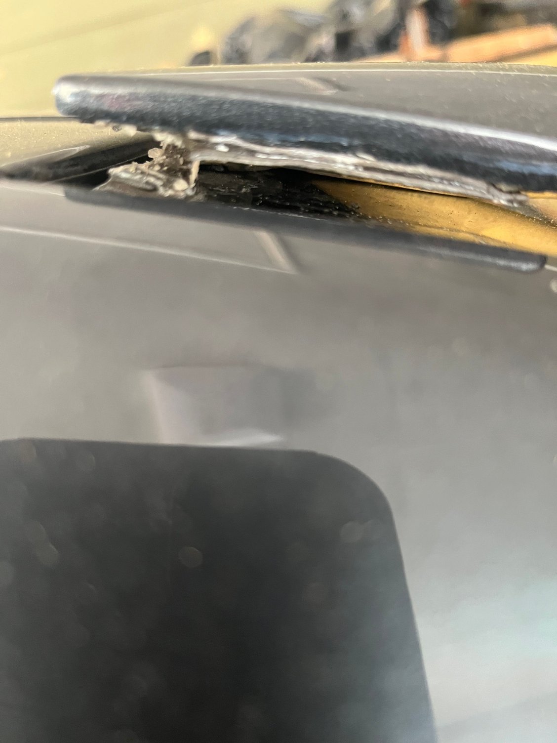

The window spoiler is a bit ugly as I did not remove the multiple tapes I had used trying to keep spoiler ends attached to the car. I just added the clear adhesive and may have to do it again if the tapes layers fail between them, but I don’t think this adhesive will fail. After all failed tape layers are glued it will be all set.

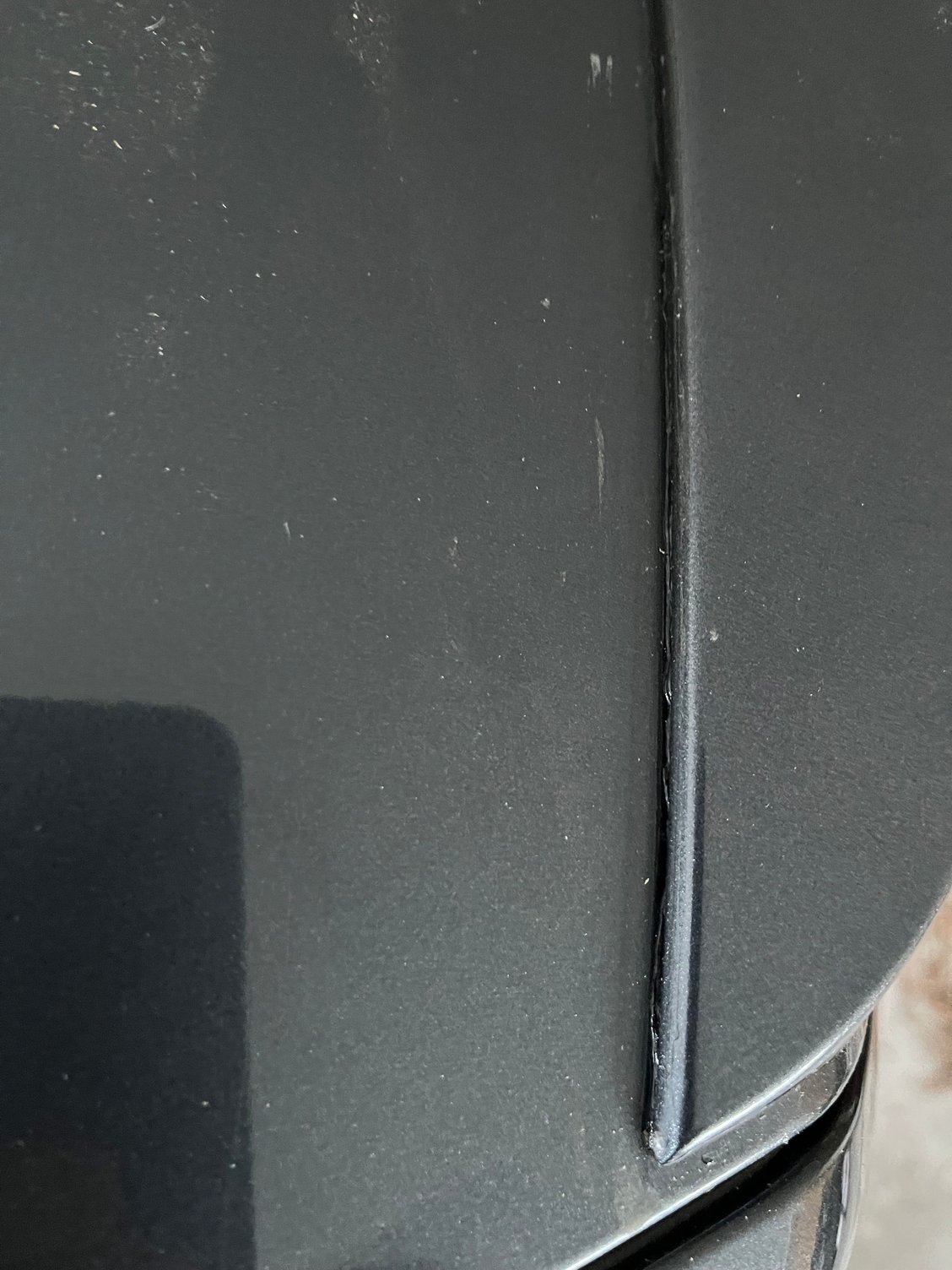

Trunk lid spoiler.
Loose window spoiler with multiple failed tapes.
Window spoiler after using clear Lock Tite glue.
Clear Lock Tite construction adhesive.
