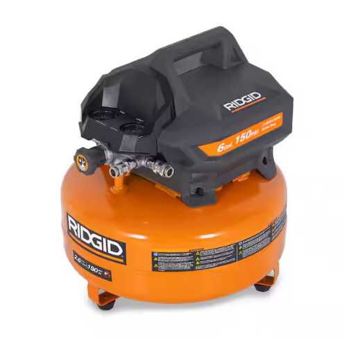

I was also thinking about getting the pneumatic version and I would if I had a compressor running at all times, but I don’t. The hazzle of getting my compressor running and then draining and drying it takes more time than doing ax. 30-40 hand pump movements and so does not warrant for pneumatic model. But this is just my case…
I have a 25 gallon air compressor and this 6 gallon pancake compressor. I use the pancake compressor for oil changes, inflating tires, etc. The 25 gallon compressor is used for bigger jobs, such as paint spraying. I've pretty much have replaced my air tools with battery tools.
Using the pancake compressor is a simple as twisting the drain valve 90°. I agree, the bigger compressor is more of a pain to use.
I have the exact same pancake as you show in the picture. Setting it up for me means digging it out from storeroom and then starting up and connecting the hose reel. It needs to run a couple minutes to get fully charged.
After use I need to let it run like 3 min with the valve open for drying the tank of water that condenses in it and then put it back in storeroom. This is about 10 min of time, and I can do manual pumping in way less than that so I don't see the benefit of the pneumatic MityVac.
But hey, all for ourselves. And the pumping this thing gives a little exercise that I get very little...

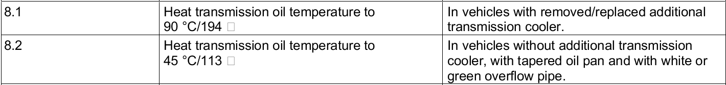

I have read some discussion about the ATF changes and how it needs to be cool. I think it needs to be like 80C that is the operating temperature. Someone correct me if I'm wrong, but it has been working fine since the change was done.
OK, you're wrong. The attached may help.

80°C is way too hot unless you have an additional transmission cooler. It should be 45°C.

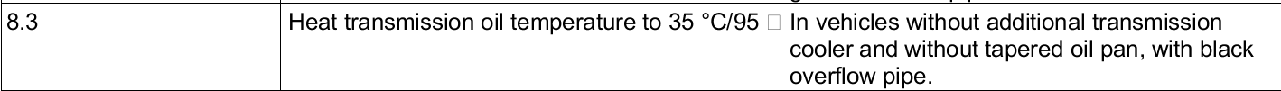

And, actually you should heat to only 35°C if you have the black overflow pipe.
