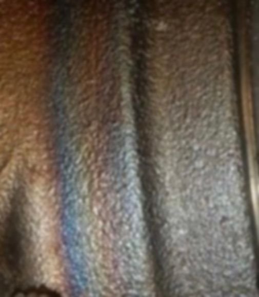

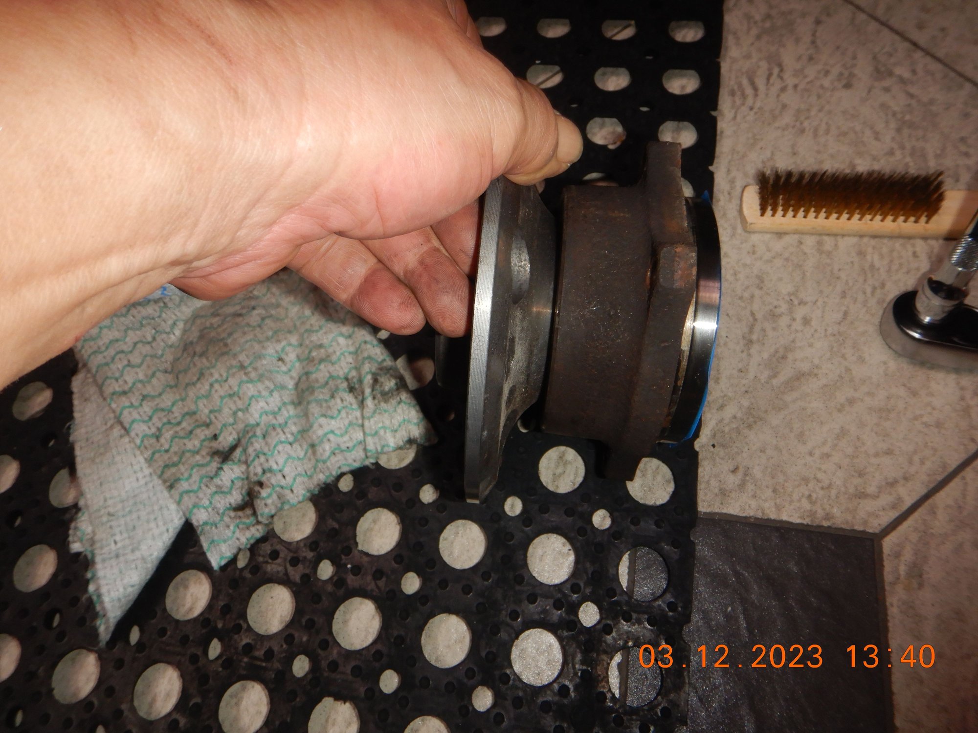

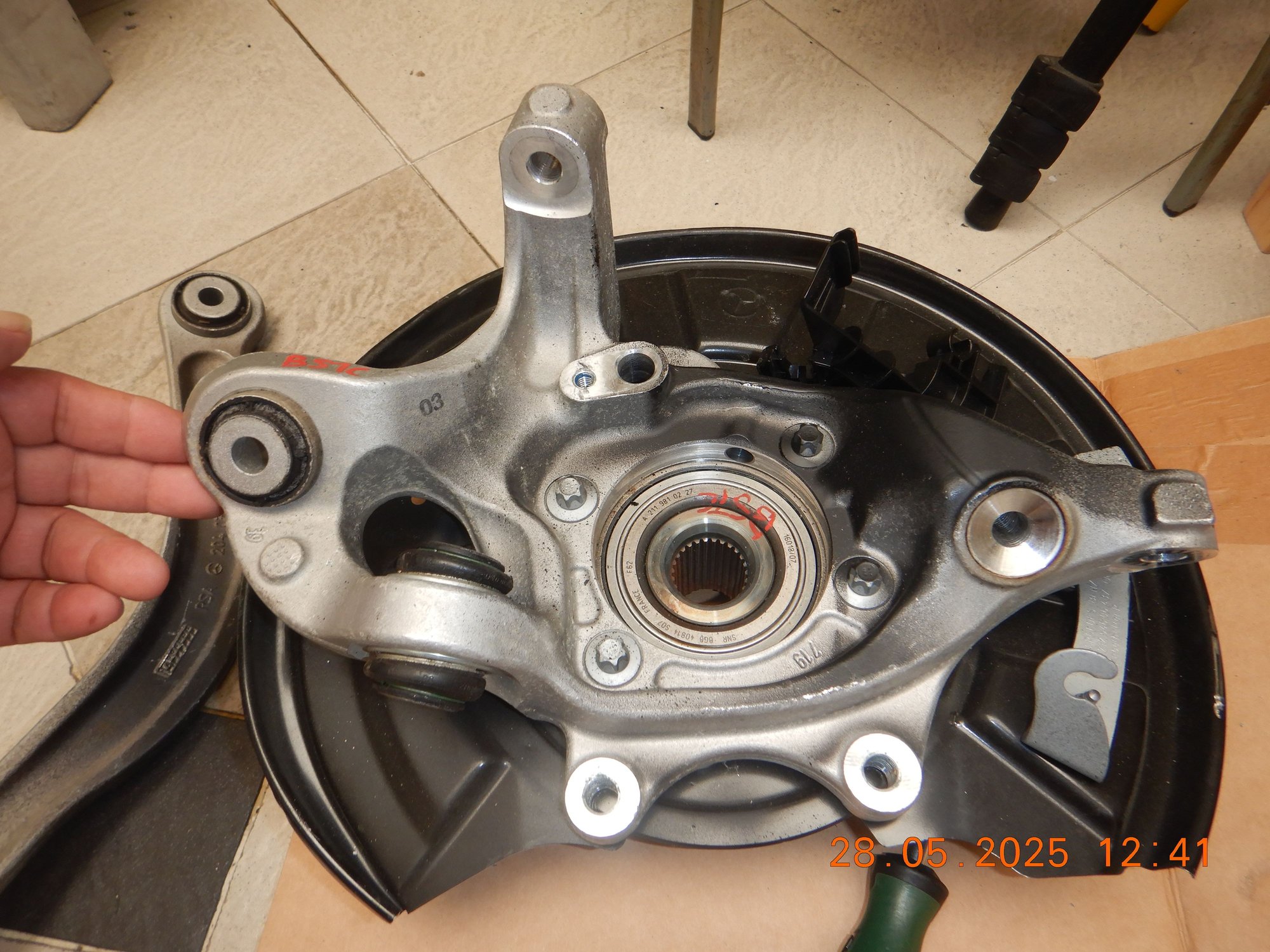

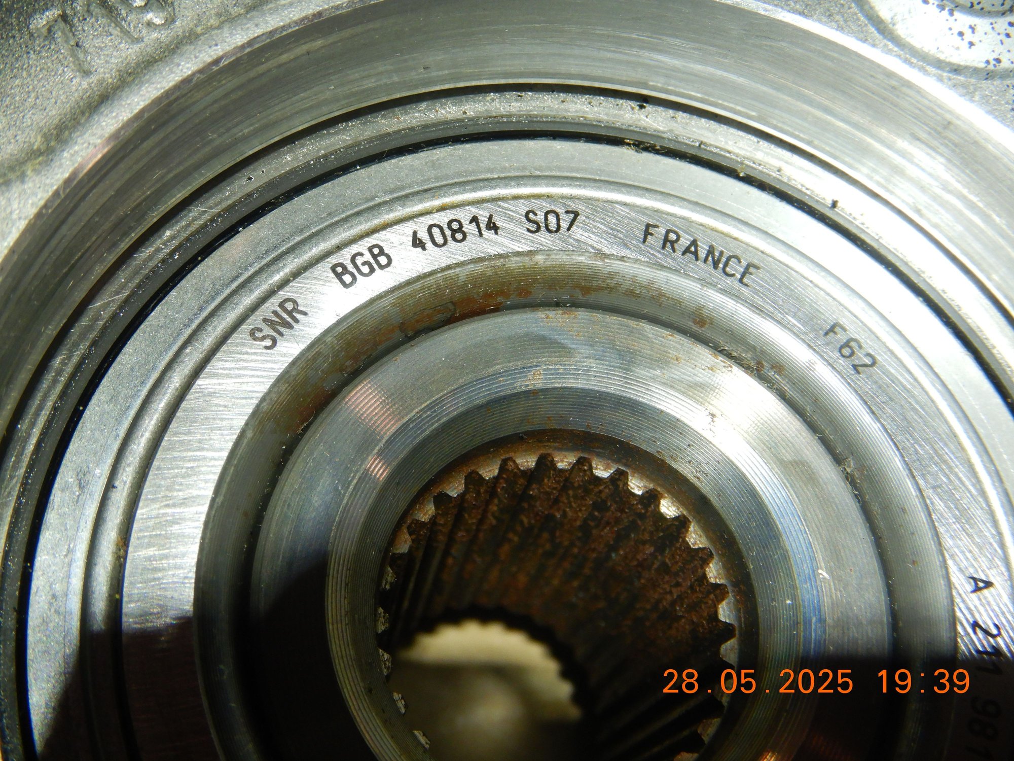

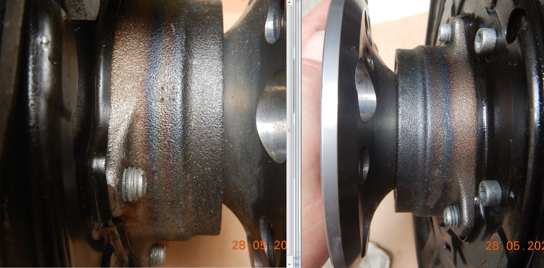

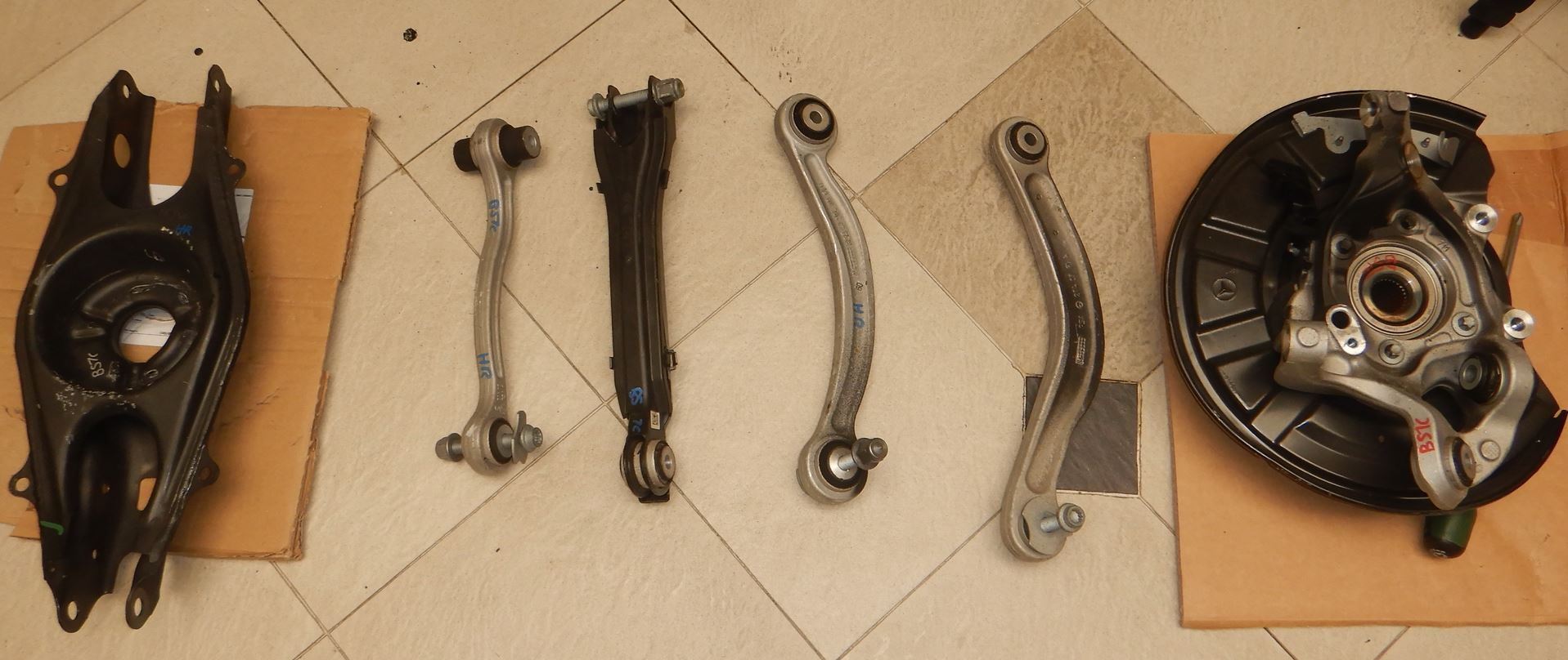

Hi Gang,
I bought for fun & experiment, a complete set of all these from Germany, used. Supposedly from a very very low mileage car, which I believe because the parts look so good. RIGHT REAR

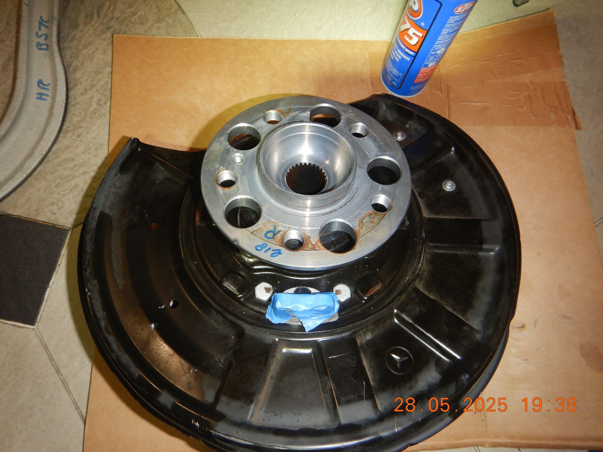

The color of the bearing is what I want to ask. Is this normal casting color ?

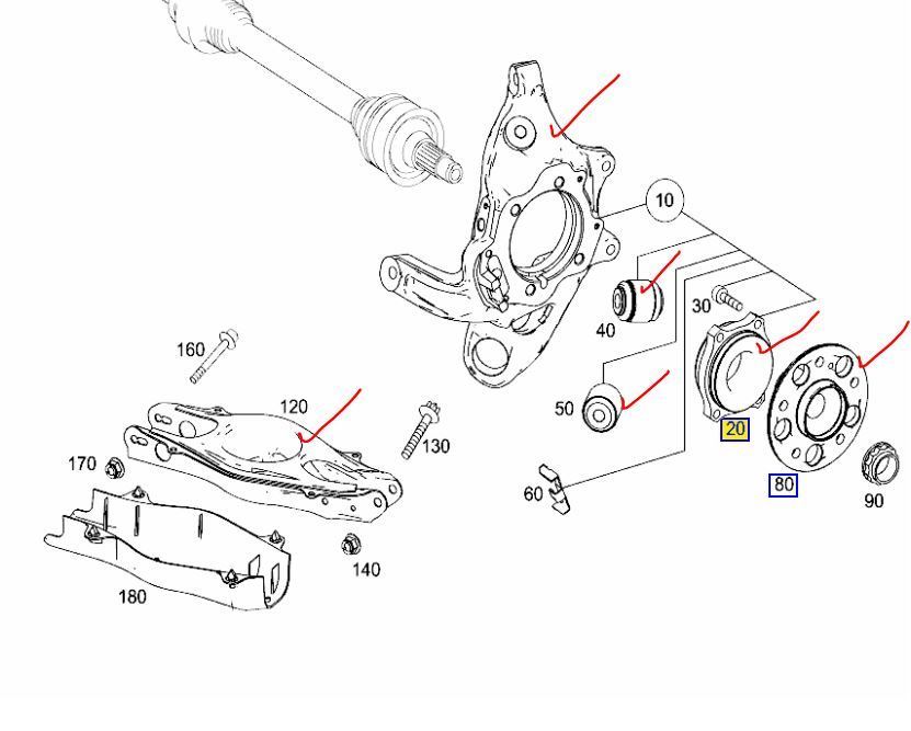

Bearing #20 in EPC is super smooth and tight, by hand.
The bearing is so nice smooth to spin and firm..........
Above is the color I am asking.
No rust too........

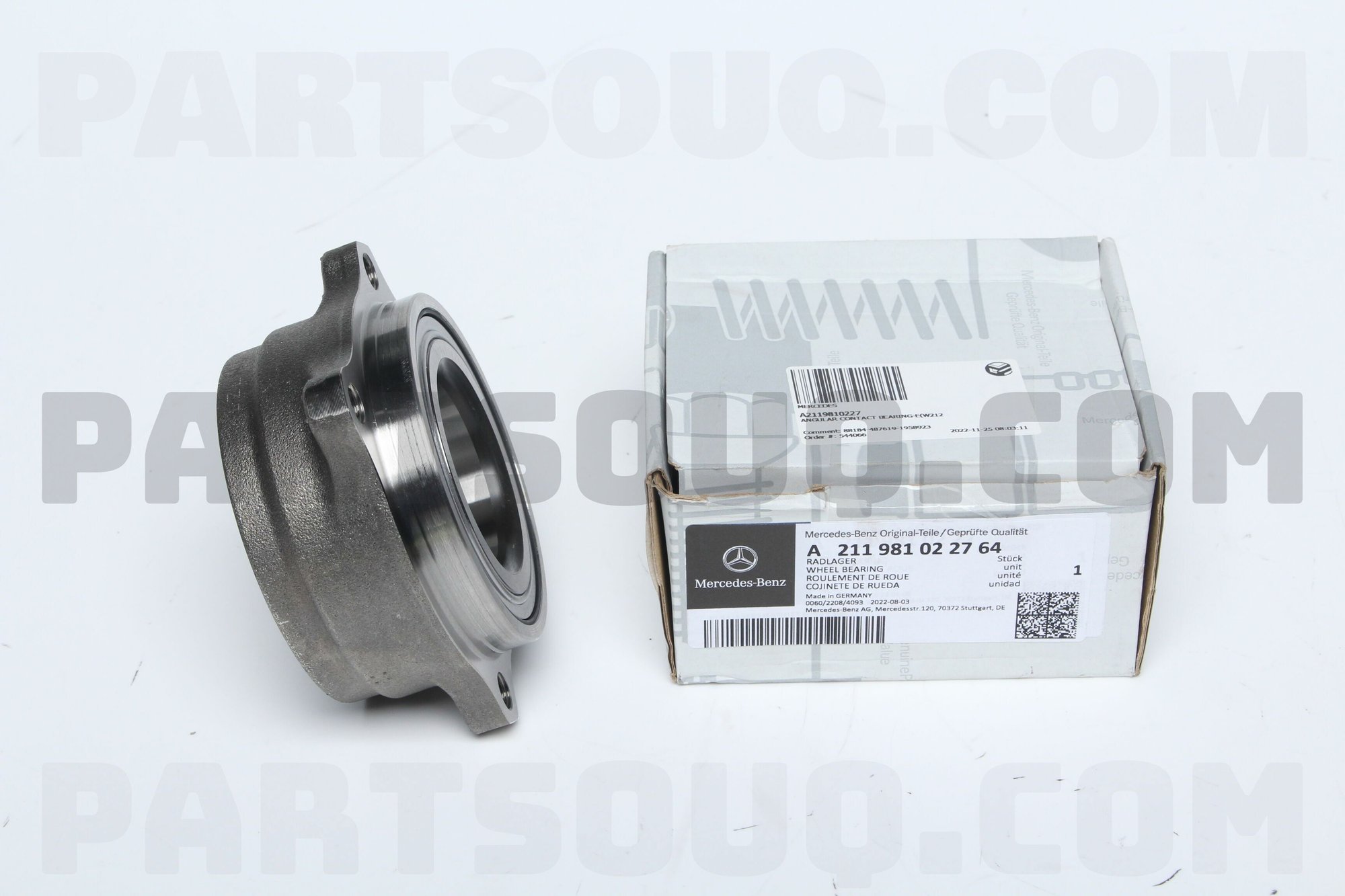

If From Part Soug photo of the same bearing
https://partsouq.com/en/search/all?q...#A2119810227-5
My oldie one on the car surely rusty already and dirty
I use anti-seize to make it not easy to rust.

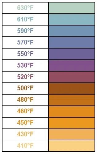

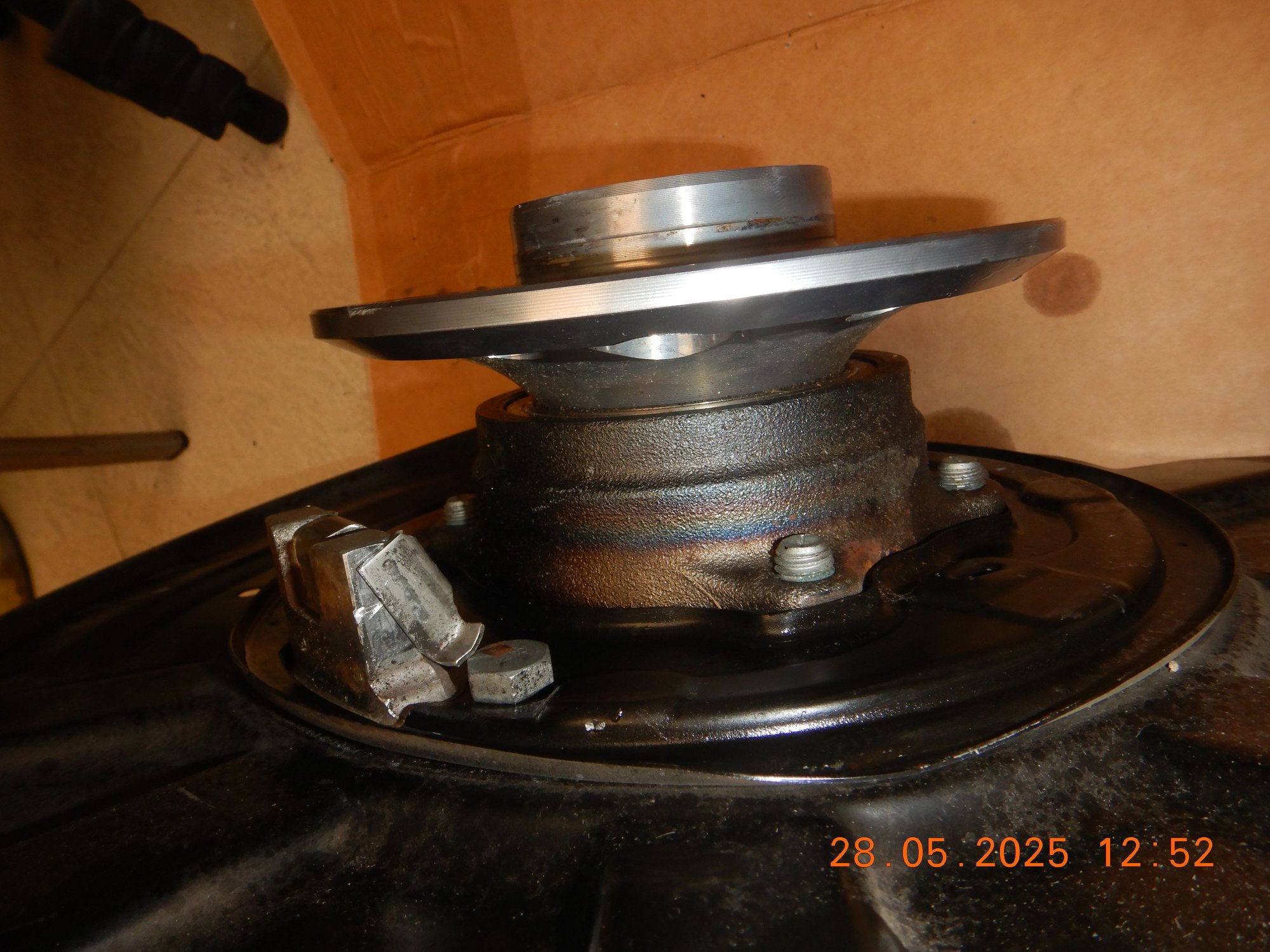

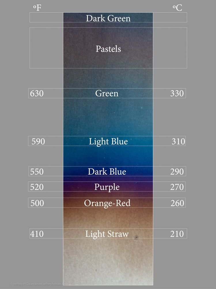

I been reading on color chart of cast parts when being heat treated. Wondering if it was from heat treatment.
https://www.jeffreyhdean.com/heat-co...lting%20colors.
https://www.servicesteel.org/resourc...are%20absorbed.
What do you think is those colors on my used bearing ?
Thanks very much.

I am NOT an expert...but, spent a TON of time some years ago looking at how to "color" metals (mostly titanium or stainless steel) with heat. This was as opposed to anodizing them, and, with luck not damaging the structure of the material at hand (making it weaker). Things have moved forward in the past number of years with vapor deposits and other coatings as opposed to using heat to alter the color of hard metals. As you have read on the Dean website, color can alter the tensile and impact strength of an item (mostly we would play with forged items, not cast as your parts are). To that, a thought I just had is there is no way that our car parts are anything more than a "junk metal" alloy - it is not like they are Metal Matrix Composite or even a higher end alloy (in my world of Titanium it would be 3Al/2.5V or 6/4)....
Now, to your part...well to my non expert eyes that sure looks like heat created coloration. While I would say it could have been from heat treating, my cars do not and have not had that appearance. If I had to make a call, that was at some point a bad bearing that severely over heated.
For reference - this is a Titanium bolt that I colored with my torch. It was FAR cheaper to get a stock bolt and torch it than pay $40.00 for the same bolt from a company called "Better Bolts". https://betterbolts.com/collections/...itle-ascending

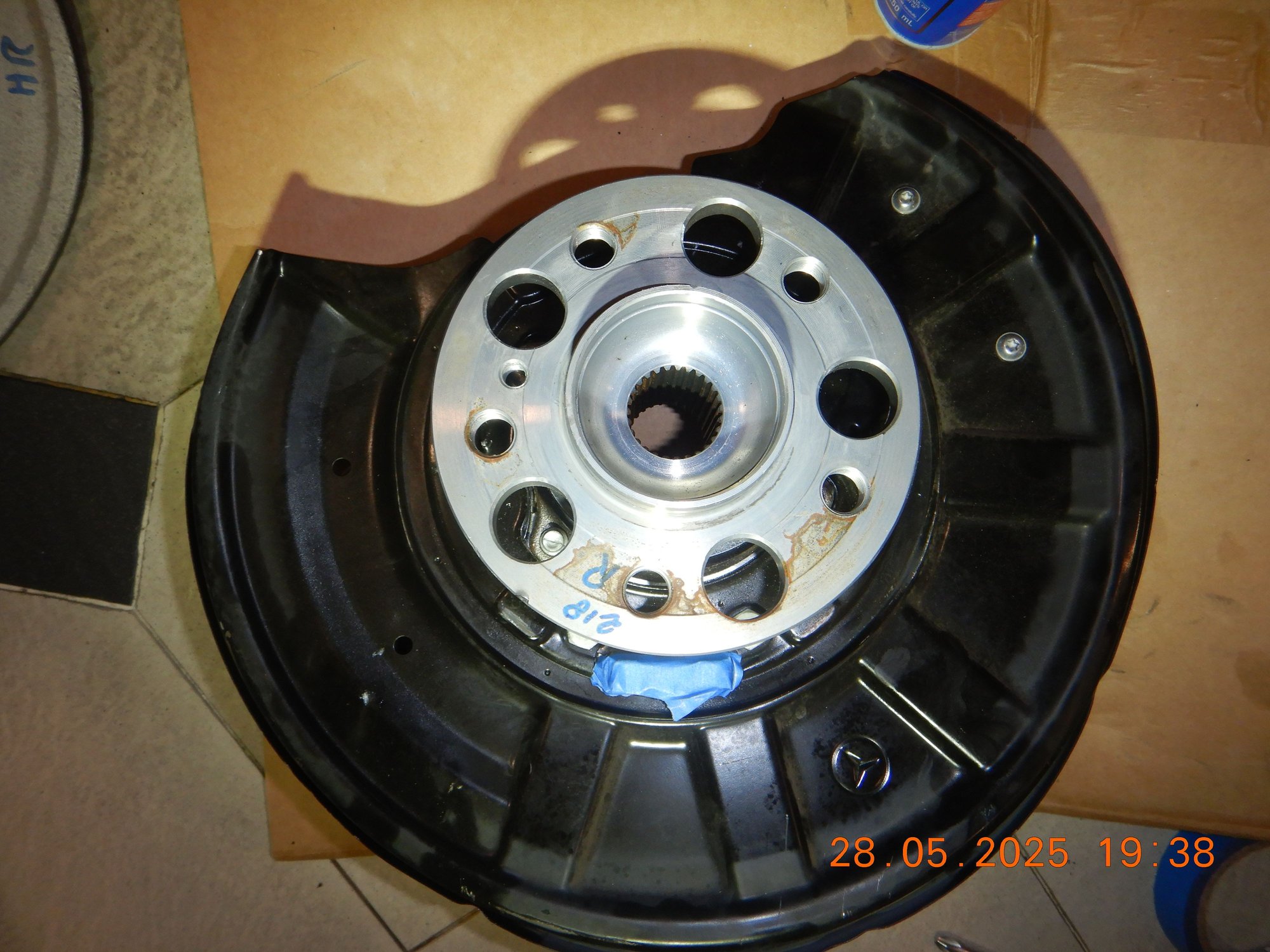

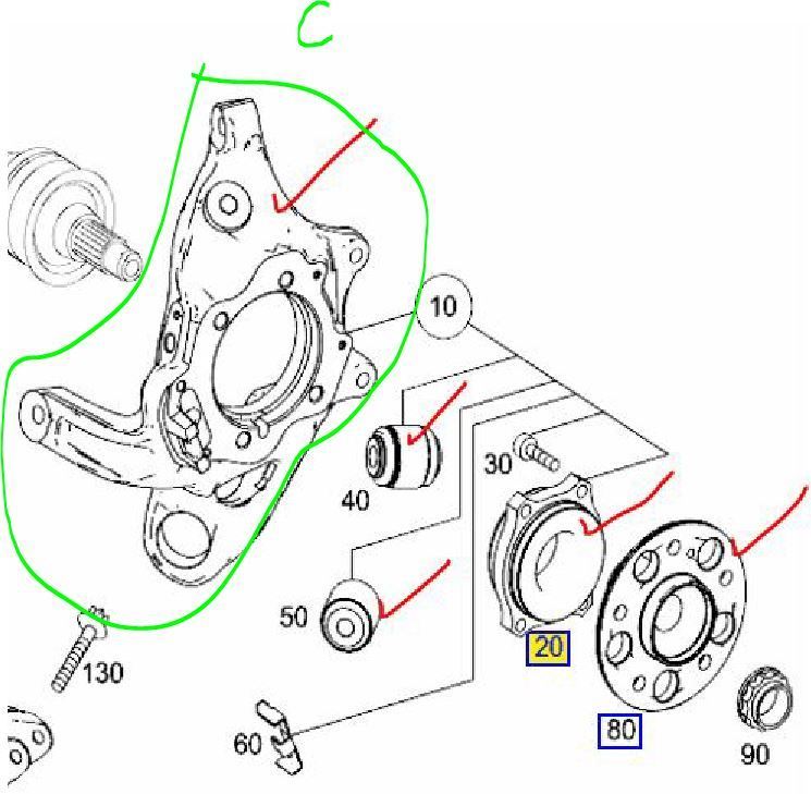

That colored region is part of a bearing assy Item A where when we buy from MB, we get the whole thing.
Unless someone replaced the bearing only inside the Item A assy...using heat....it is possible
OR.... someone replaced the flange ( item b) only while hearing up Item A
I am most interested in the wheel carrier /knuckle actually, item C , #10

Looks like it could be the interference press fit on that part. Does the bearing feel smooth?
On many parts that require press fits in industry, you heat the bearing hole and freeze the bearing. It can help reduce galling for really tight press fits for ISO H7 hole fits or above. Piston pins, pressed in some connecting rod designs, use this method too.
If you’ve ever installed bearings in this method, it’s pretty fun to watch them just drop in the hole, or use very little force to insert them.
On bearings, this can prevent out of round conditions where some of the material in the hole gets deformed, causing the bearing race to distort. Could be they used that procedure to insert the outer bearing. The heat pattern looks too uniform for a tech using a torch to change bearings. Looks like it was done on a machine.
I have seen that part on some other MB’s look the same way (coloring from heat) . So it’s probably one of many manufacturers MB uses to manufacture these parts that used the pre-heat press fit processes. It may be an aftermarket part, but if it has such low mileage, that would be doubtful. Can you identify the bearing manufacturer?

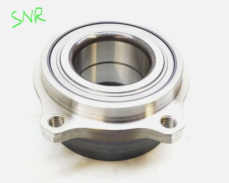

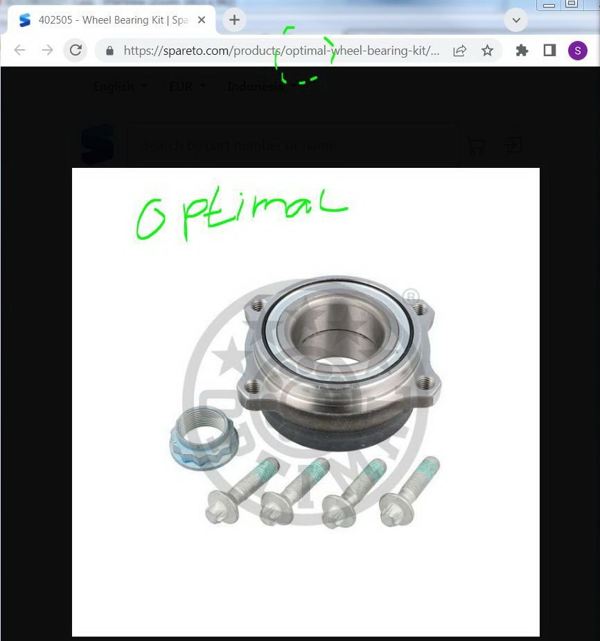

Here are two other brands aftermarket bearing having similar color like my used unit.
The bearing is genuine, I am sure.

I stopped at my shop - "normal, that is what they look like" this is from a MB Master Mechanic.

Induction heat treatment is normal for hub/bearing units like the ones pictured above.
Induction heat treatment color pattern is shown on the parts pictured above.
Bearing components are forged, not cast.

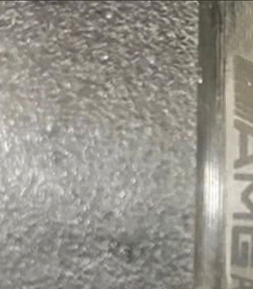

The body of the bearing holder/housing rough surface is indication it is casting method.
Just the body holding the bearing

I'm pretty sure that is induction heated so the bearing can slide into bearing carrier because of interference fit. Pretty common practice to make pressing the bearing faster and more gentle.
On the flipside you can also freeze the mating part so it shrinks. Which is what I did when I did all four wheel bearings on my car.

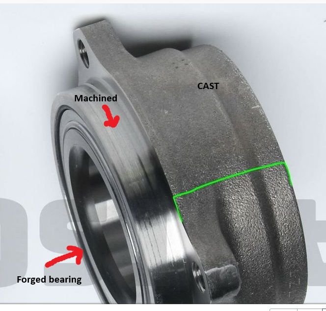

Yes, the part is technically “heat treated” thru induction. Heat treating is a BROAD term. Anything from hardening to annealing/stress relieving is considered “heat treated”. The induction process could generate enough heat for stress relieving or hardening, if desired, depending on metallurgical properties of the part. Also some parts have built in bearing races and the whole part is hardened to add durability to the bearing races. I don’t believe that’s the case for this particular hub.
Induction process from SKF bearings : (similar induction process used on parts for O.D. press, but different machines)
https://www.skf.com/us/products/main...uction-heaters
I’ve used a similar one of these portable induction heaters to mount bearings on a shaft:
https://www.skf.com/us/products/main...duction-heater
There’s a bunch of good information from SKF
https://cdn.skfmediahub.skf.com/api/...pdf#cid-595611
Hard to tell visually if the part is cast or forged without more in depth analysis.
Modern castings are very uniform, but this is a fairly high stress area.
Below is a confirmed MB forged part, and the wheel hub in question side by side.
Things are not always what they seem
You get the idea…

What’s interesting about that bearing, (though have replaced a few of those assemblies, I don’t currently have the actual part in hand, nor did I note)
I don’t see a shoulder for the bearing to seat. So it’s appears to be held in place by press fit alone or possibly tapered? It’s also a deep bearing press, lots of surface area.
@S-Prihadi do you see a shoulder for that bearing to seat?
But you are correct, it will depend on desired class of press fit. Only way to tell designed press fit is disassemble and measure.
