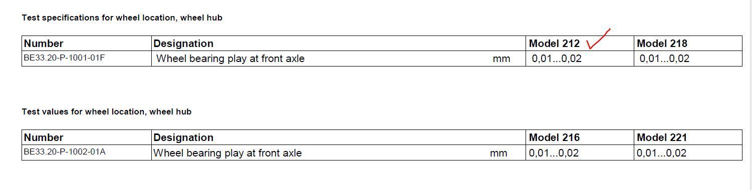

It seems the bearing is settling down again after 43,000KM.
So total I been doing inlcuding this 3rd one, 0.02mm x 3 adjustment.
Or total 0.06mm or 2.3 thousandth of an inch.
2nd time
https://mbworld.org/forums/e-class-w...ent-again.html
Today, 3rd time
If you guys test the right way ( hand at 12 and 6 o-clock only ) and with enough force........for this bearing freeplay,
I bet many of you are at 0.04mm ( 1.5 thousandth of an inch) or more
