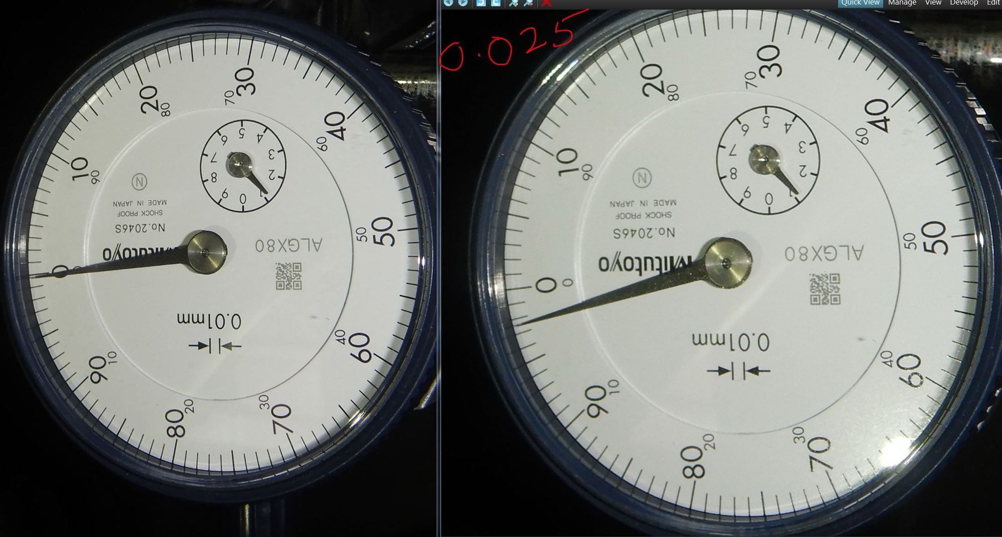

At approx 24,000KM and 4th Oct 2020, I already set it nicely to 0.01mm. It was at 0.04mm and this tiny 0.02 "looser" than minimum specification, does make noise.
To test, hold tire at 12 and 6'oclock and do one hand a push and other hand a pull
========= Oct 2020 archive, first time freeplay adjustment, approx 24,000KM ===============================
Today, at no more than 36,000 KM or only 12,000KM of use, Its freeplay increased again, by sound (mild ) not as much as 0.04 mm like in 2020, but I think 0.030 mm.

My estimate is correct, 0.03mm freeplay.
Managed to set RIGHT FRONT back to 0.01mm.
I am getting the hang of it now, since this is my 2nd time.

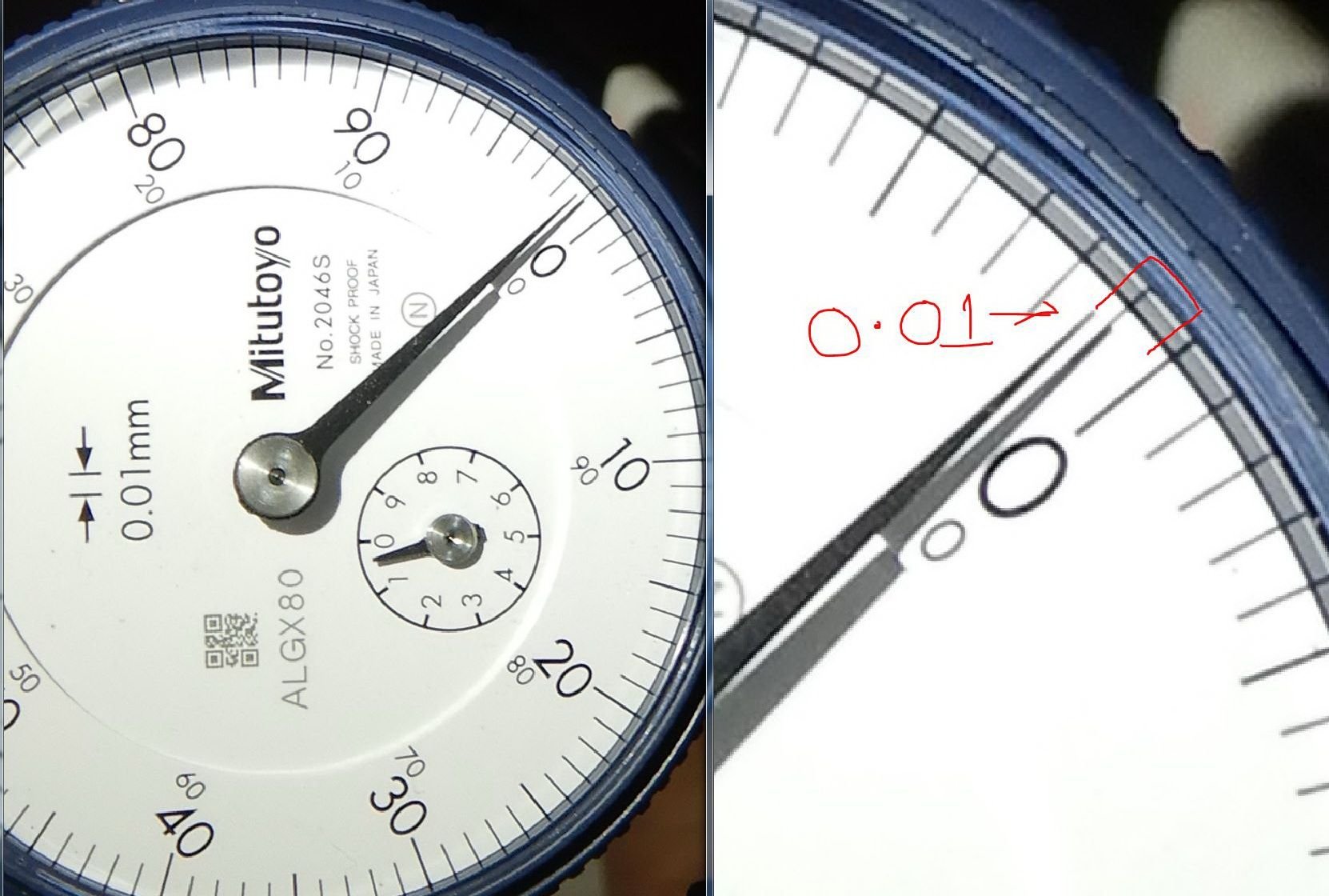

Reading 0.01mm is no easy task,

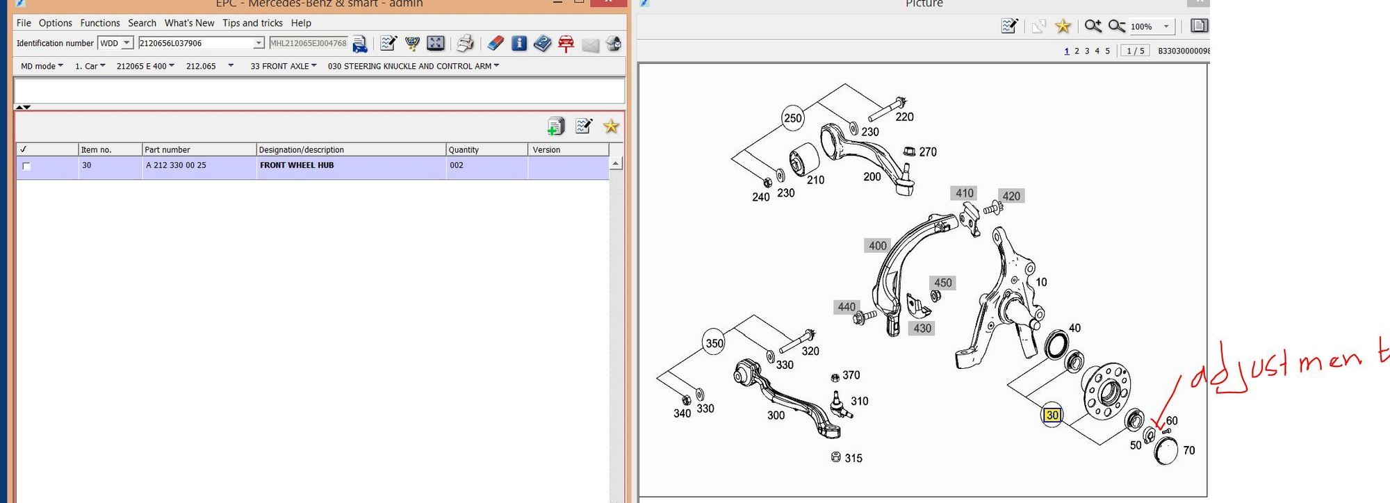

The Clamp Nut is basically a big NUT, but it has a locking allan bolt of 5mm.

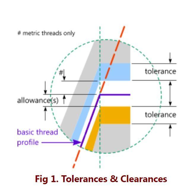

As with all bolts engagement to a nut, the thread themselves have tolerance.
Image Source : https://www.calqlata.com/productpages/00042-help.html
So if Clamp Nut loose and I set freeplay at 0.01mm, by the time I tightened the 5mm allan bolt, the clearance will be zero aka bearing will probably seize or be damage within short period of time. Sure wheel can spin still.
So when adjusting freeplay, a loose Clamp Nut , its own thread can contribute to freepay approx 0.01mm to 0.015mm, do remember this.
Make sure when you think you have achieved the target freeplay, once the clamp nut is tight ( using its allan bolt 5mm ), do test again to verify you are getting 0.01 to 0.02mm freeplay.

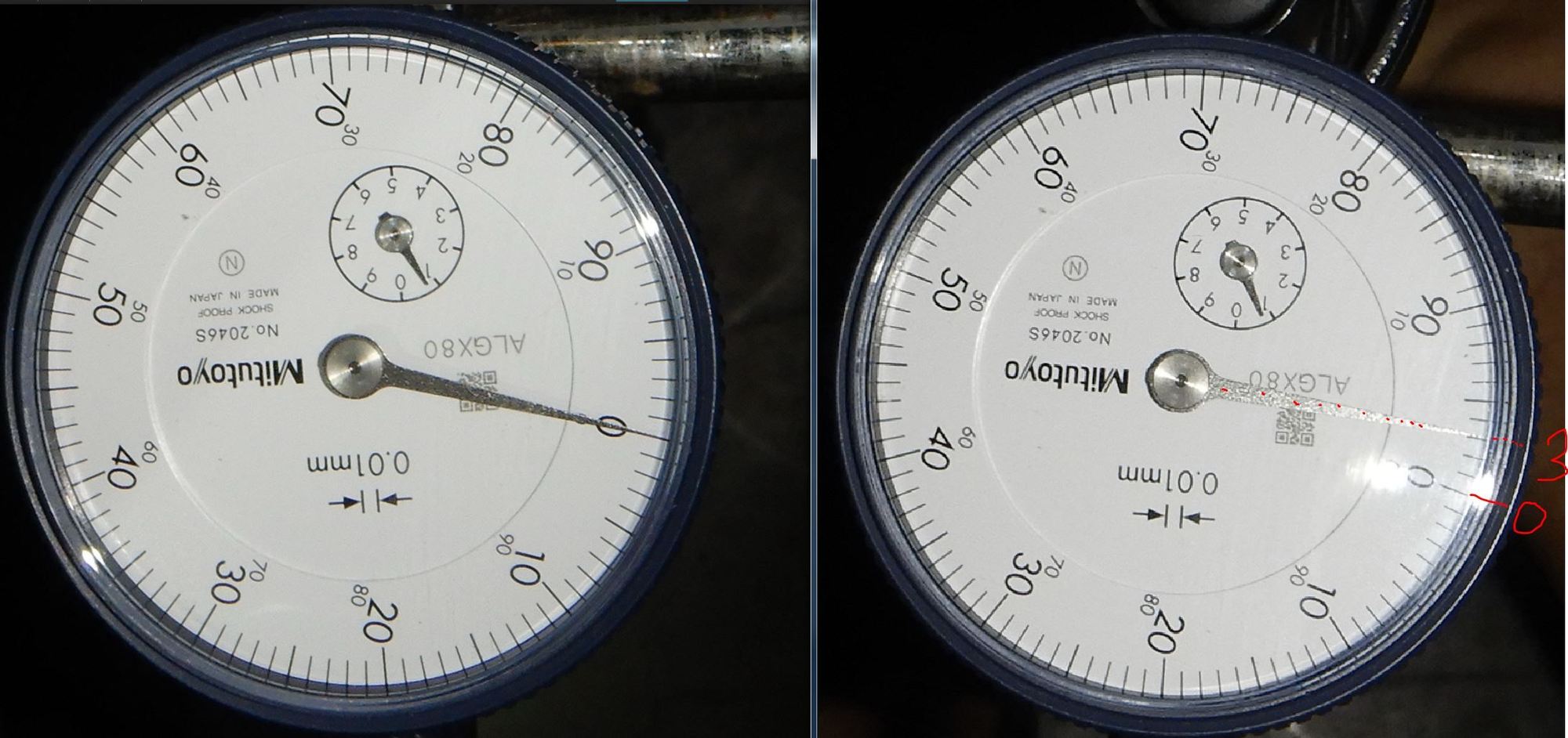

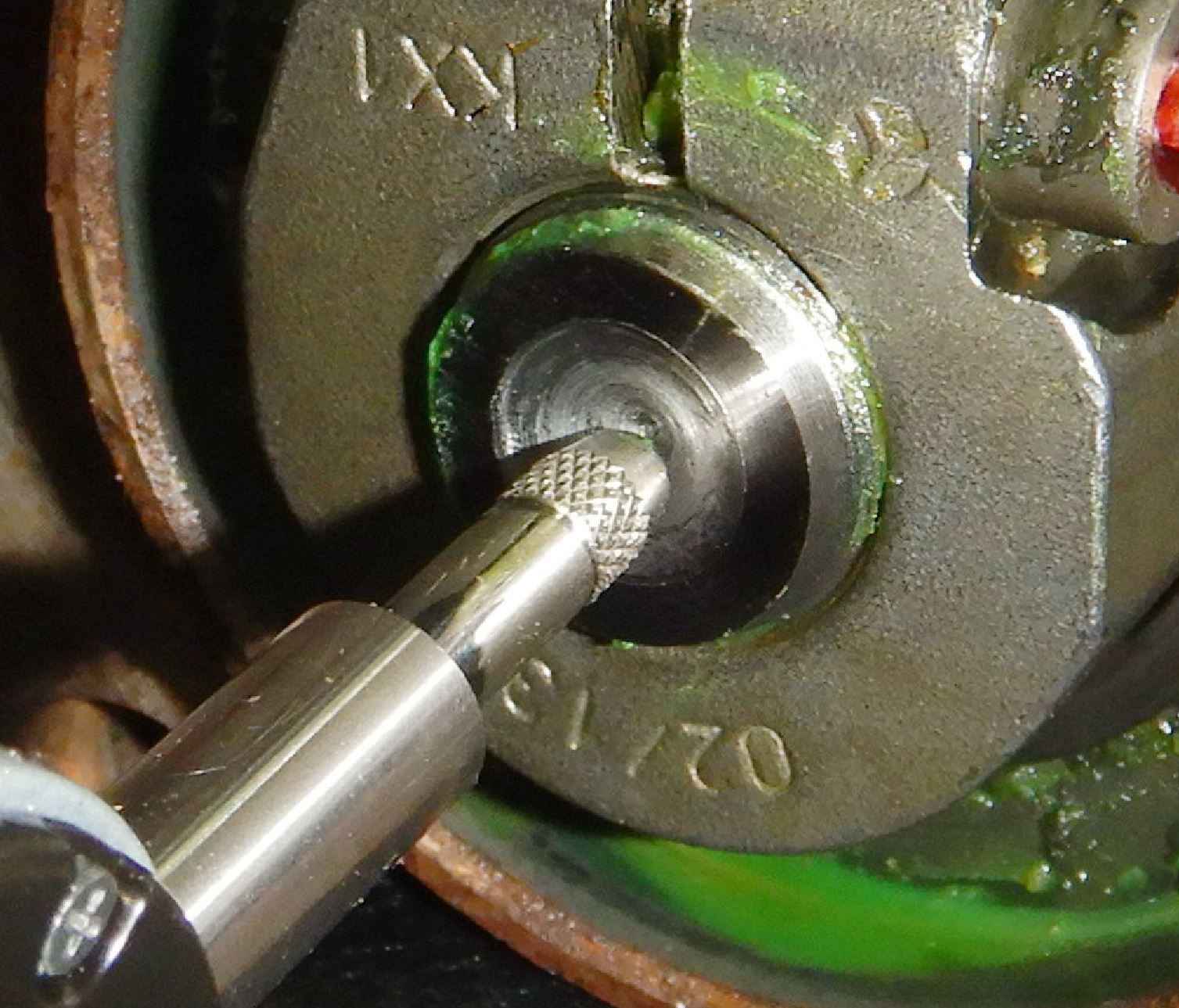

Placing the dial gauge is another art in itself. I hate it...... it is sooooooooo very slow to do.
Remember the dial gauge is placed on brake rotor and the rotor can spin.
Usually the component we measure is the one moving or spinning and the dial gauge stay put.,.... this is so much easier.
The measuring spot is the main wheel shaft, it has a shallow concave shape.
Above example of dial gauge needle not yet at concave's bulls eye and is only visible when zoomed. If by naked eye ....hhhmm, maybe 20 years ago I can tell
Me eyes not as good as a young man and since I can't raise my car as high as my eye level* ( *me sitting down on a super short stool) because Quick Jack maximum lift is approx 50cm only.
You have to make sure you hit the bull eye at the concave as accurate as possible, easier said than done. Need magnifying lens for me .
To verify that you dial gauge needle sit beautiful, at the concave bull's eye, spin the disc rotor 30 degrees LEFT and RIGHT and if your dial gauge move, that means the needle is not at the bull's eye yet.
All 3 axis aiming of your dial gauge needle must be spot on and 0.01mm spot on is tough. I wasted more time getting the dial gauge needle right than the freeplay adjustment itself.

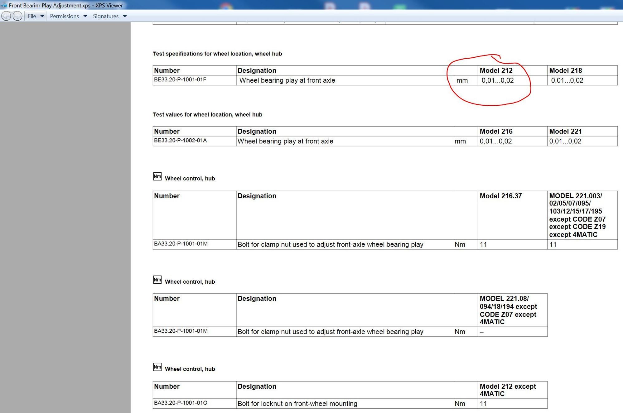

No wonder MB specified 0.01 to 0.02 mm.
The less loud click-click noise of LEFT FRONT was from a 0.025mm freeplay ...wow. Extra 0.005mm can make a sound....LOL

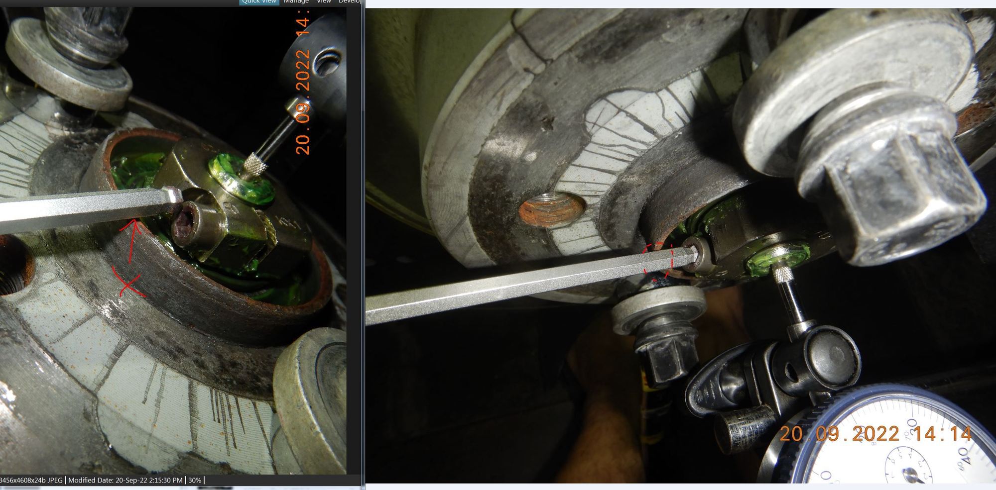

I can't do 0.01mm for the LEFT front. I got so worned out pullling and pushing so many times to generate the freeplay after adjusting the claw nut.
LEFT front I can only do 0.015mm.
I forgot to add, when using allen/hex tool, get the one with the L end having the ball type, so that it can be angled a bit.
If straight allen/hex tool, for my car it will get kinda obstructed by the lip of the bearing cavity. I marked red.
On my 1st time adjusting the freeplay in 2020, I was using straight one... not good at all, I was fighting friction not the bolt.

The front bearing for us RWD cars is sold as a set, hub set.
Only adjustment needed, no pain of removing bearing.
Did the workshop inspected the shaft end, the taper ( knuckle) which held the bearing hub ?
Usualy when wobbling occured, this taper coul get damage too.
Below :

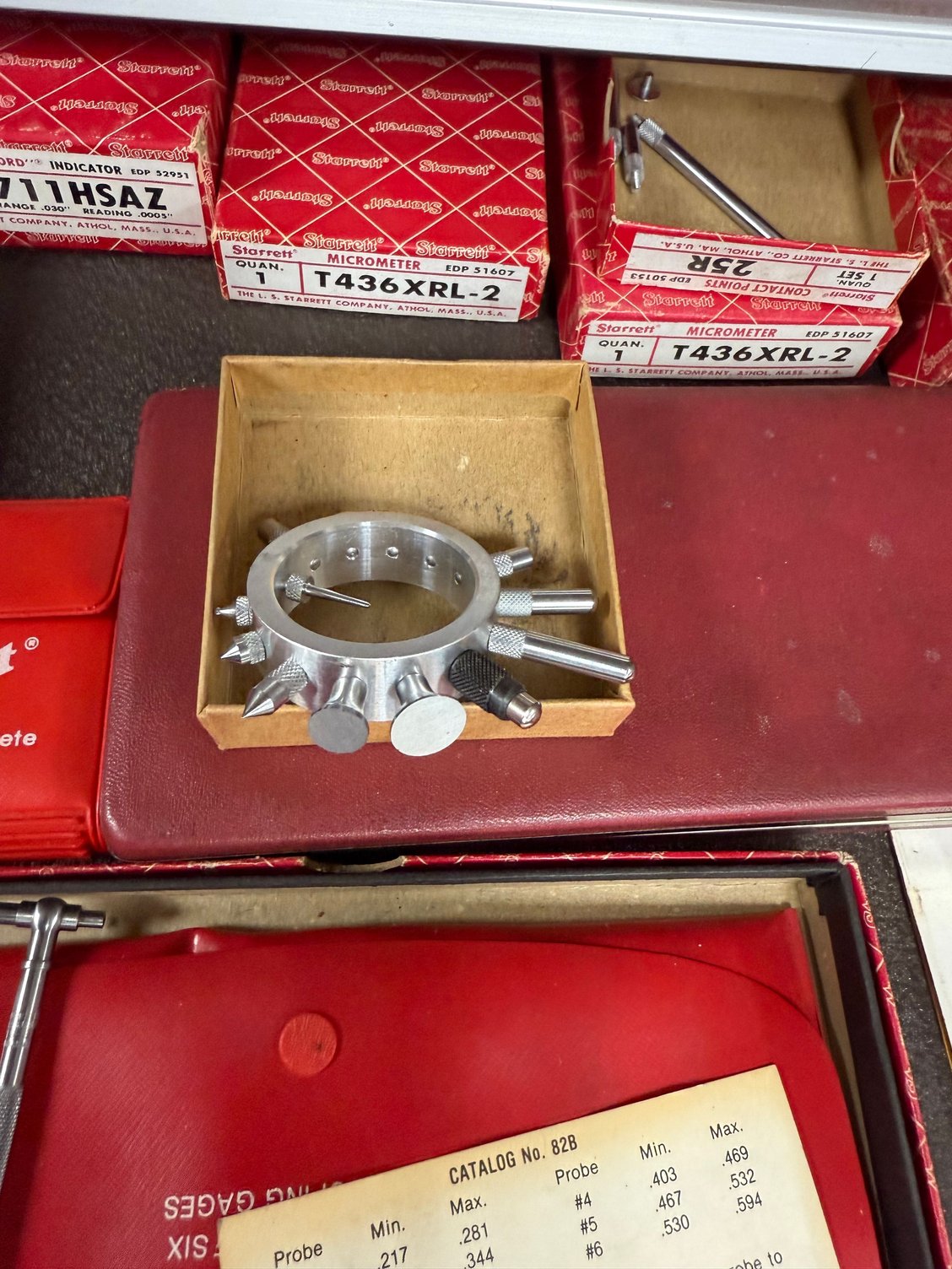

(Also you need a different tip on your indicator! Your accuracy is only as good as your setup. See pic)
When you “set” a tapered roller wheel bearing. The procedure is you have over tighten the nut, spin the rotor several times, THEN back it off to reach your clearance/play target. If you go the other way, try to tighten into the clearance, it’s much more difficult to achieve predictable results.
if you visualize how the two tapered roller bearings sit in the hub, you’ll understand why this makes sense.
The WIS procedure is correct, it’s just that you need to make sure you tighten the bearing, then loosen it to check clearance. Most techs I’ve seen have this problem haven’t tightened the bearings enough initially to get a proper/consistent reading. Or they are trying to set clearance while tightening the nut instead of loosening into the clearance/play.
Probably would have been helpful if they (MB/WIS) had given a torque spec, but they figure techs have been trained I guess….
