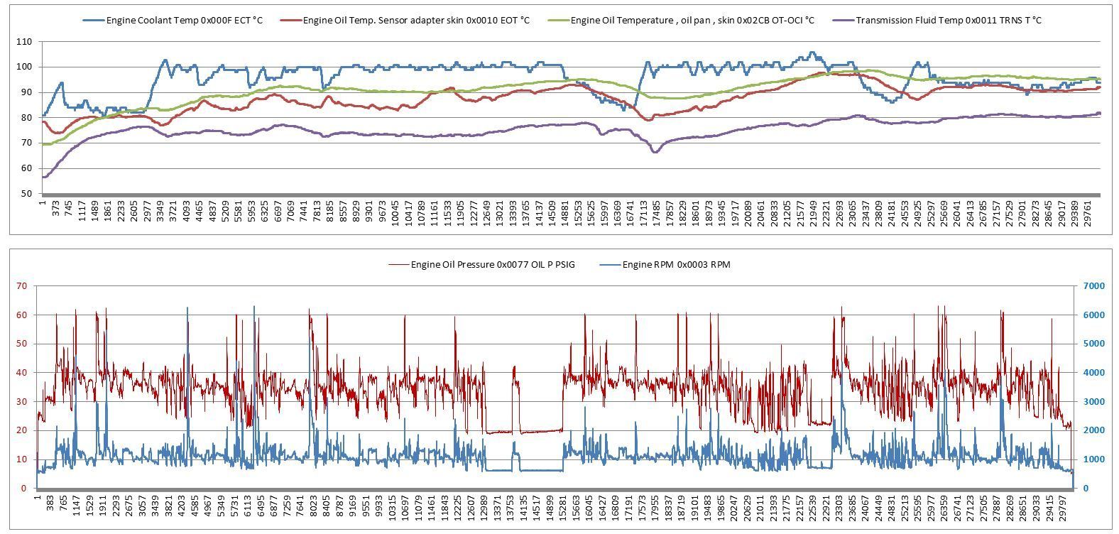

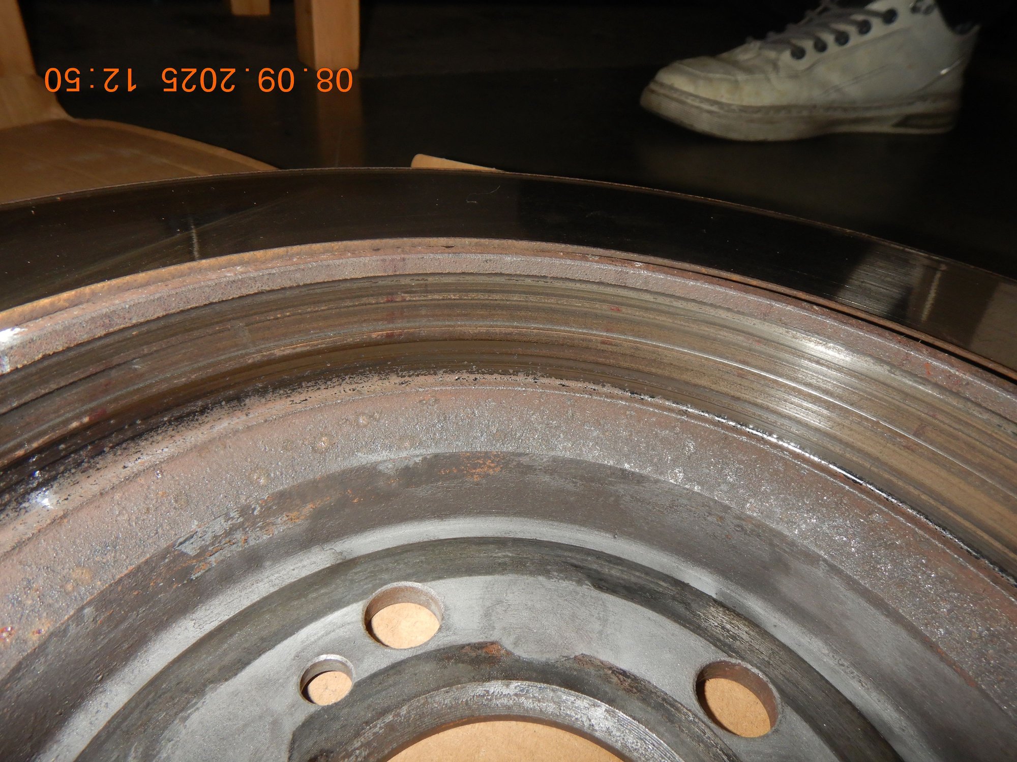

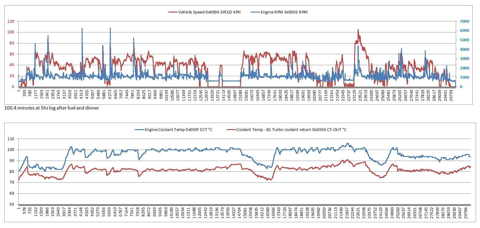

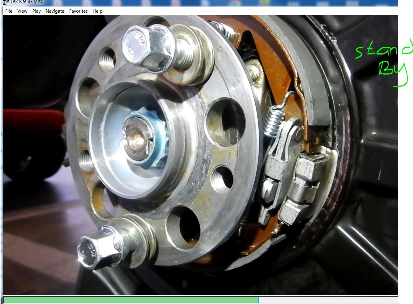

Car buttoned up and I did a long test drive yesterday Sunday, and dinner too.

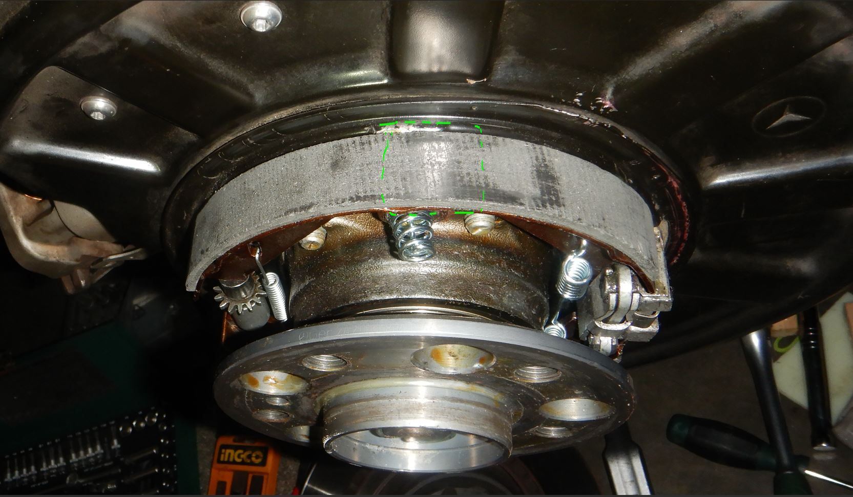

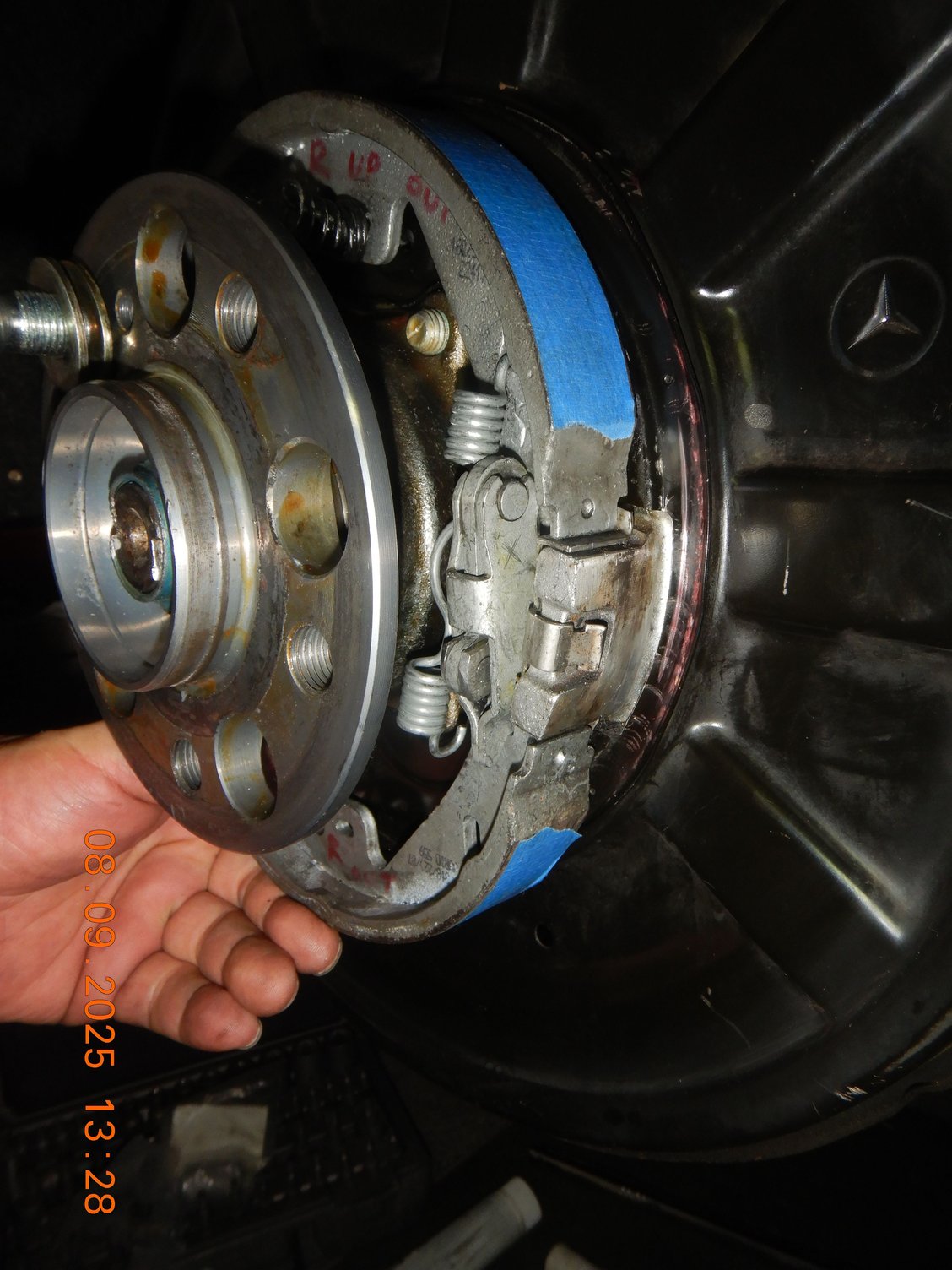

My bloody brake pad of right rear PARKING BRAKE is making cheapo noise...dugggh.
Anyway, all went well, but I never ran the engine hard yet.

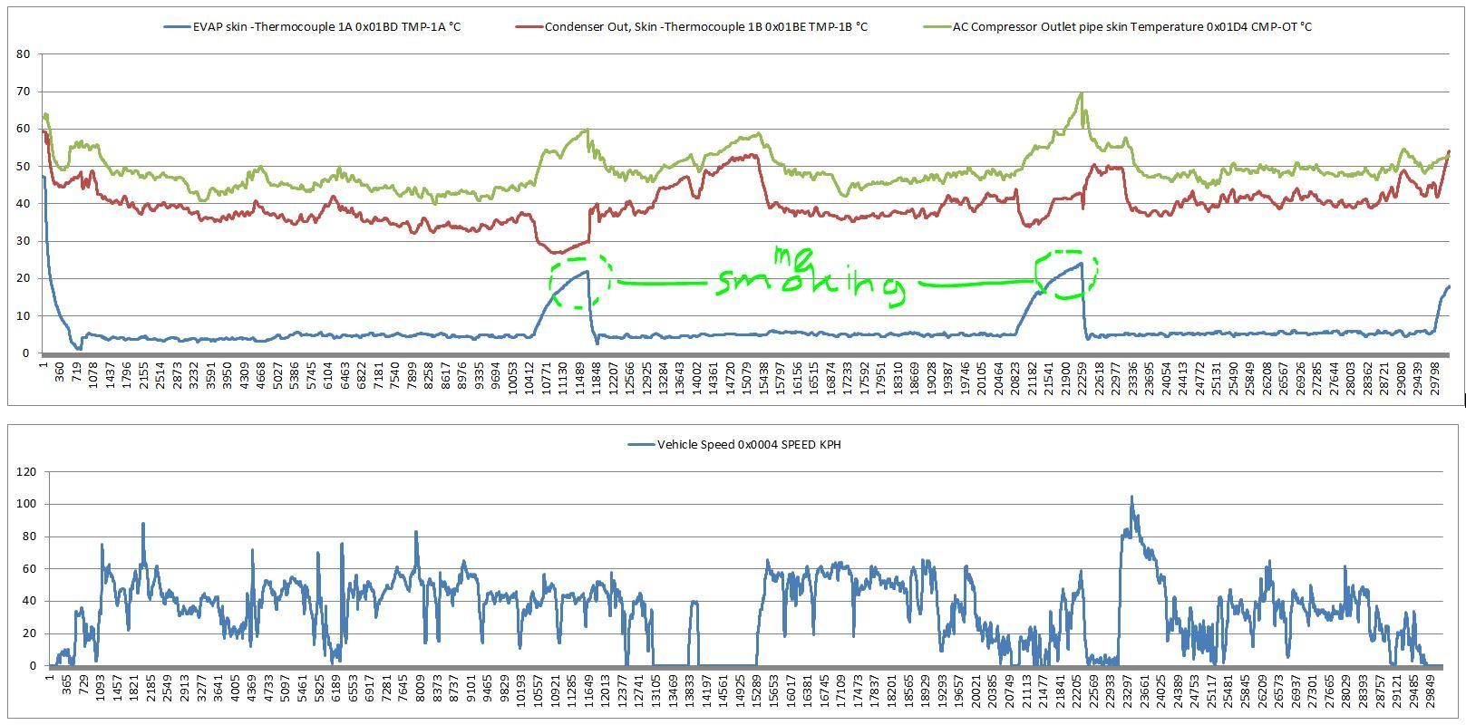

Engine parameters. 100 minutes log. Total run almost 140 minutes actually and about 70KM.
My HVAC system

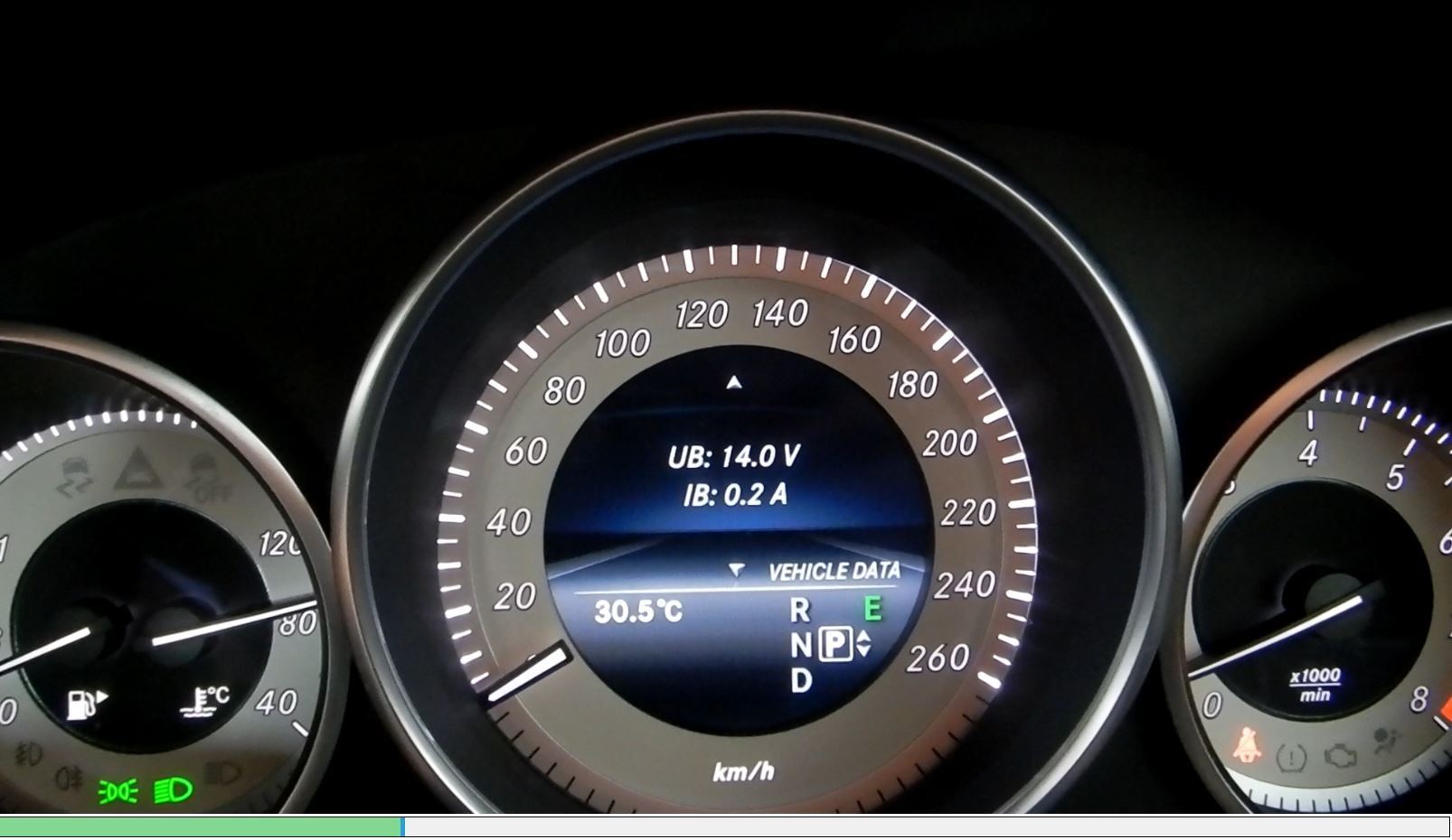

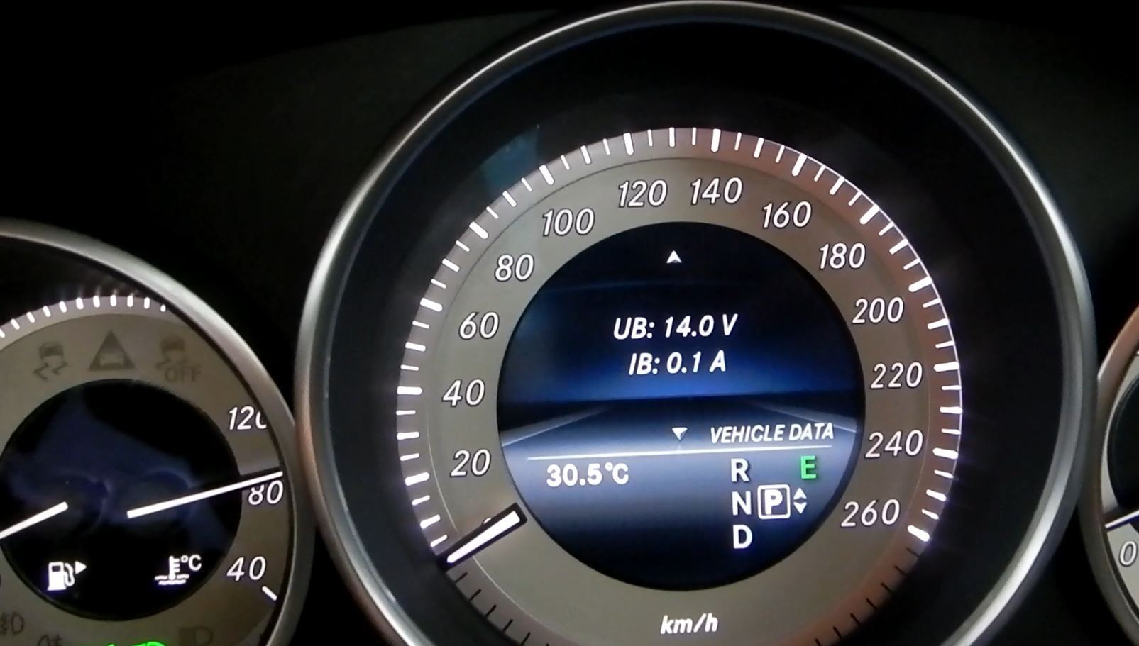

Testing of alternator stand alone smart charging.
I charged the battery up the night before this test.
See 0.1 and 0.2 amps only.....very nice Valeo charge controller which is built into the alternator. I like it.

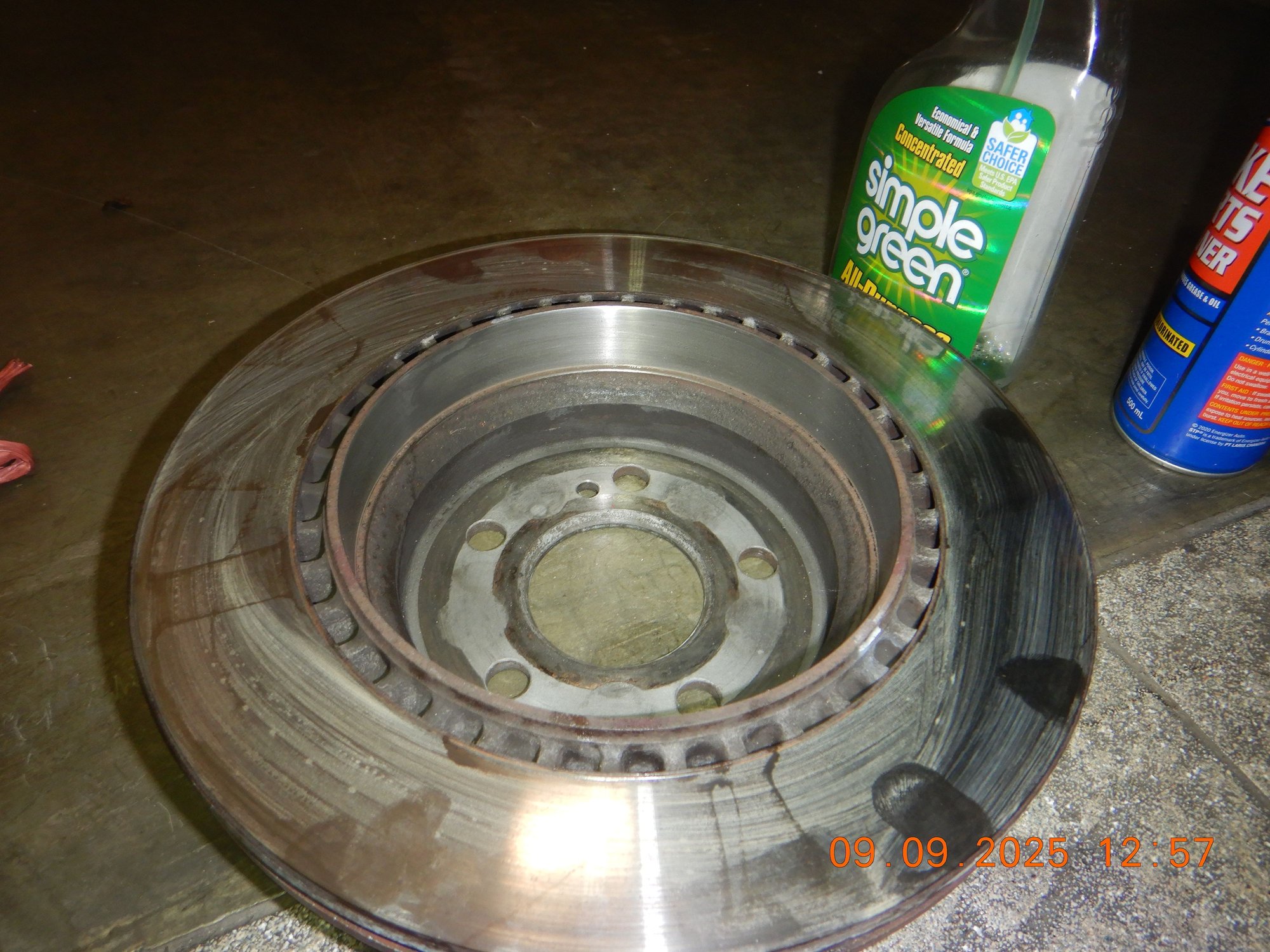

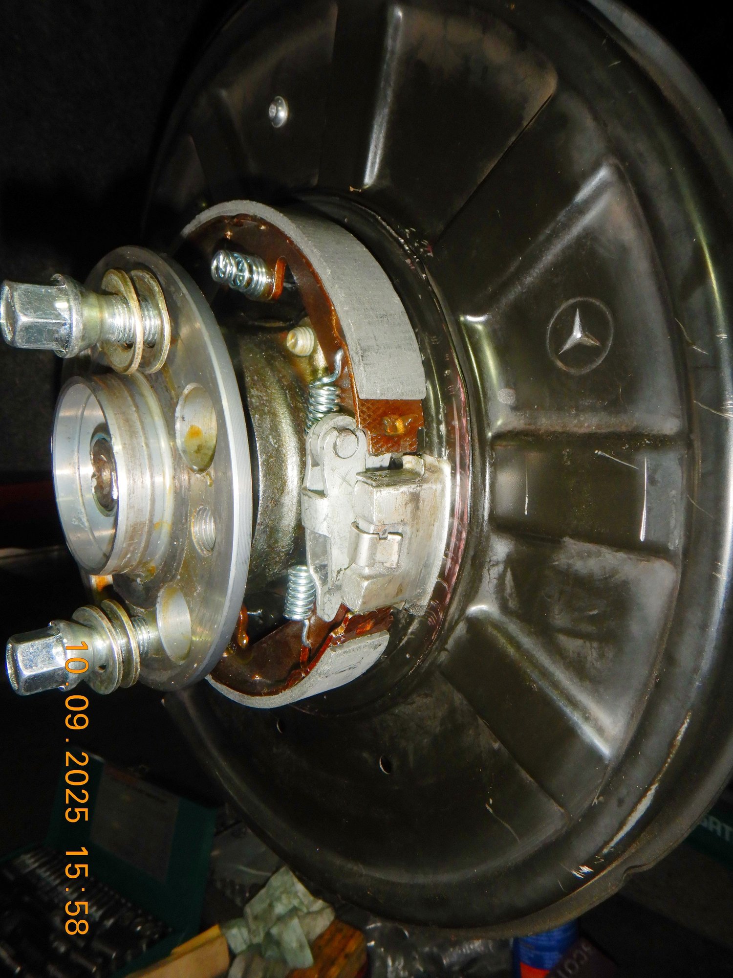

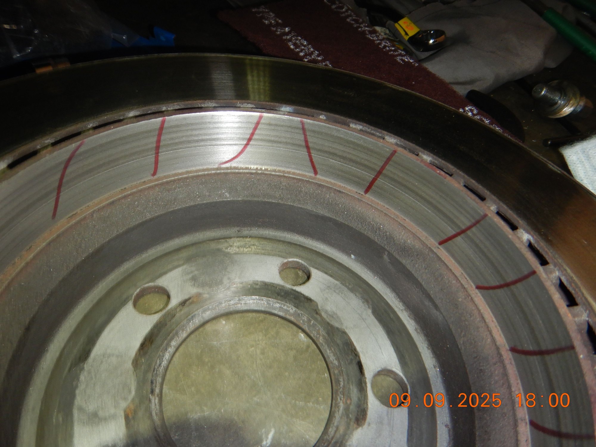

Today, stripped down the rear right parking brake system...again.

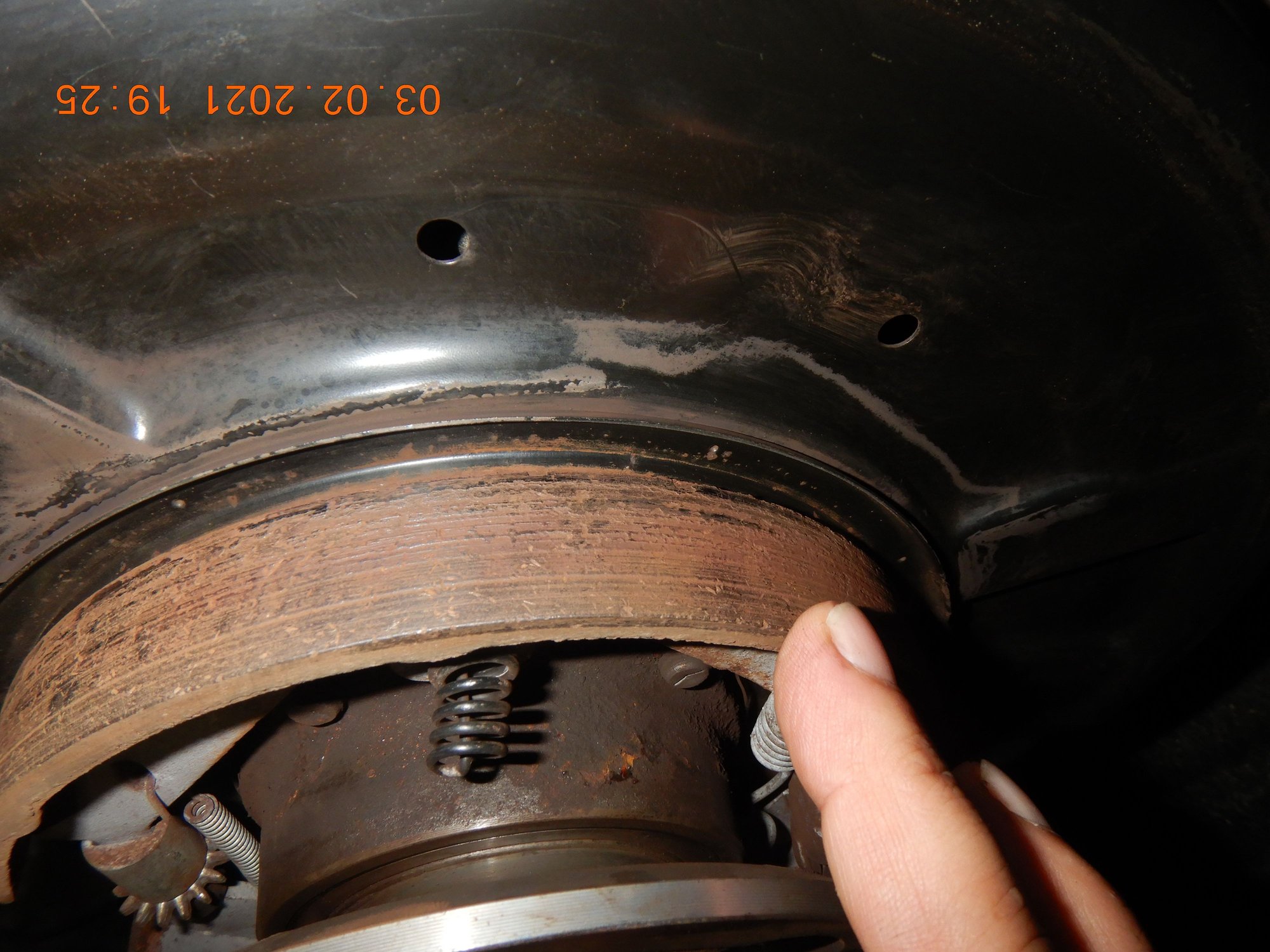

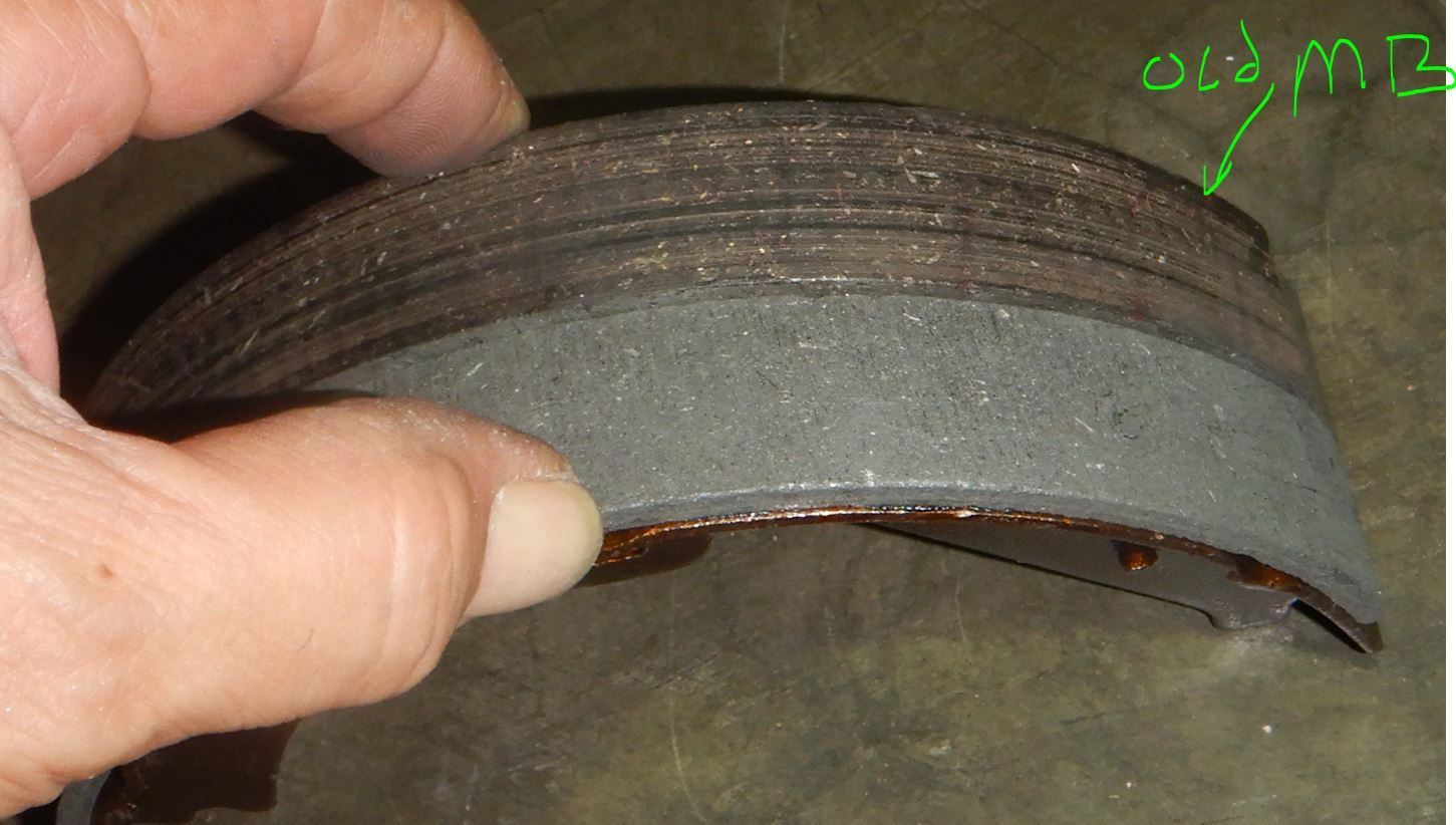

This time I sent my Disc/Drum combo to machine shop for simple surfacing. I hope by tomorrow Tuesday it shall be ready.
Actual pad to drum contact surface is very low/small.

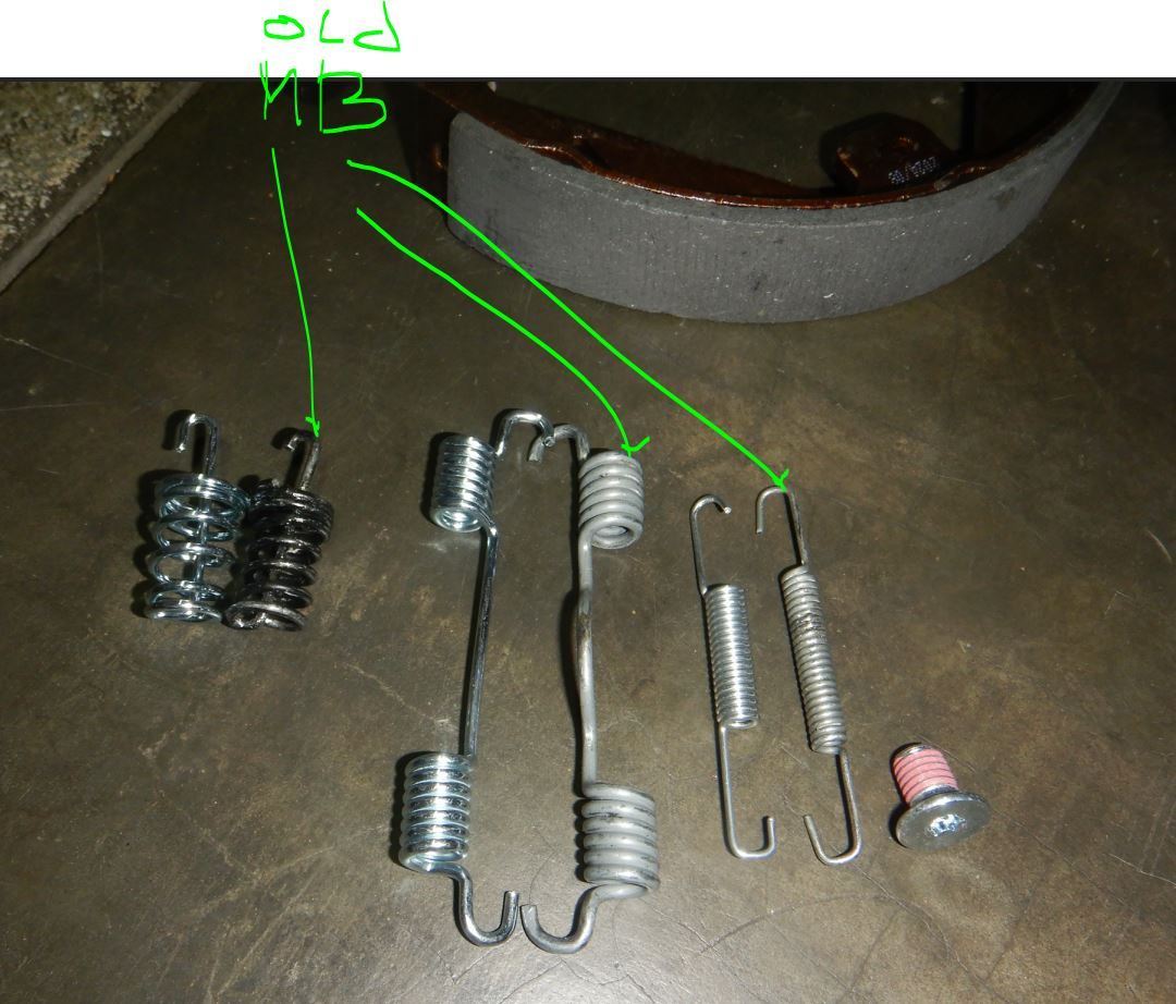

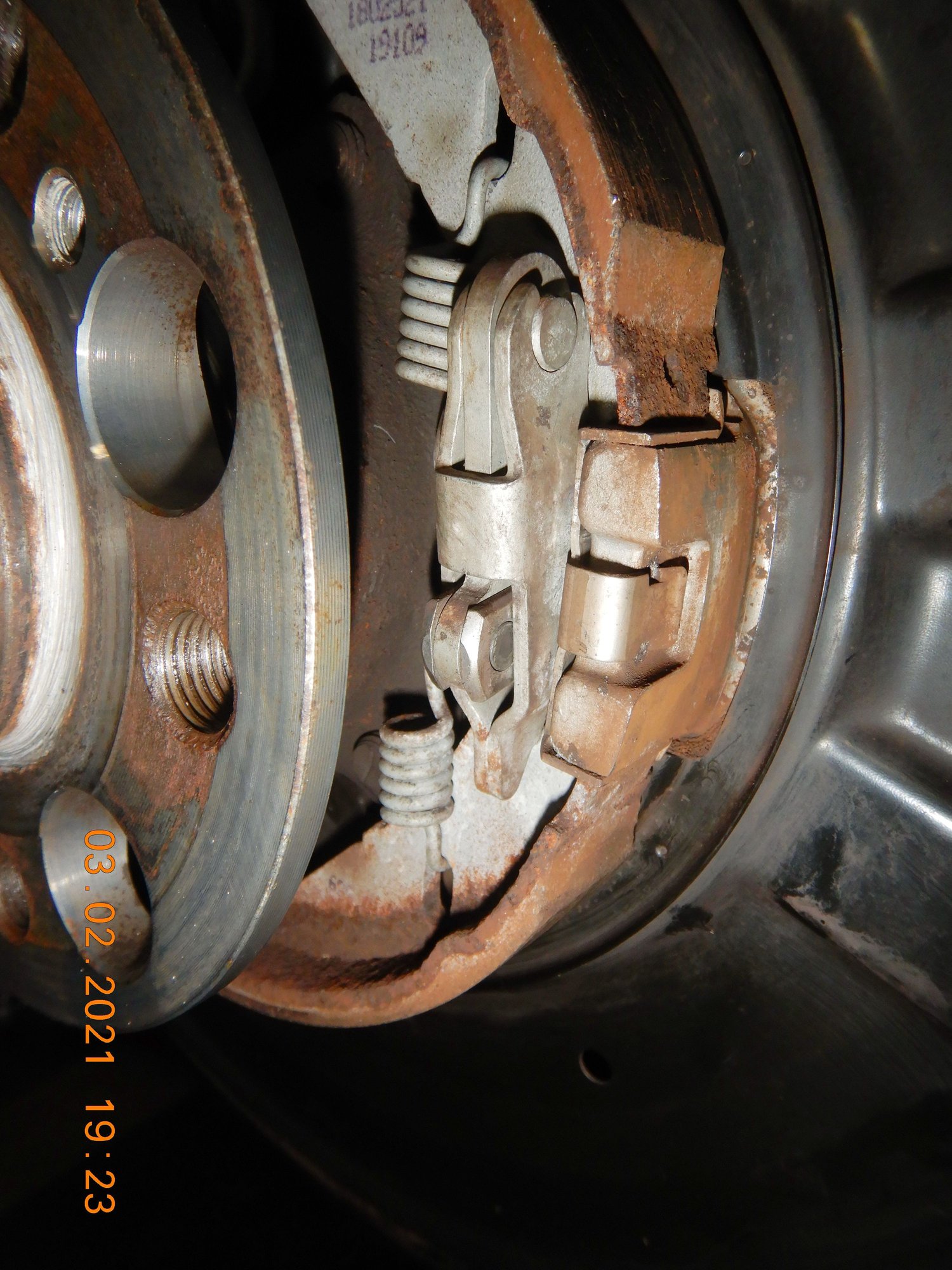

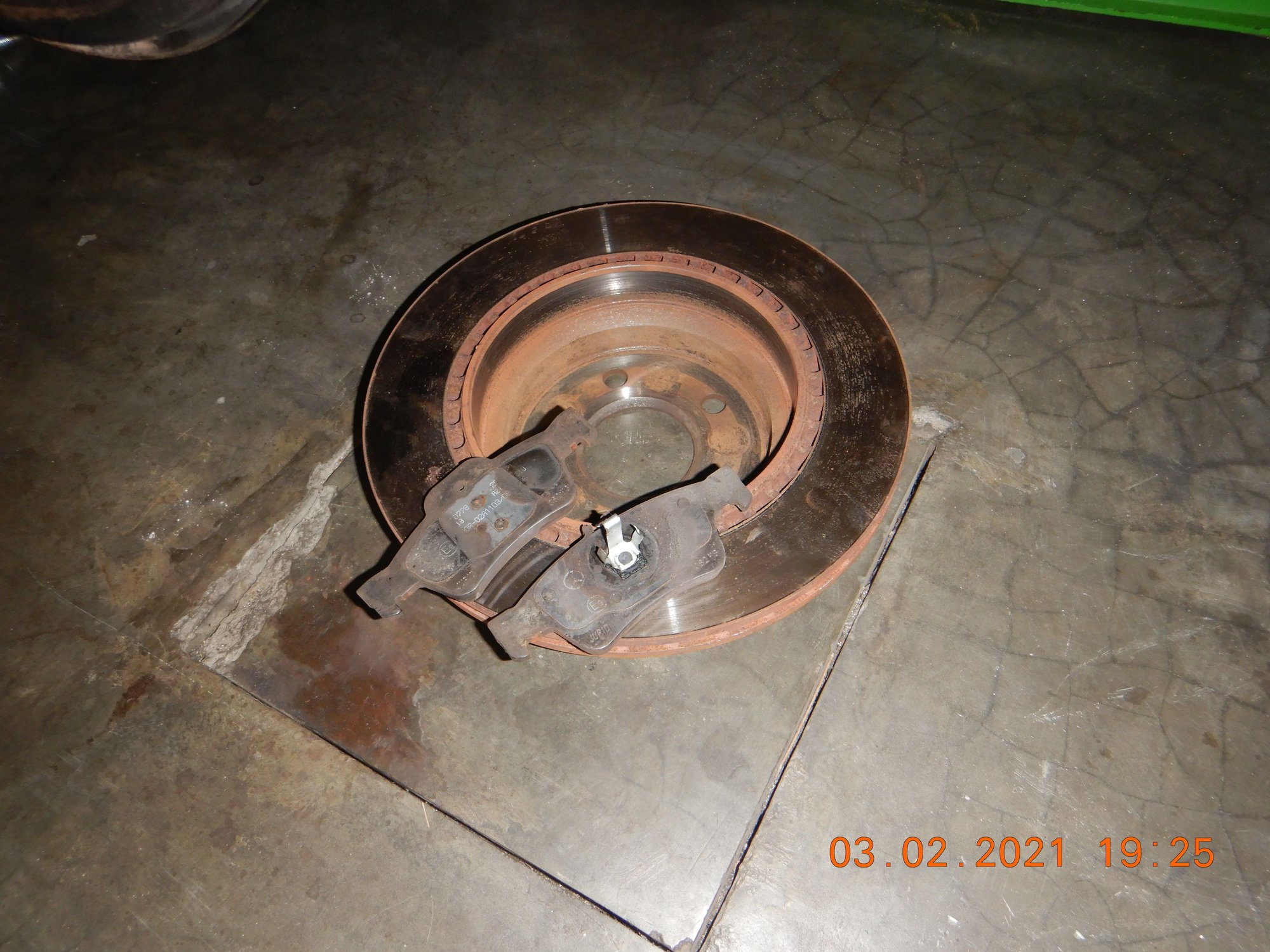

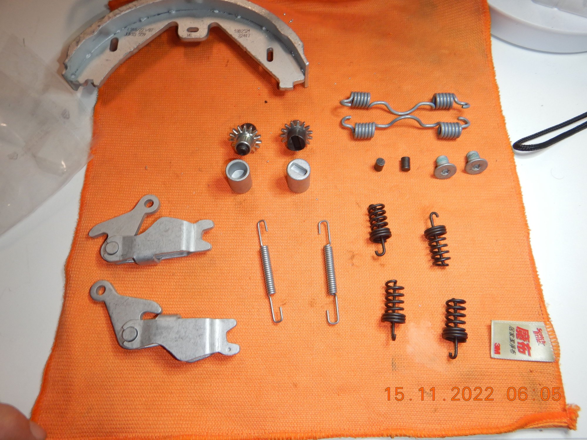

BELOW : This was when I bought the car and 1st time I cleaned up the parking brake in 2021
I replaced with new complete parking brake kit, 100% all new later in 2022 and its still on my car now.
But I never done any surface correction on the drum side.
Standing by for Rotor Disc-Drum to be ready from machine shop.

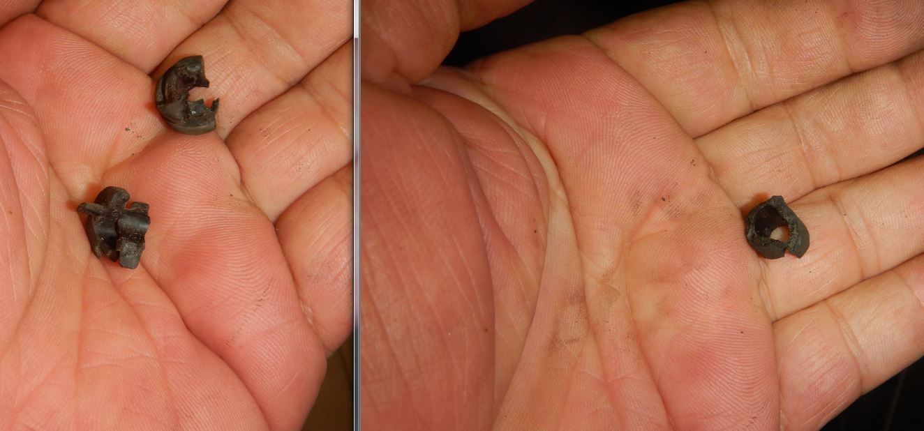

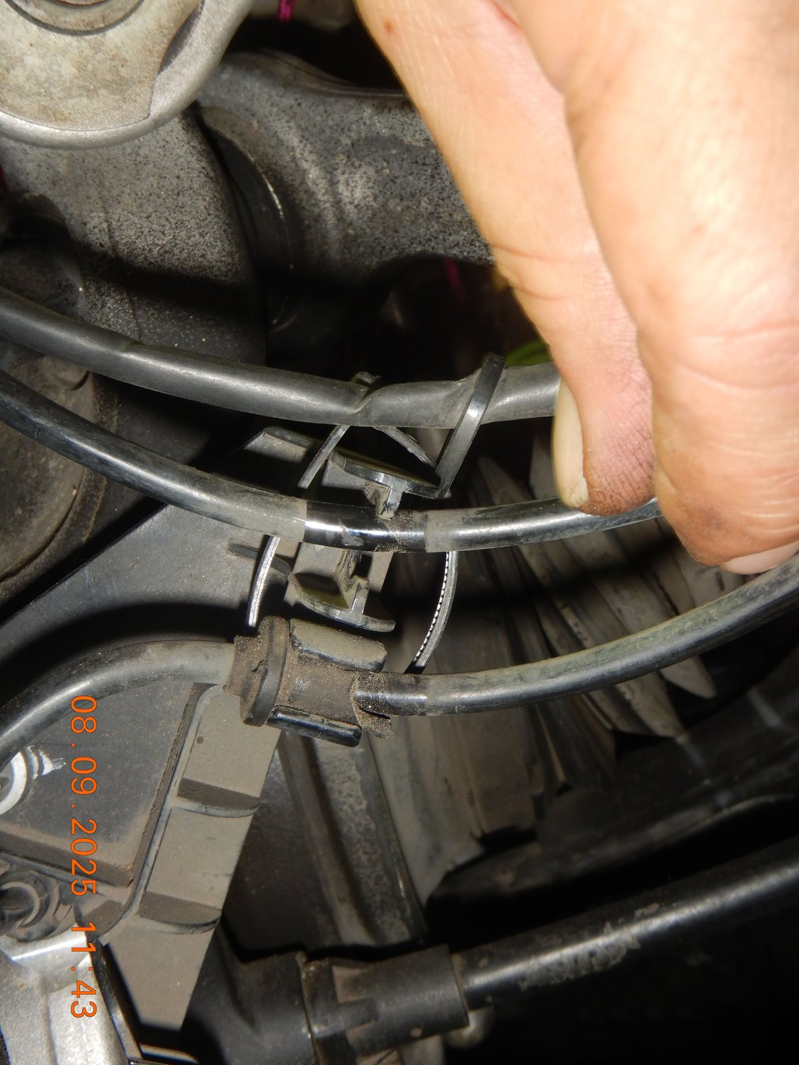

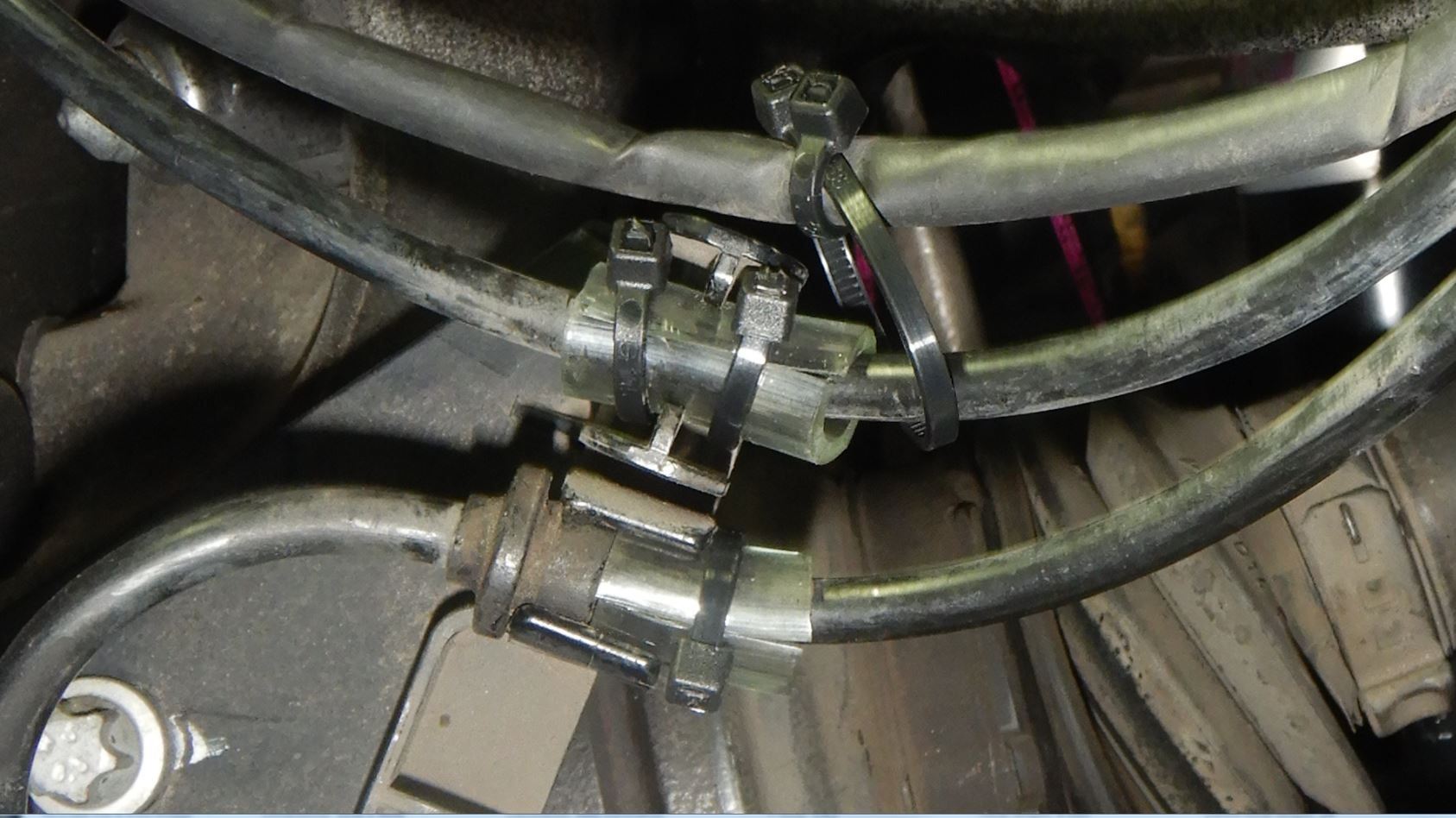

My rubber grip-jacket for wheel speed sensor and brake pad wear cable are now broken to bits.
This will surely happen before year 13th of car age, as I seen on my friend's C200 W204
This is what I meant by rubber grip-jacket
DIY fix

Amazing, amazing graphs and charts.
Have you ever explained how you were able to genthem, and publish them on the forum?
Old Sep 8, 2025 | 10:08 PM
  #160
S-Prihadi's Avatar
Joined: May 2018
Posts: 6,632
Likes: 6,569
From: Jakarta-Indonesia
It is from my Banks Gauge set, which is OBD2 system reading car OBD2 data out and also the Banks Gauge has its own sensor modules using its on CAN-BUS system,
and all the data is logged to a CSV file.

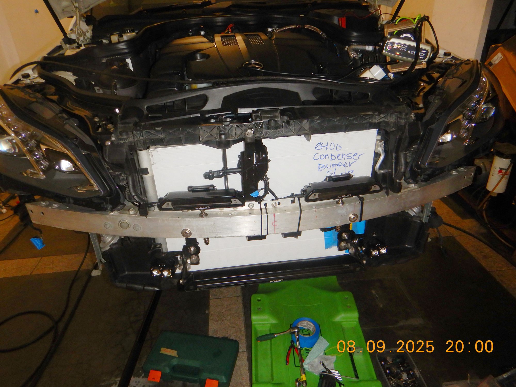

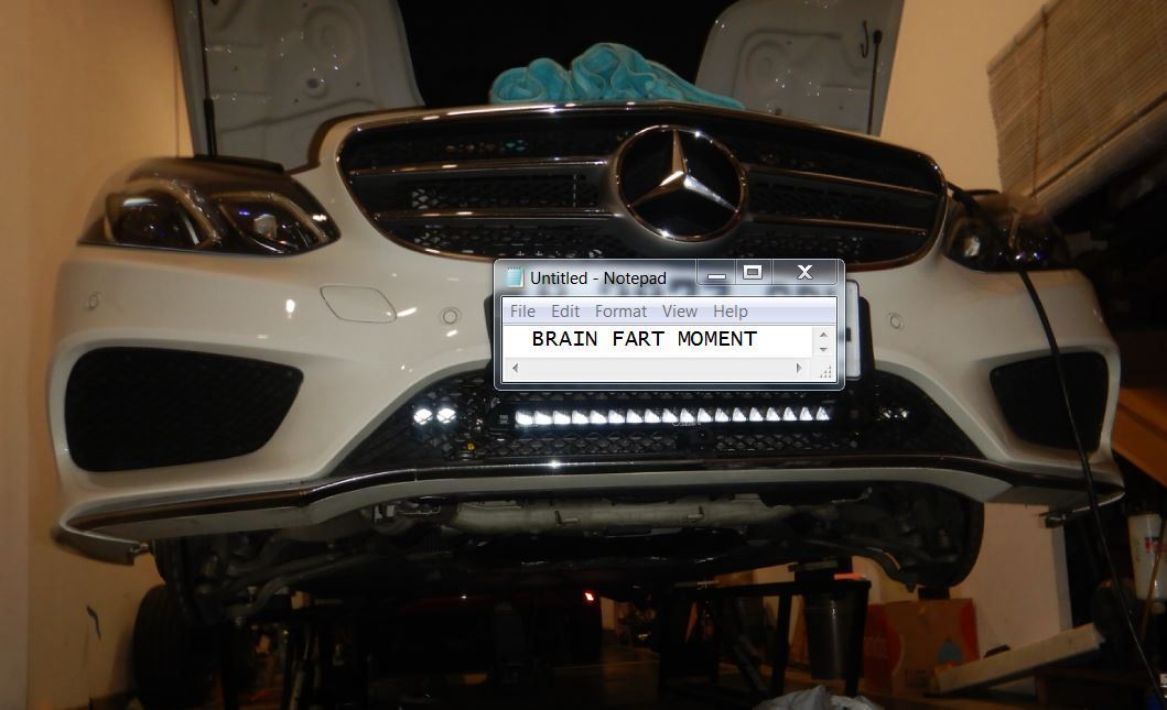

Another BIG brain fart moment on my part, too much distraction from a moron yacht "client".

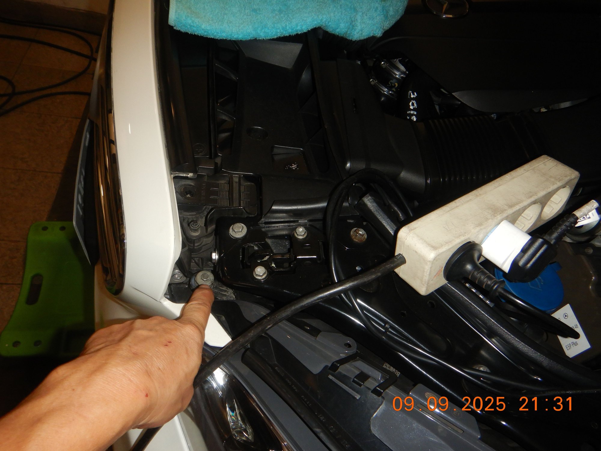

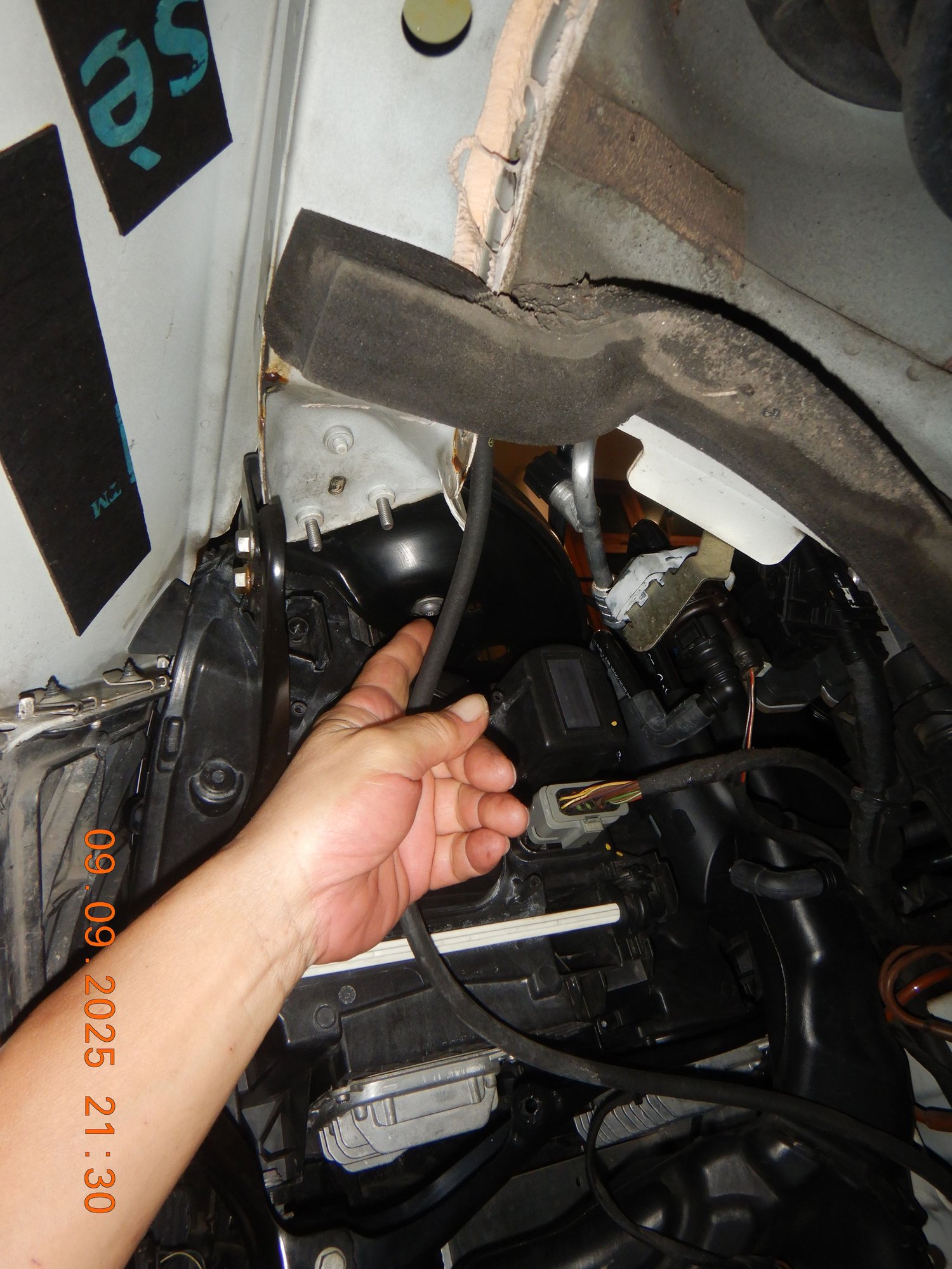

I was adjusting the AUX lights since last nite, and to protect my condenser, I use the usual white plastic board as protection layer.
This morning while waiting for the rear brake rotor/drum return from machine shop, I then proceed to adjust the gap of my original headlights to the bumper, as it has room to be out of position by 4 millimeters, for adjustability reason.
So the bumper need to be installed first and I adjusted the headlights install nicely, all flushed. All good.
2 screws of headlight install needed front fender liner, half-front to be removed, otherwise with bumper installed, there is no access.
.Above is 2nd screw, T27 Torx if I am correct.
Below is 3rd screw size 8 metric and is hidden behind, the frame my finger is pointing.
3rd screw is acessible, easy.

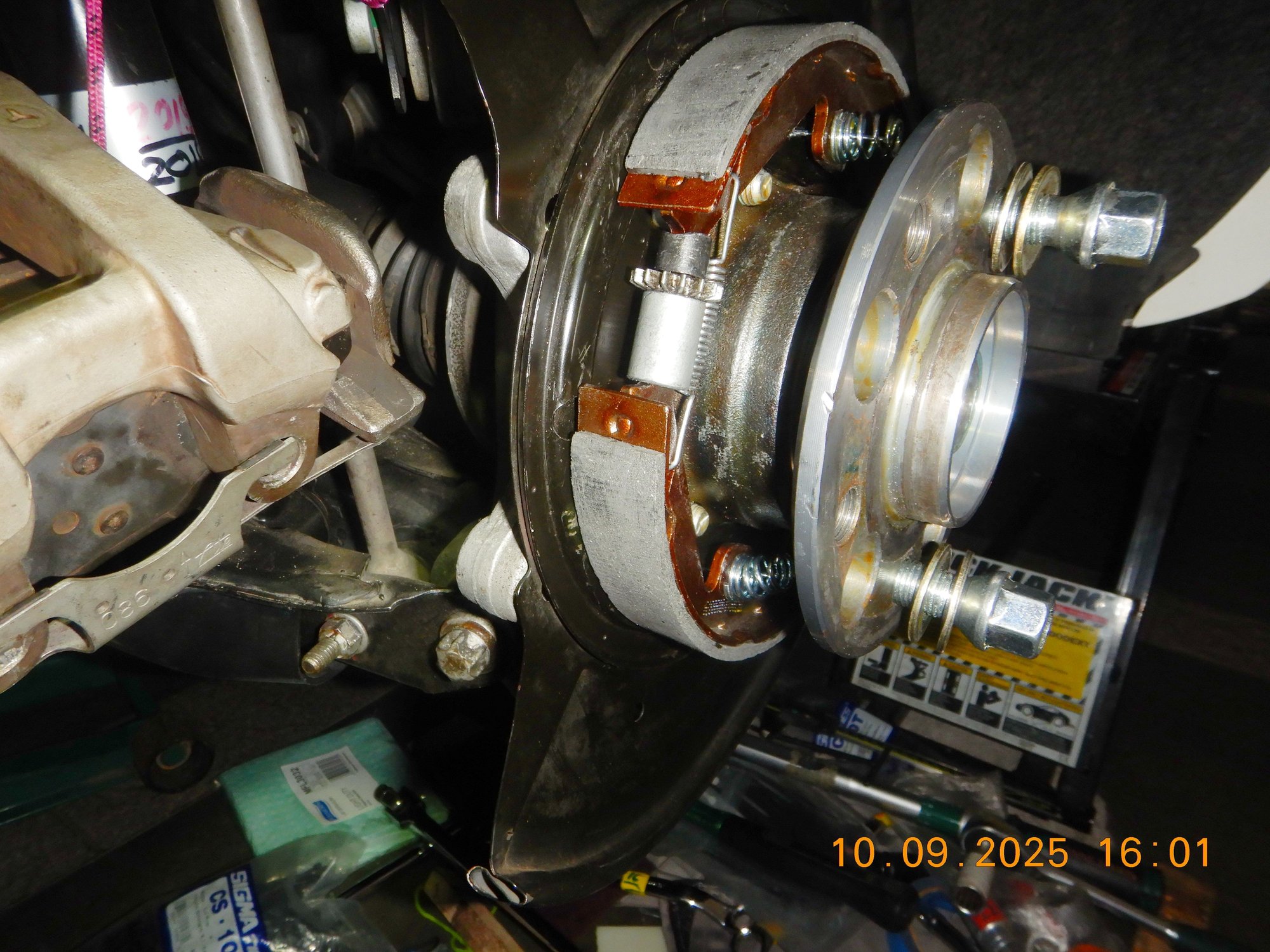

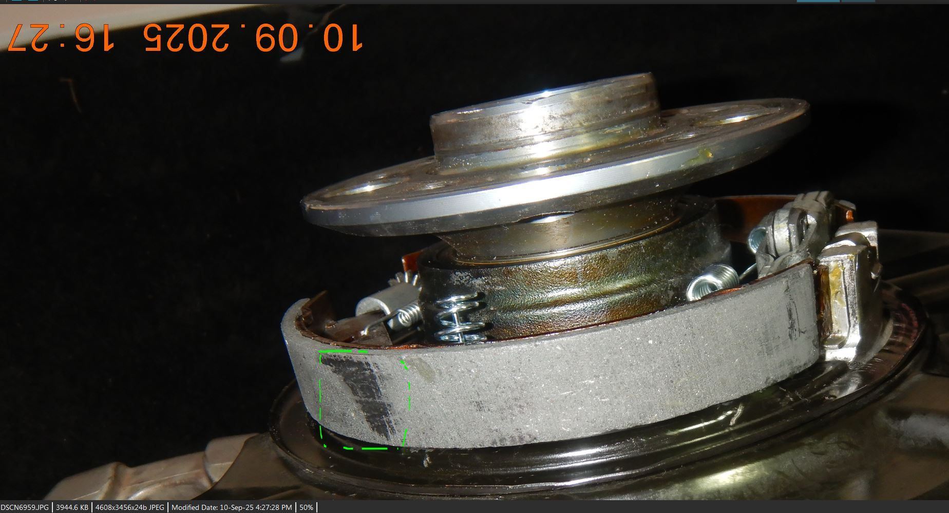

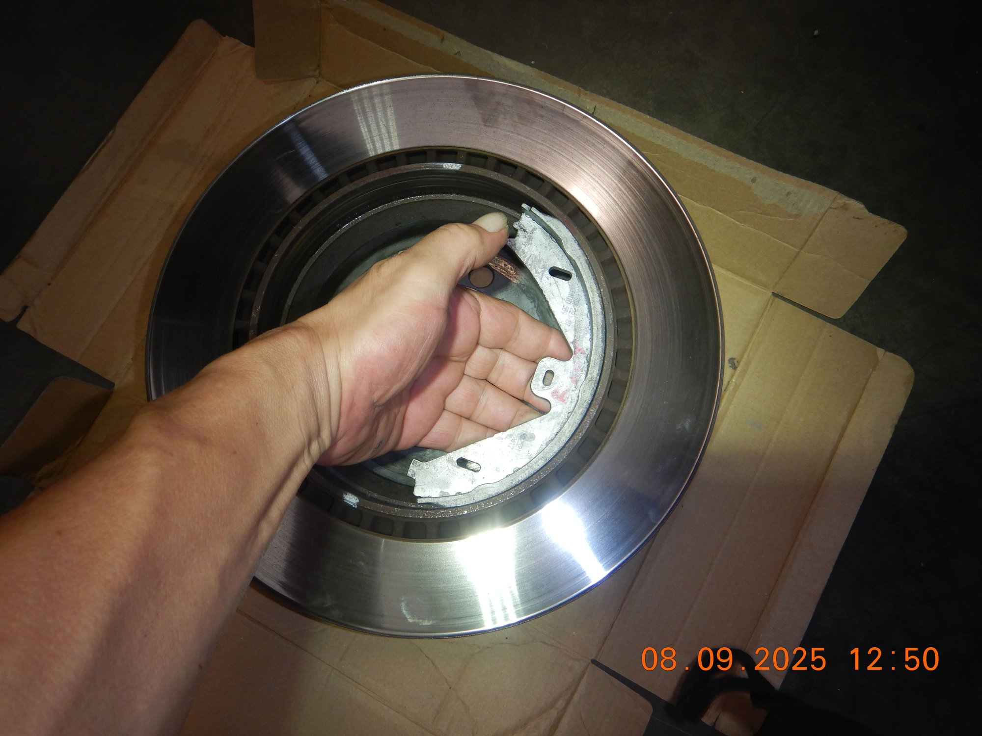

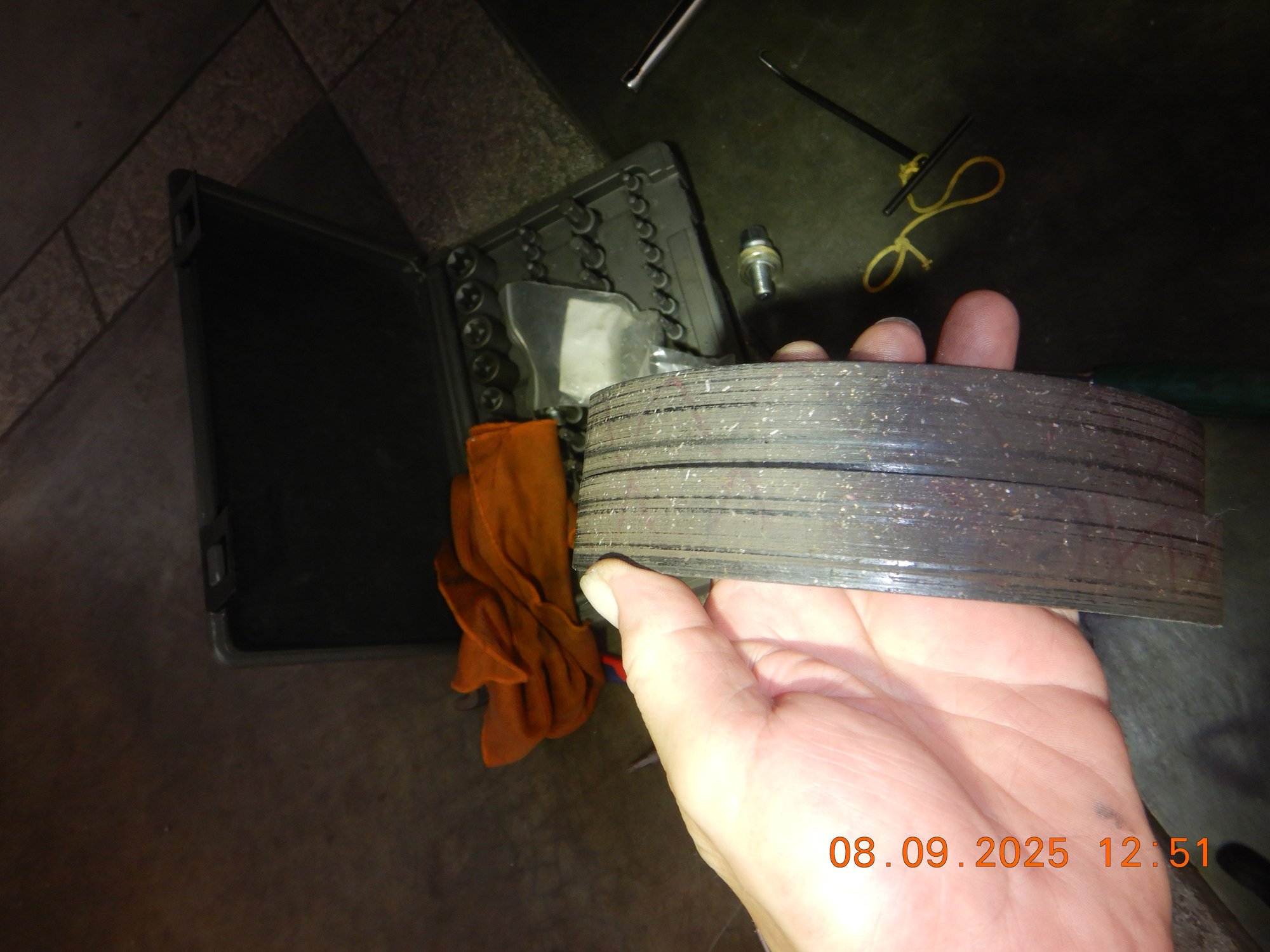

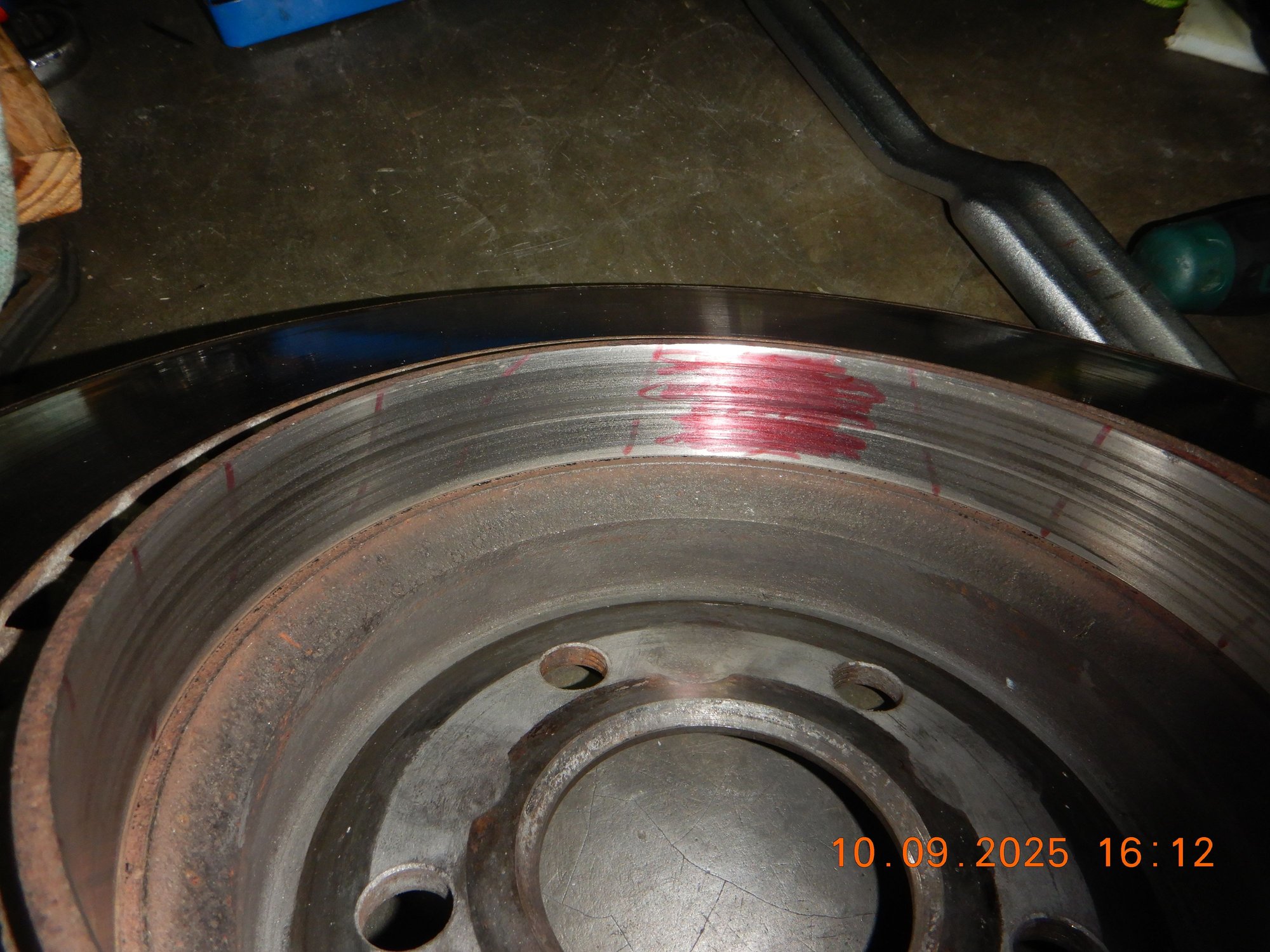

By mid noon the rear brake rotor/drum arrived and I installed it.
Use the engine and tranny in D to test contact area, the parking brake pad itself is not even/flat a 100% due to previous condition of the disc rotor/drum before machining.
See the color difference on the contact surface.
So noise is still there and only get reduced when I run engine and tranny in D and press parking brake pedal like 3-4 clicks.
When noise reduced much, the left rear is STILL quieter than the right side, as the parking brake pad is the noisy bas-tard.
Now my right rear parking brake adjustment is still near zero, thus its grip is not as good as LEFT side...yet.
I will polish again tomorrow.
I really hate parking brake drum style, it is so primitive.

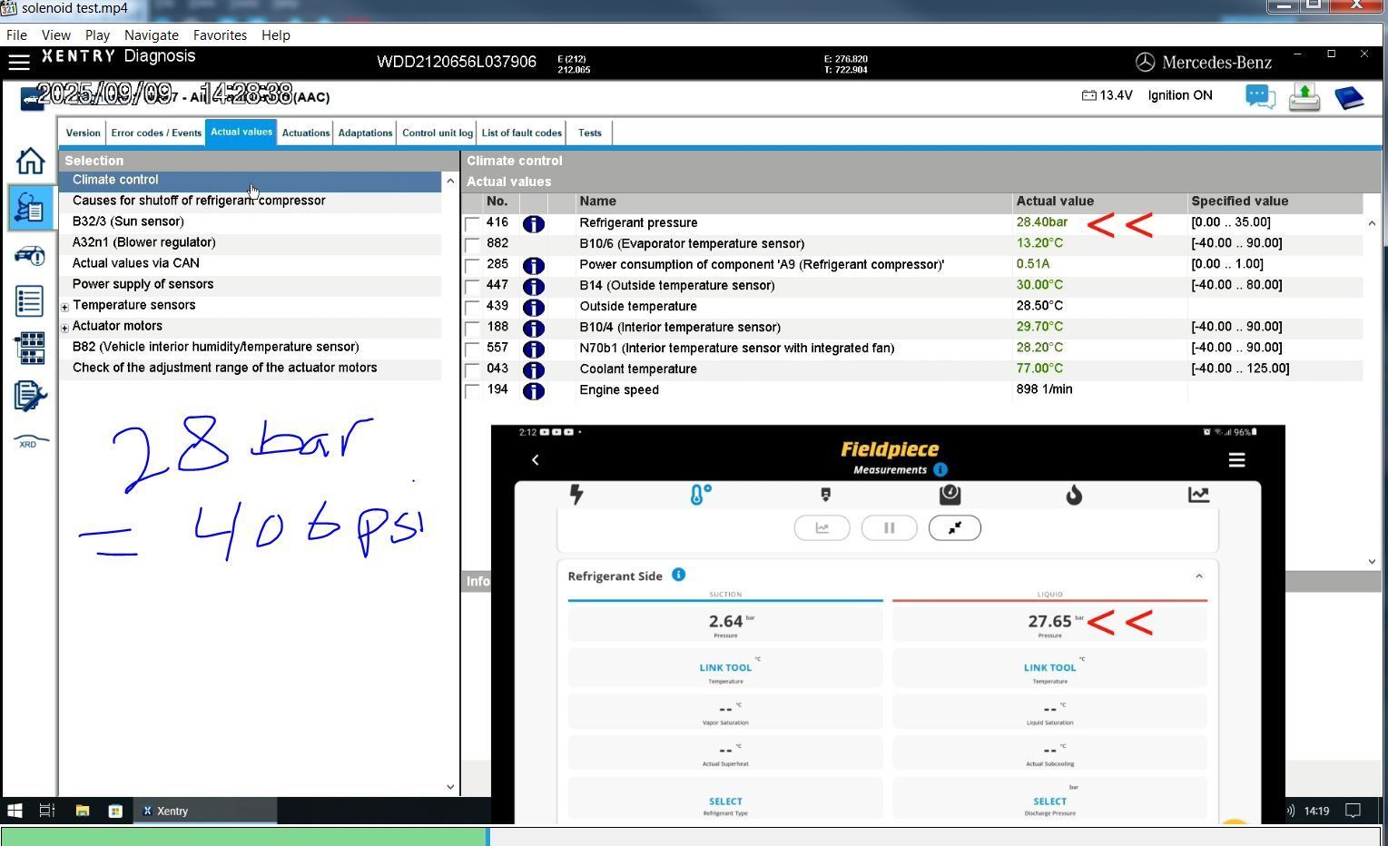

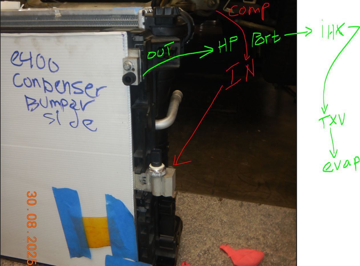

I was feeling hot, afterall today is 31.5C / 89F ambient temp and usual very humid close to 80%.

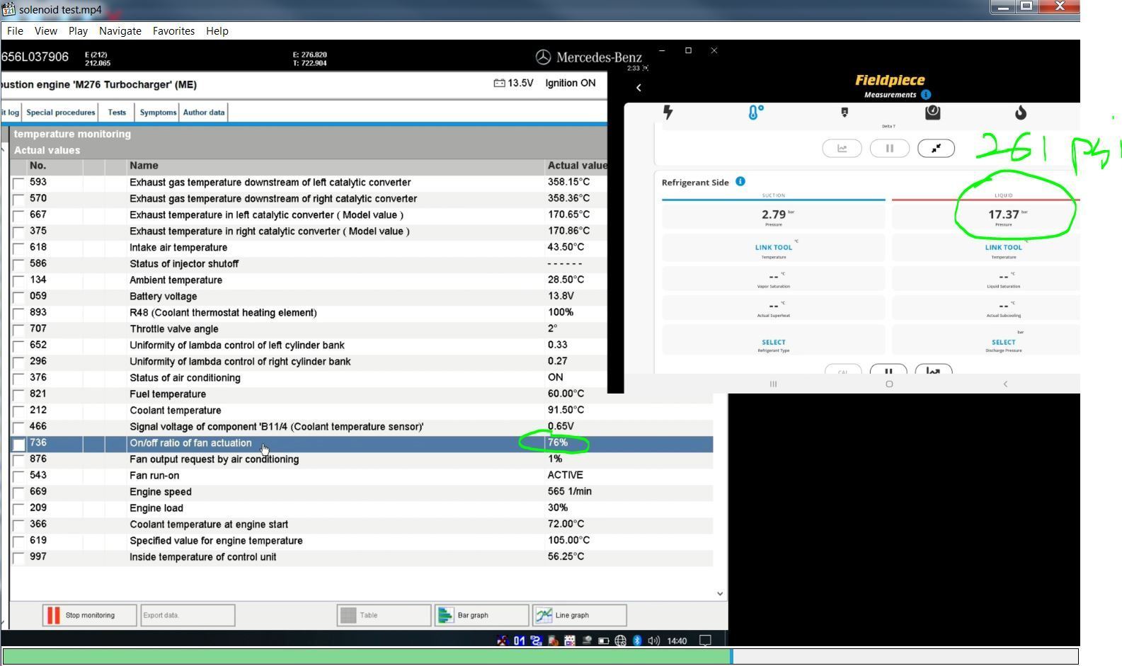

So while "polishing" the rotor-drum with the parking brake pad using tranny in D, I turned ON my car HVAC.

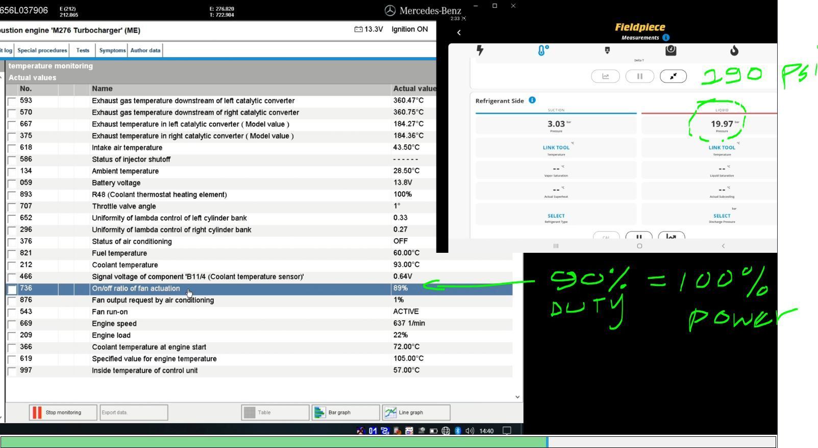

Within 2 minutes, the radiator fan goes to top speed...duggghhhhhh.
Damn, it must be high pressure of refrigerant, so I thought.....could it be my new R134A pressure sensor went bad on me ?
I got busy setting up Xentry and the Fieldpiece wireless pressure gauges. I need to compare car built in R134a pressure sensor vs the Fieldpiece to be sure.
22 BAR = 319 PSI , no way in hell my HVAC HP side ever get this high
15 BAR or 218 PSI is as high as it will get.
I tested again and I revved engine higher this time.
Sh-iet, what went wrong ?
I then looked at my photo archive to see the actual position of the car r134a sensor position, vs the HP service port as there is a second or two delay of
pressure rise between r134a sensor compared to the Fieldpiece gauge at HP service port.
I then realized dumb-azz me, I did not remove yet the plastic white board for condenser protection, as I am still not 100% done and will remove the bumper again
tomorrow .
So it was no airflow to the condenser.
I initially thought about it, but I just cleaned it well and all good and HVAC been oke for 4+ hours test and ride on Sunday and Monday whole day.
Man, with bumper installed, and in the evening .....the white board is not visible unless I shine a light to condenser hahahahah.
I learnt something out of this dumb-Azz-me, the radiator fan will go into 76% duty ( max is 90% duty as 100% power ) merely at close to 18 BAR R134A pressure or 261 PSI
Remember the Fieldpiece reads slower ( more downstream ) than the car's R134A sensor.
The last time I seen a CLS AMG 63 which I troubleshoot, its R134A sensor drifted so far, it was showing like 24BAR or 348 PSI and radiator fan went to top speed mode.
Now I know 20 BAR ( 290 PSI ) or even a bit less will make fan 100% power.
20 BAR or 290 PSI is 67.5C or 153F temperature of the R134A itself.
Good learning....................

S.Prihadi,
If I am reading your last post correctly, your whiteboard, protecting the evaporator, was left in for a test drive.
In your part of the world, you would not see, that in frigid climates, a radiator vest is used, to limit the cooling the engine is getting.
The most convenient versions are zipper equipped, to open and close the vest to varying amounts to match the relative frigidity.
In a manner of speaking, you reinvented the wheel, if in this case, the wheel is a radiator vest.

It was not a test drive on the road for the parking brake, it was dyno mode on Quick Jack in my garage.
I have some sort of LSD differential and I can apply decent parking brake pressure to bed the brake pads and both wheels can spin.
If standard open DIFF, I can't do this. I tried on my friend's W204.

The old parking brake pad on new machined surface, is not good.
Still noise at times ( dyno mode, on quick Jack, tranny in D ) and the new machined surface is adapting to the bad surface of the brake pad.
Above : The high spots of the old parking brake pad slowly ruining the new machined surface , not good.
So I bought a new brake pad, by Ridex. https://en.ridex.eu/product/8098379
Supplied components by Ridex.
Testing contact zone
Good, no high spot.
Garbage design, parking brake this drum style is. So crude. So imprecise.
The cable pull will produce the top brake pad to "expand" more like 60% than the lower one approx 40%.
After that we hope for the servo effect....which will need wheel to spin at least 120 degrees first before proper bite....the servo effect.
At this point in time, the RIGHT SIDE new parking brake pad need to bed down first.
Now its bite is not as good as LEFT SIDE , which I did not touch at all.
My parking brake adjustment where I deemed good is when :
AA. Full-maximum parking brake pedal click, it must be decently strong enough to hold the car while in D and with a bit of throttle like 1,500 RPM.
BB. 20 degrees slope, at 75% of maximum click should be enough.
CC.. Perform AA and BB , while the pad is very mild touch to drum surface when in standy-by mode.
My LEFT SIDE parking brake is already at this good state as above, the RIGHT SIDE will need time.

So, I shall close this thread.
No fuel leak, no oil leak, no coolant leak from radiator system and aftercooler.
Albeit I have not driven hard the car yet, I would think all went well.

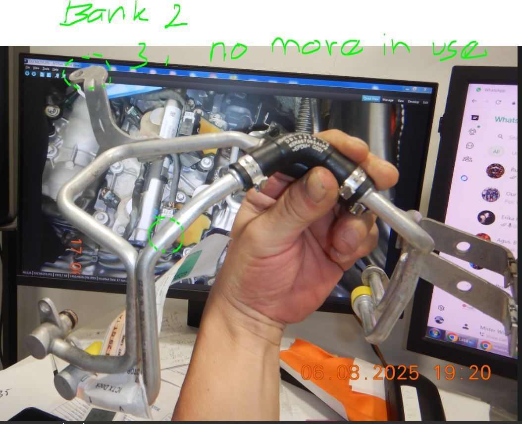

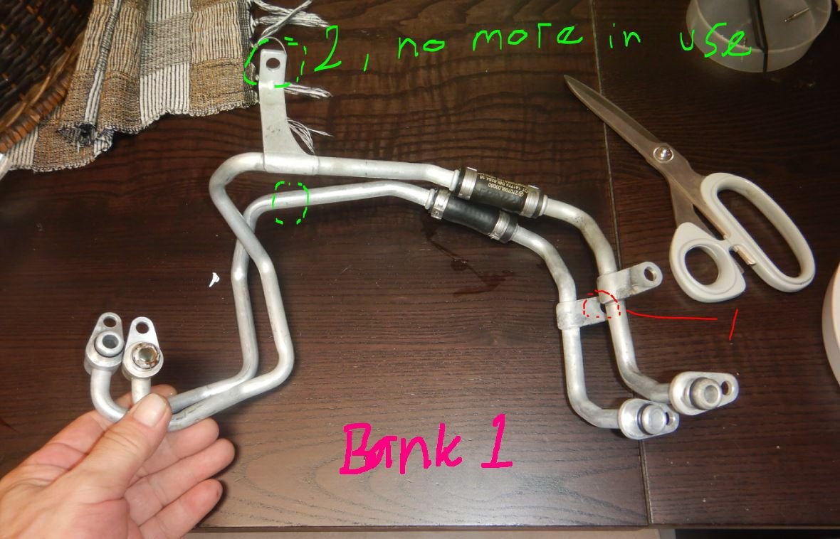

DID I MADE ANY "PROFIT" ON BOLTS ?
Yes I did, 3 pcs and took me some hours to figure out which region I forgot to bolt down ?
I found 1 location/bolt, its the coolant pipe for Bank 1 turbo from engine block to turbocharger, so this is input hose-pipe.
This coolant pipe has 1 L plate to extra secure the coolant pipe. Labeled as #1 in red. Installed it, done.
The two extra bolts #2 and #3 are because MB new hose-pipe set, removed the needs for extra 1 bolt mounting L plate.
The removed L plate or bolts are where the old pipe-hose sets uses cylinder head, near COP as extra mounting point.
So, all done, no profit made on bolts... LOL.
