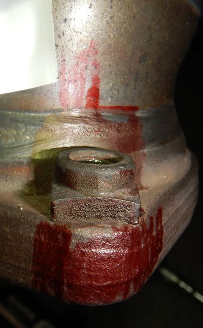

Is a thread chaser tool good enough for this mild repair ?
Gents,
I am machining 101 stupid, so need advice.

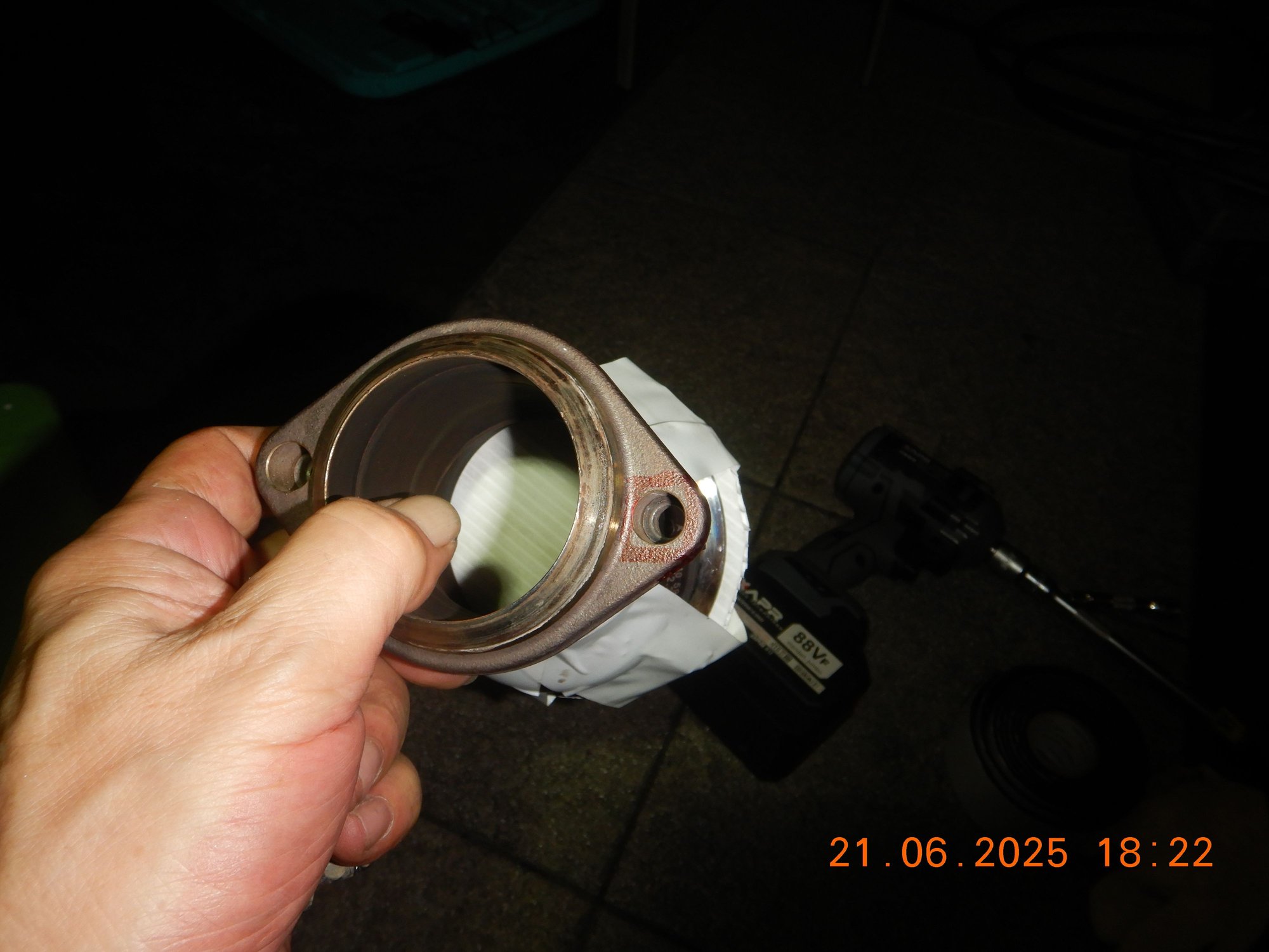

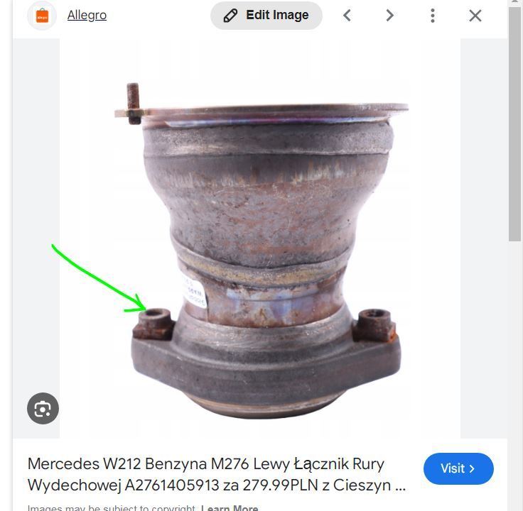

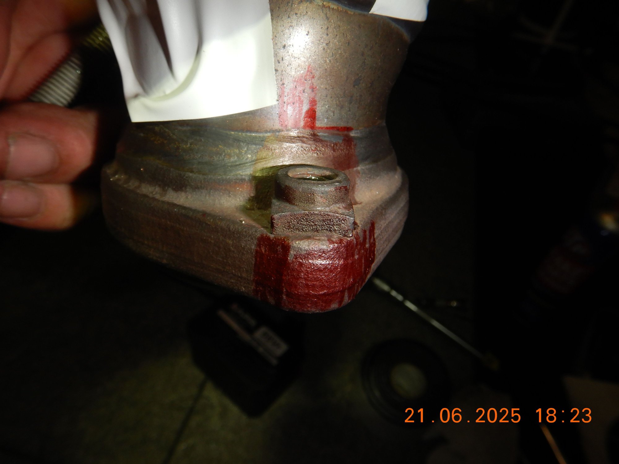

My LEFT side exhaust flange to turbocharger, had a bad female thread in its welded nut.

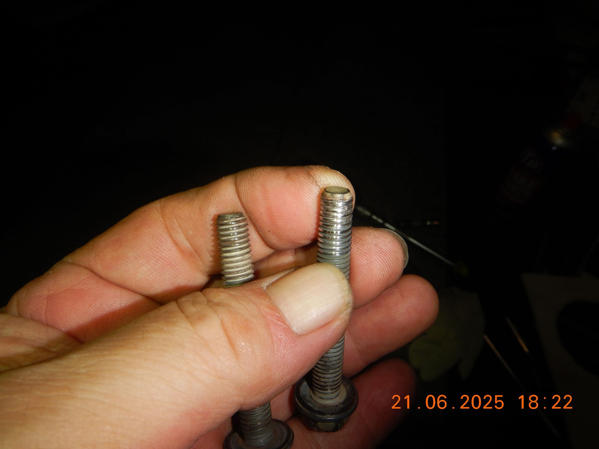

It is "eating" up bolt male thread and giving false torque value as such, 3-way-CAT flange is not mating and sealing properly yet, the torque wrench already clicking.
The tightening torque is not high, only 20Nm.
This is the part : It is a small piece between turbocharger and 3-way CAT.
Only one nut is bad. The one I marked red.
White plastic board is flange surface protection.
Right side bolt is the one being "eaten" by the female nut.
The material used for the baby sized exhaust intermediate flange is very very good.
This baby sized exhaust intermediate flange to exhaust 3-way CAT does not use gasket.
It is like how JIC fitting works. Cone/conver meet concave. High precision metal to metal contact only.

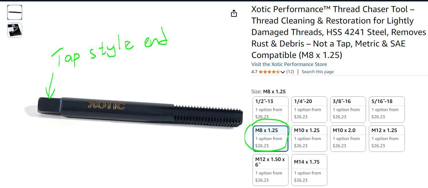

I can't get thread chaser tool locally. The available one is thread making and repair with insert.
So I have to import from Amazon USA, 4th July it is supposed to arrive in Indonesia.
I bought this one M8 1.25mm pitch
Amazon Amazon
I do not know if this is good enough to make my nut female thread good again ?

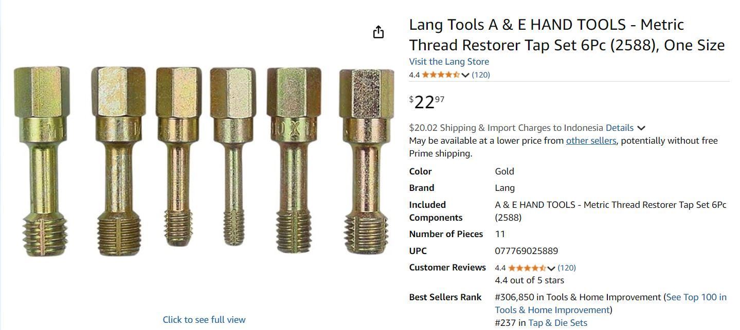

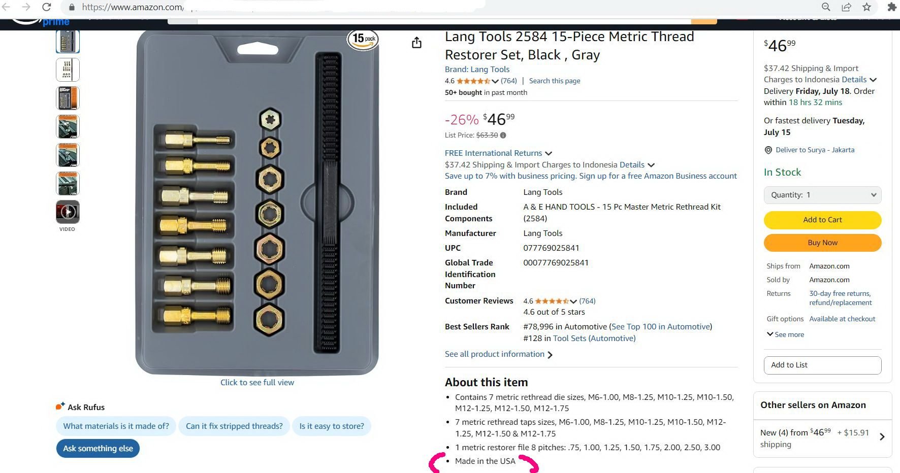

China made so it seems and US made ones like Lang also seems to have quality decline.
Any advice appreciated.
Thanks

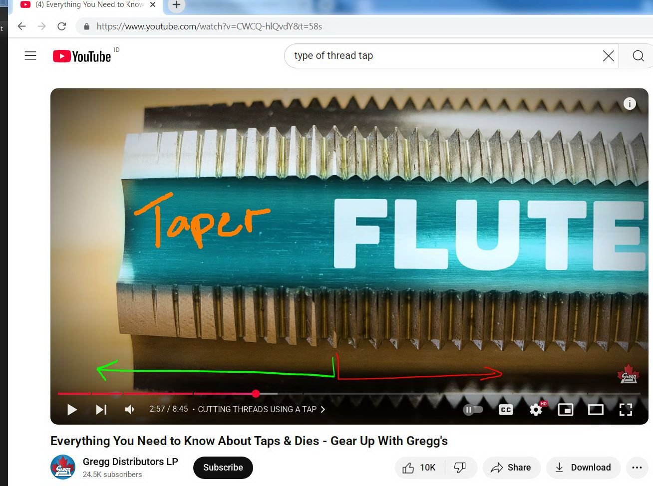

Editing to add it doesn’t look like the tool you have is tapered like a traditional tap and I think a tapered tap might make it easier to line everything up. Don’t forget to use some sort of oil or grease depending if you wanna capture the shavings.

Is it dirty with crud, or is the metal distorted? If the former, file a sacrificial bolt to a taper, and then file a notch perpendicular to the threads. Run that down, and it'll clean out all the gunk. If the threads in the flange are damaged, you'll have to reform them. A tap will be the answer, but you're going to want to make sure you get a high quality one. Cheap taps will make the whole thing loose. If the threads are clean, there should be no cutting until you get to the damaged section. Depending on the type of tap you get, it'll either cut through the obstruction, or sort of fold it back where it was supposed to be. Which type you want depends on the damage.

I think the thread on the damaged nut should clean well with a thread chaser. You might need a new bolt however.
When I removed those bolts to try to replace the engine mounts (I only tried as I was unable to disconnect the LH side O2 probes...) I've reassembled them with some Permatex’s Anti-Seize Lubricant to help the
threads not get damaged as they were pretty tight.

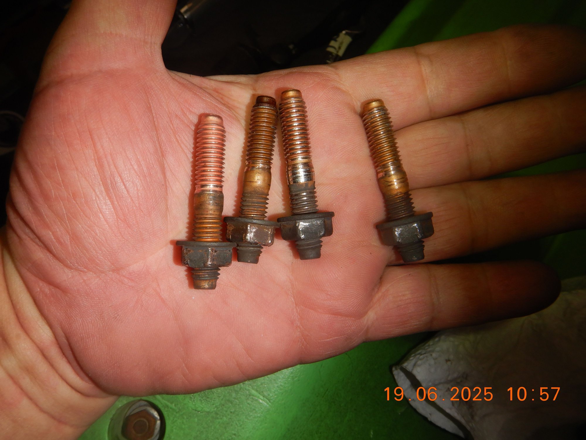

try what you bought.
Better to use actual tap with taper on front.
No need for bottom tap or such.
Use cutting oil and go easy back and forth working your way until straight part of tap extends past last nut thread.
My guess is from the high heat the nut warped and is not round anymore kinda egg shape like a Mechanical lock nut. (Class 10 DIN 6927 Top Lock Flange Nut)
which makes for difficult re-use but side effect is that bolt will not loosen on its own.

Wow, I did not know there is such a unique lock nut .
The nut probably warped due to heat like how the LEFT ( removed ) exhaust stud has the nut stuck on it and I ended up pulling the stud. Below :
On that baby exhaust flange in discussion , a new bolt when used on the damaged nut .............is already semi frozen by 1st thread.
When new stud and nut arrived for exhaust manifold aka turbo, I will play with it and see how bad is the seizing, is it similiar the exhaust flange nut ?

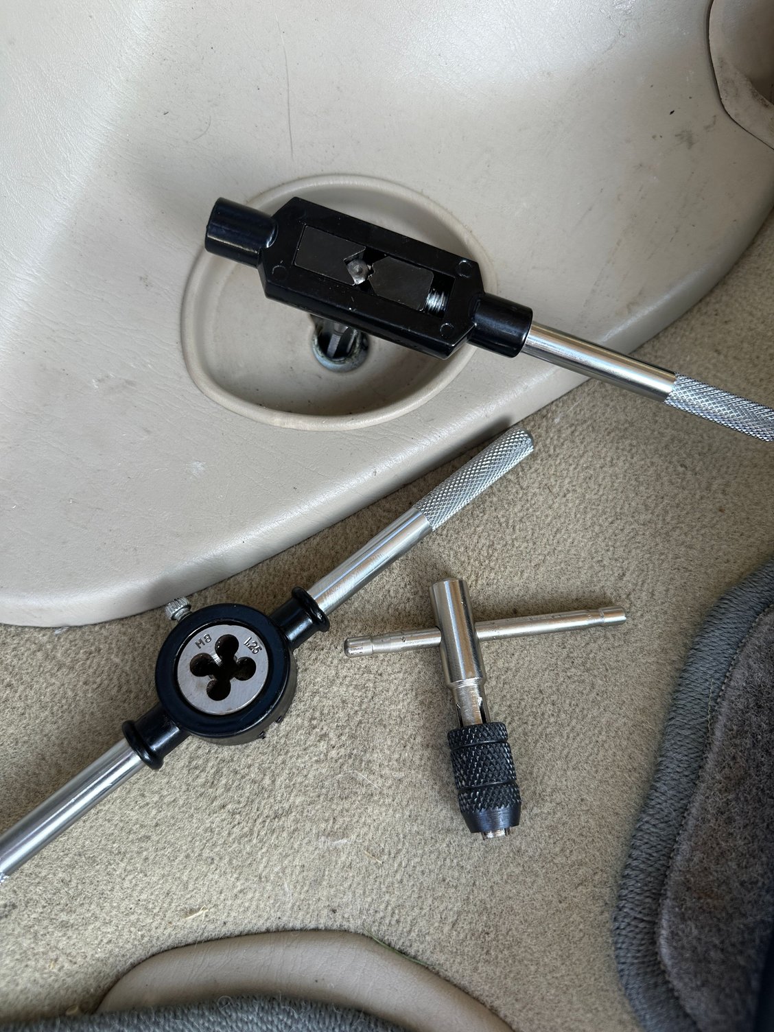

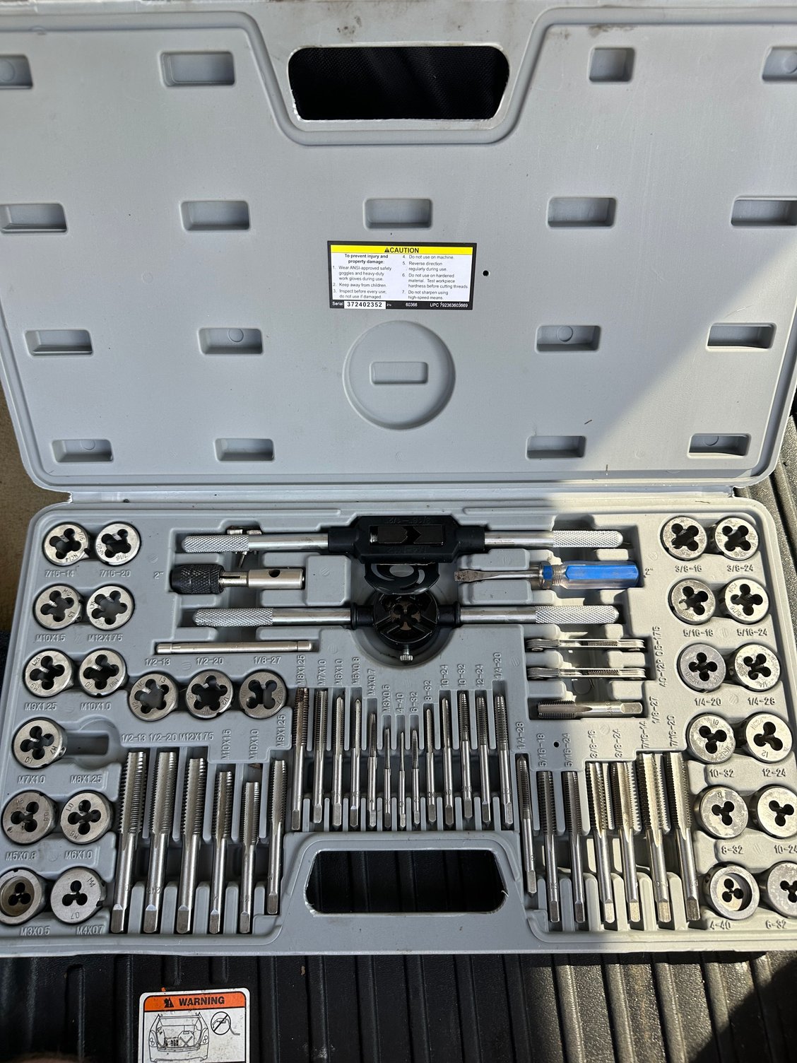

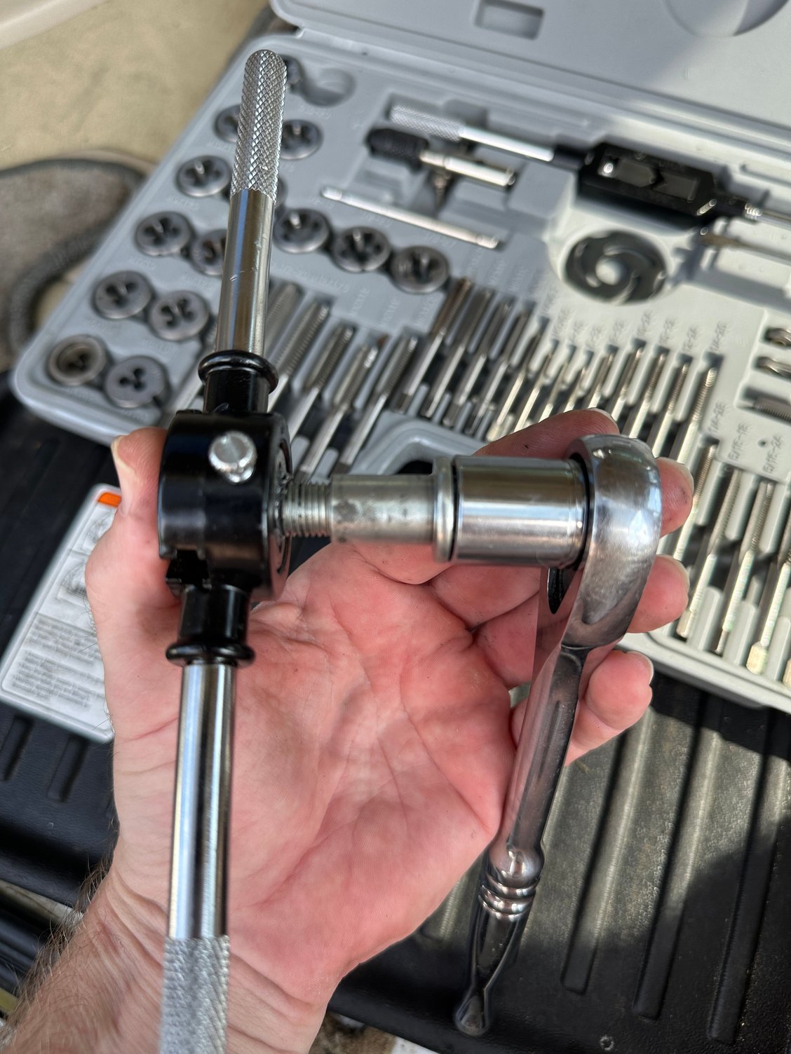

I blame you. Refoamed an old subwoofer and replaced some trim in my lx that required the rear interior to be removed.
Doh.
Doh. Seatbelt anchor bolt.
Harbor freight purchase from years ago
Harbor Freight purchase from years ago
Something for everyone
Tools of the trade
Tools of the trade
Chasin the thread
Chasin the thread
Nope nothing wrong here, please move along

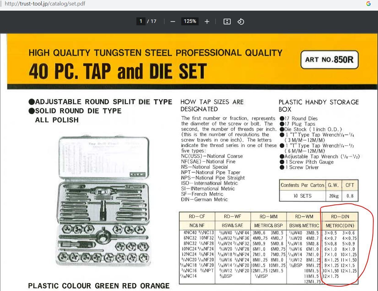

Yipeee, I got a good Japanese made Tap n Die, metric only. by SKC
I will need the M8 x 1.25mm pitch.
US$90 approx with sales tax. Will arrive in 4 days ish and probably the same for the Amazon thread chaser, and I would still be in Bali then.
This SKC company is so old fashion, look at its website ...LOL
http://www.skc-taps.com/english/

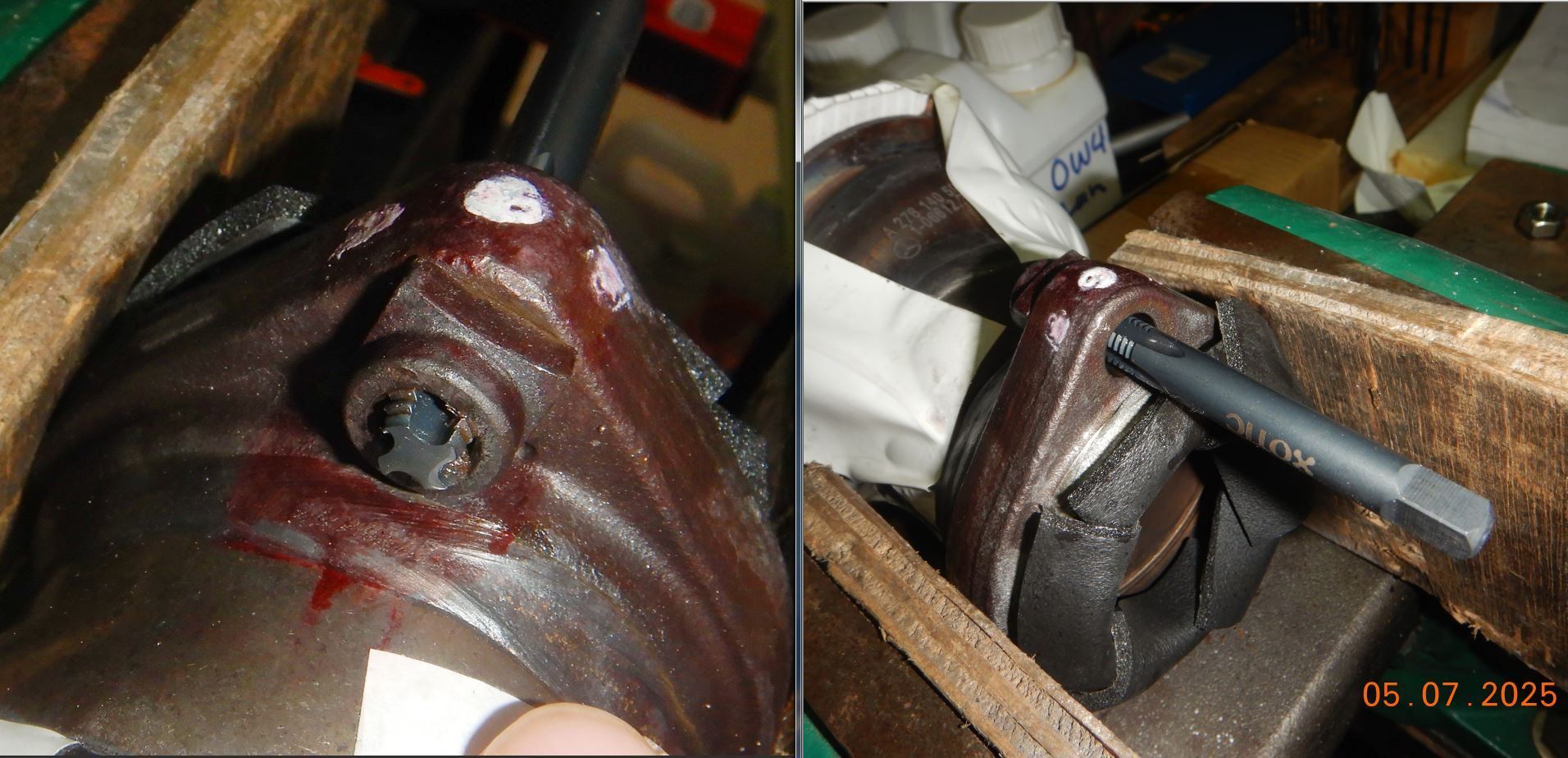

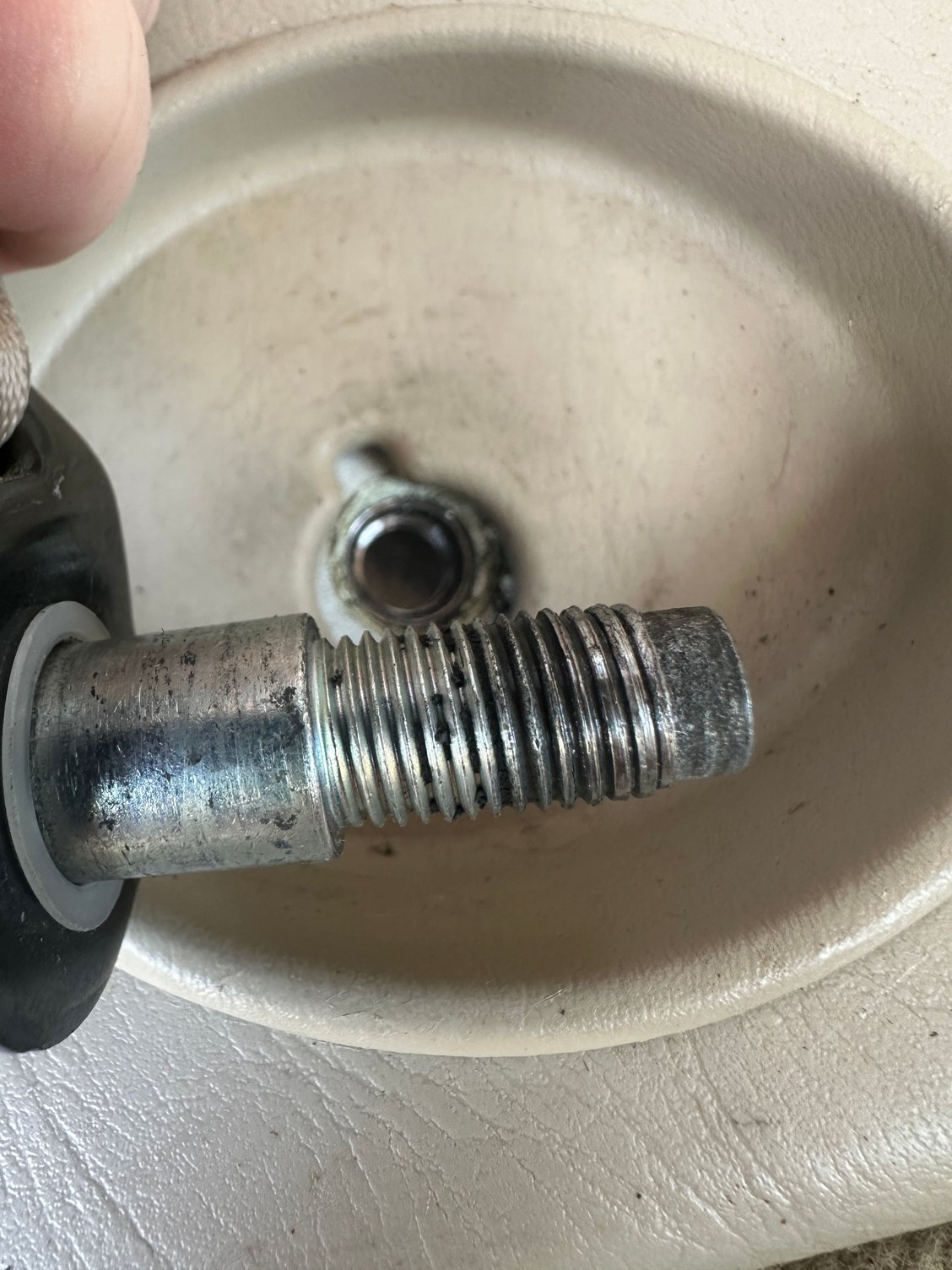

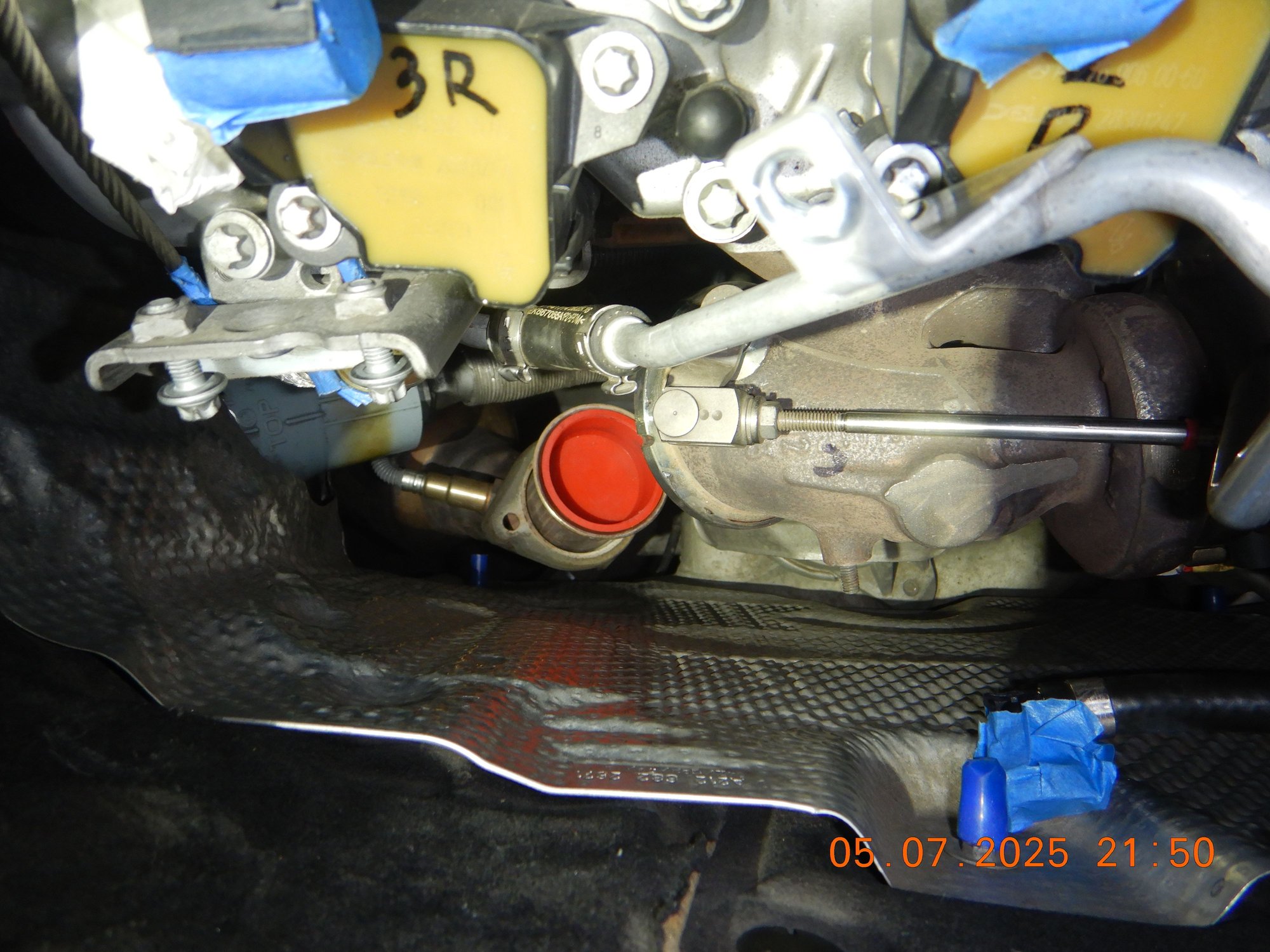

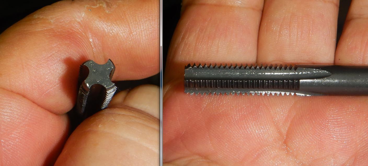

Okey dokey, I am back in Jakarta and the so called Thread Chaser tool from Amazon USA already waiting for me........

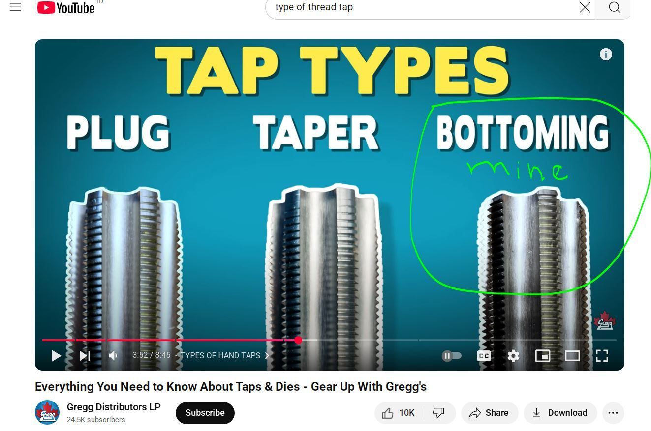

I think the description of this tool being a thread chaser is not too accurate. Thread restoration chaser would be more suitable.
It works VERY well, but I am technically curious. It is more like a Bottom Type Tap
Very very tiny bit metal cleaned at the female nut. So the Xotic thread chaser tool is not too offensive.

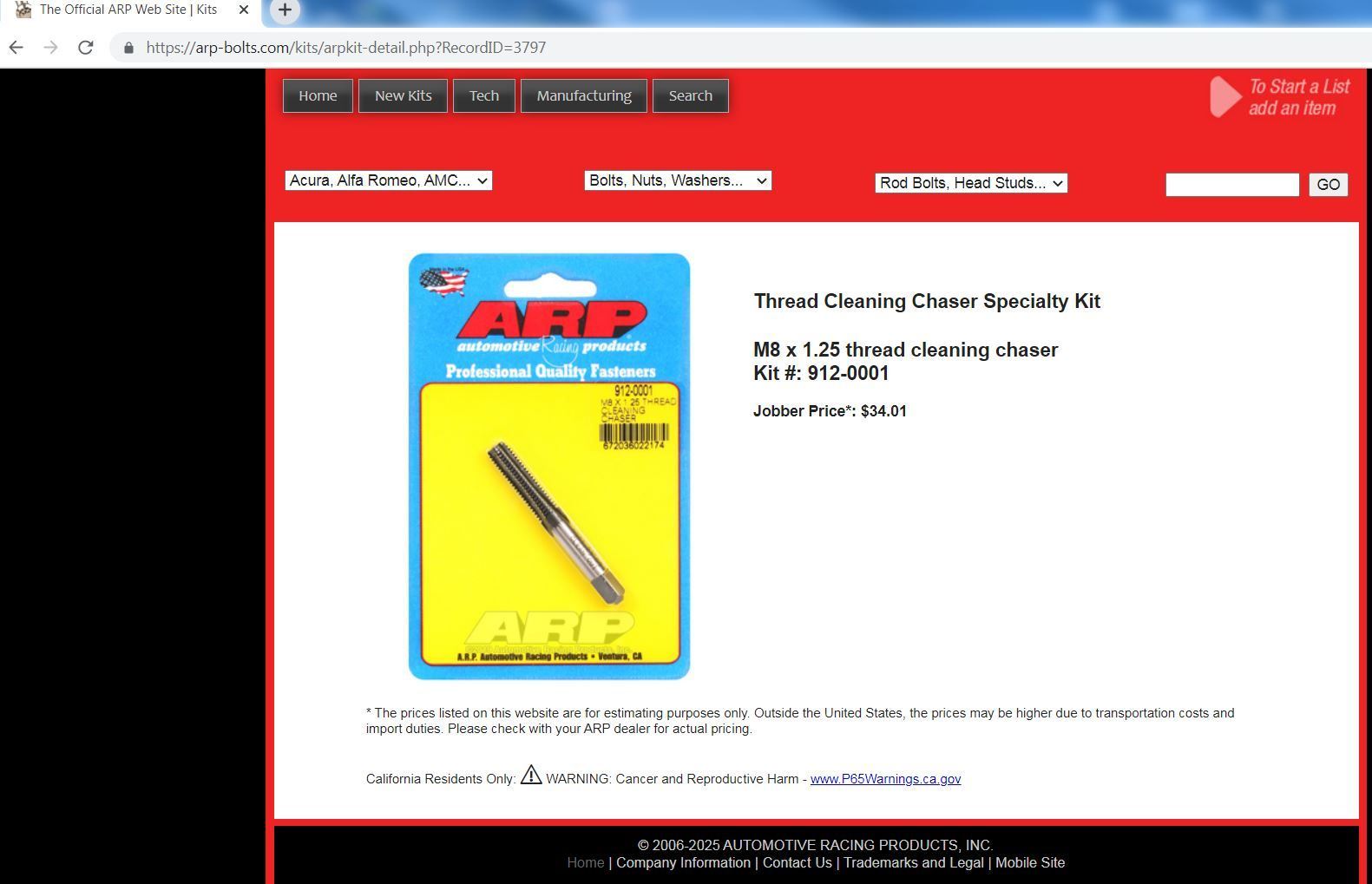

I thought thread chaser woul and should look like below :
But there is another brand which their thread chaser is similar to tap tool, like my Xotic brand.
https://arp-bolts.com/kits/product.php?PL=61
I failed to get the Japanese made Tap n Die Set by SKC.
The selling company ( Japanese ) emailed me yesterday that stock not available...dugghh.
So I choosen a branded Chinese one instead, DAMN !!!
At least branded and not some unknown no brand product.
I chose this alternative brand :
Their website : https://www.maxpower-tool.com/cuttin...w-tap-set.html

So I bought the Lang brand, supposedly still USA Made, metric only thread chaser kit.
I hope today it is still made in USA. 18 July 2025 it will arrive.
I removed RIGHT side Bank 1 exhaust flange last nite and inspected its female thread.
So this is what happen to these turbos flange.

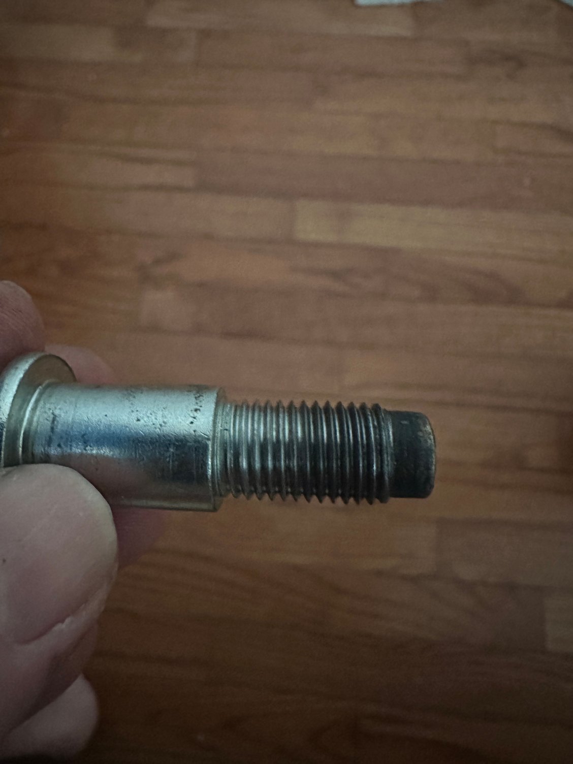

01. Due to heat, the locked ( not welded ) female nut thread gets kinda "rough". It is not rusty rough. I do not know how to explain it.
One thing for sure, you can never use your fingers alone to screw in the bolt all the way in, you need to use tool......
02. I believe the female nut is of better material than the bolt, thus bolt always lost/damaged.
03. The bolt itself will develop some sort of grey-whitish coating from the heat of service :
See the two top bolts ( from Right side, Bank 1 flange )
3rd bolt from top, with 5-6 damaged male threads, it belongs to the LEFT side Bank 2 turbo exhaust flange and the reason this repair-investigation took place.
This grey-whitishy coating adds thickness to the thread pitch/diameter, making hand screwing not possible.
If I cleaned off the grey-whitish coating using brass brush and WD-40 equivalent, it will go away, not all but it will smooth the thread.
So I chased all 4 nut female thread on my turbo exhaust flange. 4 new bolts coming soon.
For RIGHT side Bank 1, I left one female thread on purpose to be not totally "chased".
I want to see what will be the difference between fully "chased" female thread and not fully chased one, by next 10,000KM of heat abuse or so.
Fully chased female thread will allow a bolt to be hand screwed easy and all the way 100% penetration. Damn sound so kinky
A not fully chased female thread will need a tool to assist the bolt insertion, but at less than 1 Nm of force, just slight resistance, that is all.
These 4 bolts on LEFT and RIGHT turbo exhaust flange had been removed at least 3 times since 2014.
Twice is for replacement of both engine mounts in 2018 and 2022 or so.
3rd one is for replacement of propeller shaft middle bearing and rubber boot.
By 3rd removal the bolts I renewed, I was suspecting the bolt was the problem and never thought it was the female thread at the nut.
So now I know what to expect from these nut's female thread distortion overtime with use/heat.
I will be watching them from now on, simply by gauging the effort to screw in a new bolt, that simple.

Originally Posted by JettaRed
I recently used this kit to "correct" the caliper hole while working on the rear brakes of my 2000 Ford F-150. (Crazy that that truck uses both metric and SAE sizes throughout.)
https://a.co/d/iAcyd5v
These sets are easier to use with a socket wrench so it does make them easier use in many situations. Ive never had a set like pictured above as I find I need a bit more depth and personally like the tapered edge of a tap for alignment of the initial threads. Regardless, all of these tools are excellent to have because bad threads stop the repair process. I clean every exterior thread and bolt I touch on one of the older land cruisers I help maintain that has rust. I think I broke something like five bolts in the frame last time I did a bigger resto job on the subfame and rear crossmembers. I had to drill each one out and then retap. Having the tools on hand made it so I didnt curse...too much.
Op, glad you got this figured out without much fuss.

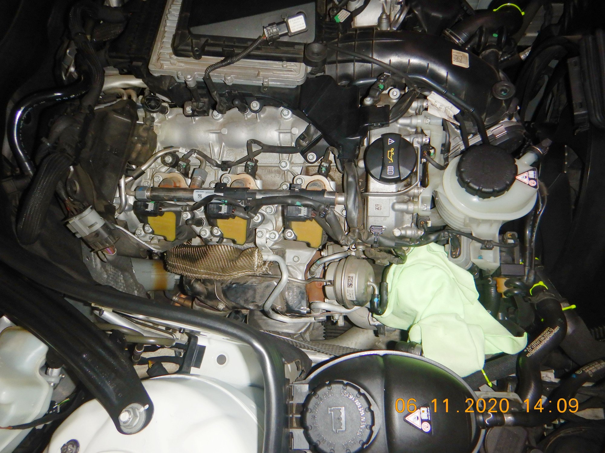

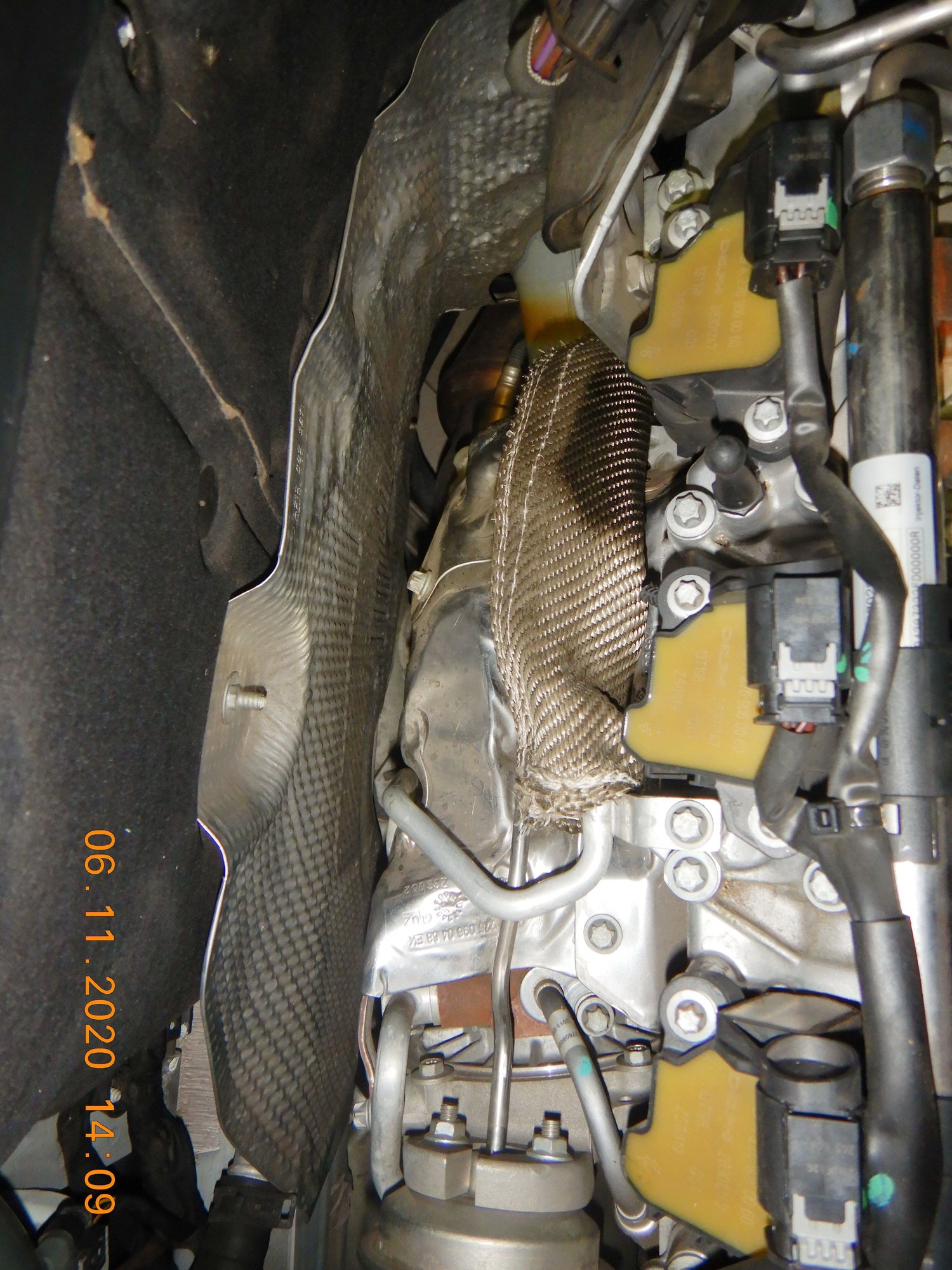

Without heat shield of turbo, we get better access. Thus heat shield, 3 pcs, must be first removed.
But coolant pipe-hose ( IN and OUT ) must first be disconnected from turbo if heat shield is to be removed...no fun.
The bronzy heat shield cloth/fiberglass is my own add-on.
