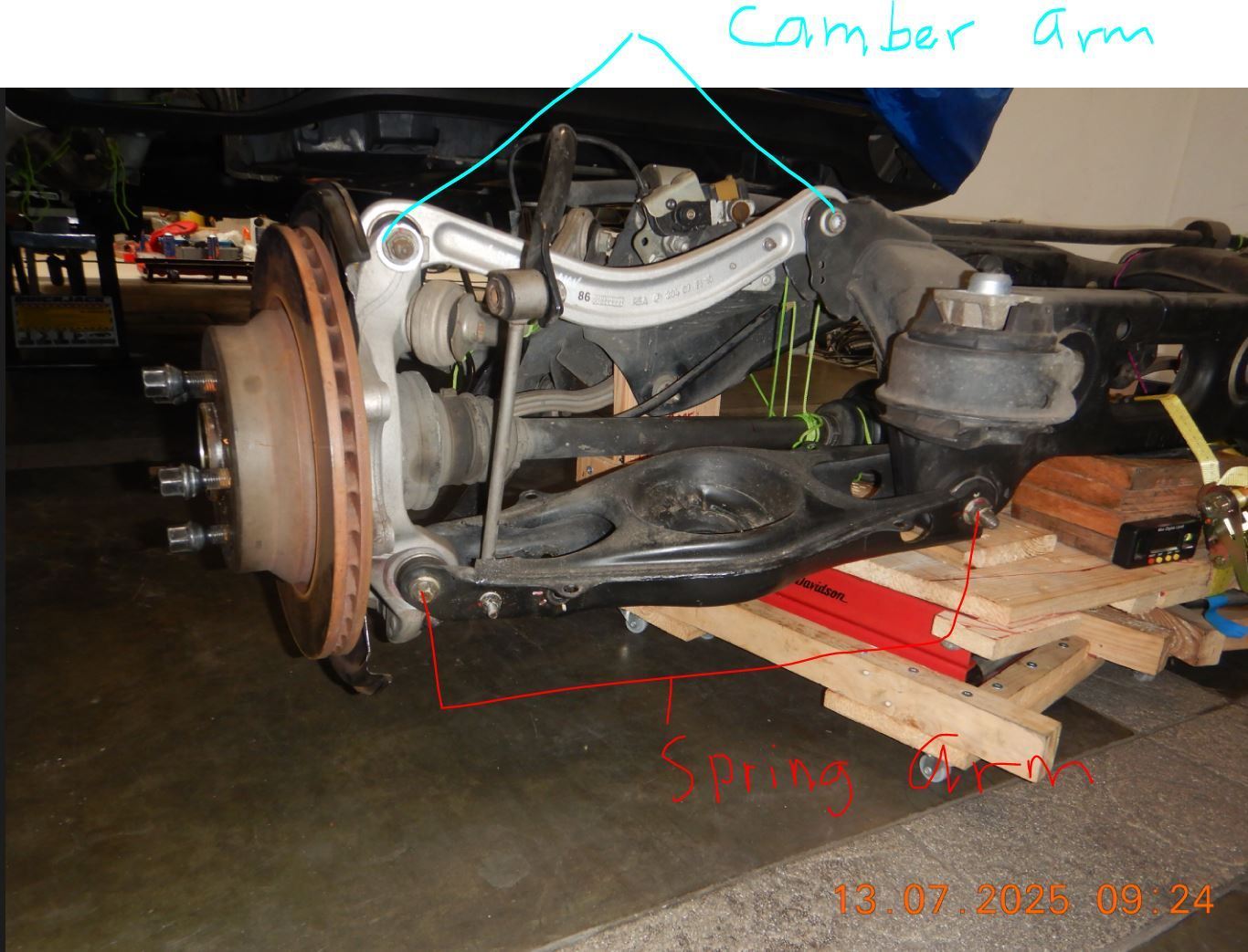

Thank you all for the great info and K-Mac feedback based on your experience.
@K-Mac, I sent an email to you @ sales@k-mac.com on Monday a little past 3PM your time. Not sure if you got it but I can’t msg you through the site because the admins said I haven’t posted enough to unlock that feature.
I’ve got a 2016 E63S 4MATIC that has extreme tire wear issues. I’ve had the inner edge tire wear on front & rear tires. Replaced tires several times in the 2.5 years I’ve had the car and had a blow out once already. Currently have a small hole and extreme inner wear on the right front tire leaking air again.
I looked @ the catalog but wanted to confirm exactly what parts are needed to fix this issue for the front & rear. Thanks!
Old Jul 14, 2025 | 03:03 AM
K-Mac's Avatar
SPONSOR
Joined: Apr 2013
Posts: 1,700
Likes: 177
Mercedes-Benz CLK 550
Just spotted your input !
On checking see yes did respond direct to your personal email address of Monday the 7th.
Pointing out 2009 to 2016 E63 AMG ‘4MATIC’
Front kit (Camber & Caster) P/N 503716M $595
Rear kit (Camber & Extra Toe) P/N 502126K $480.
Both can fit without special tools or need for control arm removal.
Both provide up to 2 extra degrees Positive or Negative adjustment.
Precise easily accessible single wrench adjustable.
sales@k-mac.com ….web: www.k-mac.com ….1888 847 9099 (Sales Tech 24/7)

As we have you here, what would be the parts to correct rear Camber on a 2012 S550?
I looked at your catalog once and it is so complicated/unclear I cannot be sure what to order.

Yes K-MAC Mercedes Benz Catalog contains close on 150 P/N’s covering virtually every model front and rear 1968 to 2025 !!!
Re 2012 S550 (W221)
Rear Camber and Extra Toe adjuster kit #502626-1K $480.
Front Camber (only) #502316-1i $345.
Front Camber & Caster #502316M $595.
NOTE: All K-MAC front and rear kits especially designed so no special tools or need for time consuming control arm removal to install !
Replacing at the same time the 4 front and rear highest wearing bushings.
Up to 2 degrees extra Pos. or Neg. Easily accessible precise single wrench adjustable.
AUDI to VOLVO - K-MAC Experience Of Resolving OEM Suspension Shortcomings (and Costs) Since 1964 !

sorry for the late reply K-MAC. Thank you for the info & confirming. A few additional questions:
1. Are the parts 503716M & 502126K in stock and ready to ship within the U.S.?
2. Is there a discount or special pricing for MBWorld.org members?

1) Yes 503716M & 502126K in stock which means DHL Express air would receive by Friday next !
2) DISCOUNT / PRICING - Current promotion is DHL air Express delivery worldwide $40 one kit $20 each extra.
Also (with constant / ongoing R&D) have now included bush extraction / insertion tools. Eliminating need for special tools - or time consuming control arm removal !

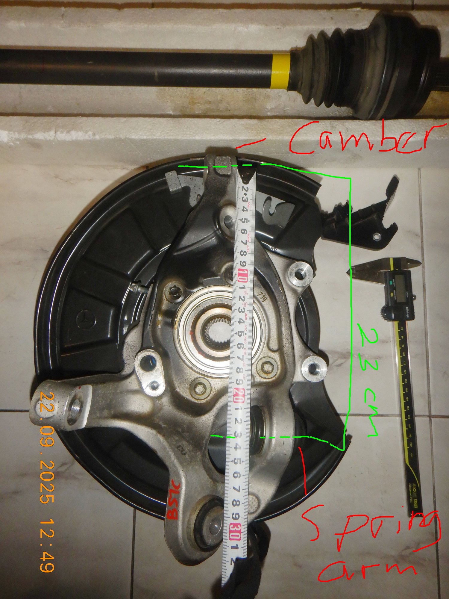

K-Mac are you able to send me the directions for 503716M & 502126K?
I finally found a local mechanic and they’re asking me to share the install directions of the kits to see what’s involved and provide a labor estimate before they commit to the job.

CPG,
To not confuse your workshop, tell them this :
01. FOR REAR CAMBER ADJUSTABLE K-MAC BUSHING
K-Mac rear camber kit, manipulate the SPRING ARM bushing at the subframe and not the true camber arm of the suspension system.
If your workshop relies on MB WIS, he will try to find Camber Arm.
This is the spring arm bushing at subframe. The other bushing for spring arm is at the wheel carrier/knuckle and is a special ball joint type bushing.
Spring arm bushing at wheel carrier/knuckle
The top part is the Camber Arm mounting spot at wheel carrier/knuckle, where both bushings for Camber Arm are built into the camber arm itself.
With this information, your workshop will charge you for Spring Arm works and not Camber Arm works.
Your workshop will also charge your for pressing out the old bushing of SPRING ARM at subframe and install new K-Mac bushing there.
If you install the K-Mac toe-arm busing, which is at the arm itself, your workshop will charge you the removal of toe-arm and remove/install toe arm bushing subframe side, which is the adjustable side.
This is the toe-arm also called tie-rod or track rod
See the broken arm below right bottom corner, that is the toe-arm/tie-rod and the subframe is UPSIDE DOWN.
Usually when one speak of adjustable camber feature for MB rear suspension, it is the camber arm itself which is adjustable. Like below :
Let us know how much they charge you for the labor . I am curious.
Good luck....
