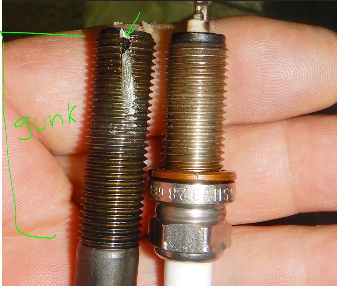

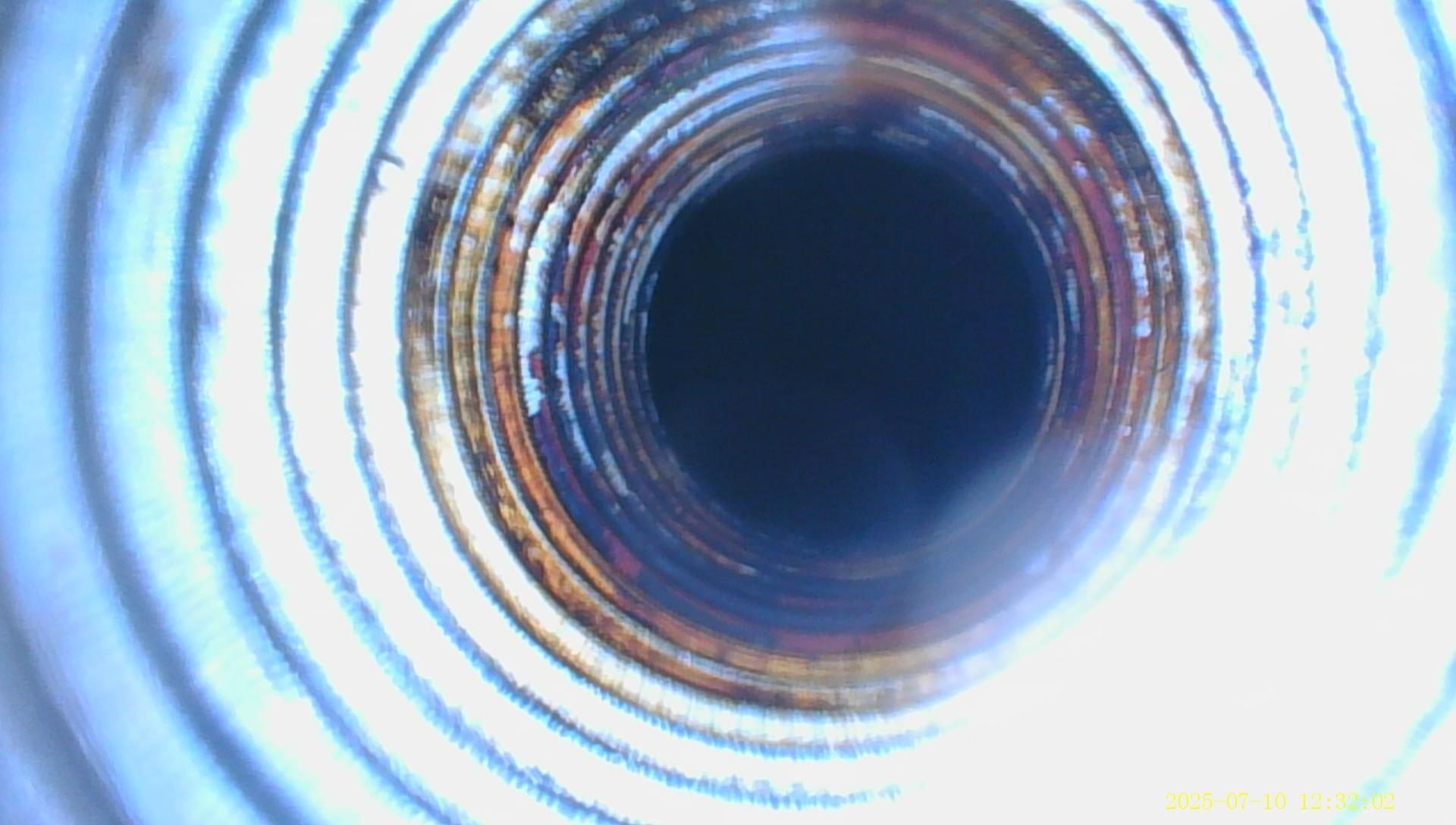

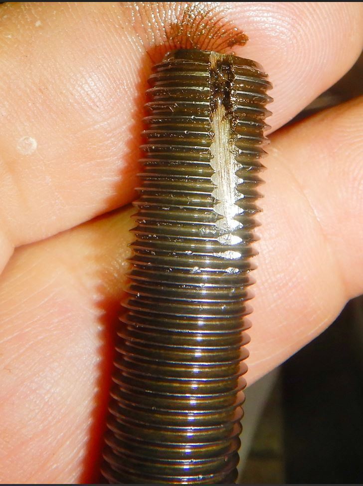

Now that I know how thread chaser works, I DIY one myself.
M276 engine spark plug.

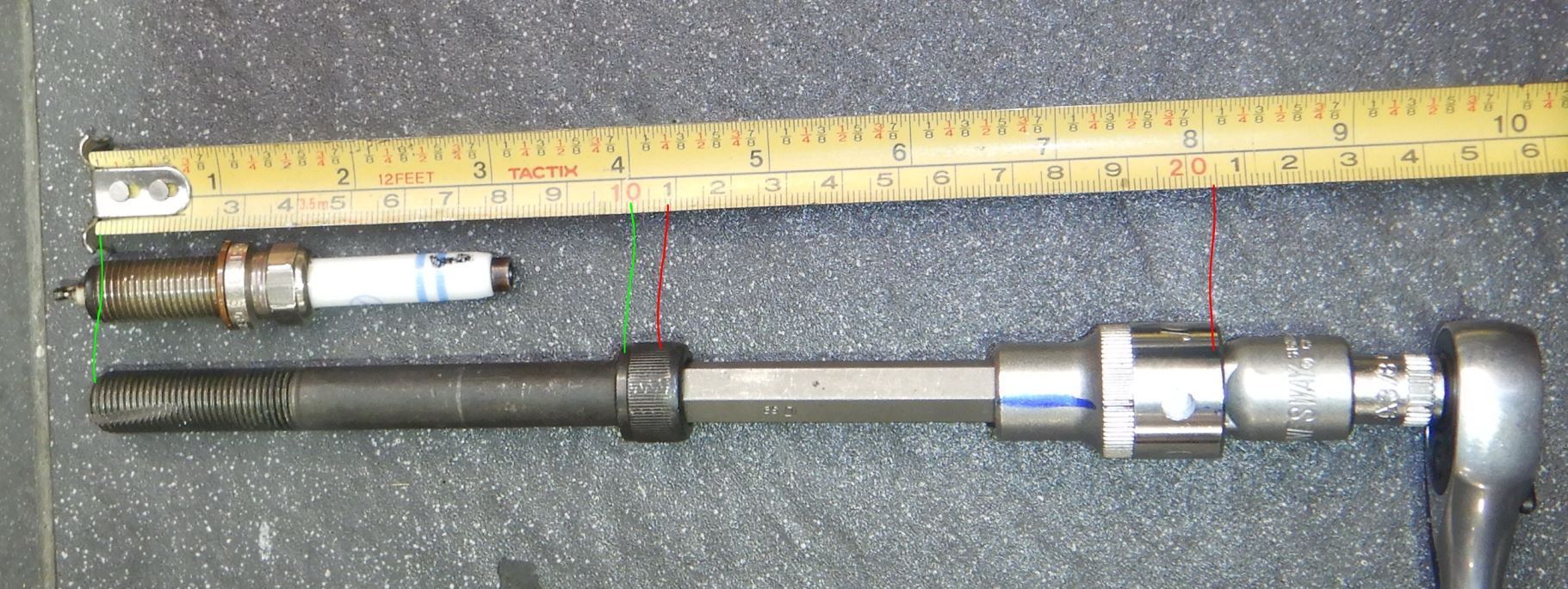

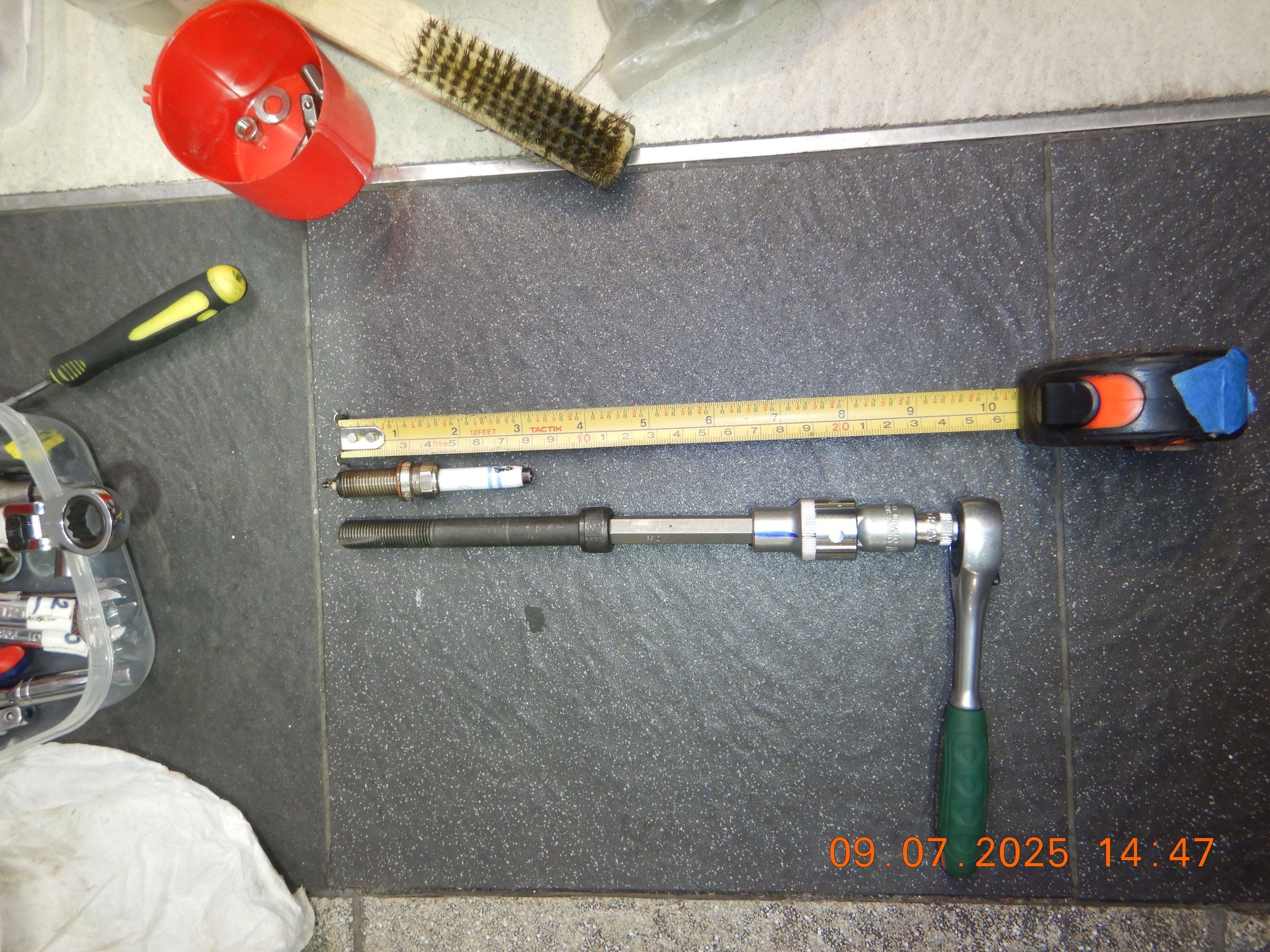

M12 x 1.25mm pitch is what you need. Minimum length 10cm of Allan bolt type, dont exceed 15cm.
Thread count minimum 25 or more.

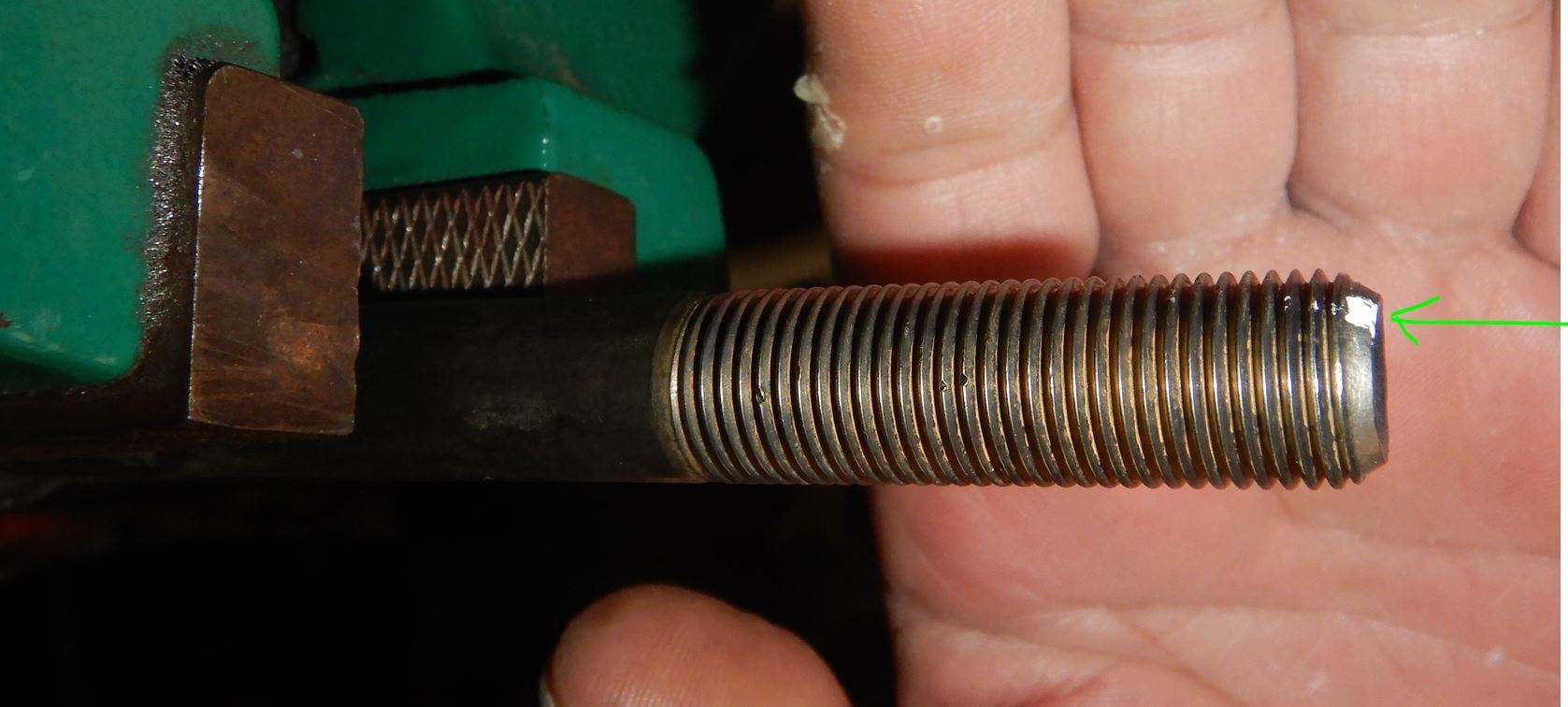

White dot is where the thread starts, thus I dare not touch that area.
Opposite to white dot is the dirt collector channel.
All job is finger powered only, no power tools allowed. Must feel the dirt resistance. In fact I do not use the rachet unless I am hitting "dirty" spot.
Run the chaser 4 times, slowly collecting dirt.

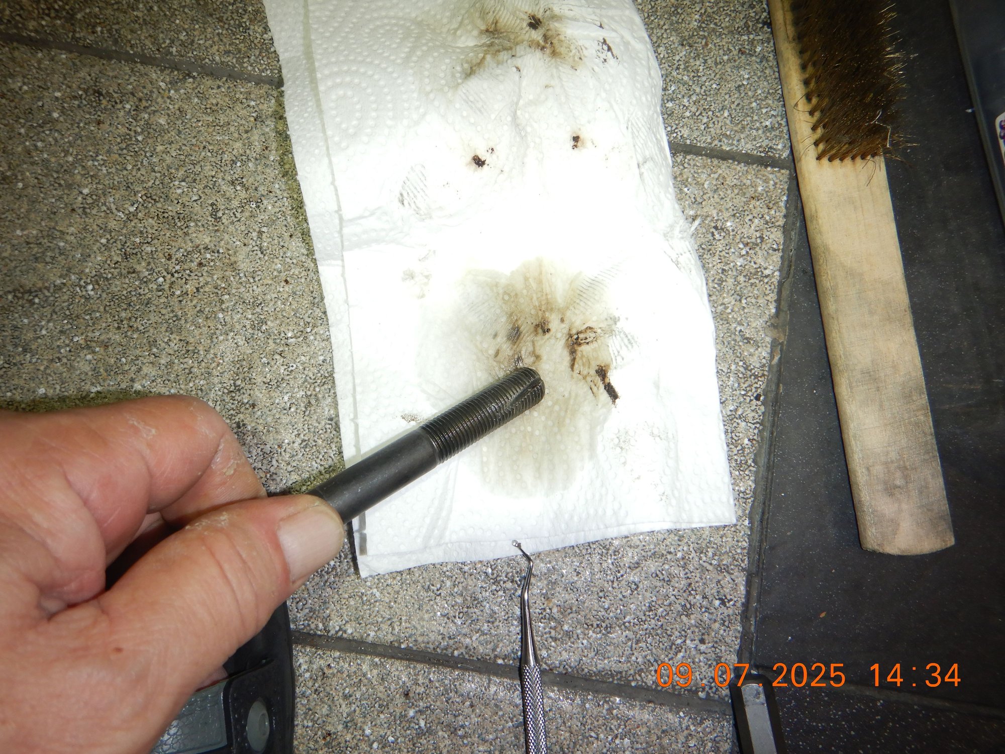

I use BG cleaner chemical and wet the chaser male thread, otherwise the gunk will not come off easily.

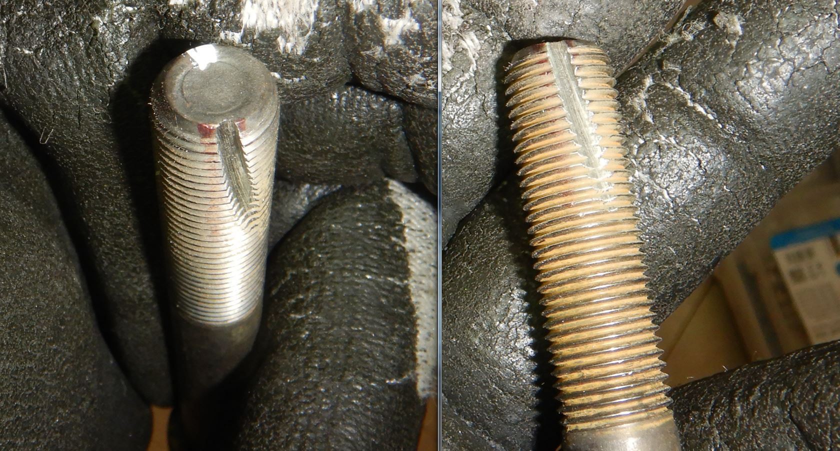

1st chaser run
1st chaser run
2nd chaser run
2nd chaser run

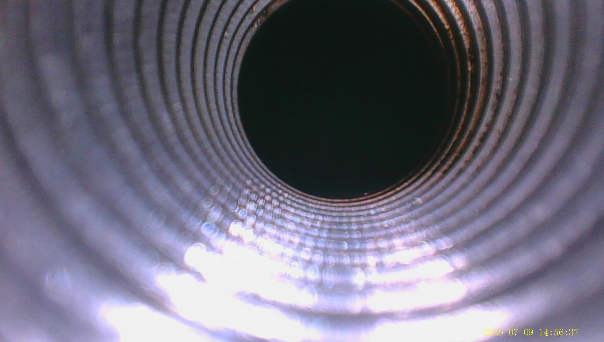

Inspect female thread after each and every chaser run.
Not bad the result...........
Other cylinders.
Before cleaning
AFTER CLEANING
Will continue...................

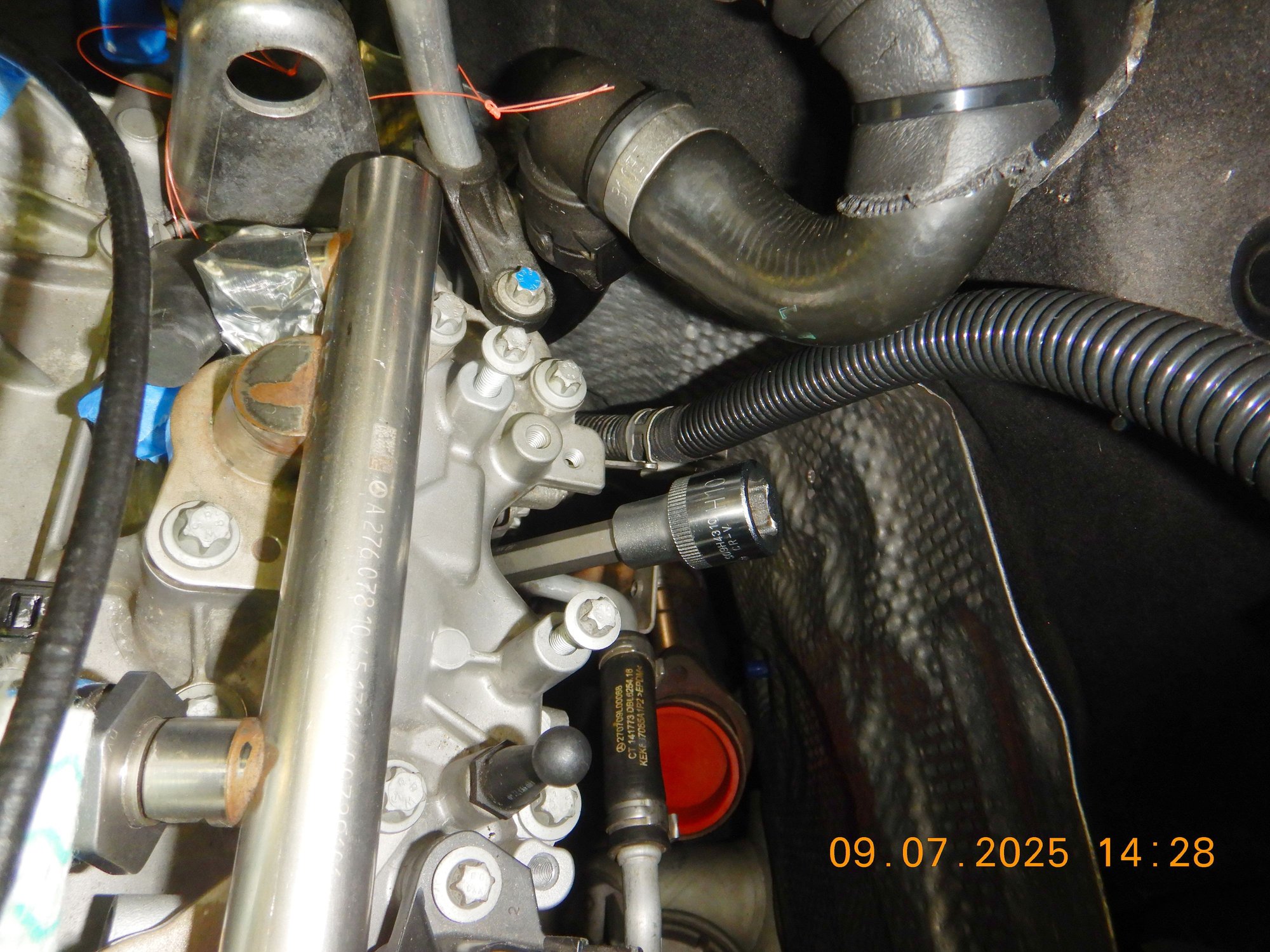

10CM allan bolt M12 is just nice in length to work on worst tight space of cylinder 6.
Enough clearance
Enjoy your cleaning .............

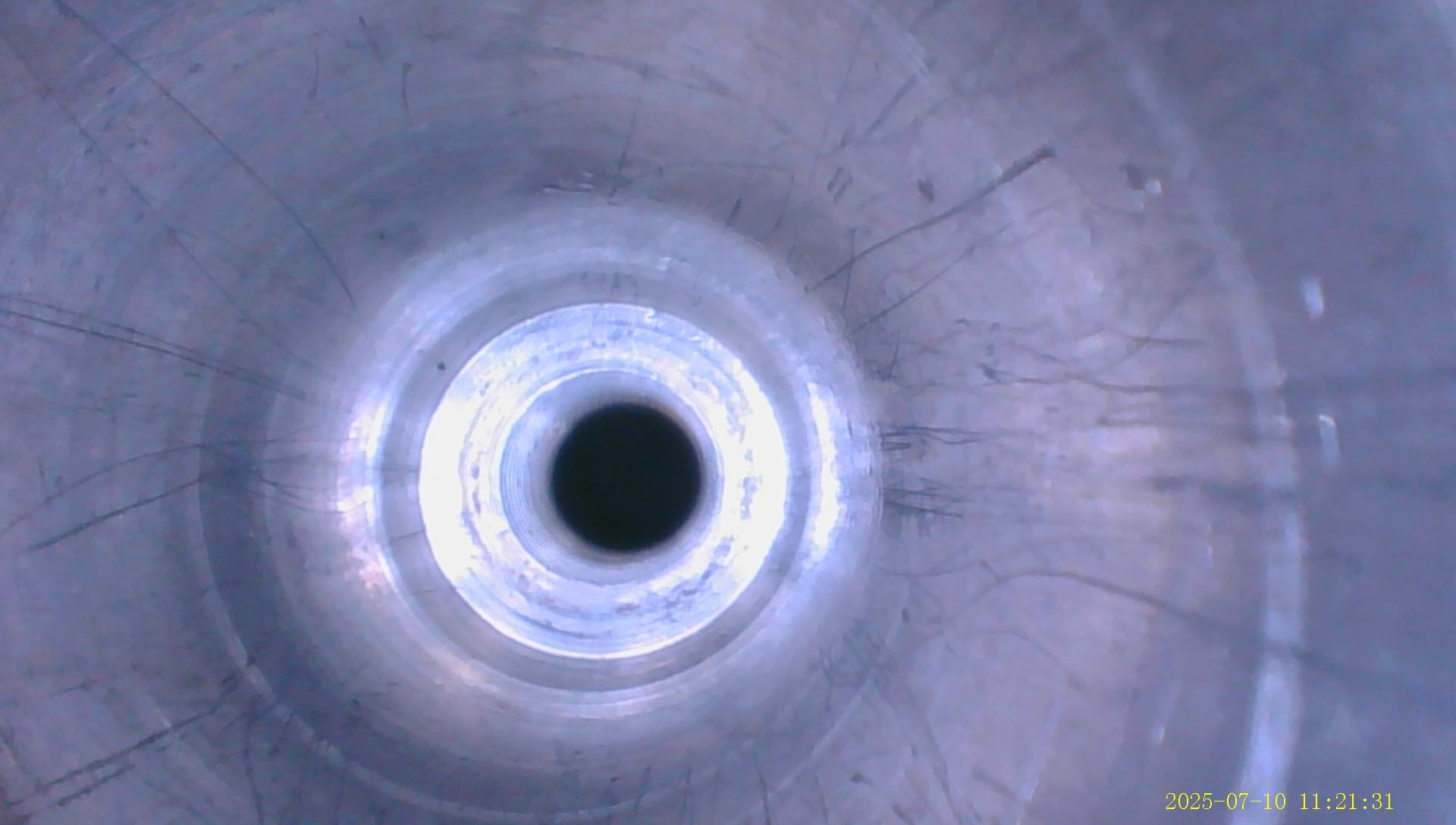

Spark plug jammed up in the cylinder head bore is another worry if too much gunk.
Electrical grounding will also be better when the threads are clean, at cylinder head female bore and the male thread at the spark plug.
When both are clean, it is so easy to hand screw in till end stop, zero resistance.
There then 23Nm torqued.
The non threaded bore must also be clean, so no dirt can enter the spark plug bore and again better electrical grounding as the copper washer sits here and pass
current to the spark plug from the cylinder head ALU metal, which is the negative ground.
