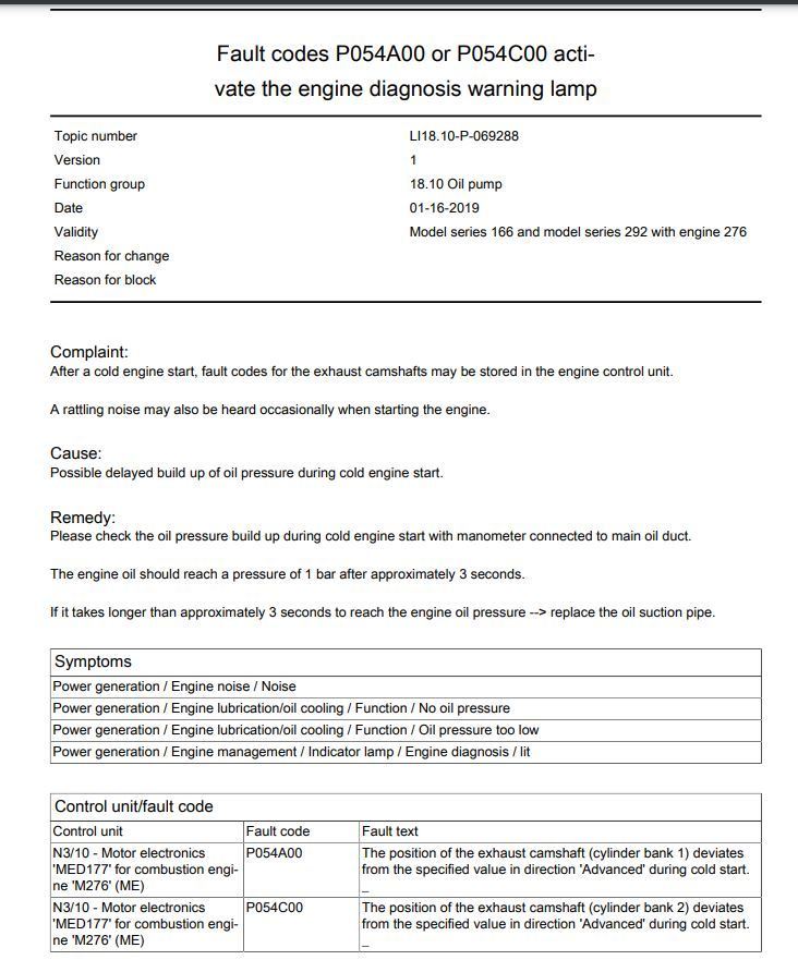

Too bad I do not understand Mandarin and no subtitle, but the DTC is clear and there is a TSB on it for W166 and W292 chassis,
but my concern is the engine model, my engine.
https://static.nhtsa.gov/odi/tsbs/20...54013-9999.pdf

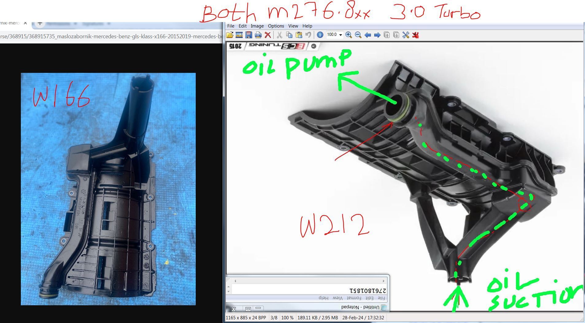

I worry of the joint/seam on the plastic which is the suction pipe itself. Its o-ring FOR sure will harden and fail over time.
If anyone understand Mandarin, perhaps the techy in the video explained which part of the oil pan aka suction pipe had a cracked producing the air leak.
I worry abut the seams.

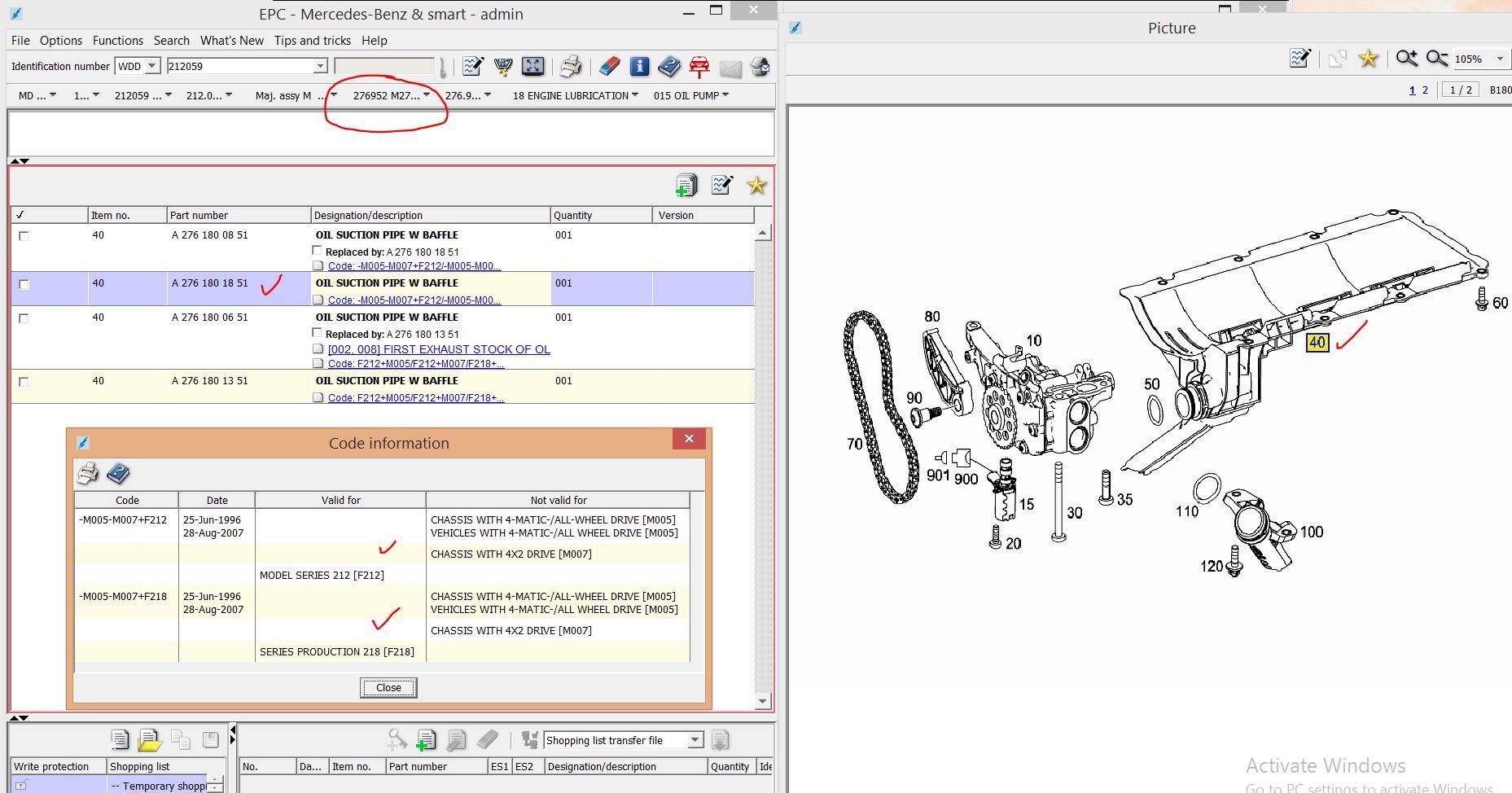

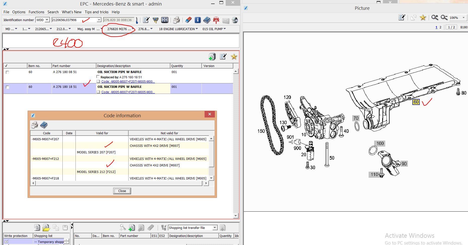

BTW, M276.9xx 3.5 NA uses the same oil pan-suction pipe as M276.8xx, for rear wheel drive model.
So we all will have the same issue eventually.
I have discussed this a long time ago, back in 2023
https://mbworld.org/forums/e-class-w...brication.html

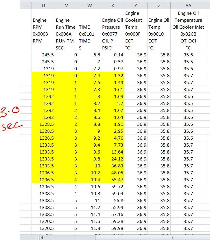

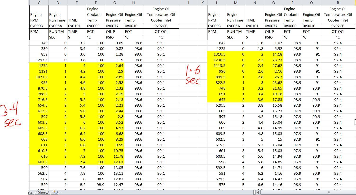

Some samples of oil pressure rise vs time , to its maximum potential based on RPM and oil temperature.
Engine Oil Temperature is the metric to inch coversion adapter/fitting metal skin temperature of the oil sensing port.
Engine Oil Temperature, Oil cooler Inlet is actually engine's metal oil pan outside skin temperature.
I am still hunting down unique slow-ness of oil pressure built up, when engine shut down is only 3-4 hours after a normal full operating temperature use...and then I start the engine.
The time to full oil pressure could be up to 6 seconds. Usually 5 seconds is max, counted at 5hz and engine RPM already hit 1,300RPM for 0.2 second.
Here is the 4 hour engine kill data upon starting.
1.4 second to 7.8 seconds or 6.4 seconds is way too long. Worse case I have seen a week long engine kill would be approx 4ish seconds oilpressure build up.
The 1.2 to 3.6 seconds zone is what does not make sense, that is a pressure rise and then down, albeit very small 0.86 PSI at 1.8 second , it should not be at 0.12PSI at 3.6 second.
This is not a glitch. I have seen this a few times on my log, when and if engine shut down is 3-4 hours after a drive, and I started the engine again.

This plastic baffle + suction pipe combo is not like say a round pipe, but square shape with seams.
If there a TSB issued, that meant the case have occured often enough to warrant a TSB.

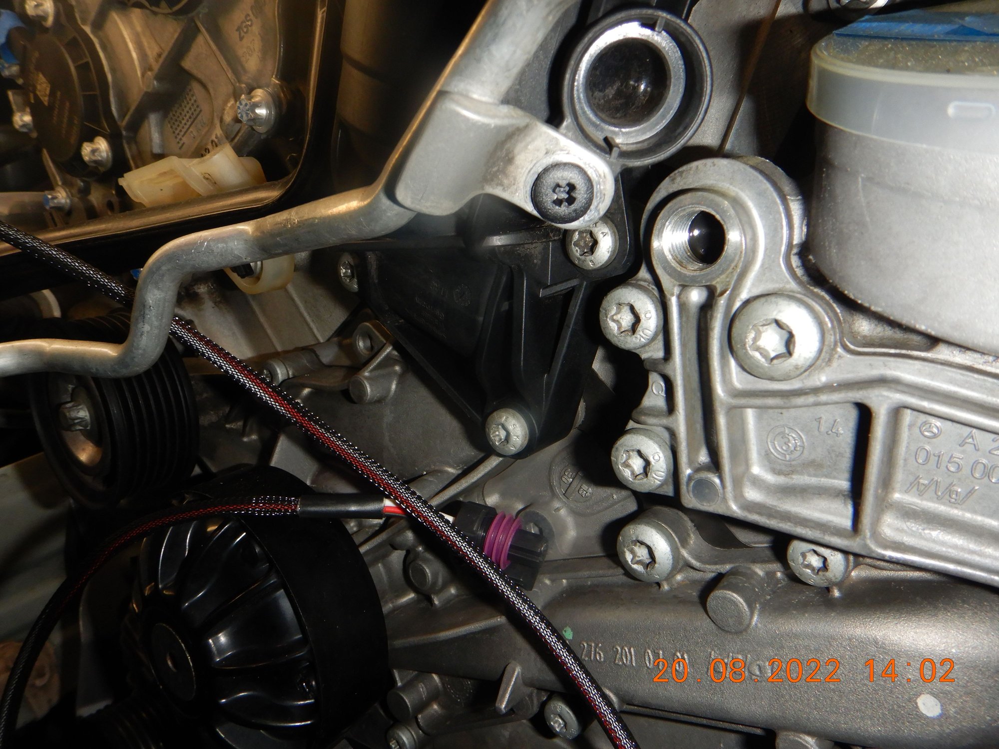

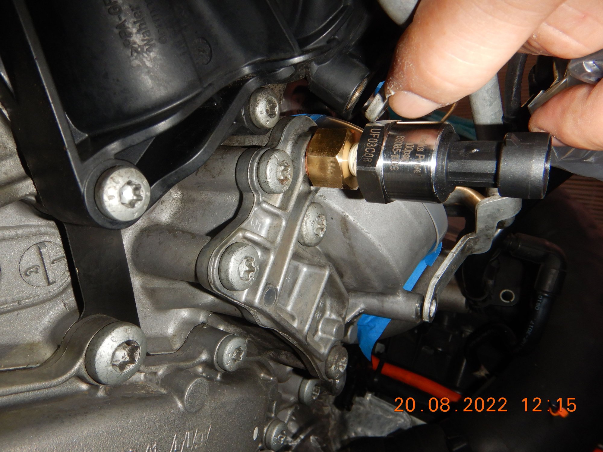

My oil pressure sensor is located where MB reads oil pressure mechanically for oil pressure check.
This port is after the oil filter ( by oil flow )
I am just curious on why mid hot temperature like 60C coolant temp and oil temp seems to produce slowest pressure rise to peak.
Very hot as in 100C coolant/oil and COLD ( my COLD is 28C at best in town and 18C if I go to the mountain ) is fast enough for pressure build up.
