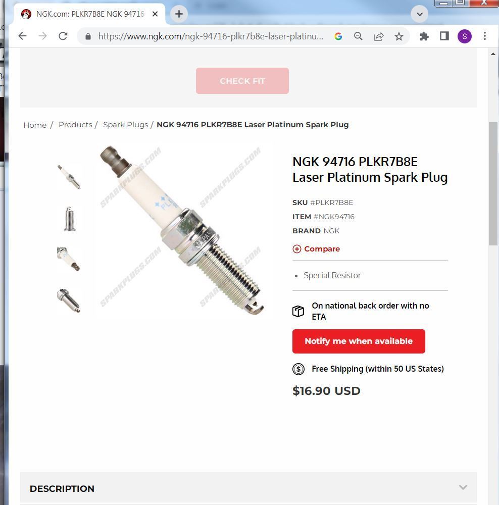

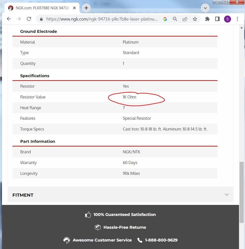

Interesting about that MB plug being an NGK PLKR6A. If that in fact is a Genuine MB plug from the dealer then I see no reason to not use just a regular NGK PLKR6A plug since they should be the same things minus the MB stamp.
I never noticed the NGK PLKR6A plug is 1k and the Bosch YR7MPP33 is 6k, I thought they were both 6k which is why I never bothered to look further into NGK.
For the M272 plugs the dealer price isnt that bad at all, I look up the NGK PLKR6A plugs at local auto stores and they want more money than the MB dealer wants for Genuine plugs. Same with the battery, when I was looking for a replacement all the local auto stores wanted more money so I ended up at the MB dealer. Afterwards I realized Walmart carries H7 agm batteries in stock cheaper with a longer warranty so i'd probably go there next time.
I was searching around online for the specs on the Bosch Y7MPP33 ( not YR7MPP33) plug and cannot find anything on them. Wonder if they are 1k, or even 0.

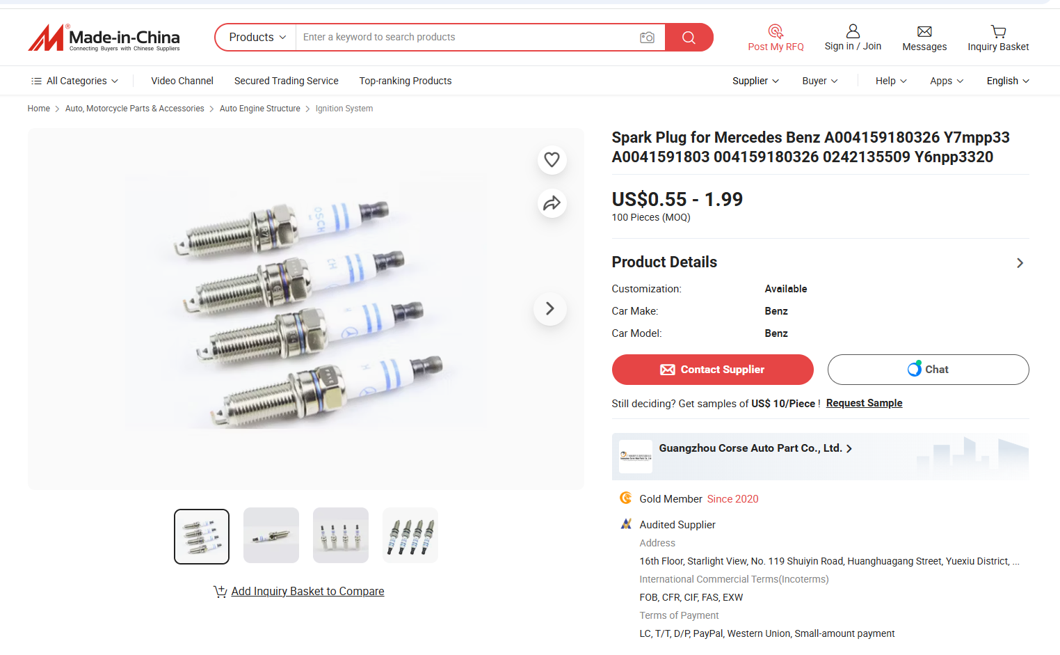

In my search I came across some inexpensive MB Bosch plugs. Im guessing this is why they are so cheap on places like ebay. It says Y7mpp33 but in the photos im seeing an "R" in the numbers.

Something tells me the "Made in China" website isn't selling genuine, made by the OEM (NKG, Bosch, etc) plugs.

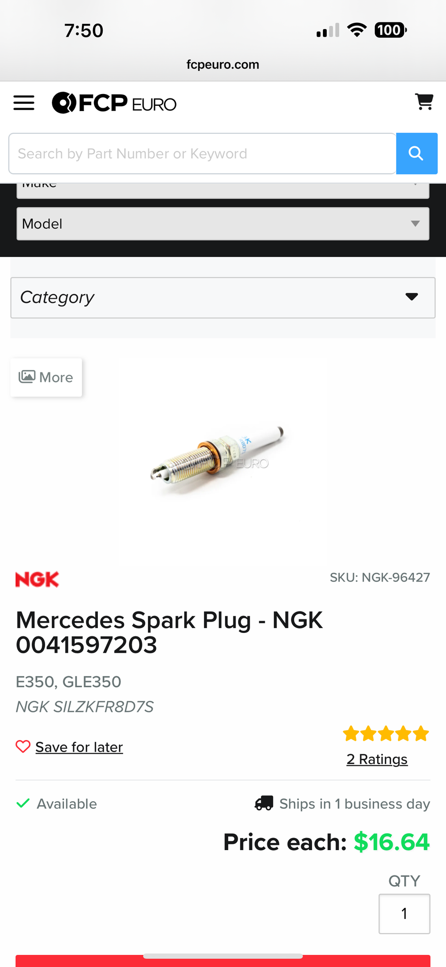

I just bought those NGK plugs from FCPEuro.

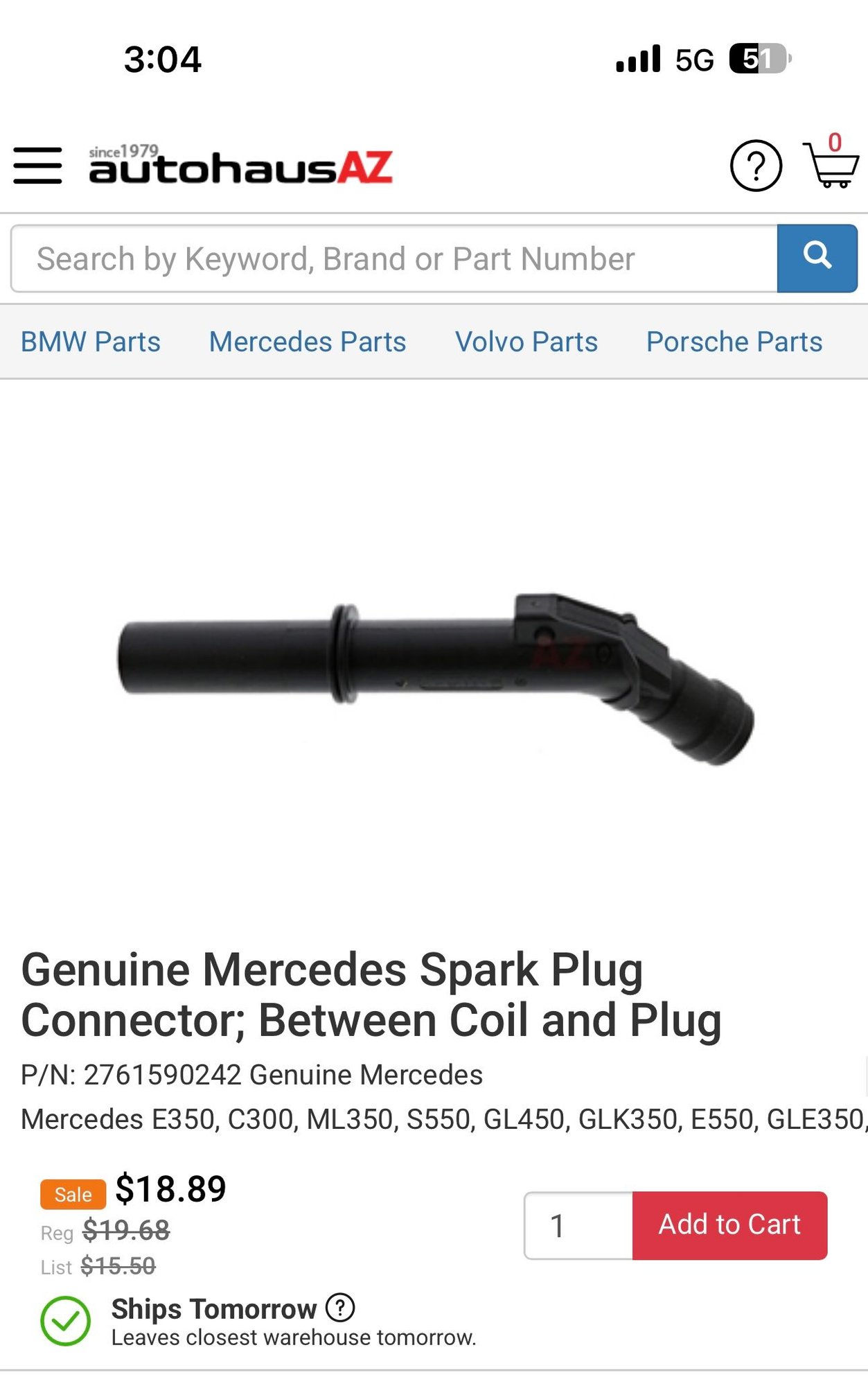

I got those connectors since I’ll be in there. They’re a bit more pricey than plugs, but since I’m doing the work myself, it’s well worth it.
Good call not to save on necessary parts when labor is heavily discounted ...

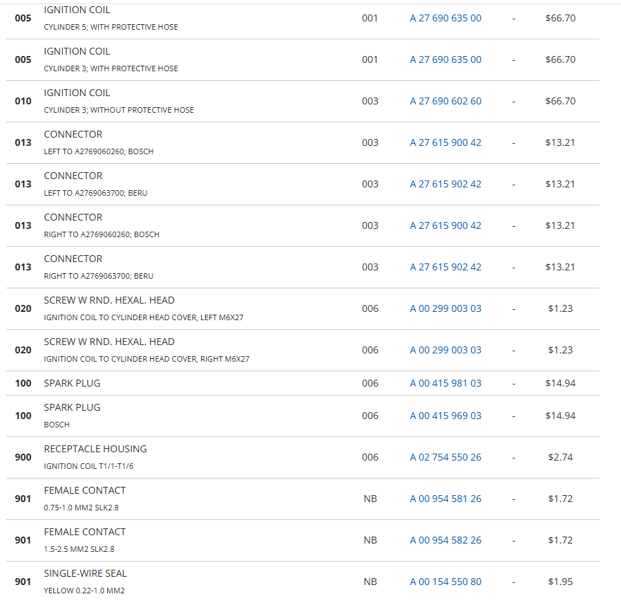

I conducted several Merc dealer parts lookups, and it appeared they were all using the same software. I entered my car info, 2016, E350, Base, Gasoline, and asked for the spark plug. It couldn't find anything. Tried spark plug boot and got a hex bolt, asked for a spark plug connector and same reply as the spark plug. Well, I just don't know what to think about parts lookup on Merc dealer parts lookup websites. Maybe tomorrow will be better.

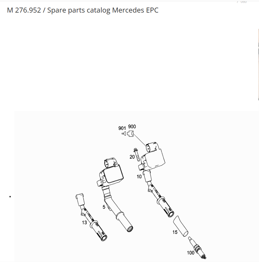

What is your vin #? I use the Nemigaparts website to look up parts: https://nemigaparts.com/cat_spares/epc/mercedes/1/212/
I took a guess on your engine, M276.952?

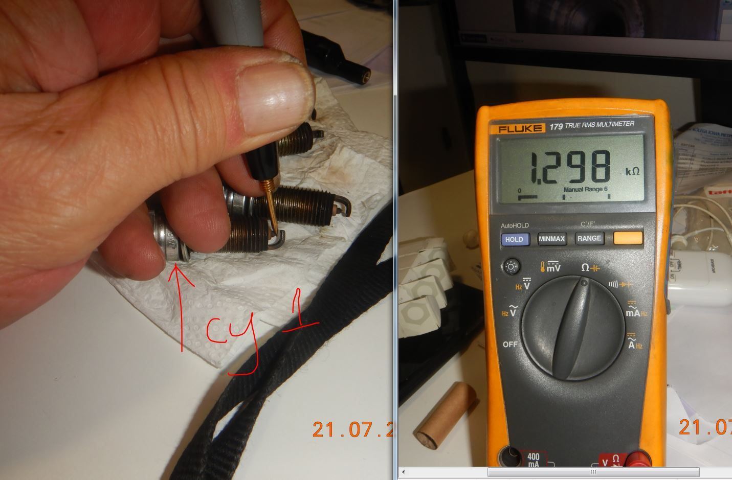

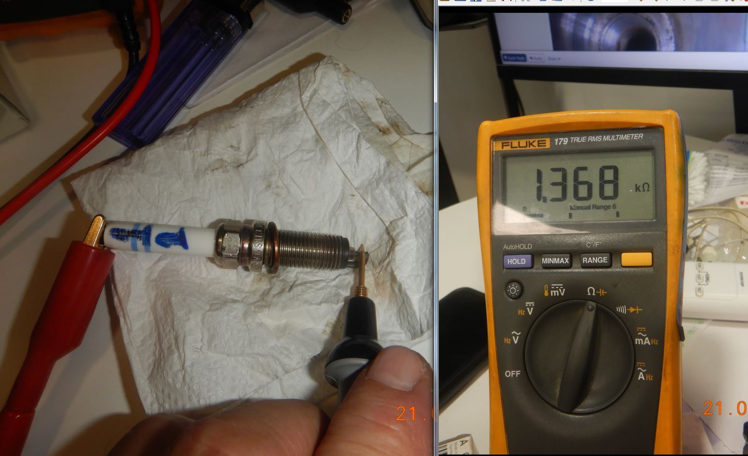

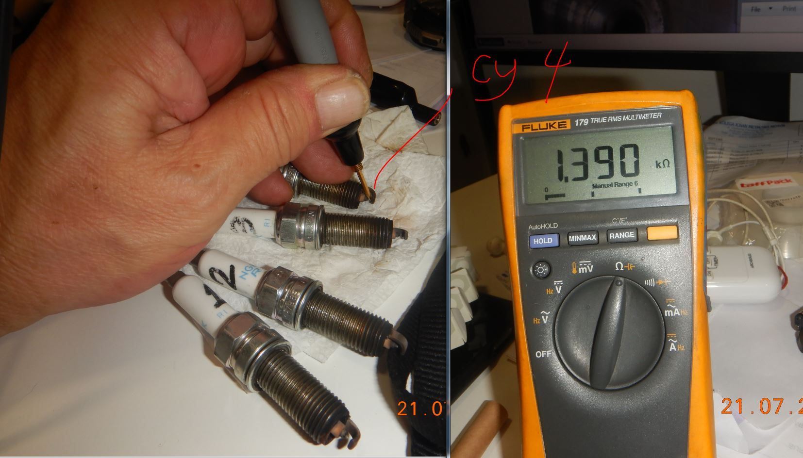

S-Prihadi's Avatar
Joined: May 2018
Posts: 6,601
Likes: 6,547
From: Jakarta-Indonesia

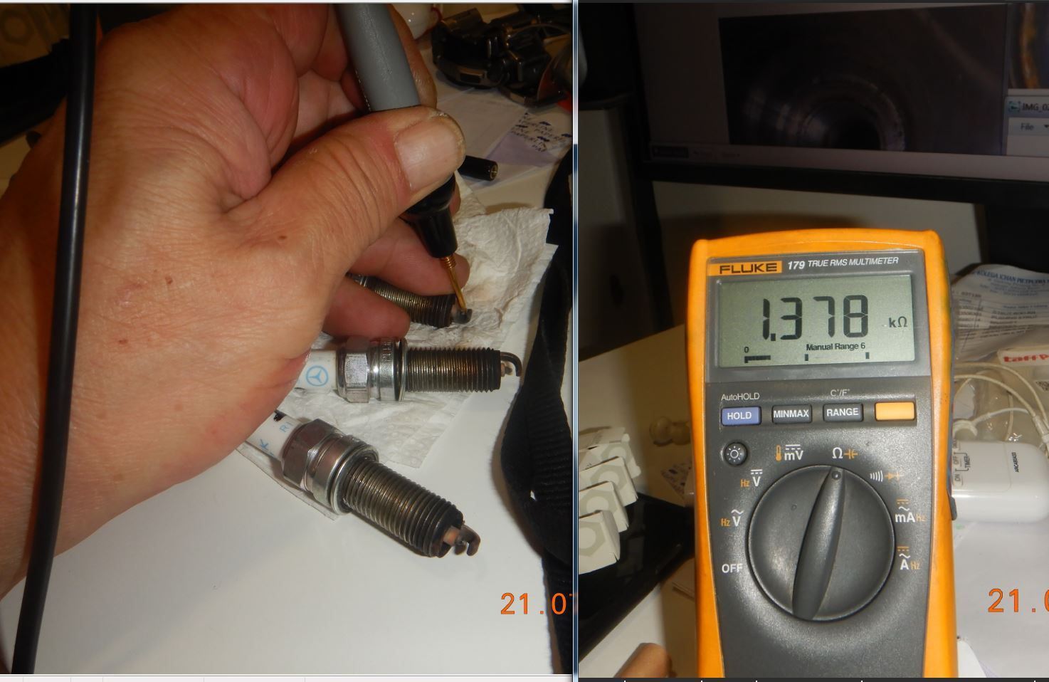

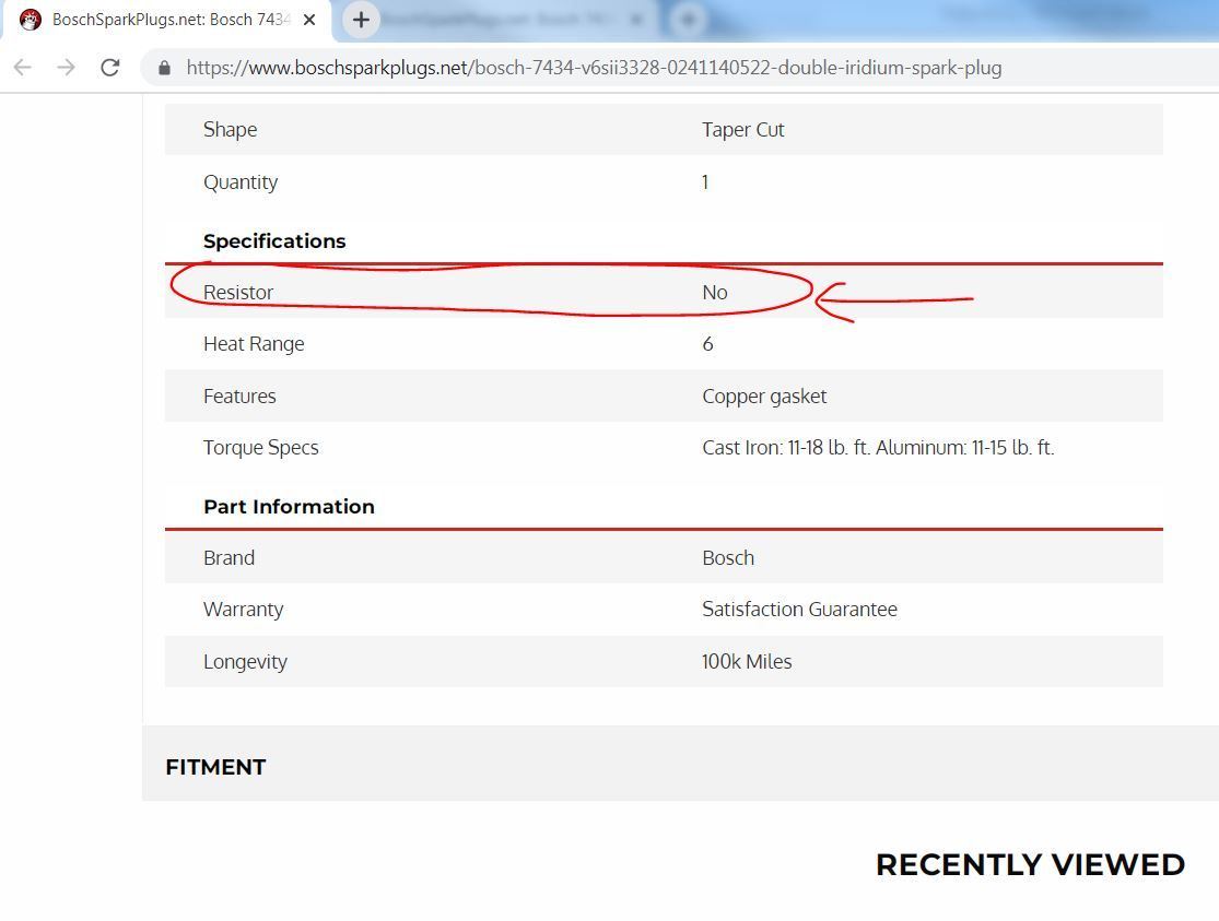

MB Indonesia told me MB HQ stop selling COP boots.
That means MB HQ does not want to sell it stand alone, must buy entire COP.
On a side note :

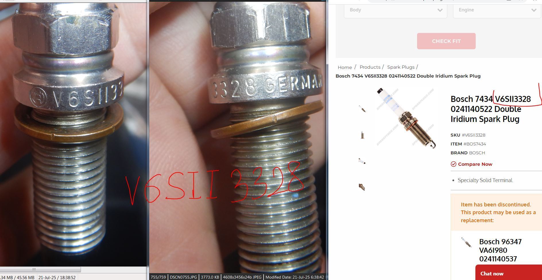

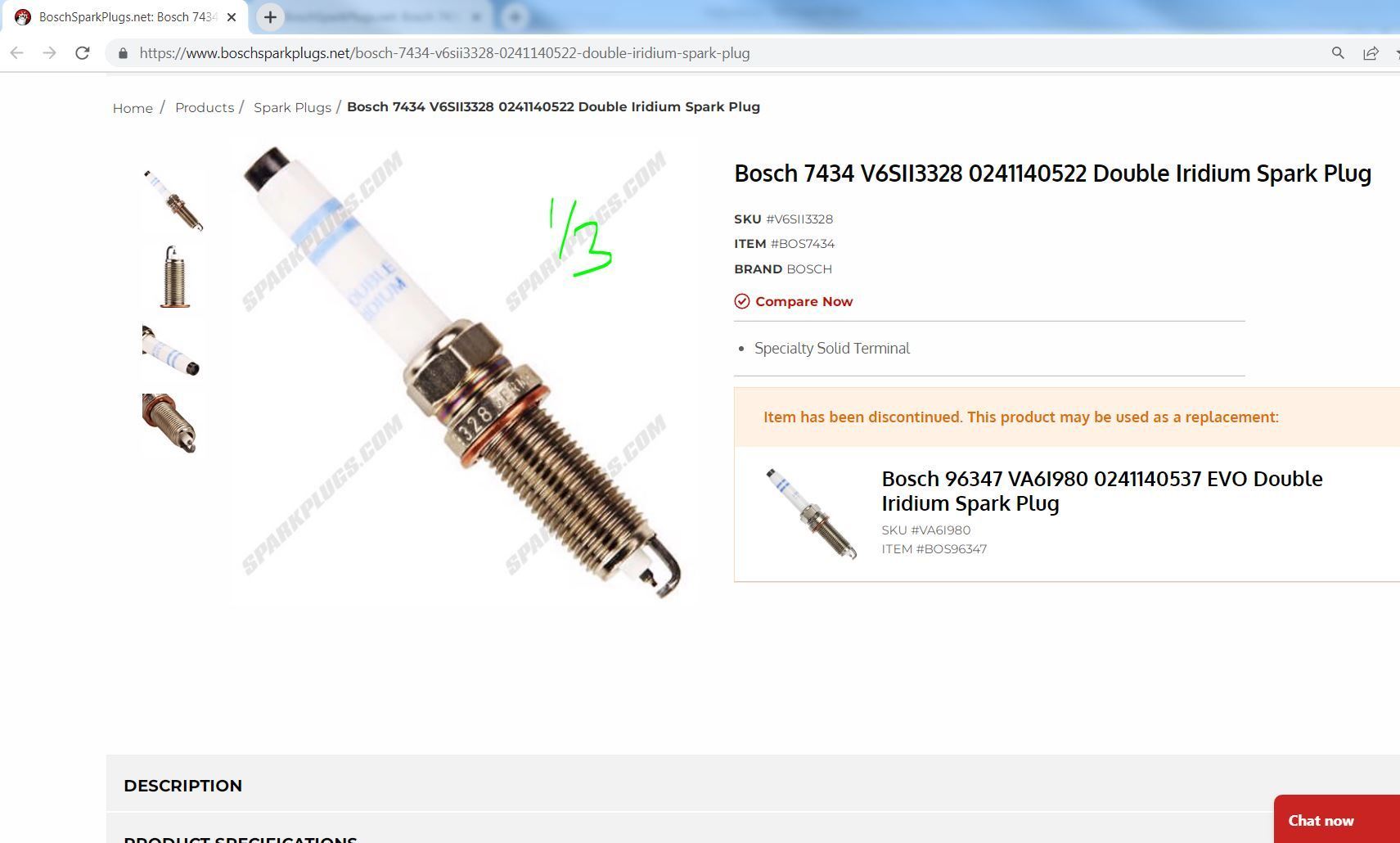

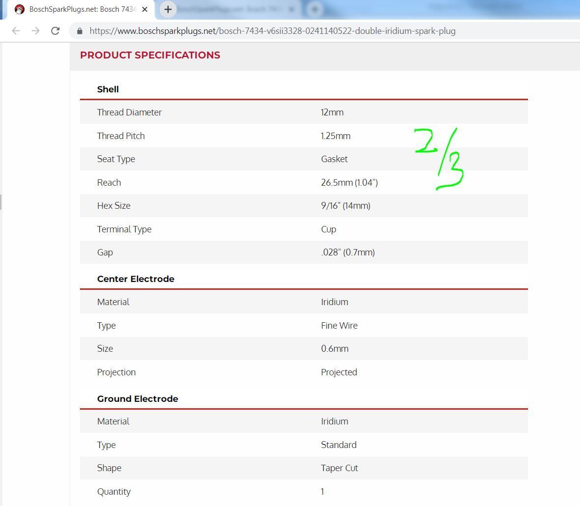

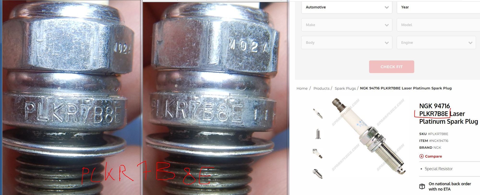

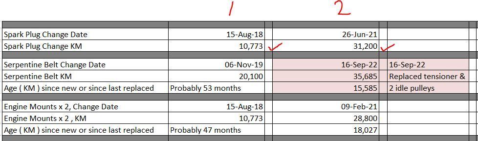

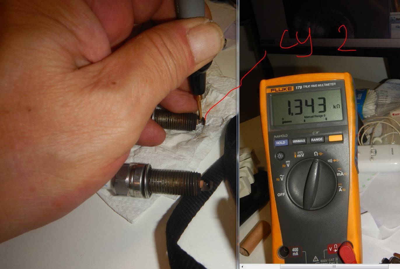

My M276 spark plug genuine MB , its resistance is 1.368 Kilo ohms, not 1K ohm. I measured cylinder #1, me too lazy to measure the rest.
All 6 are new when in June 2021, and today 21st July 2025 is only 12,000KM driven.
I replaced the previous set after 10,000 KM to 31,000KM.
I like my plugs to do no more than 25,000KM. Thus 20,000KM ish I replace them.
The clean one 3rd from the left is the new one, 1 to 3 is the one serving 21,000KM
====== RESISTANCE TEST ===============
Guess what Bosch spec wrote .........
Look below : supposedly NO RESISTOR
When MB buys spark plugs and they want custom spec resistor, they get it. They buy millions of spark plugs.
Resistor on a spark plug is important for our massively laden computers on board.
MB choosen approx 1.4K ohms as their magic number, who is there to argue ??
W204 or W212 if C200 or E200 with M271.860 turbocharged 1.8L engine.
This is 20,000KM old too.
Supposedly 1K Ohms
Want to see real resitor value when the brand has MB on it aka genuine MB spark plugs made by NGK. ?
The magic number approx 1.4K ohms again, albeit this small engine M271.860 ( car is 2010 ) is older than my M276.820 , 3.0 Turbo ( car in 2014)
Do you guys know that Michelin 4S has special edition for BMW and only for BWM M3 and M4 ?
Never underestimate how an-al German engineers can be and with such buying power BMW or MB can do for components.
It is all abour $$ and priority.
As I said, some components you can go for BOSCH or other actual OE supplier of MB cars of your model.
Spark Plugs , get MB genuine. As easy as that.

Why is are there resistors built into modern plugs?
The resistance values built into modern plugs have nothing to do with whether the engine runs on flex fuel, non flex fuel, unicorn urine (yeah, I know, already used that once today). The resistance is there for EMI shielding. The EMI generated by a non resistor (shielded) plug can interfere with wireless signals, onboard CANBus systems and even wiring.
The added or reduced resistance has no effect on the spark itself
, it just slows down the rise time of the spark pulse, thereby reducing that aforementioned EMI.
In high performance systems, that resistance is easily compensated for by the ignition system. Modern ignition systems can even vary the output voltage in real time, to compensate for varying amounts of fuel being injected into the combustion chambers. We're not dealing with our grand papy's 1960's single coil with individual wires going to each plug, ignition designs anymore.
Should you run non resistor plugs in modern applications? No. Can you? Sure, though you may get diminished performance due to EMI issues.
Again the resistor just dampens the rise of voltage and suppresses EMI, not limit current like a fuse would. The spark is essentially the same between the two versions.

Correct as always Surya,resistance has a direct effect on spark, High resistance effects spark quality, if the resistance is too high, it changes the intensity and duration of the spark, which can cause misfires, poor combustion and reduced power output, too low resistance also effects spark quality, which can cause too intense of a spark and pre-ignition, which leads to engine damage
