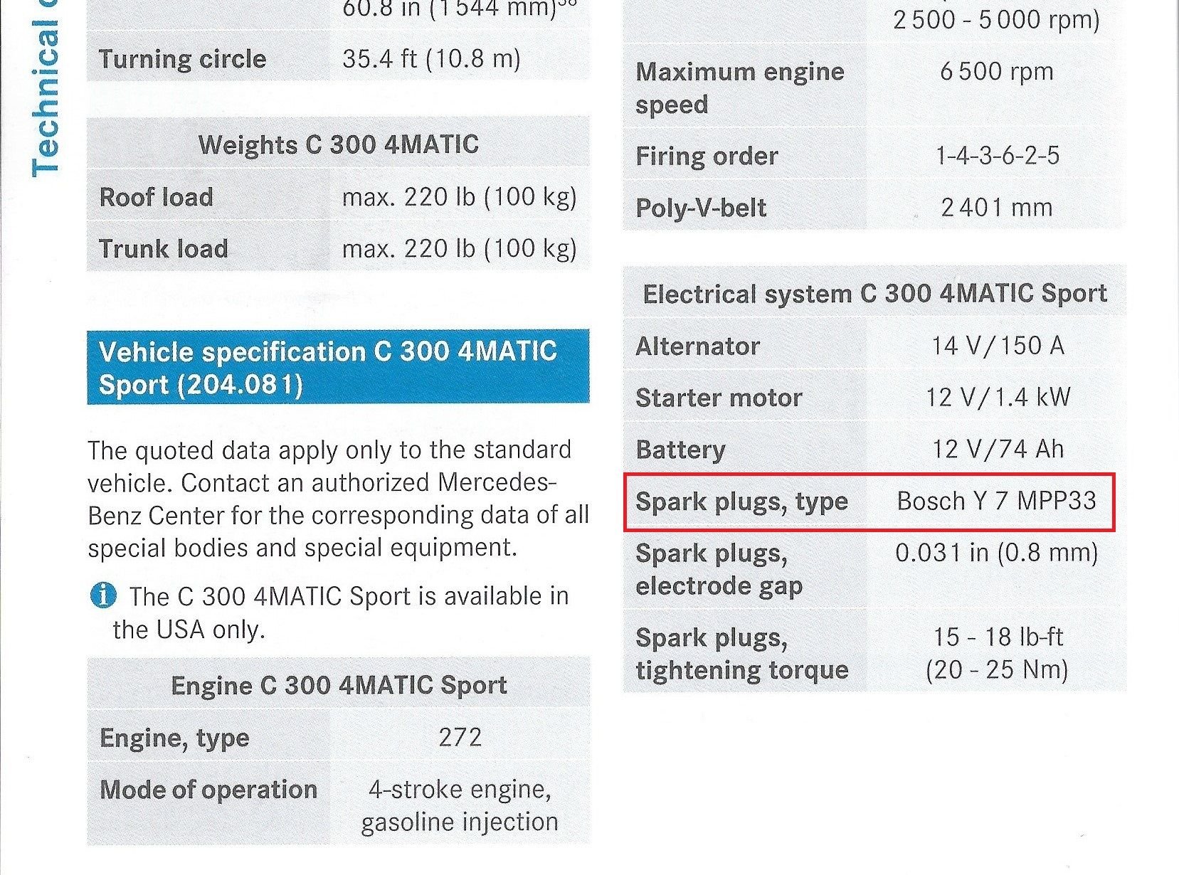

My operators manual in the glove box lists a specific plug to use in my W204. I have the M272 engine and it says Bosch Y 7 MPP33. When I look for the Bosch brand plugs non-MB branded all im finding is a Y R 7 MPP33 which has a resistor im guessing. I had contacted FCP Euro asking if the MB plugs they have are in fact the Y 7 MPP33 and they confirmed they are. So I will be going with the Genuine Mercedes plugs when I get around to doing them.
I have no experience with different type plugs. I looked and Mercedes brand plugs is what is in the car now so I rather not change anything since the car does run great. At FCP the Mercedes plugs are only $5/each more than the Bosch brand, so only $30 more.

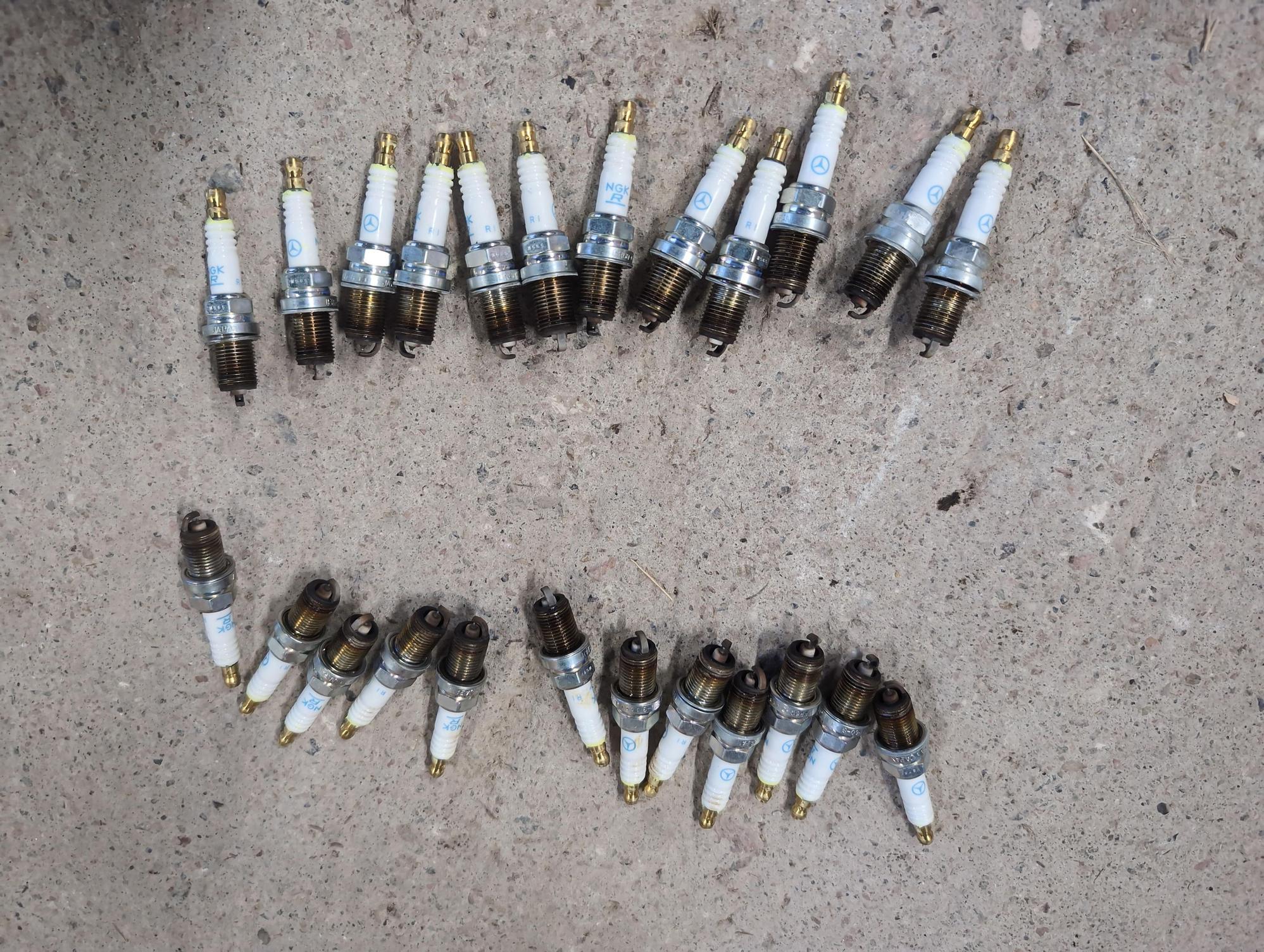

I'm sure you know there are no such things as "genuine" Mercedes spark plugs, since Mercedes doesn't actually make spark plugs. Mercedes farms out spark plugs from manufacturers such as Bosch , NGK, and others.The only difference between "genuine" Mercedes plugs and the same plugs directly from the same manufacturer is the Mercedes "tax" and maybe the Mercedes Star logo.
Curious, why are you pro aftermarket (non Mercedes "genuine") O2 Sensors, but aren't a fan of non Mercedes "genuine" plugs? If anything, the O2 sensors are more important than the plugs, since the O2 Sensors play a much more critical role in the ECU determining fuel mixture ratios are correct, one of the indicators of a complete or incomplete burn, that spark plugs generally initiate.
These are the original plugs I pulled out of my M279. Notice the NGK and Mercedes Star. Price for the same plugs from Mercedes is approx 8 dollars more than the same plug from NKG. Multiply that by 24.
Please don't tell me you also purchase genuine Mercedes windshield washer fluid, designed for those genuine Mercedes wiper blades...?

I would use Bosch plugs if I could find them but I cant. Only ones im finding have an R in the part number. My manual has info for the C63 and it says NGK ILZKAR 7 A 10 plugs.

if NGK the correct one for M272 is PLKR7A. The bosch Y7MP33 has different resistance value Bosch has 6K ohm resistor, whereas the NGK/original MB plug has 1K ohm resistor. I was using bosch (it was less than a year old) and cannot pass emission test. Changed to original MB plug (not that much expensive for maintenance items every 50k or so...) then it pass emissions tests (and improved LTFT!). Maybe the difference in resistance value makes the difference....
detail here https://mbworld.org/forums/e-class-w...ml#post9070003
