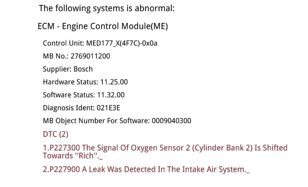

Hi again,
I am getting CEL after 30 to 40 minute driving in daily basis with error
Air Leak detected in the Intake Air System. If I connect the scanner to the car. CEL will truned off after that without clearing the code.
Yesterday during my trip after 40 min the CEL get on. After stopping the car for 20 minute then start back the CEL is off but after another trip CEL triggered but never get off even after connecting scanner without clearing codes.
Please check the latest report and what can I do troubleshoot this issue before go to garage.

You started the post by indicating that the issues began after you replaced the spark plugs, correct? Did you remove the intake manifold to replace the spark plugs? If you did, either the intake manifold is not properly installed (likely the gaskets), or something is not correctly connected.

MULTIPLE ECM FAULTS
You have TWO ACTIVE CODES that are likely related.
ECU FAULTS
ECM FAULTS
As JC pointed out the green intake seals need to be installed properly or renewed.
Then allow some time for exhaut sensor to relearn mixture.
After this is all said and done...
At 240k Km you should replace 2x upstream Lambda sensors.
The old dirty sensors make your engine slow-poke.

I will check/replace the gaskets and the O rings related for any hose/part in the intake air system. About upper O2 sensors, I will do it later this year unless the issue exist so will do it directly. Will keep you posted.
Old Sep 8, 2025 | 05:09 PM
CaliBenzDriver's Avatar
Joined: Apr 2019
Posts: 11,993
Likes: 6,827
From: Silicon Valley
W212 MY'14 M276-3.5NA @75kMi
CONSIDER IT DONE
Originally Posted by redaotrosh
I will check/replace the 6 intake gaskets
(and O-rings related for any hose/part in the intake air system)
It's always rewarding to be proactive.
Your engine will thank you by running well again.
Old Sep 11, 2025 | 03:26 PM
redaotrosh's Avatar
Joined: Oct 2017
Posts: 174
Likes: 24
From: Lebanon
W220 S320 99, W212 E350 2014
I took the car to the garage, he used smoke leak detector device by put it iñ the one of the Manifold hose, after couple of minutes, smoke start to leak from the pressure sensor(cracked from the back). He replace it and clear all dtc. I did several tests mixed with small and long trips. Everything looks fine and the full power with normal fuel consumption get back as before.
I will test more and more.
I'll keep you posted.
This is the leak test device used.
https://thinkcarus.com/products/prof...HXJtpj9FAnDYdv
