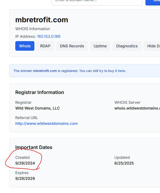

You praise the only hacker here - this is a crime too - the one who stole my website mbretrofit.com. Is quite funny to blame me being so stupid to post myself, about me the elucrubations being a hacker.

You mean this site?

Yes, now is on the same server as ninja.com
