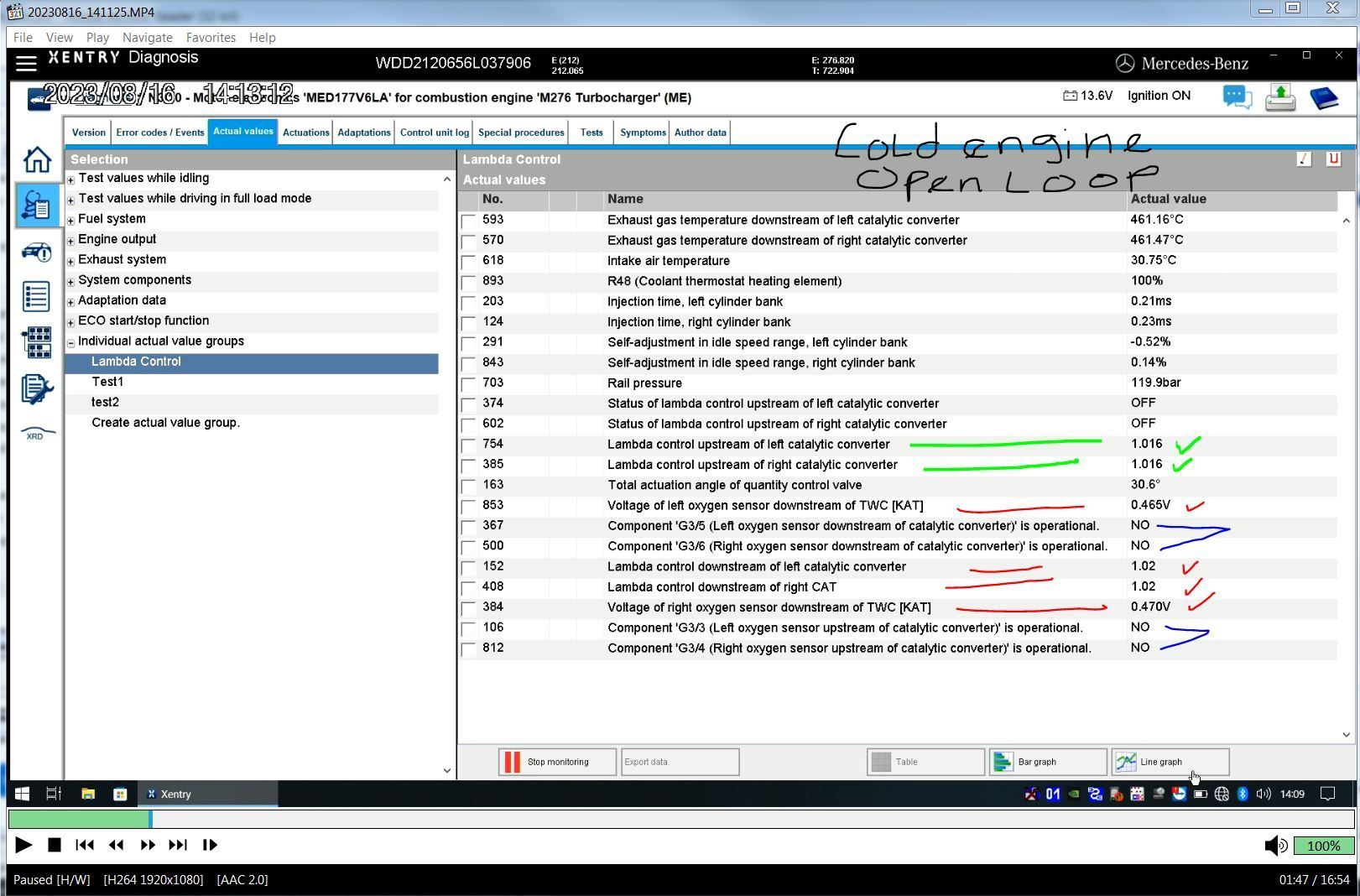

Dont rely on AI for such information.
Use Xentry, because MB of W212 uses different oxygen sensors type since 2009 to face lift and depending on engine type.
The proper ID of oxygen sensor would be Bank and then sensor number/position....if using OBD2 device or scanner in OBD2 mode.
B1/S1 = Bank 1 , upstream wide band Lambda sensor.
B1/S2 = Bank 1, downstream narrow band oxygen sensor.
If OBD2 type scanner, often the may not produce accurate reading for upstream/front wide band sensor, which is a processed data from ECM and not directly from
the lambda sensor itself.
The current pumped into the Lambda sensor is actually the rich and lean value, and some ECM does not produce this value for our viewing, instead it will give us the
Lamda value, which is most important.
Attached is Bosch wide band LSU4.9 which my engine uses
Here is Xentry values.

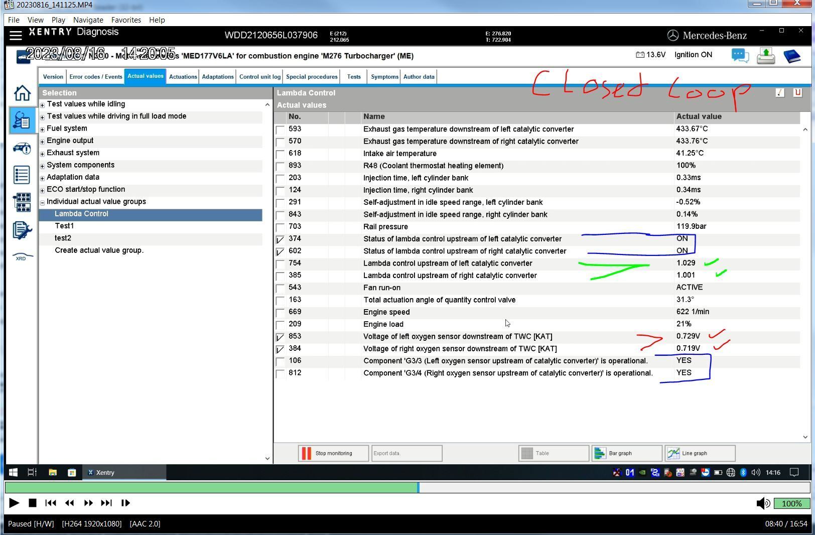

Cold start is Open Loop, so no feed back from oxygen sensors. ECM does not use any oxygen sensors to determine fueling quantity. It uses its internal memory.
Engine already warming up and now the oxygen sensors are being used by ECM for fueling quantity.
Xentry does not have FUEL TRIM data.
FUEL TRIM data is OBD2 stuff.
Lambda value above or below 1.0 is where fuel trim comes from.
But becareful when looking at Lambda value vs fuel trim.
Lambda value tells you engine conmbustion is Lean or Rich.
Fuel trim is telling us what % of extra fuel is taken out or added to the fueling of the injectors at that point in time if short trim and what compensation value is added if long term.
If we mesh the throttle to do WOT or let go during de-acceleration, the engine will be open loop and not closed loop.
If anyone wants their engine to be super nice for driveability, replace all 4 oxygen sensors every 10 years or 100,000KM.
These sensors get "slow" as they age. They live in the 2nd most hostile location of the engine, which is the combustion gas flow.
Only spark plugs and injector suffer 1 level worse working environment, the heart of the explosion of combustion.
I replaced mine already, all 4 oxygen sensor and very nice result. I am only at 43,000KM and was under 40,000KM when I replaced all 4 oxygen sensors.
My rear oxygen sensors got lazy.

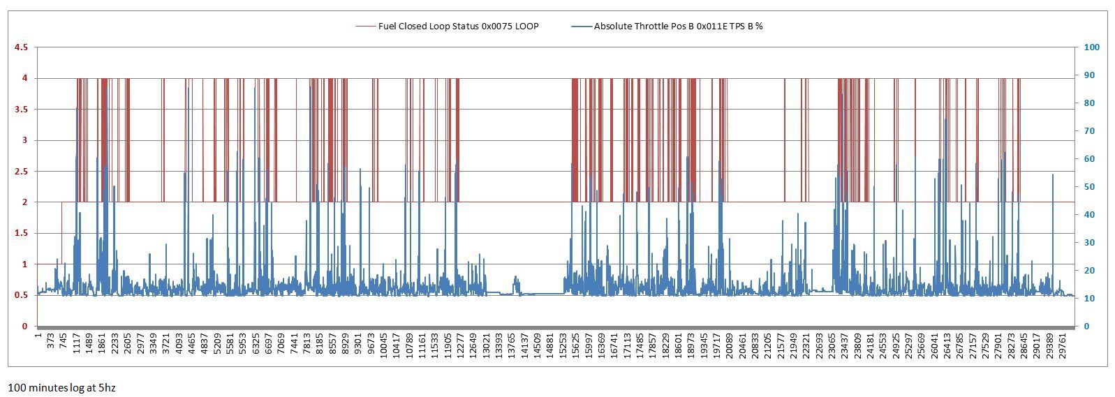

As stated above, I also recently replaced all four sensors after noticing that my downstream sensor was reacting improperly. When looking at the graphs, the sensor was making dips not attributed to throttle input. Meaning the upstream sensor reacted to new air but the downstream did not act the same. In an overlayed graph of upstream and down stream, upon blipping the throttle you should see a slight delay in the DS (downstream) sensor reacting to the input. And obviously both left and right sensor graphs should overlay each other.
Since I was in there, I did not just replace the one bank. I replaced all four sensors, and the graphs lined up nearly perfectly again and reacted symmetrically with just a small deviation because of small upstream variability in fuel, cam position adaption, etc as Cali mentioned.
search with keyword lambda under my name in the 212 Amg forums to see my pics. I did this about six weeks ago or so….. here it is.
https://mbworld.org/forums/w212-amg/915750-lambda-control.html#post9198592
