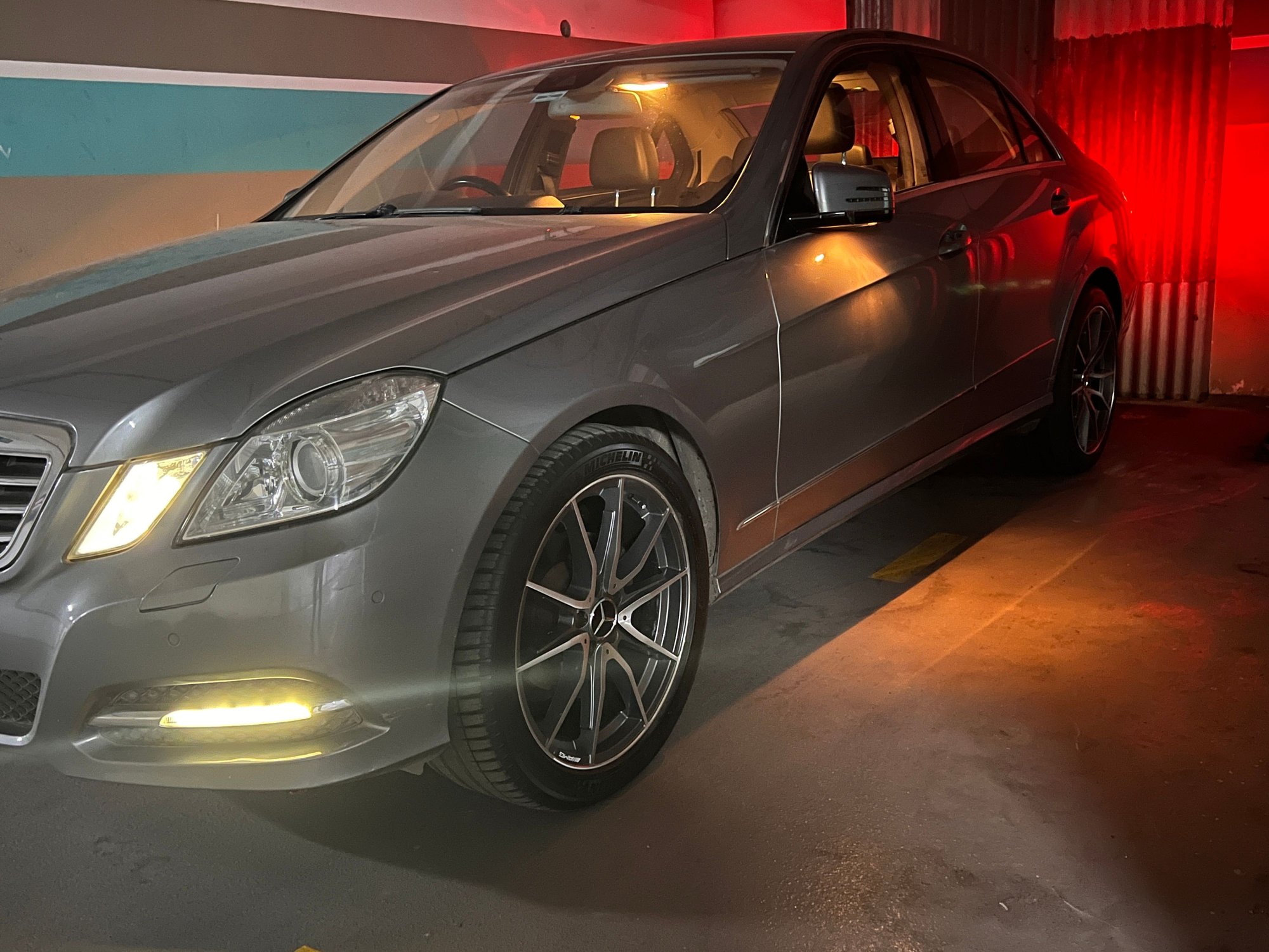

Hi I’m looking to go and buy a second hand set of e63 wheels to put on my e350 bluetec, I was just wondering would they just fit and have no rubbing? And also has anyone done this and have any idea how the fitment looks like once done?

I have put them on now, I have to admit on deep bumps where the spring is soft and the car dips I get a slight rub nothing to serious, but I am putting 25mm lowered stiffer springs to see how it feels any better or worse, any advice would be great, or I might just lower the rear not to sure
