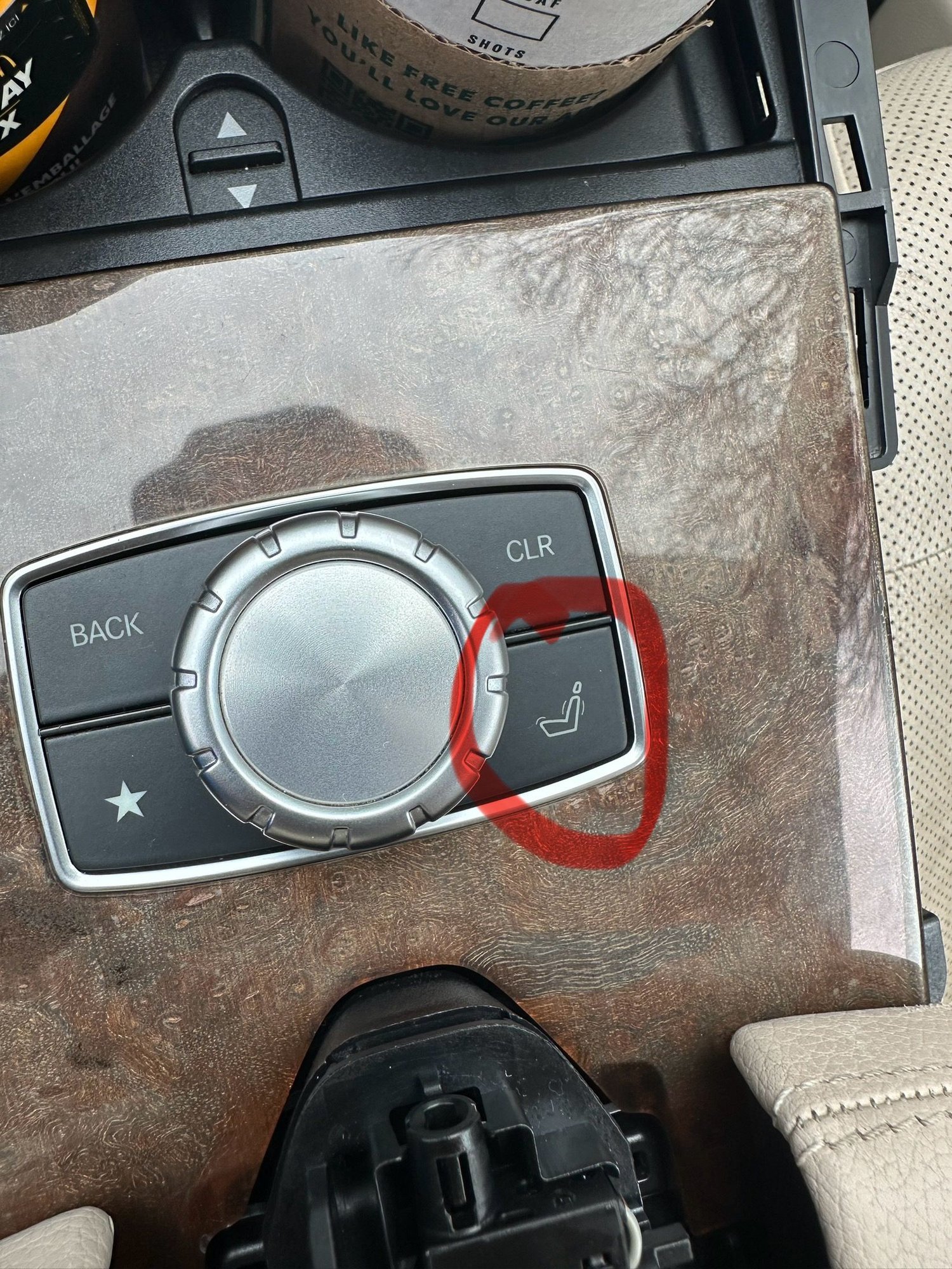

Hi Everyone, I am looking for any help I can get.
I have this button on COMMAND console but I am not sure what does it exactly do.
I press it and nothing comes up on screen. I tried searching under settings but I don’t see any seat settings in COMMAND screen

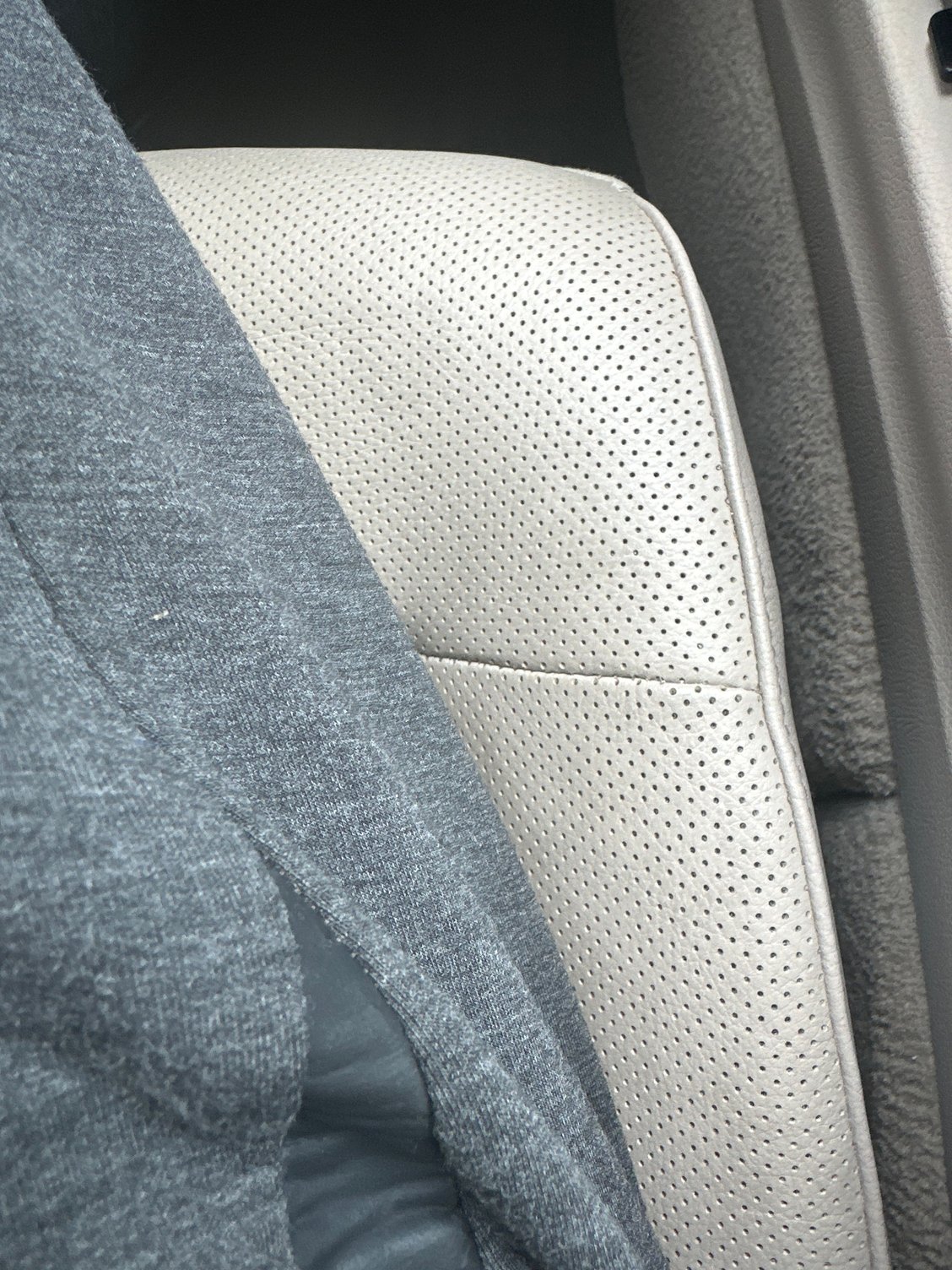

please note I do have Dynamic seats when I search for all options my car has but I am not sure how I can activate or use this feature. I also don’t have the control of seats next to my seat cushion.

seat not working
you have reached the most logical conclusion: your dynamic seats are faulty.
You could get this diagnosed professionally by connecting a scanner to interact with modules.
Issue is more likely to be compressor or plastic piping but solderless rotary dial LIN module may need attention.
Your local MB Dealership can repair your seat.

But I don’t see any options or settings on my screen ! As if I don’t have them at all. Even if this feature is faulty, I should have settings to activate it. Right?
yes Indeed: "seat options" should be shown on IC display.
Scanner will save time to whom gets this working.
I checked. I don’t have any errors. I don’t know why I cannot see it in UI Command screen.
I tried using diagnostic tools and I can control the pumps from diagnostic tools.
Is there programming that needs to be done?

MESSED UP MODULE OPTIONS
Your investigations shows your car has the working hardware but not the software options to control it.
It sounds like somebody may have replaced either the IC Display or the central Gateway module without proper coding. Now your car can no longer run all its options.
My non-profesional opinion is to call your local dealership or forum sponsor @BenzNinja for expert firmware coding.

I might be wrong but dynamic seats should also come with the massaging function as well. I don't see any buttons on the sides of your seat .

Yes my seats has also massaging feature. From my research, In 2014/2015, Mercedes W212 facelift changed where you control Dynamic seats from side panel to Command UI. That’s why I don’t have the side panel.
The reason I am missing controls on screen is because someone changed the coding and deleted all options related to dynamic seats by mistake.
I am trying to find out what needs to be coded to get this back. I have all the tools required with me (Xentry and Verdaimo) so I should be able to do it if I find what ECUs needs to be coded

Problem solved!
Incase someone had the same issue as mine, I had all options for Dynamic seats however it was not activated on Command Screen as I expected. To solve the issue, I had to go to Engineering mode then turn this feature on and simple as that !
No dealer, No coding no Verdiamo or anything else!!
It sucks this information is not available anywhere except on some Russian forums and had to find out the hard way.
