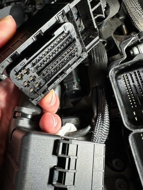

I'm looking for advice on the M276 oil-in-harness issue for my 2014 Mercedes E350 (80,000 miles). I was performing preventive maintenance and currently have no check engine lights or fault codes.
My goal was to get ahead of the known oil wicking problem. What started as preventive maintenance has now become a concern that I may be too late.
What I Found:
  1. I planned to replace the Camshaft Position Sensors and install the sacrificial pigtails/protection kit on the Camshaft Magnets (Solenoids).
  2. The Camshaft Magnet connectors were clean.
  3. However, after finding oil in the air filter housing, I inspected the four Camshaft Position Sensors (CPS).
  4. All four CPS harness connectors were soaked in oil. - Video and Picture Attached called Camshaft Position Sensor with Oil

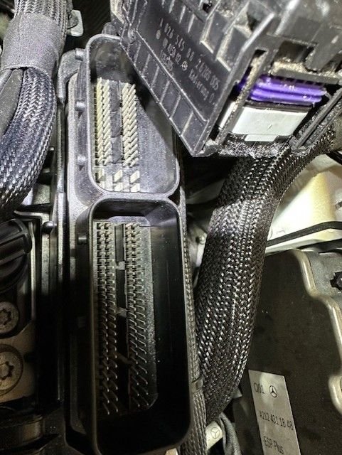

  5. I immediately checked the main ECM plugs. The good news is that I found no trace of oil on the ECM pins or on the harness connectors at the ECM end. Pictures attached - ECM Plug A & B ECM Pins A & B
What I've Done So Far:
  1. I installed four new OEM Camshaft Position Sensors.
  2. I have been meticulously cleaning the male harness-side connectors (the plugs that attach to the sensors). For the past week, I have sprayed them daily with Liqui Moly Electronic Cleaner and let them air dry completely.
  3. I believe the sensor-side plugs are now clean.
My Core Question & Concern:
My main worry is the oil I can't see.
I’ve cleaned the sensor end of the harness. But since the oil wicks inside the copper wire strands (not just on the outside), I am extremely concerned that a significant amount of oil is still trapped "in between"—somewhere in the middle of the wiring harness, slowly migrating its way to the ECM.
My dilemma is: How do I address the oil that is almost certainly still inside the wires, even if it hasn't reached the ECM yet?
  • Should I button everything up and just religiously monitor the ECM plugs every few weeks, cleaning them with electronic spray if or when the oil finally appears?
  • Or, is there any known method to flush or clean the harness 'in between' to get the trapped oil out before it travels any further?
  • Has anyone been in this situation, found the oil, cleaned out the oil, and if any oil made it into the ECM, cleaned it and not have any codes, etc. afterward?
I'm desperately trying to avoid the catastrophic "$10,000 ECM and new harness" repair. Any advice on the best and safest next steps would be greatly appreciated.

ECM Plug A
ECM Plug A
ECM A
ECM A
ECM B
ECM B
ECM Plug B
ECM Plug B

This is a tough question about "The $10k oil in harness" topic.
I am not sure there is a great answer to deal with this AFTER the fact - It is best to PREVENT heatsoaks AHEAD of baking all engine plastics.
You can add the exhaust sensors that are located low down the harness to the infamous PCM contamination.
Their failure materialize with CEL's.
Lambda use an "open-concept" so oil traveling down the harness right inside the sensor-chamber. Each new sensor gets contaminated from the old harness so you may want to install a "Lambda pigtail".

If you are really curious to see how far the oil seepage has gone up the wires, you can remove the wire insulator approx 15cm away from the camshaft position sensor.
But make sure you seal them properly after that.
With a mere 1 cm exposed copper strand, you can spray contact cleaner and let gravity feed the cleaning solution down to the connector.
If you peel all 3 wires, separate their position 1.5 cm apart, safer when re-sealed and less fat too.
I would not worry if I have not seen any oil trace at the ECM connector wire harness side and ECM side.
Be informed that the pins ( usually the female ones goes bad fisrt ) of the ECM has good life up to 50 insertion cycles if silver plated. So dont over abuse your ECM connector.
https://mbworld.org/forums/e-class-w...onnectors.html
Good luck....

I agree with S-Prihadi. If you stop new oil from coming from CPS it's unlikely whatever is on the harness will move towards the ECU. I would recommend to clean as best as possible and just keep an eye out for new leaks.
