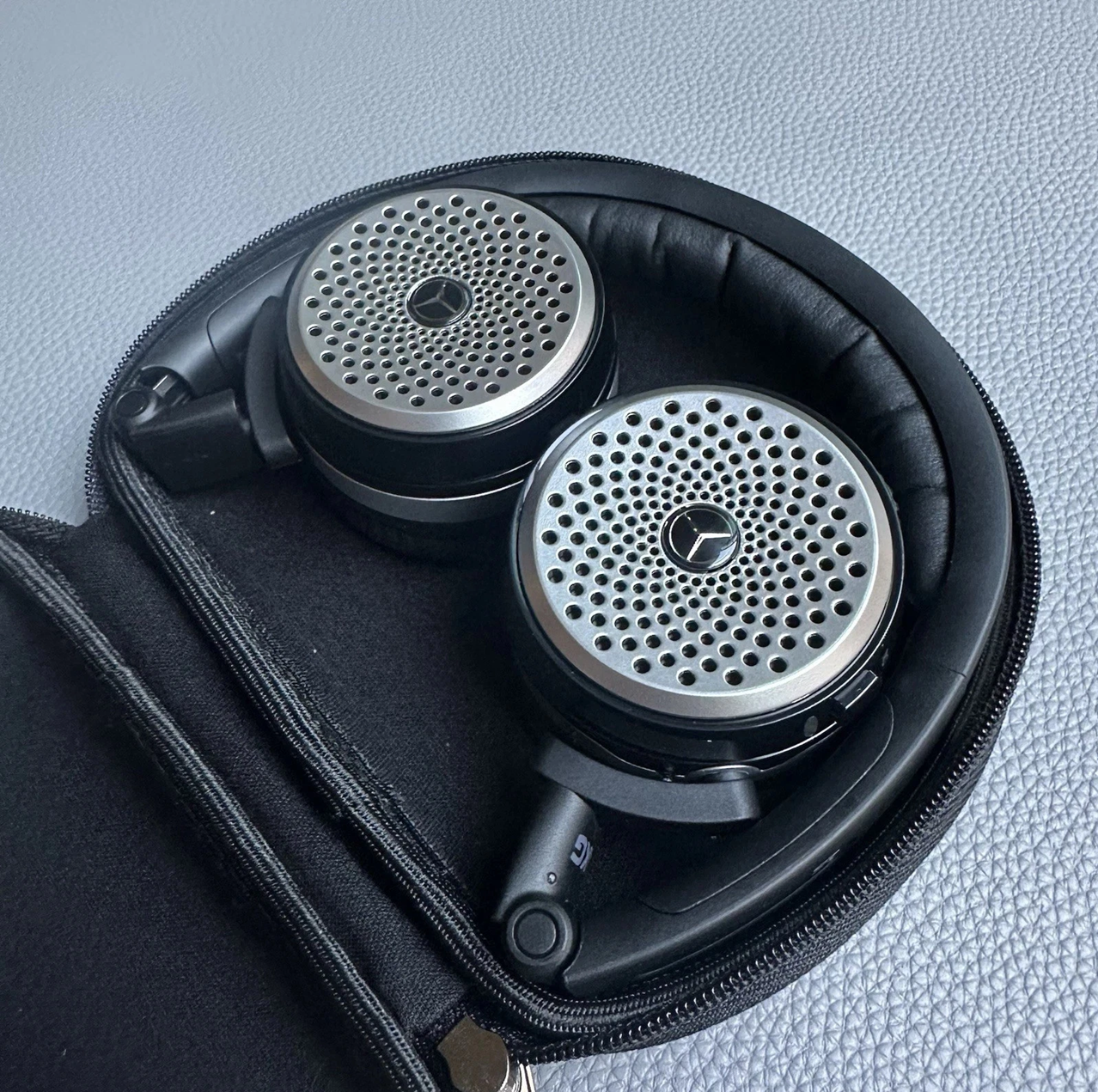

Hi everyone. I'm having an issue trying to pair a set of original used headsets on my W212 with rear entertainment system. I first tried using Xentry passthrough version 22.12.3 and when I try to use the paring teach in function I get the ECU rejected the command error message. I assumed it was a software issue with my Xentry installation, so I've installed a newer version of Xentry (25.3.3) and achieved the same results.

Yes, they are the original Mercedes ones (model P104) but purchased used from Ebay. They both seems to works (LED lights up and blinks as they go into paring mode) but Xentry is not cooperating...

Not what mine look like....

I have the headphones for the rear entertainment system, could you send me a photo of the ones you installed? I think I know which ones you have.
I don't think those are the right ones for that model, those look like they're for a 222.

That was my original thought. Then I got to checking and these headsets were out of our GLS not the e. The E headsets were all black with no silver anywhere on them. I have not yet turned on the car to verify this that would take possibly 90 seconds out of my day..

I've got mine by searching the PN on the EPC (A2228201889). Based on the code they are the same as for the W222. The core of my issue is that the Xentry is not able to put the screens into paring mode. The headsets could be off or on and it doesn't change the results.
