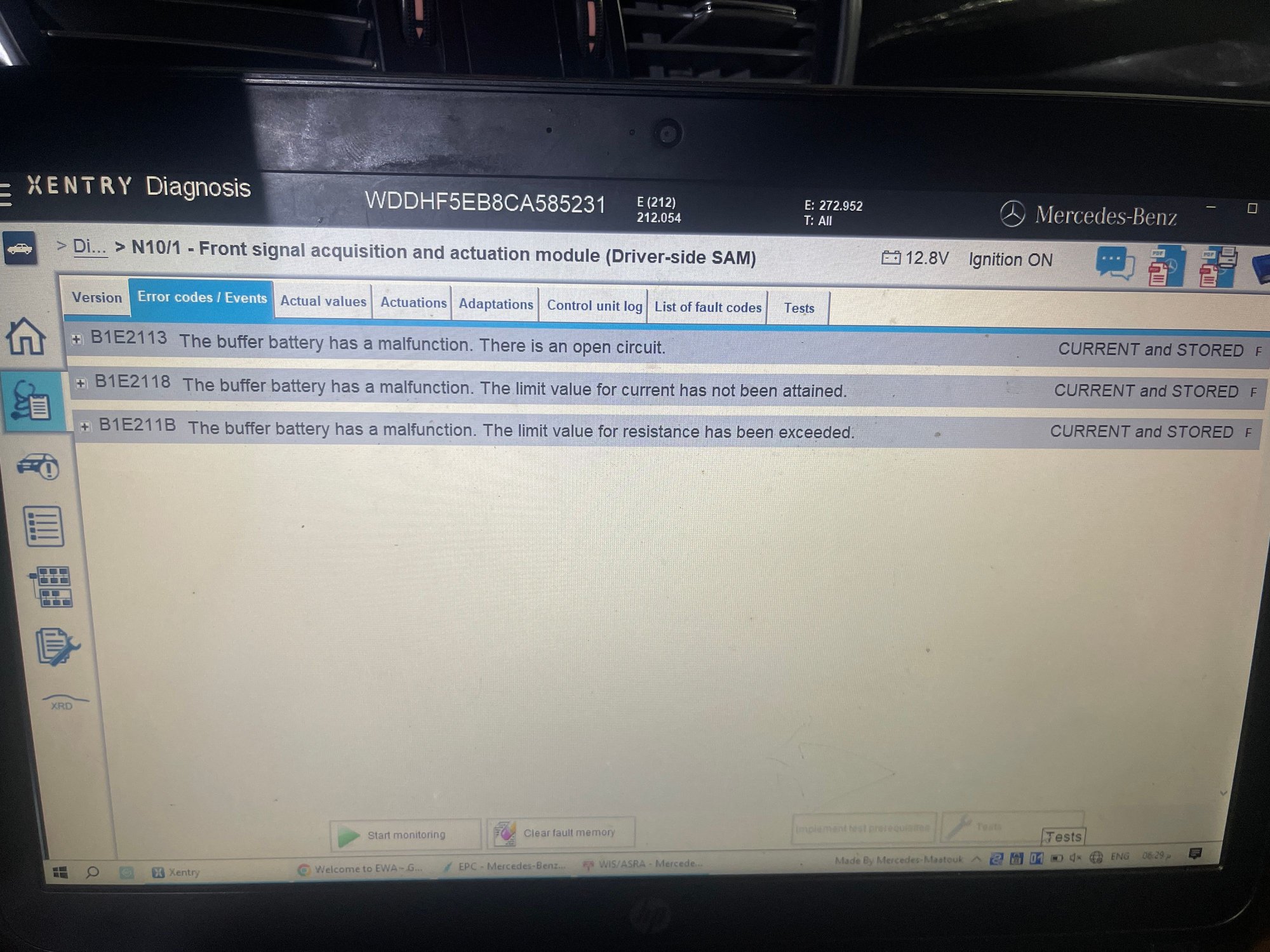

the power supply at the input of the control W212unit combustion engine has a malfunc

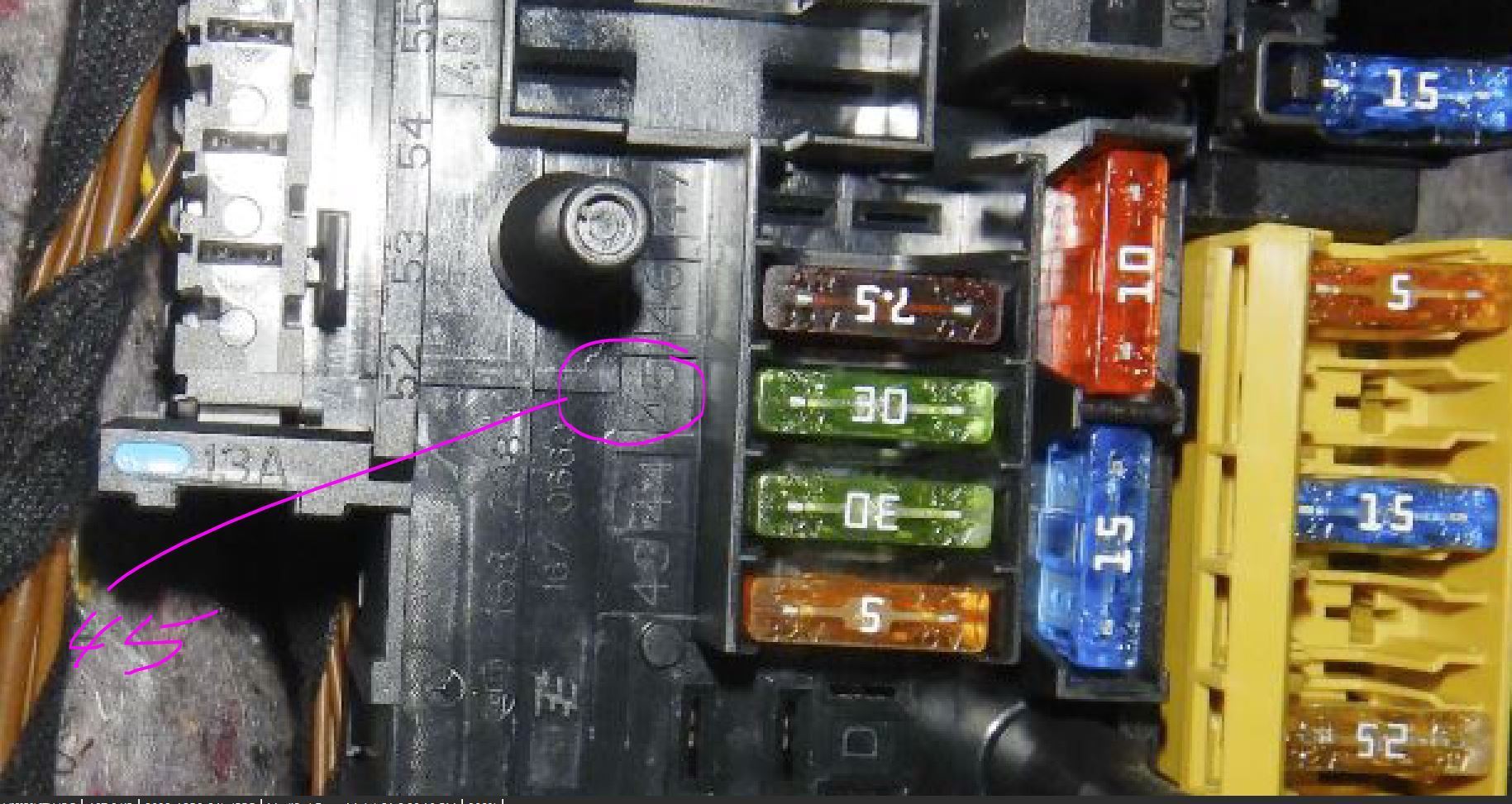

I have previously replaced it completely. But I mean the location of the F45
Old Nov 4, 2025 | 05:04 AM
S-Prihadi's Avatar
Joined: May 2018
Posts: 6,476
Likes: 6,427
From: Jakarta-Indonesia

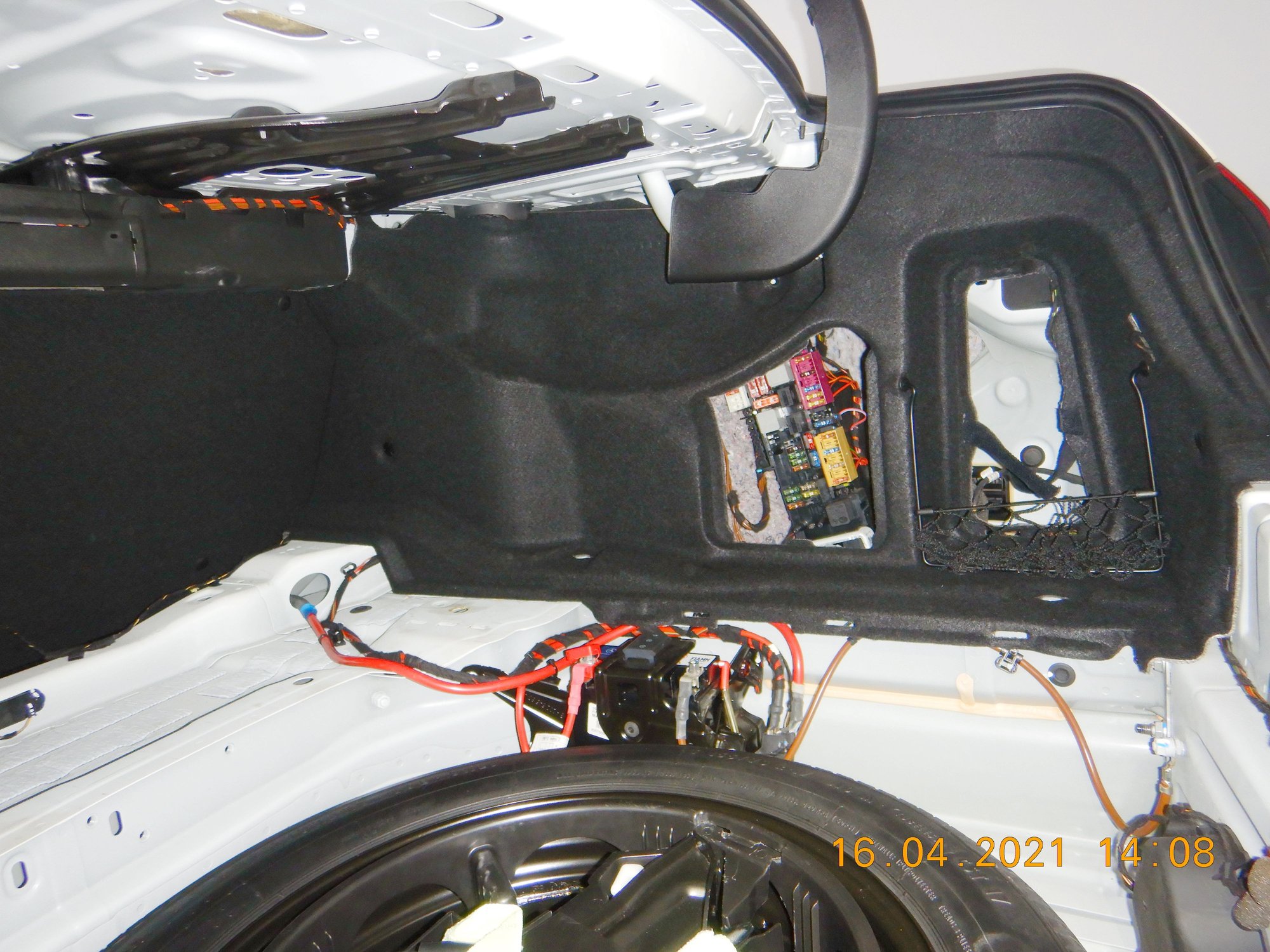

ohhhh sorry, F45 is at the rear trunk if W212. Yours is W212.054 using M272 engine.
I was quick reading Tim's post and I thought it stated front SAM N10/1
Here is rear SAM fuse block. Right side of trunk , near rear tail light. There is a small window u can pull out, the hairy interior "wall".
Read my post +5 minutes after I post. There is a delay in image upload today by the MB server
The 3rd picture is not up yet....damn, what a delay.=======now it is up. All 3 pictures. So expect up to 10 minutes delay.LOL

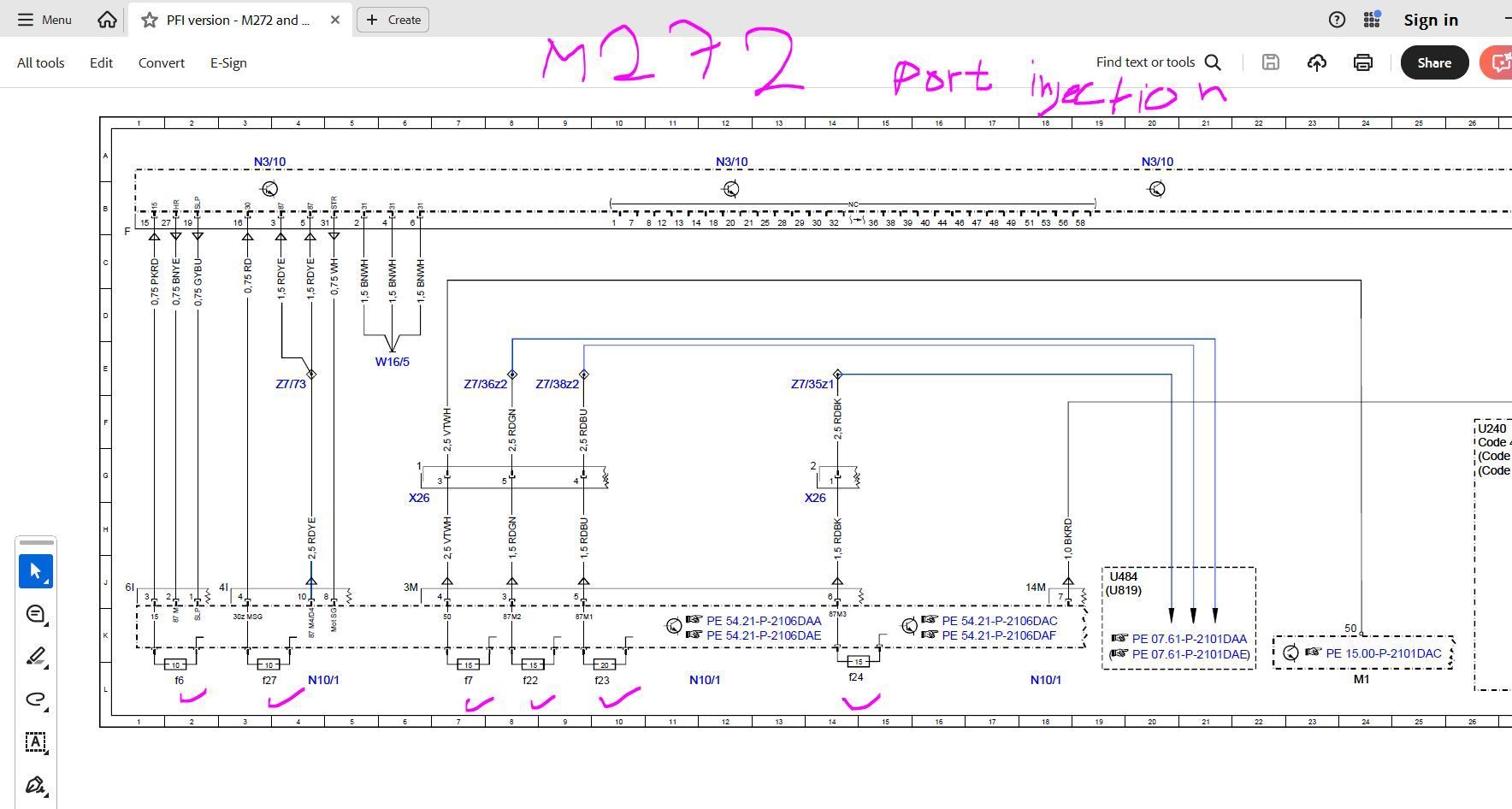

Here......... wait 5+ minutes for image to appear after my post time.
Fuse 6, 27, 7, 22, 23 and 24 feeds your engine.
2 PDF attached.
Your engine is normal port injection M272.952 3.0 liter, if W212.054
Good luck............

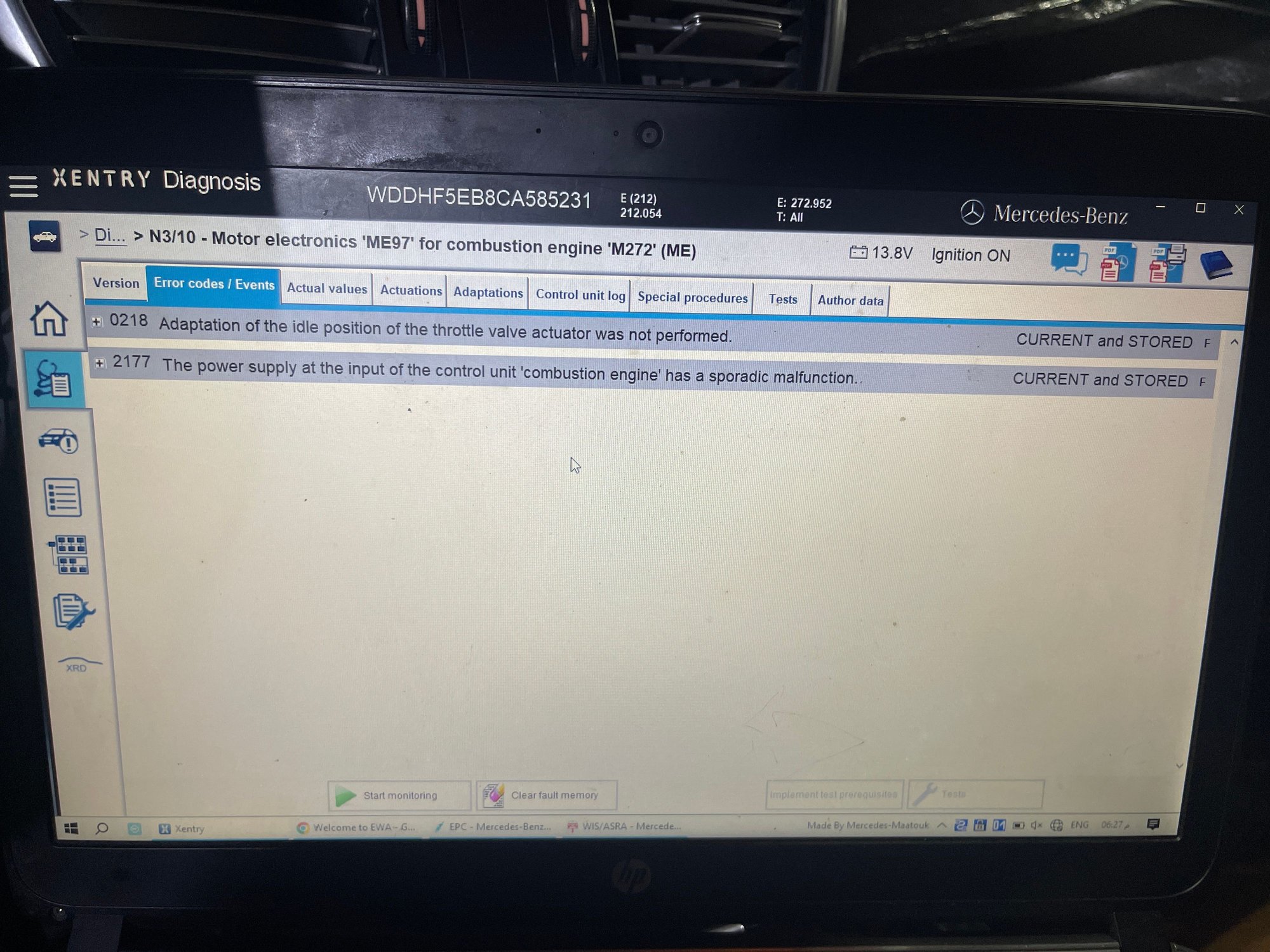

My friend, I checked all the fuses, then I completely replaced the fuse box, and then I replaced the engine control unit, all to no avail. I actually reprogrammed it.

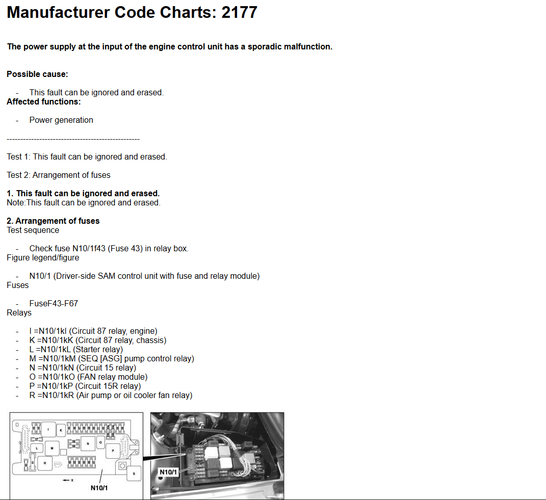

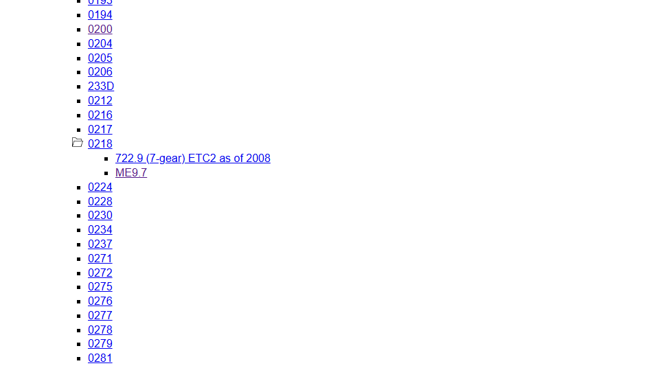

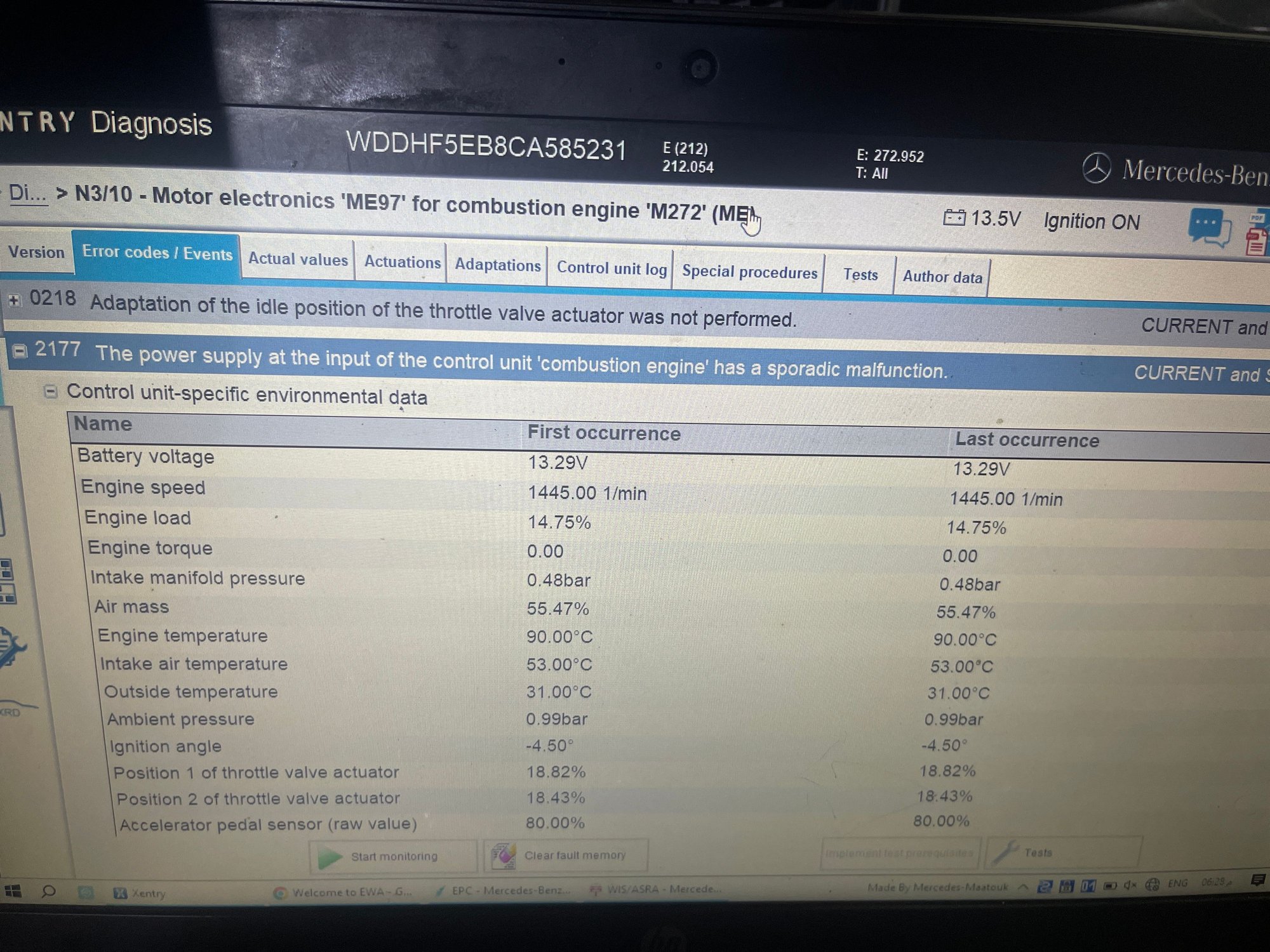

2177, I dont have data on this DTC, FAULT SETTING CONDITIONS <---- I want to see this
My engine computer is not the same as yours. Mine is newer MED 1.7.7.xx , yours is ME 9.7
Go to your Xenty N3/10 section and see the DTC list and find 2177 and take photo.
Below is 1st photo.........
NOTE : P2177 is different to 2177.
Below is 2nd photo
Expand this information and take photos. Complete data yah.
Tell us the complete history of this car, when it come to you and what you did and up to the point you are asking for help today.

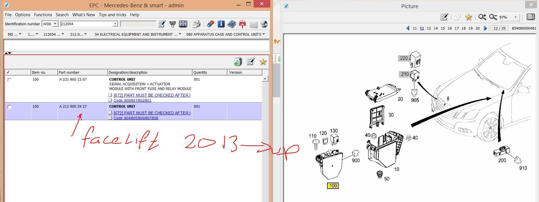

History is important. Example,the Front SAM has 2 version, facelift and non-facelift as per EPC. If you got wrong one, it will surely cause you problem.
Below is 3rd photo

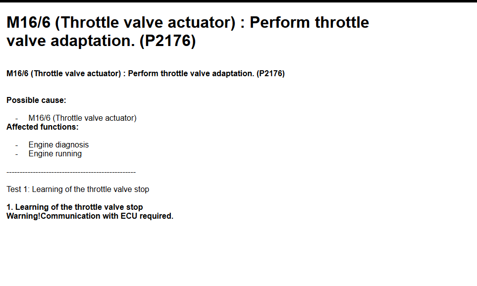

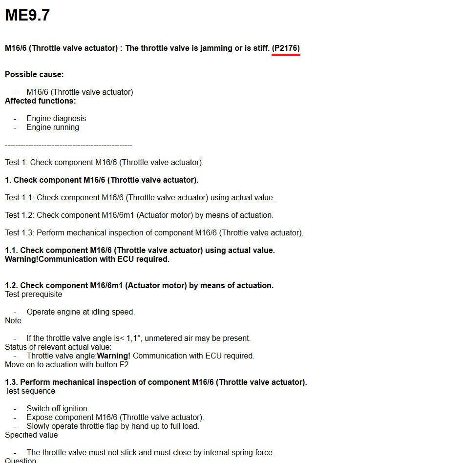

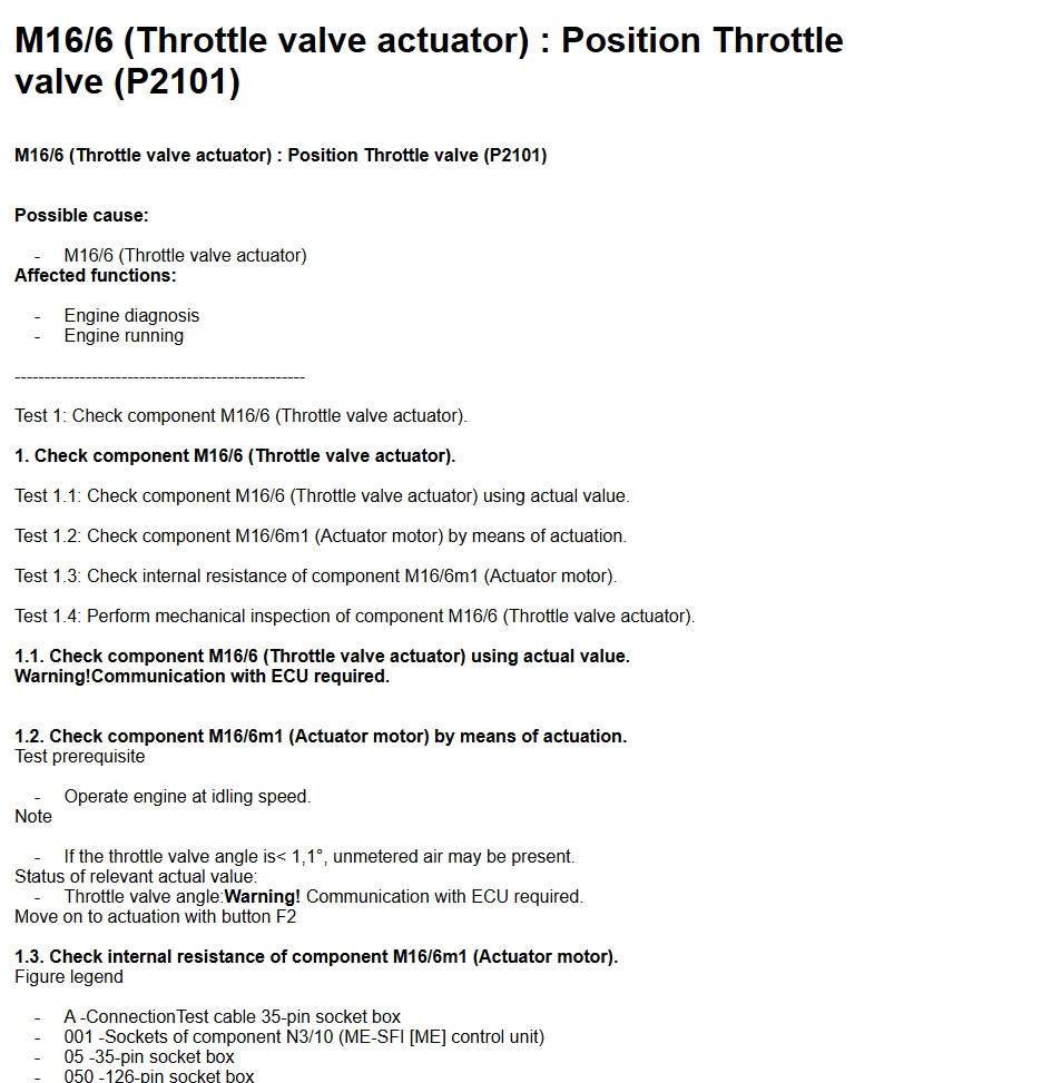

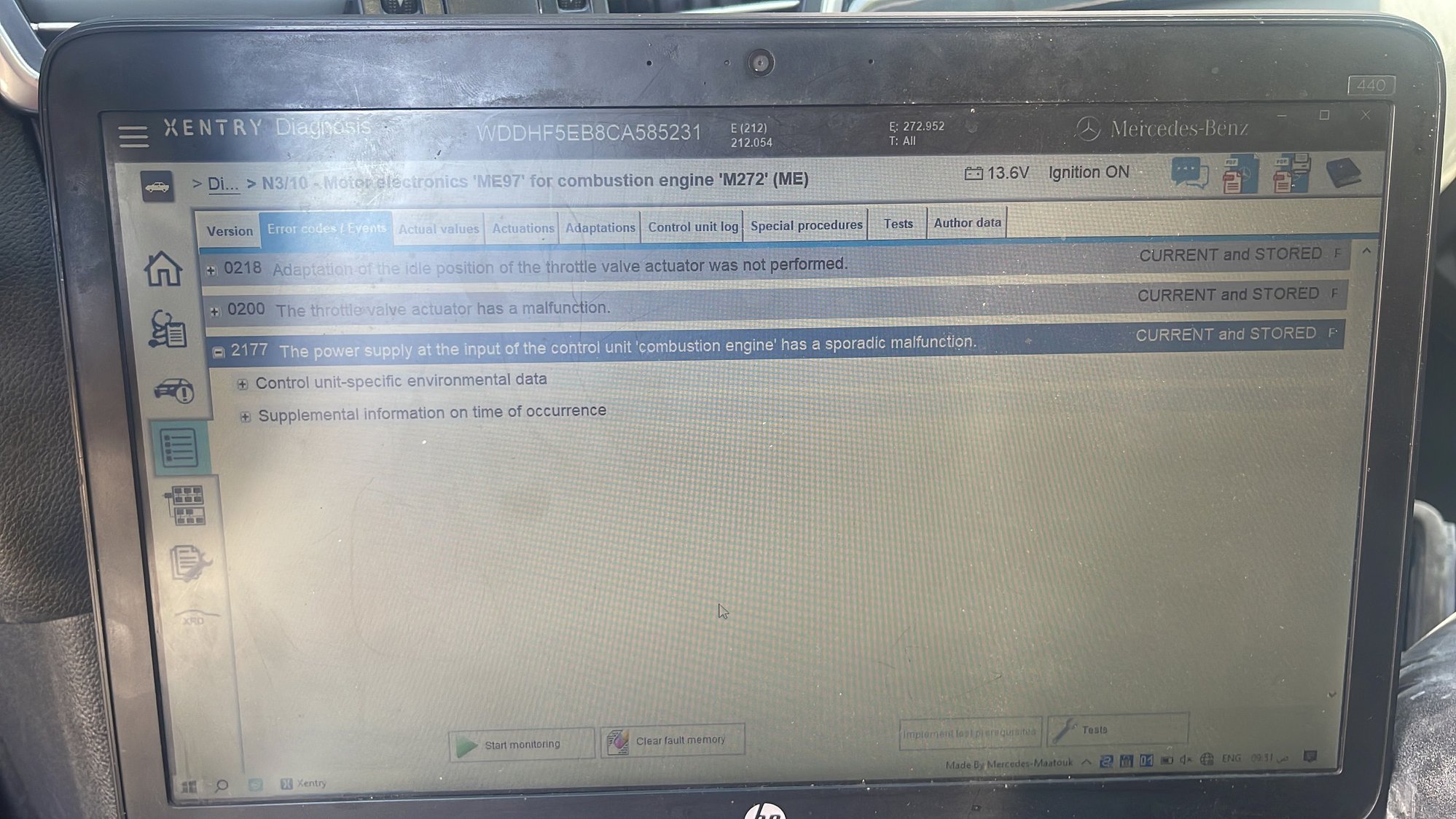

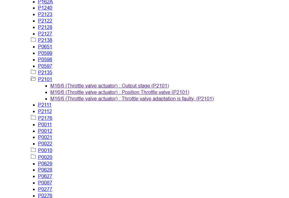

I saw another thread of yours the other day and after I looked up the 2177 code I focused on the throttle valve codes.
You mentioned you replaced the throttle body? What brand did you install, Genuine Mercedes?
I looked up the 0218 and 0200 codes and came up with below:
Then heres 0200:
Then heres 0200:
​​​​​​I change throttle body Used original Mercedes 3time I think my problem not throttle body I think Weakness in the electronic control unit
