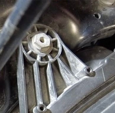

I'm hoping to get some collective wisdom on a frustrating issue I'm having with my 2010 E350's driver's side headlight.
Today, we successfully replaced the driver's side xenon bulb and the headlight ballast. Everything lights up fine now, which is great! However, the driver's side low beam is now aiming ridiculously high—it's essentially blinding oncoming traffic and illuminates the treetops. The passenger side is aimed correctly.
We tried to manually adjust the height using the part visible in the picture, but turning it didn't seem to make any noticeable progress on lowering the beam.
Any ideas and suggestions are appreciate and welcomed!

I just played with that screw. If you have any photo of the other two, i would appreciate it.
I guess we did put the bulb correctly as it was secure and wouldnt come off at all.
For better understanding, when i turn on the lights the passenger one moves down and up more, while the drivers side is more like high beam and slightly moves up and down after turning on comparing to the other one
