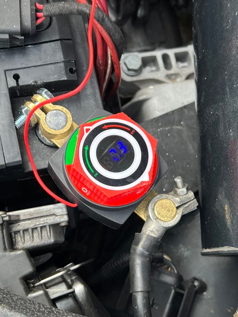

I have this on my Audi TT because it doesn't get driven a lot. It's cool because it shows the current battery voltage whether it is "on" or "off". BUT, it is in the engine compartment and not hidden somewhere in the car. I have it attached to the negative terminal since that is the side you are supposed to disconnect first. For our cars, a trickle charger is probably easier if you are close to an electrical outlet.
