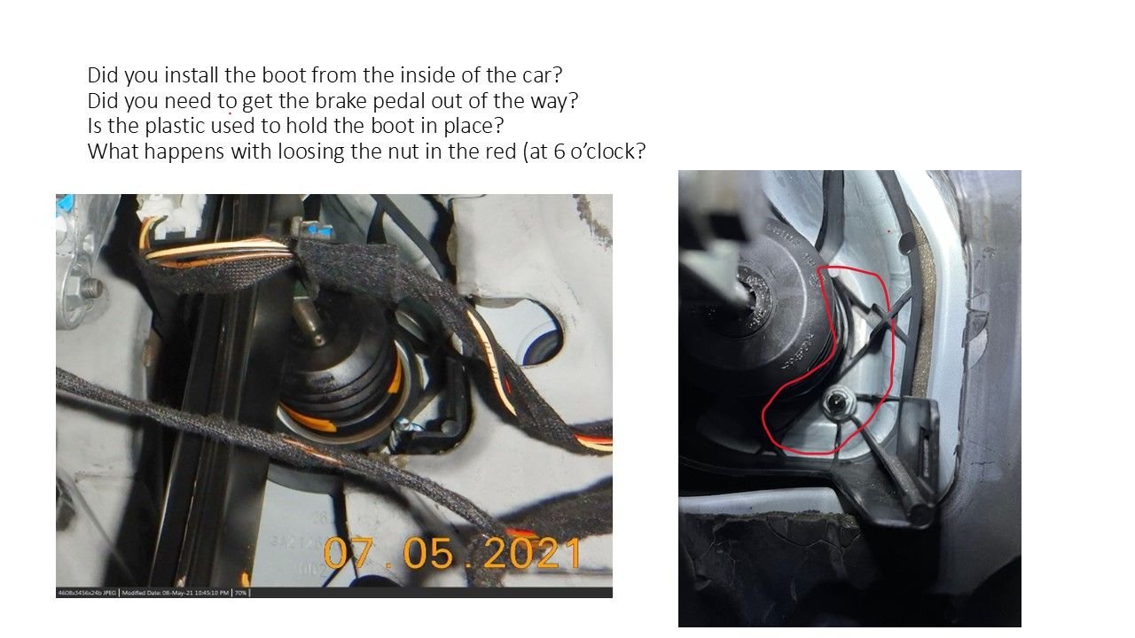

Still messing with getting the boot back in place. Any one else with a W212 or W218 that has a close up picture of the boot connected?
Here's a pricture of mine. Is the boot with the tabs folded outwards or just attached by the tabs?
Also on prior question from CaliBenzDriver, the PCV is working well. There's negative pressure at the oil cap. I have a mechanical pump, no aux electric pump assist.

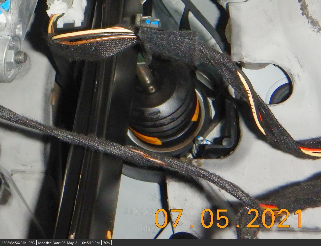

See if this can help......
This is the best image I have for my brake booster
See these too.........
and
Always check ebay for used parts, often high quality images available.

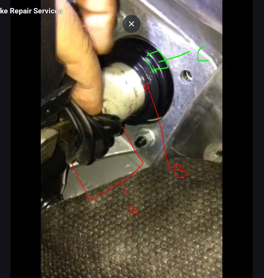

It seems these are how they are arranged and their function , 3 items below :
Guesstimate :
A is more of a dust seal. Like our shock absorber dust boot.
B is the VACUUM seal which was replaced in the URO video. Dynamic seal, takes the sliding in-out friction workload.
C is part of the VACUUM seal assembly of the booster fat body. Static seal.

Did you get a new boot? The filter material on my boot came off both on the outside (as you picture has) and on the inside vent slots (not shown). Where to you get the filter material?
There's also very little space between the plunger seal and neck of the booster for the dust boot to hold on (my exposed C is very narrow).

I did not do anything to my brake booster , it is fine.....I just took photo in 2021 for wiring thru firewall and I documented what are the stuff there hidden.
