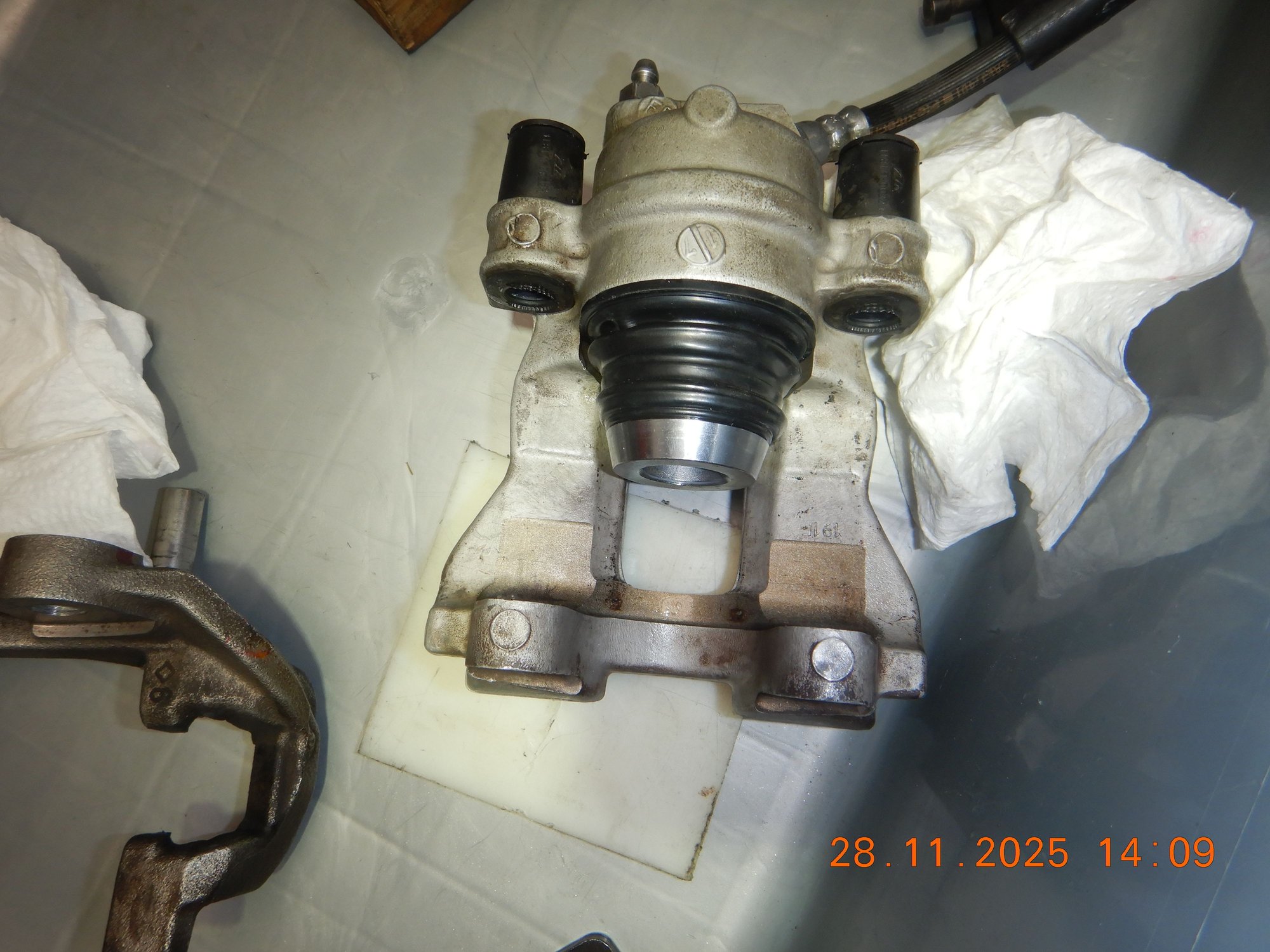

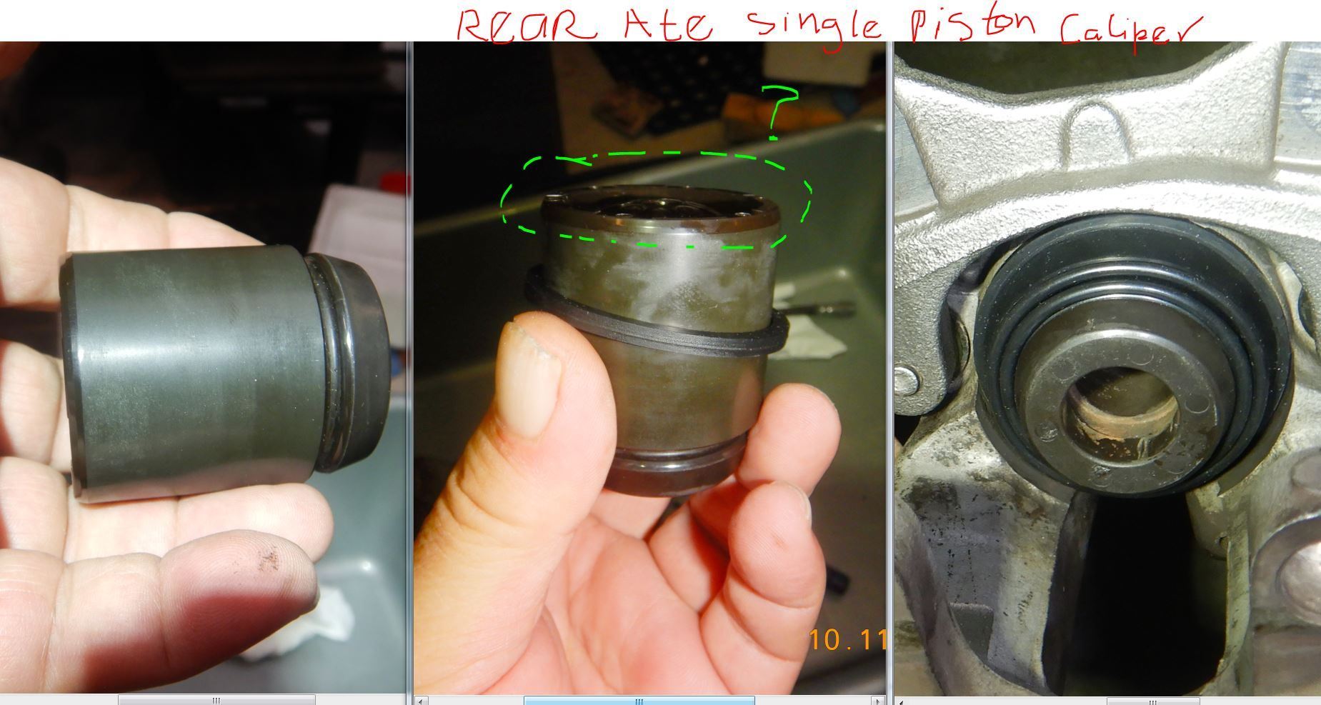

I am still not satisfied that the piston did not retract properly when brake pad is 100% new/thick and also new virgin the rotor disc.

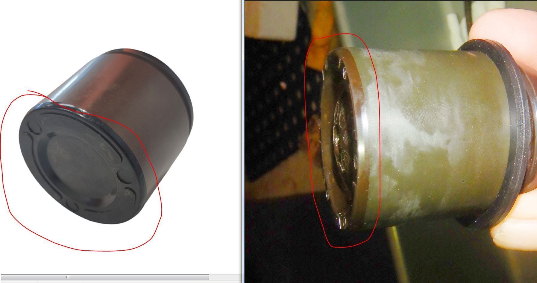

At first I thought the ATE rear caliper piston is aluminum like front Brembo 4 pistons caliper.
But the more I think how crazy light it was and its fine details, and some google search ( the AI maybe wrong though ) stated : phenolic piston
See the rear end, I circled green with question mark.

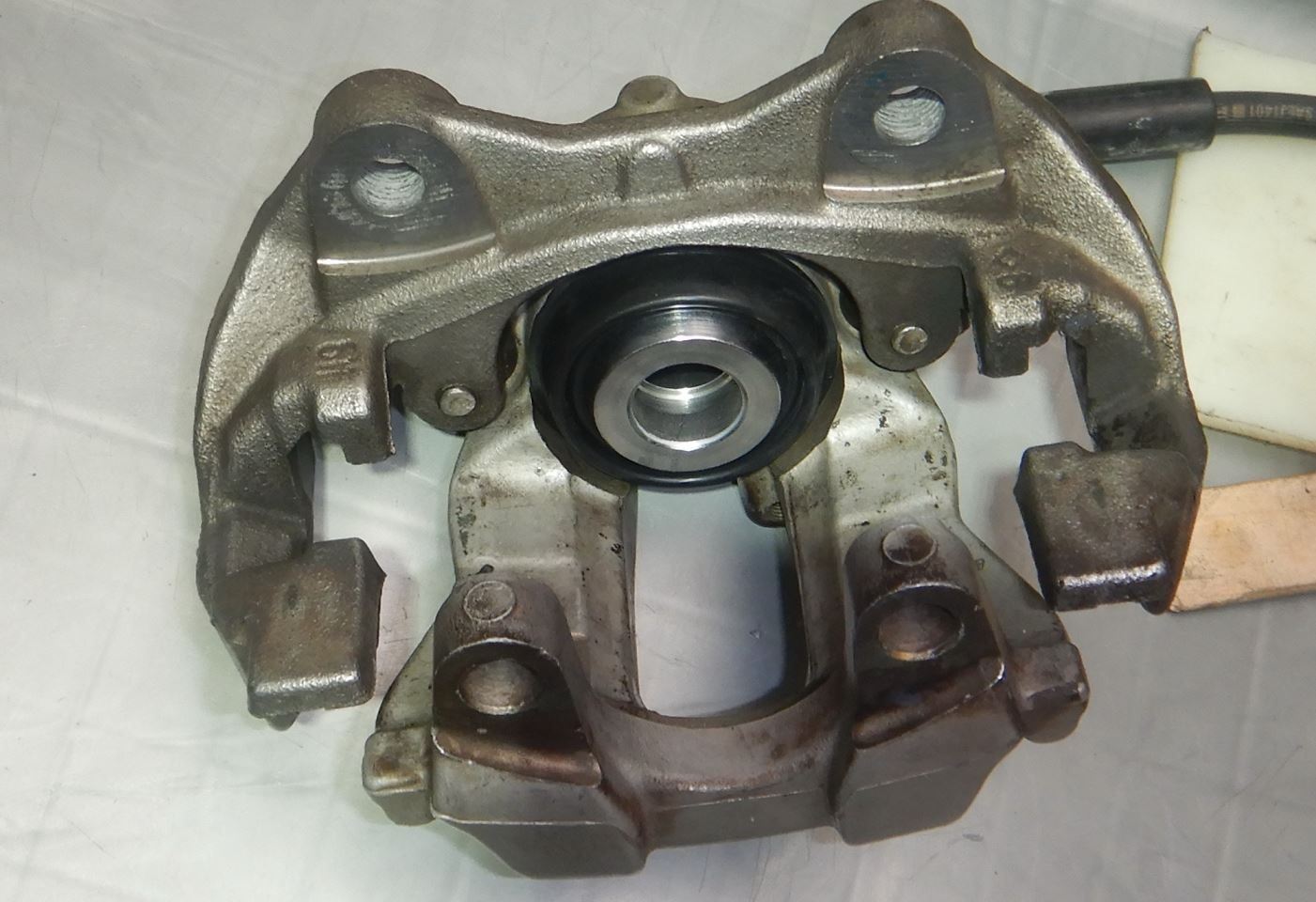

FRONT Caliper, aluminum guaranteed. Its different.

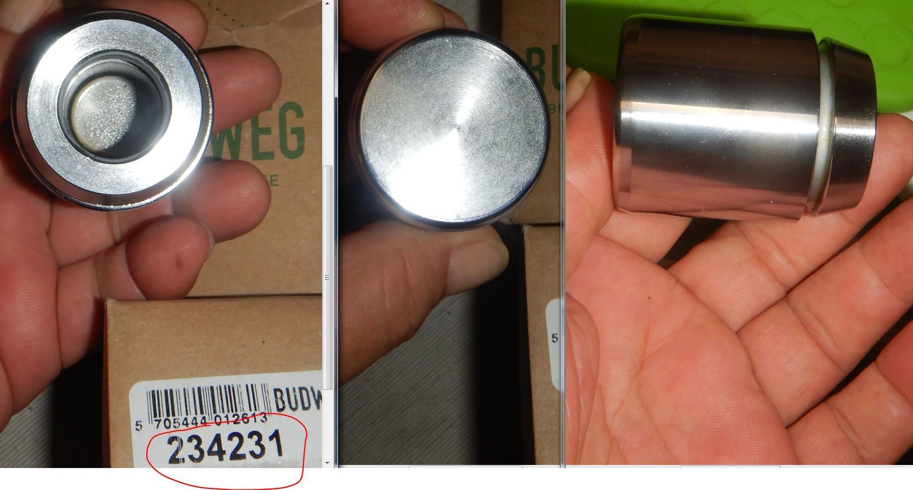

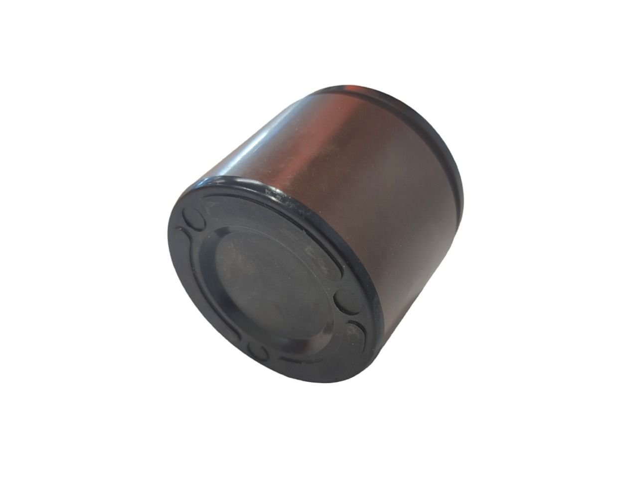

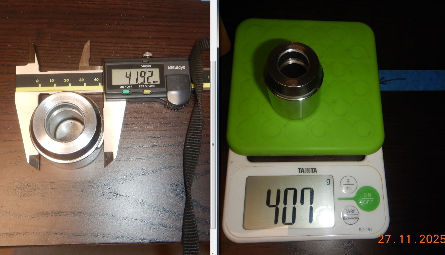

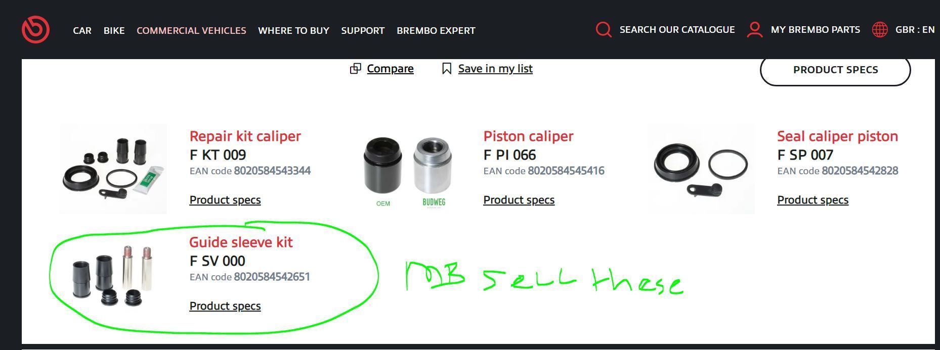

The Brembo supplied rear caliper piston for ATE and by BUDWEG, just arrived. F PI 066 Piston Caliper
It is steel, and coated with chrome I guess.
I was suprised by the heavy 407 grams of weight of the Budweg....hence it triggered the question.... on if the original ATE piston is phenolic type because it was crazy light ? I never seen phenolic type caliper piston.

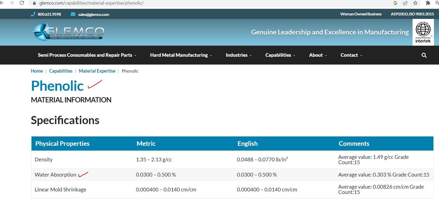

Aluminum is 2.7 grams per cm3, steel is 7.85 grams per cm3, whle phenolic caliper piston is only 1.35 to 2.13 grams per cm3.
This is what I do not like about composite material, it will absorb water and that meant it can swell if we submerged it long time enough in the said liquid.

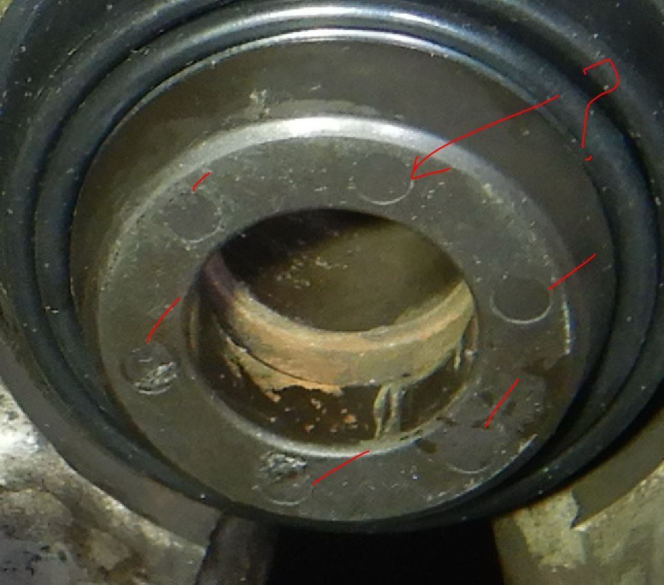

Damn, the phenolic piston surely looks like anodized aluminum ......
https://trojan.co.nz/mk3-hydraulic-c...-aa2e4180c11e/
The dead give away is the azz details. If aluminum, I dont think anyone wants to waste money to machine such shape.
ATE front, circles also waste of money, if this is aluminum metal.

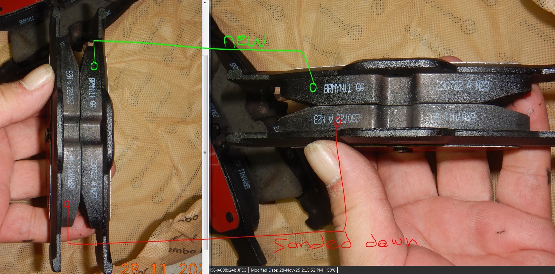

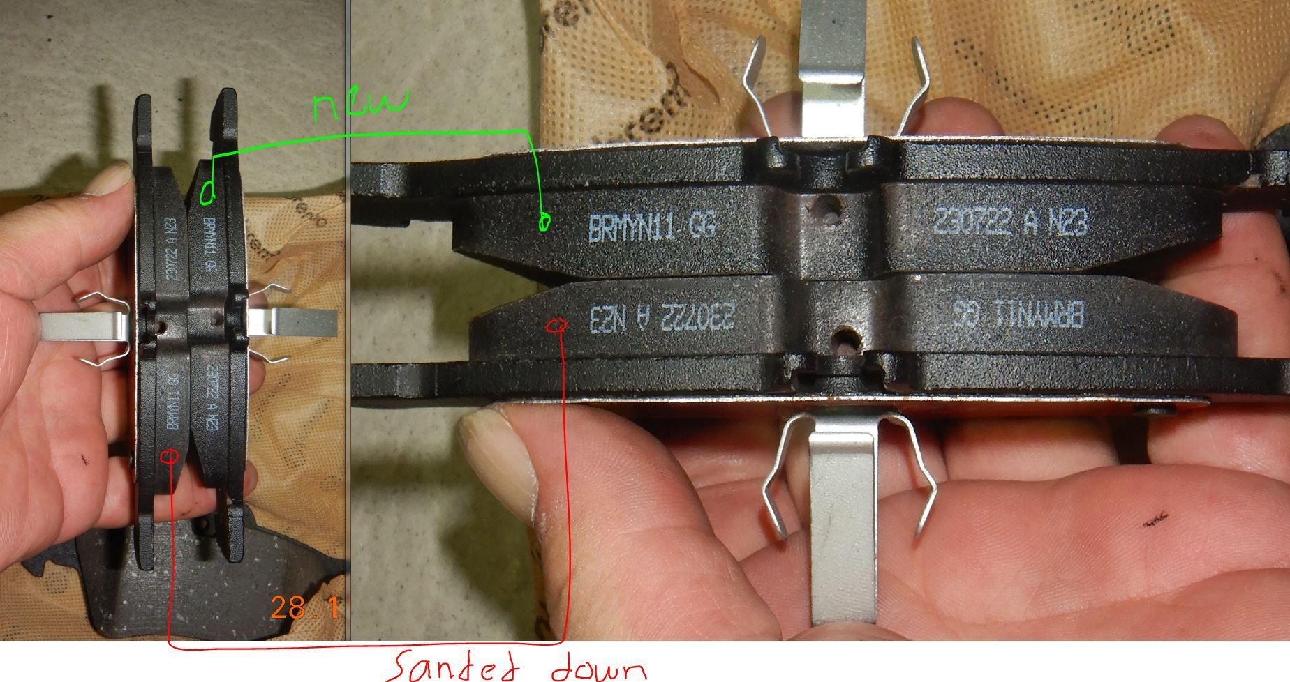

New Brembo rear brake pad on order ( again, 2nd time ), because I already sanded down the first purchase one by 1.5mm off to make the oldie piston able to retract properly.
So I can start the experiment if possible this week with 100% new thick Brembo pad and while my rotor disc is still new-virgin thick and solve the mystery once and for all.

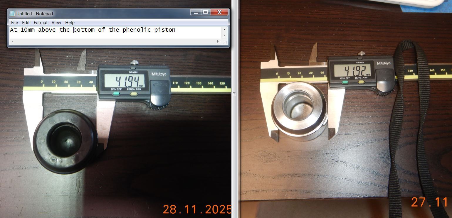

Damn-it, indeed the ATE piston it is phenolic, PLASTIC !!!!
You guys with single piston or dual piston but floating front caliper.......... may check, if you also get phenolic piston.
407 grams the Budweg steel piston vs 106 grams ATE phenolic.

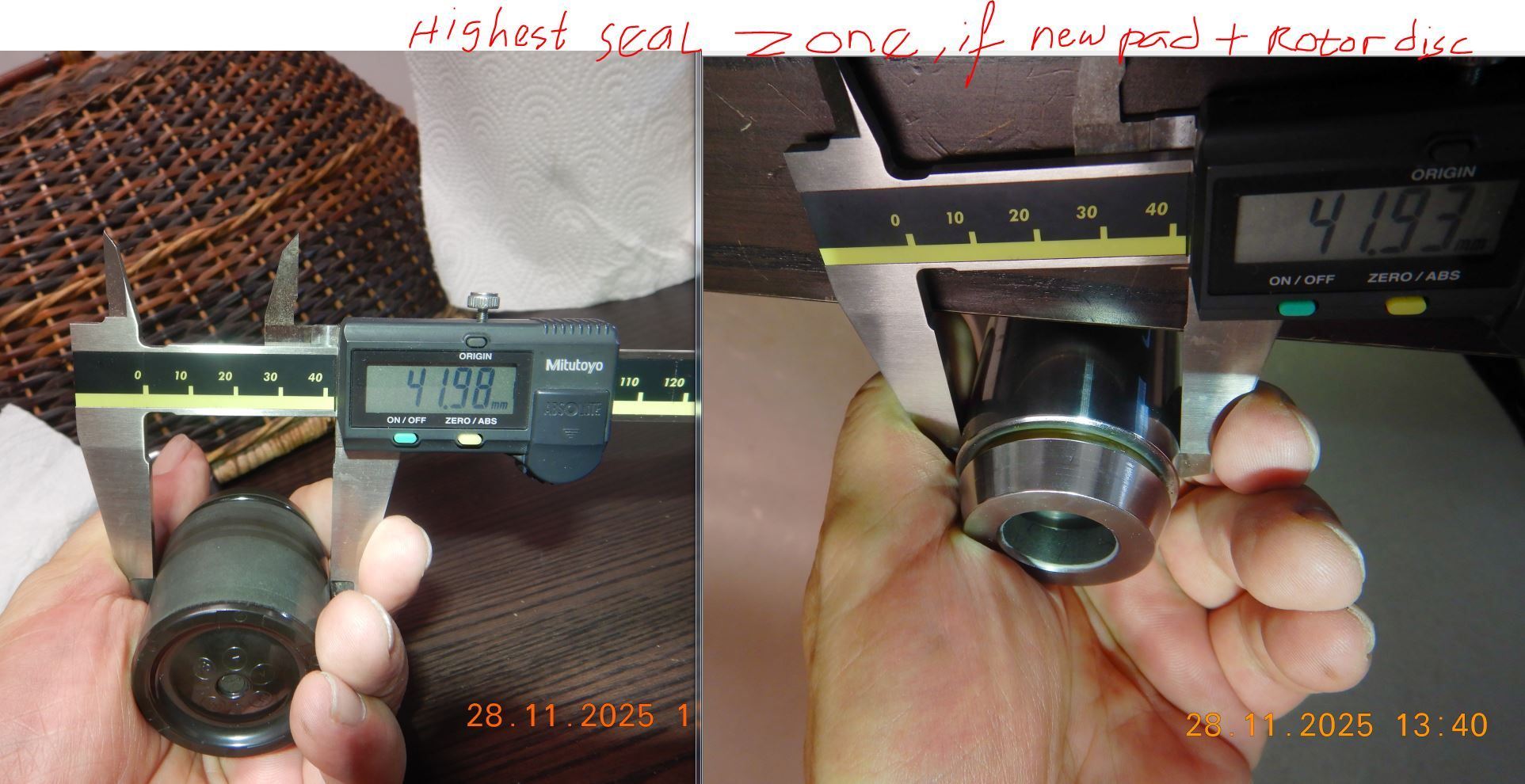

Yep, the phenolic piston swell at least by 0.04mm at the top side. This is why when 100% thick new brake bad and new rotor, piston did not retract properly.
Budweg steel piston installed.
New Brembo, vs the one I sanded down by 1.xx mm

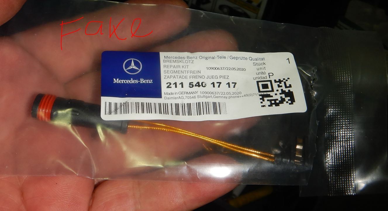

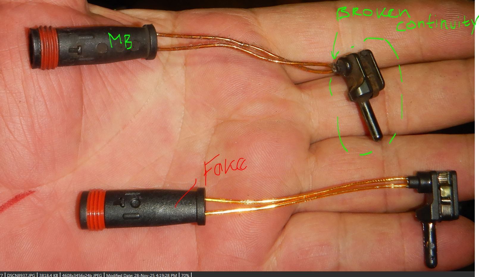

Knock-Off / Fake MB brake pad wear sensor , the new one. Not bad, it works ( too simple a product to NOT work ) and decent quality. US$3.00 vs genuine at US$19.00 .....
I insert-remove-insert the sensor so many times during this rear brake pad ordeal, it simply gave up ....LOL.

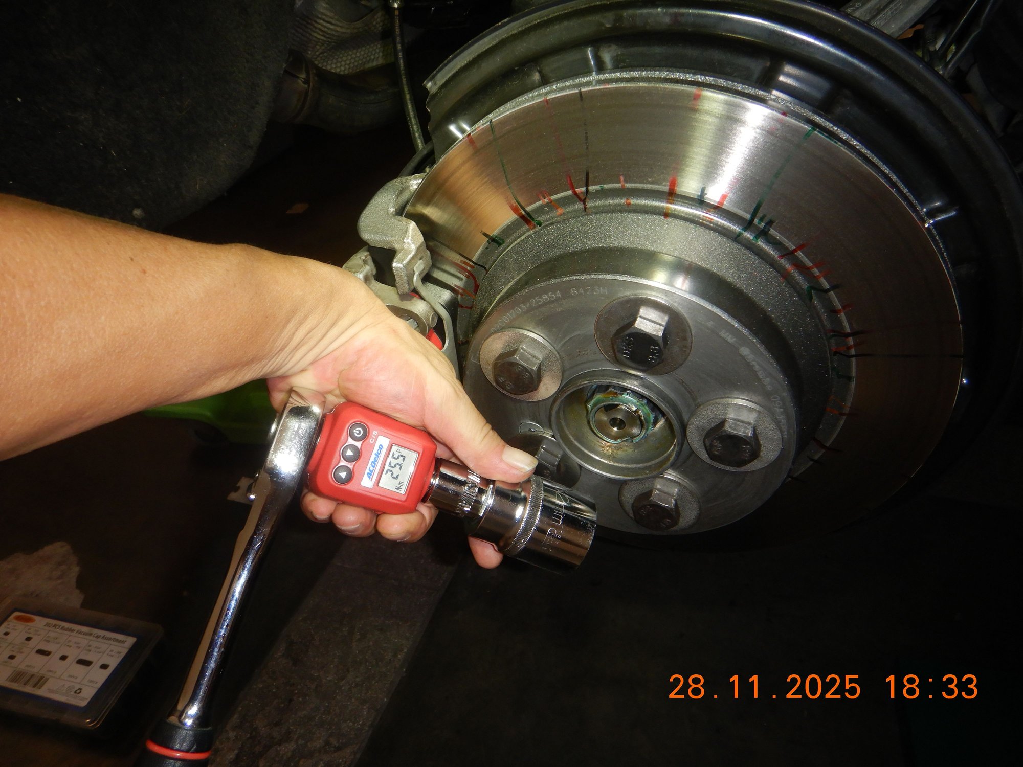

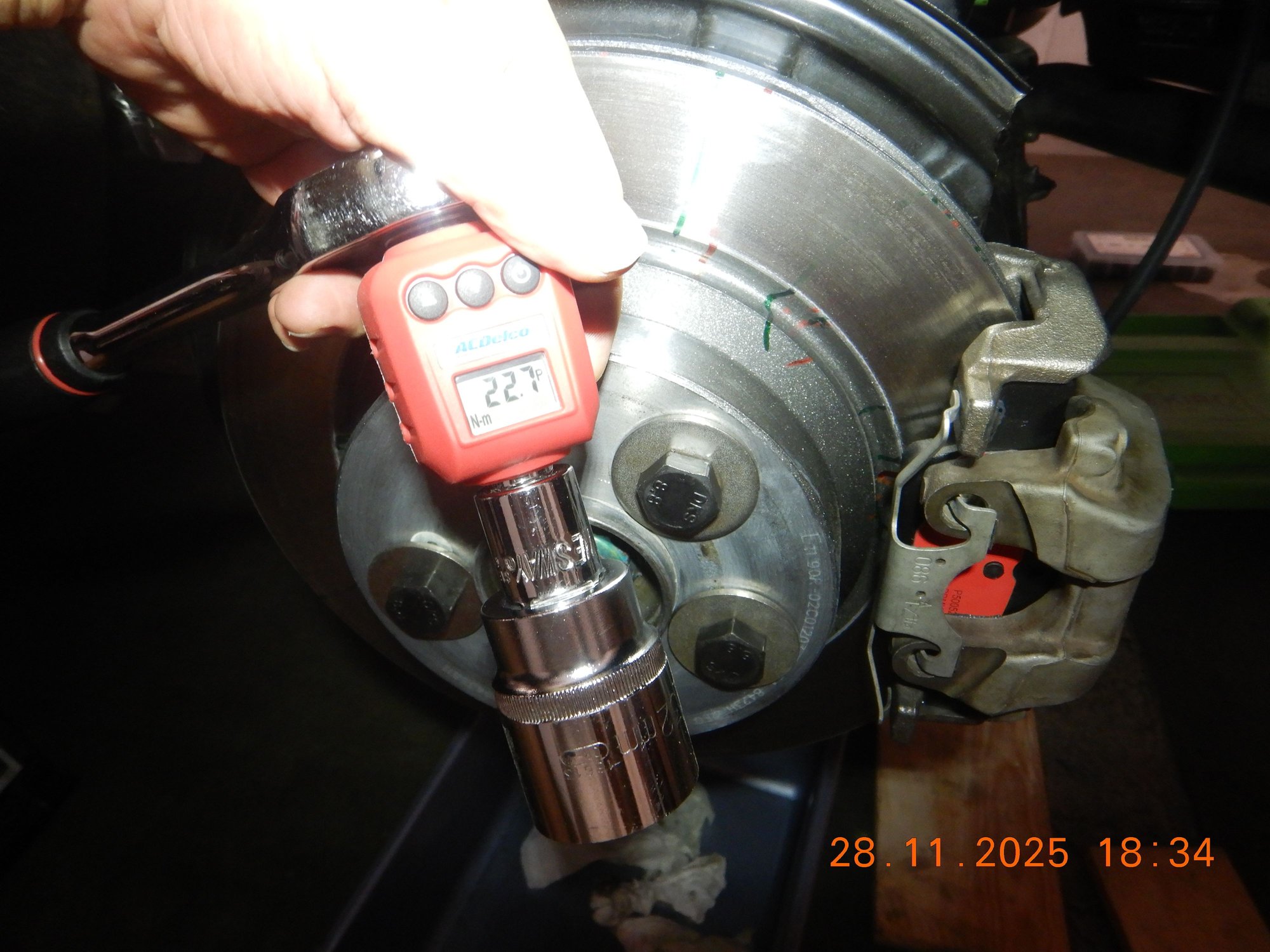

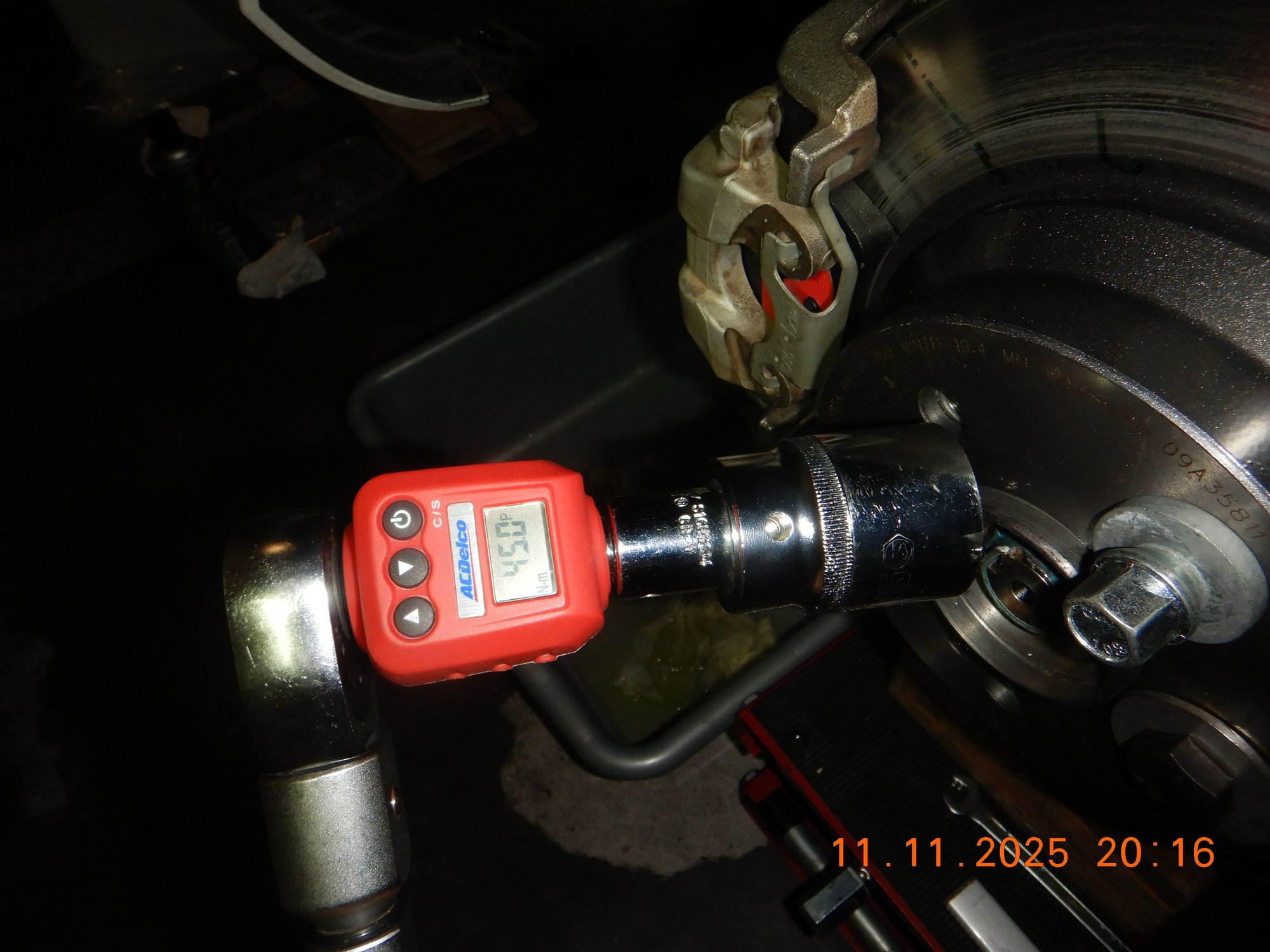

The newton resistance , which is torque to initiate spin of my rotor disc and my LSD DIFF.... meaning the other wheel spin too....the reading is low enough.
This reading also included the parking brake pad minor touch if any.
Right braking system 25.5 Nm , tranny NEUTRAL, parking brake zero click. Clockwise spin for Right side to simulate car moving forward.
LEFT braking system 22/7 Nm , tranny NEUTRAL, parking brake zero click. Counter-clockwise spin for Left to simulate car moving forward.
================ LOOKING BACK=========================

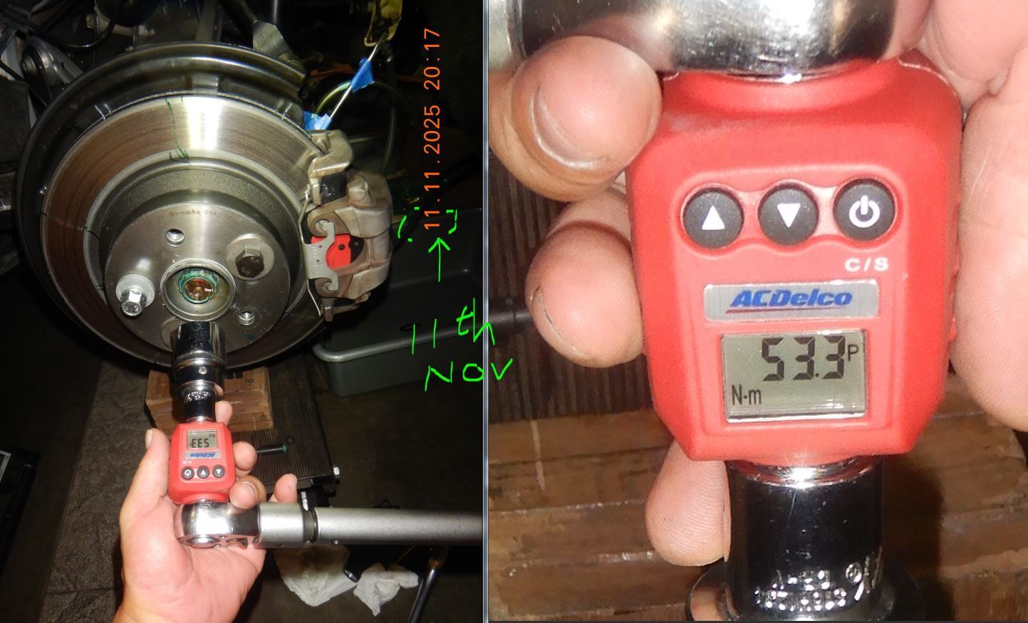

The phenolic piston with new Brembo 100% thick brake pad not sanded and new virgin rotor was giving 45 to 50Nm of drag, due to the phenolic piston did not retract properly.
11th Nov 2025 archive............
Phenolic piston and 100% new thickness Brembo brake pad not sanded down. RIGHT SIDE. 45Nm
Phenolic piston and 100% new thickness Brembo brake pad not sanded down. LEFT SIDE. 53Nm
