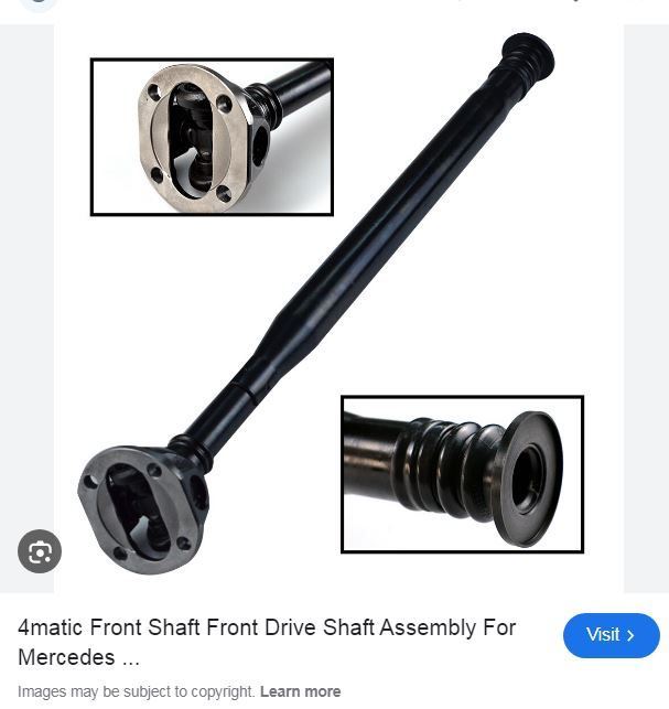

Item 5 if not genuine MB, get genuine
Item 8, are you talking of propeller shaft for front DIFF and rear DIFF asI shown below ? If so go MB genuine.
There is another expensive "disease" of 4-matic propeller shaft, the part inside the tranny.
Some back story on how the vibration started would be helpful.
Any "accident" or high speed jumping over pot holes or something of that nature ?
Also have you roadforce balanced/inspect all 4 tires ?
Hunter balancer can do it.
Items 5 and 8 are genuine Mercedes. And yes, those are the two parts I was talking about!
Of course. So the car was involved in an accident where the front right side was hit(Other driver tried to enter the highway via the exit. They were on the phone). When I got the car back, that’s when I began feeling slight vibrations. As time passed on, it has gotten worse.
If I can find a picture, I’ll post it here.
I considered something with the transmission or driveshaft related. When the guy towed the car, he couldn’t get it in neutral so he just towed it as is. I’m worried this affected the transmission such as that prop shaft you mentioned.
Is there a way I can go about testing this?
