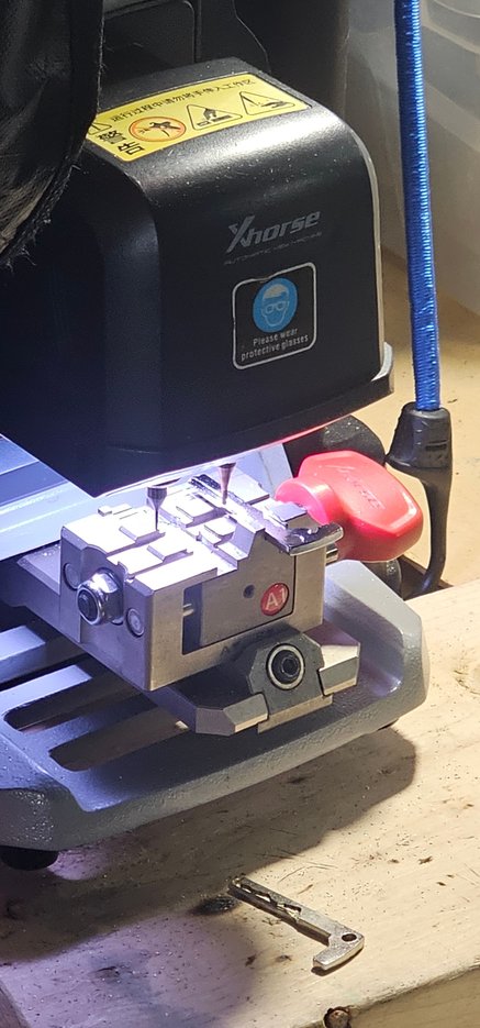

I found a local guy who came to the house, had the fob, programmed it for the car and only charged me $200 for the whole deal. It''s the "non keyless go" fob so it has to be put into the ignition module to start the car but it's a spare key so it will work. Kind of crazy that you either can't buy a new fob or you can only get them from a dealer for a grand with programming but an independent guy can do one for $200. Ah well. Time to go to see the Mouse

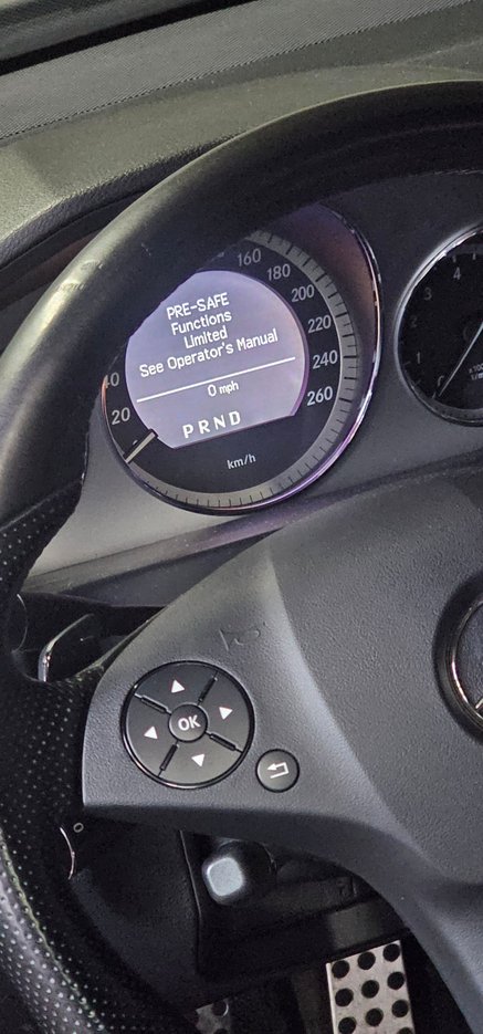

Aftermarket keyless go is working!!!! This is available pre 2015 models only. If you need one it will.cost you $500 (includes shipping in the US/Canada). You will need to ship your keys to me to make this work however. So sending it to me use fedex or something that you can trust. Takes 20min. for the car to recognize the key. After that....push away like typical original MB key. Price will include keycut as well.
