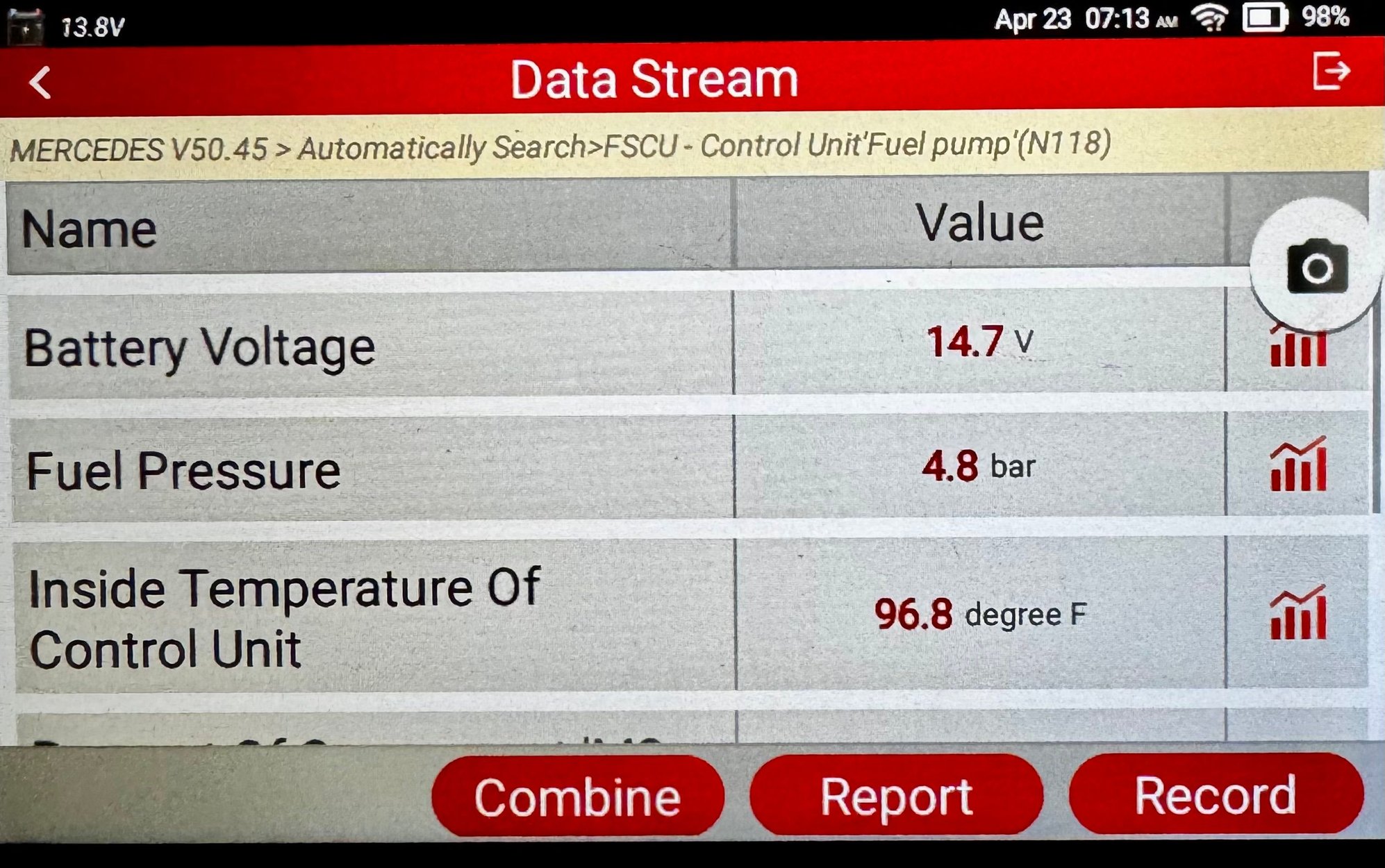

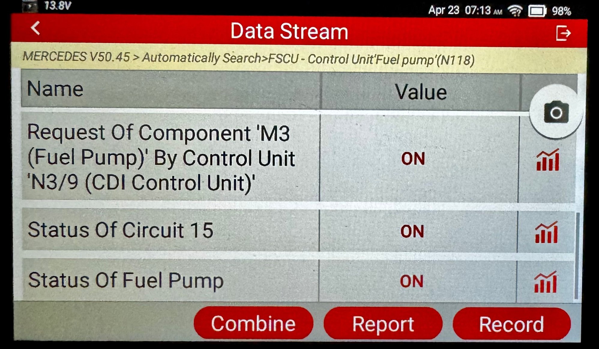

Old Apr 23, 2026 | 11:04 AM
johnfranciscog's Avatar
Joined: Apr 2017
Posts: 115
Likes: 66
From: Dallas, TX
2011 E350 4MATIC Wagon
Old Apr 23, 2026 | 01:35 PM
CaliBenzDriver's Avatar
Joined: Apr 2019
Posts: 11,964
Likes: 6,806
From: Silicon Valley
W212 MY'14 M276-3.5NA @75kMi
perfect fuel pressure
The live data on the 4x screens above look 100% ok !
Fuel is at exactly 70Psi static pressure... perfect!
Now see what happens to fuel pressure with engine operating under load.
Q: Does pressure nearly hold 70Psi or collapse ?
The answer will be pass/fail for fuel filter flow.
If "passed"... your engine is "bucking" for other reasons - Read any ECU fault codes?

two years ordeal
Originally Posted by Tacoz2022
its been doin thia for two years tho lol
Nicely predictable for two years... then likely voltage related - Fuel issues would have further matured by now.
New batteries don't help low voltage beyond first month - This may well be the oxidized prefuse drop.
Old Apr 24, 2026 | 09:38 PM
Tacoz2022's Avatar
Joined: Apr 2026
Posts: 15
2011 mercedes benz e350 4matic w212
like today it didnt do it at all
Old Apr 24, 2026 | 09:41 PM
Tacoz2022's Avatar
Joined: Apr 2026
Posts: 15
oxidized prefuse drop. Explain
