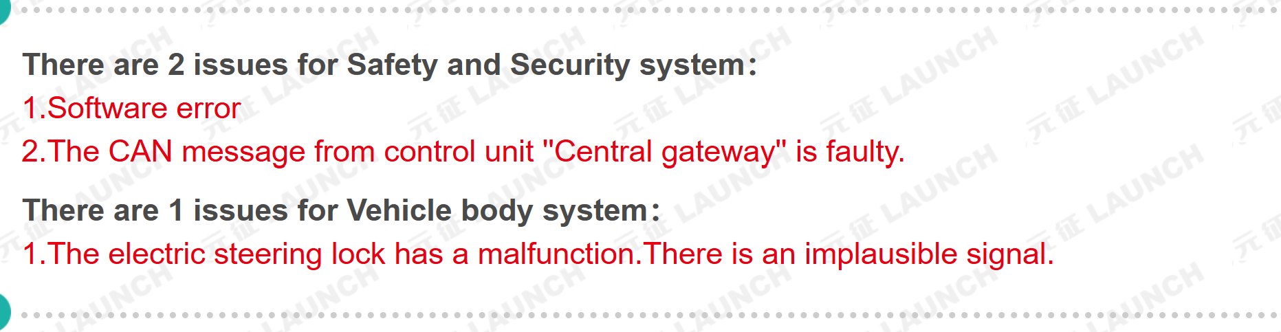

Thank you for the reply.
Here is what I am getting in the error codes.
I have tried clearing them but they came back again. Needless to say that these are with the car not starting.
Any clues if both the codes are connected and how do I go about them
Regards
BINGO... !
Your ESL has now produced its standard failure.
It needs to replaced or perhaps bypassed at your discretion.
Without this working starting is disabled for security.

Now I am left with two error codes. It's not clear if they both are connected to each other or not.
I am hoping that they will disappear once i disconnect the battery and do a cold reboot.
Does any know the location of the "Temp sensor 2" it is referring to ?
thanks
thanks
Temp sensor fault is lilely a pulled tinny wire at passenger footwell cover... a classic!
The way you're showing fault report does not show what module is reporting these faults. Let's not guess, look at the scanner itself.
