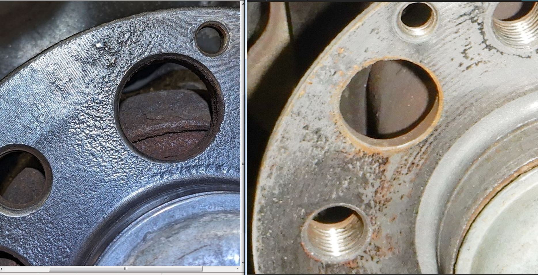

Hello, I'd appreciate any help to eliminate significant front brake rotor run-out and vibration after I replaced the pads and rotors. This is on a 2016 E350 wagon with 110k miles.
The front rotors I removed had about 2/1000" run-out and I could slightly feel it. I had to beat them with a hammer for five minutes to remove each one. The hub faces were significantly rusted. I used a wire wheel on an angle grinder to brush off the rust. Now I can see the circular lines on the face of the hubs but they are significantly pitted and may still have rust protruding. I didn't get a good read of the hub face run-out.
When I installed the rotors before cleaning the hubs, they had 20/1000" run-out. Braking with them felt dangerous. I removed them, cleaned the hubs, and reinstalled. Now they have 4/1000" run-out and braking produces annoying vibration. I might even feel a little vibration while not braking.
I measured the run-out of one new rotor (Zimmermann) on a lathe and it was under 1/1000", so I trust they are good. I lubricated the slide pins and installed new pads (Mercedes brand). I torqued everything to spec according to the WIS document. I can't think what else might be causing this.
What do you think? Must I replace the hubs due to rust damage? What tools could be used to clean them or make them flat? Could a machine shop resurface them? Or did I throw them out of spec from beating them with a hammer? Thanks for your input.
Front hub before cleaning
Front hub after cleaning

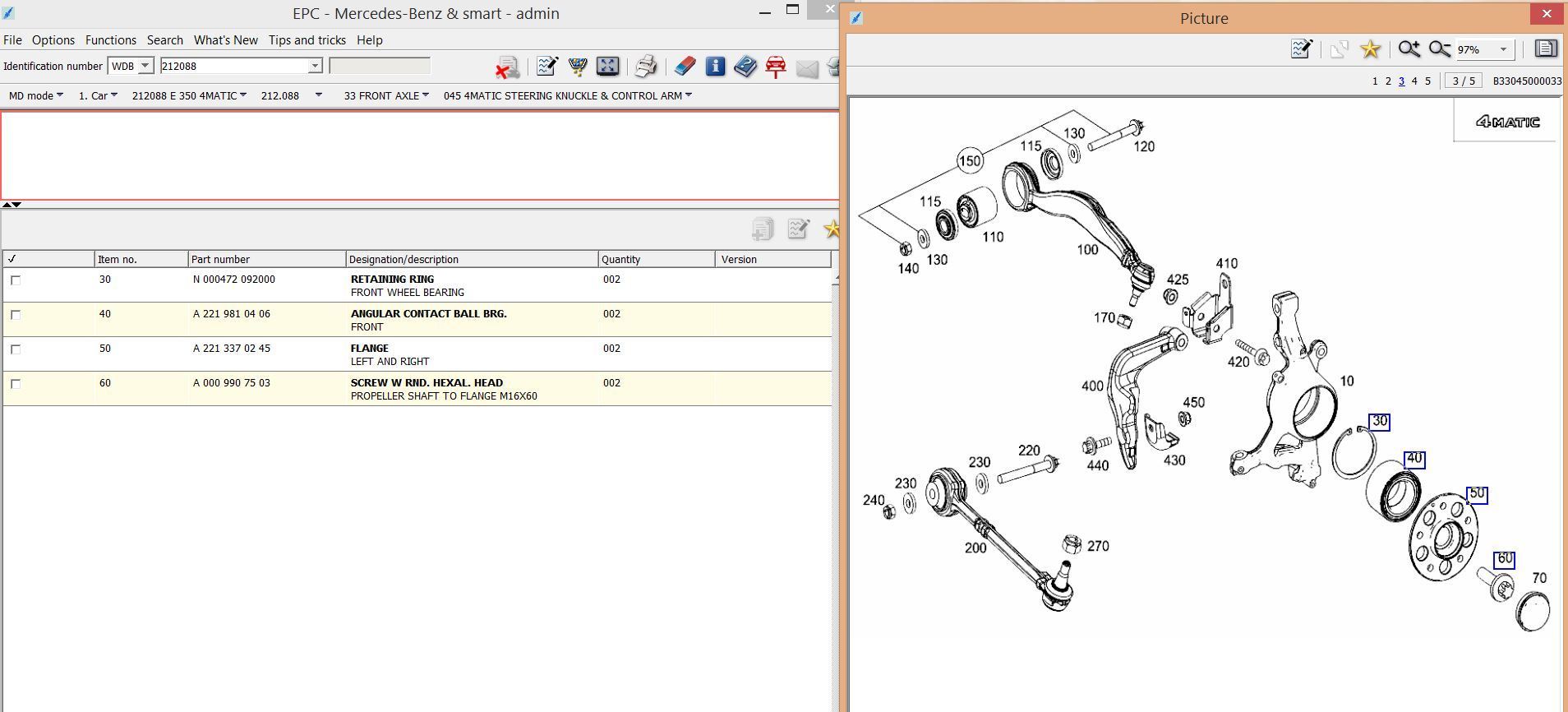

If I were you, I would replace both L/R hubs which is called the flange, the bearing and the circlip. WIS attached.
Item 50. The flange or hub

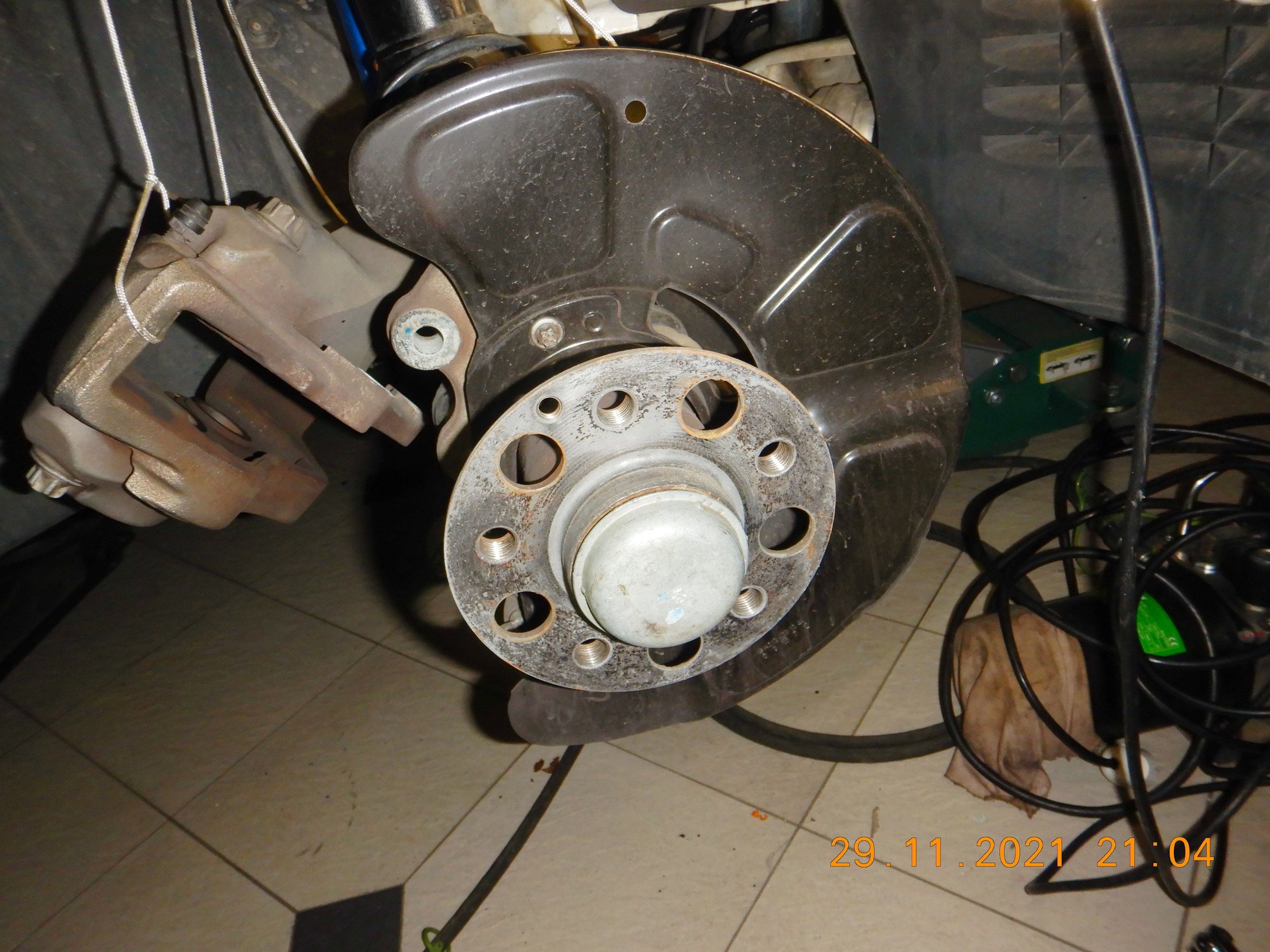

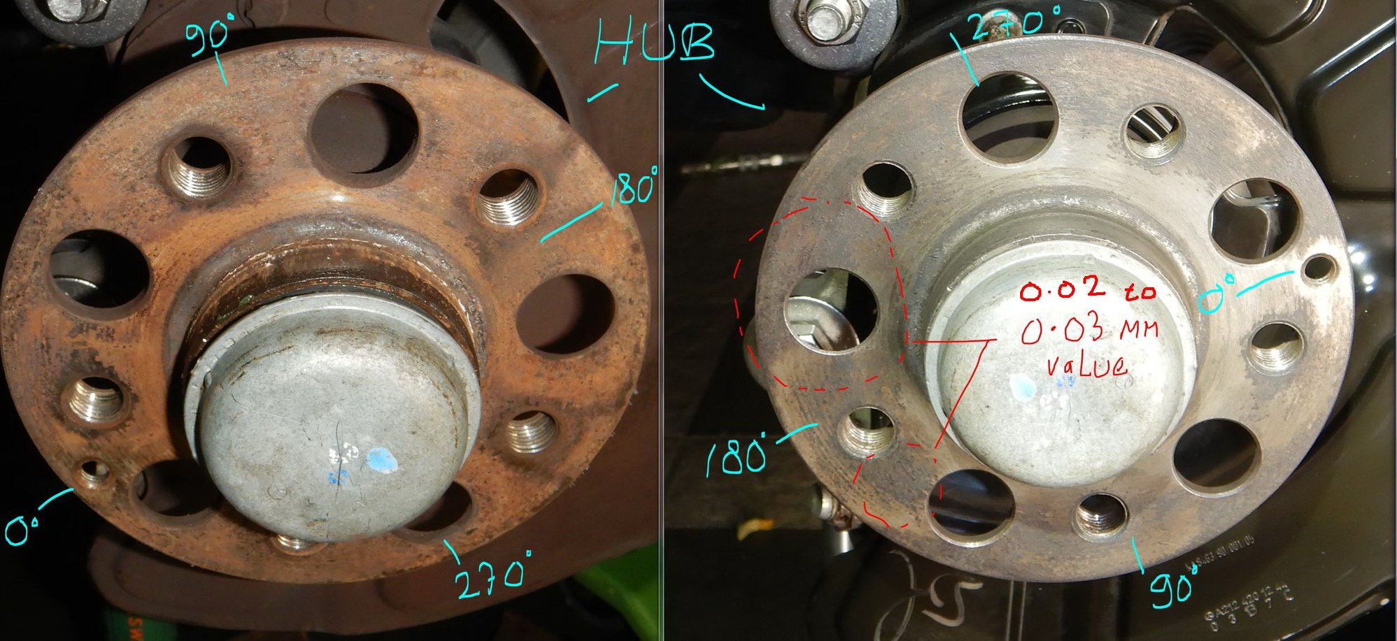

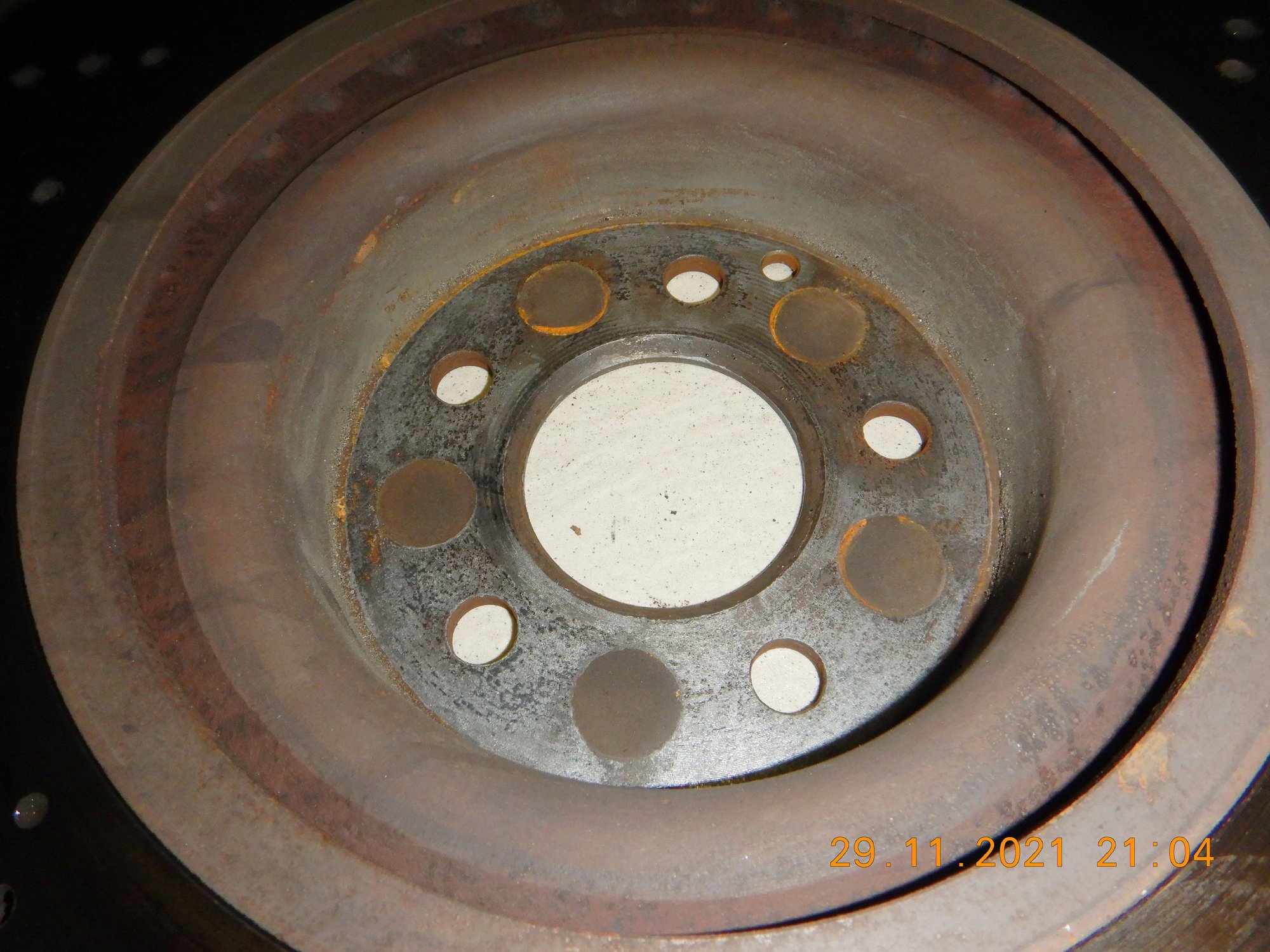

Mine when I first removed the disc rotor, mine is RWD

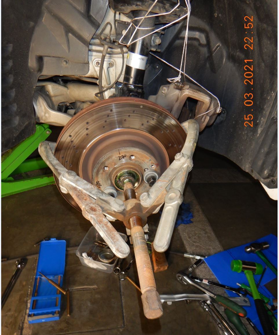

Needed puller tool

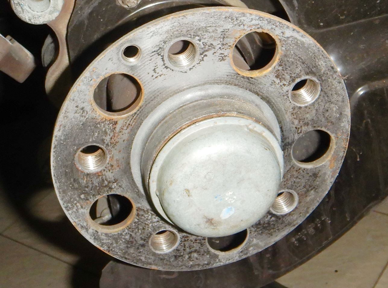

My hub/flange run-out

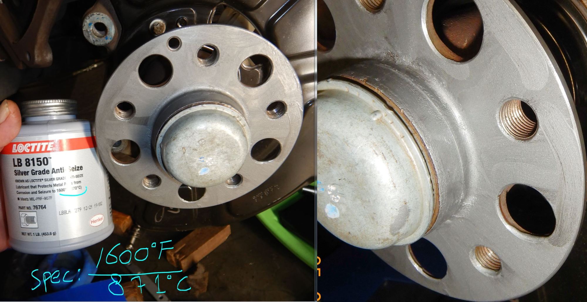

After I applied anti seize as rust protection, the rotor disc will drop whenever the small torx screw removed .... so nice.
Above is March 2021.
The next check for rust on hub was 29th Nov 2021, all good.
Yours in 2025 vs mine in 2021. With anti seize hubs in my non salted road stay good.

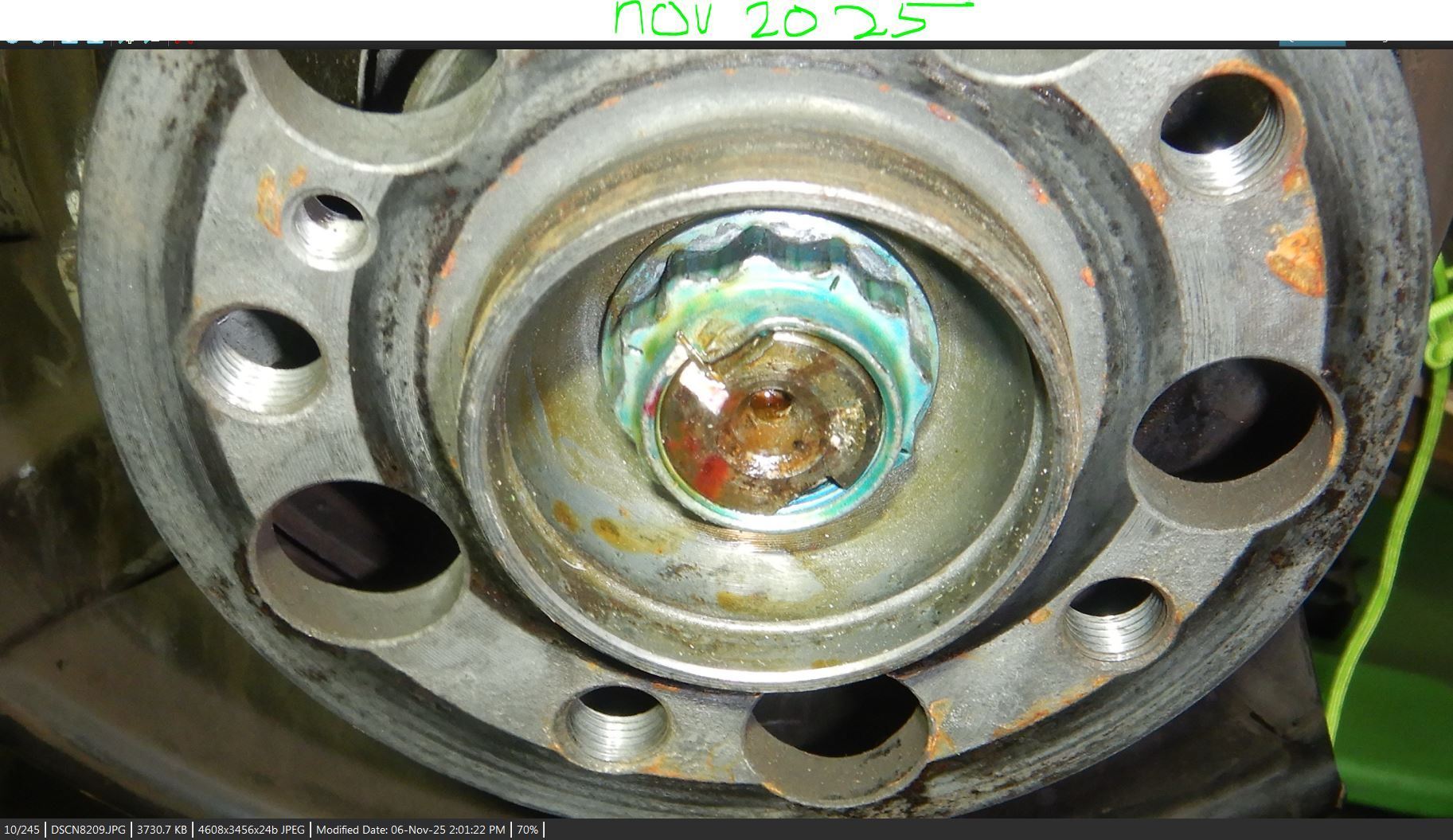

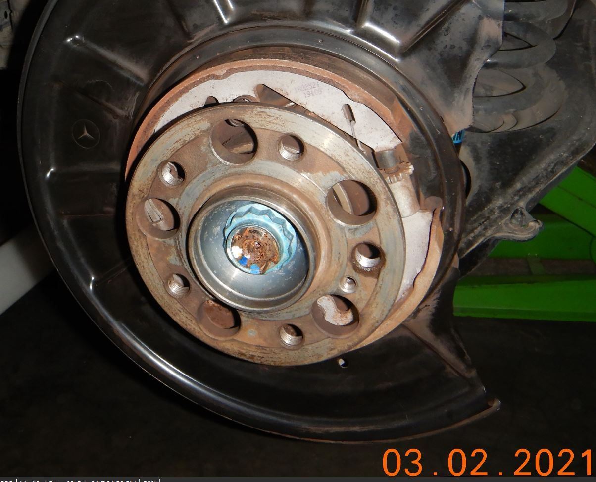

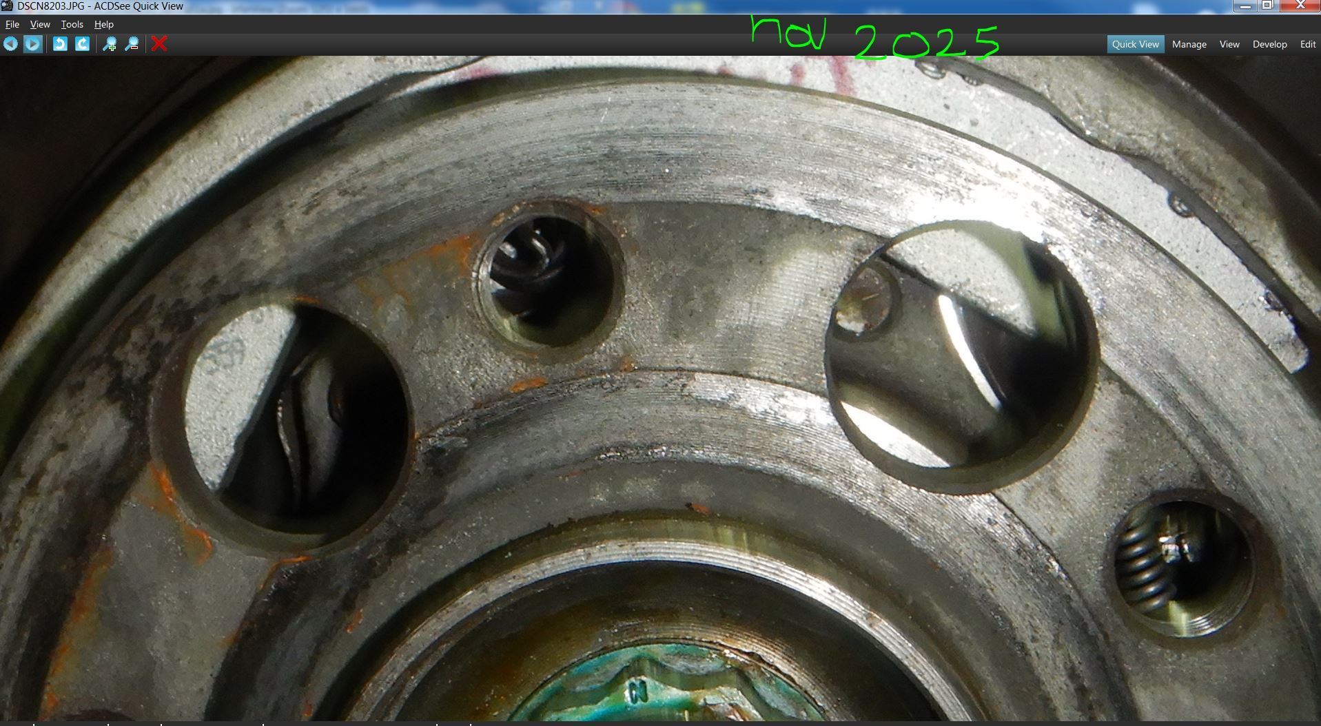

Rear hub, Feb 2021 first time removed , cleaned and use anti-seize and when in Nov 2025

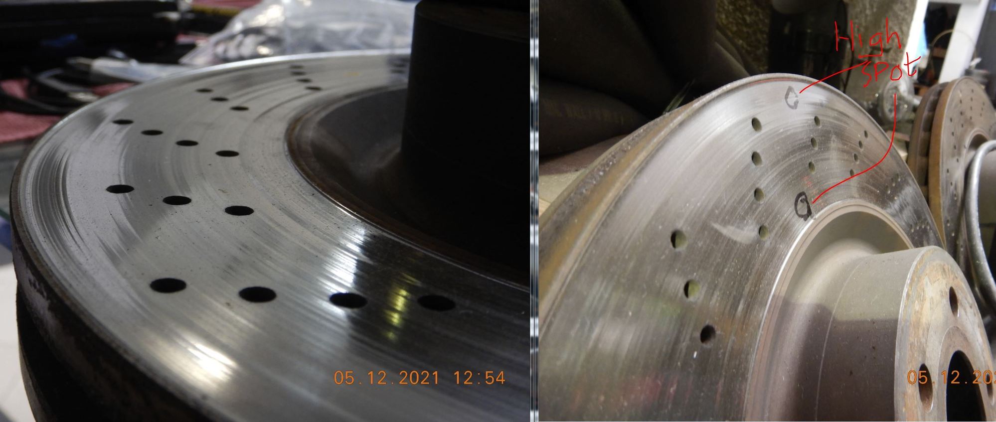

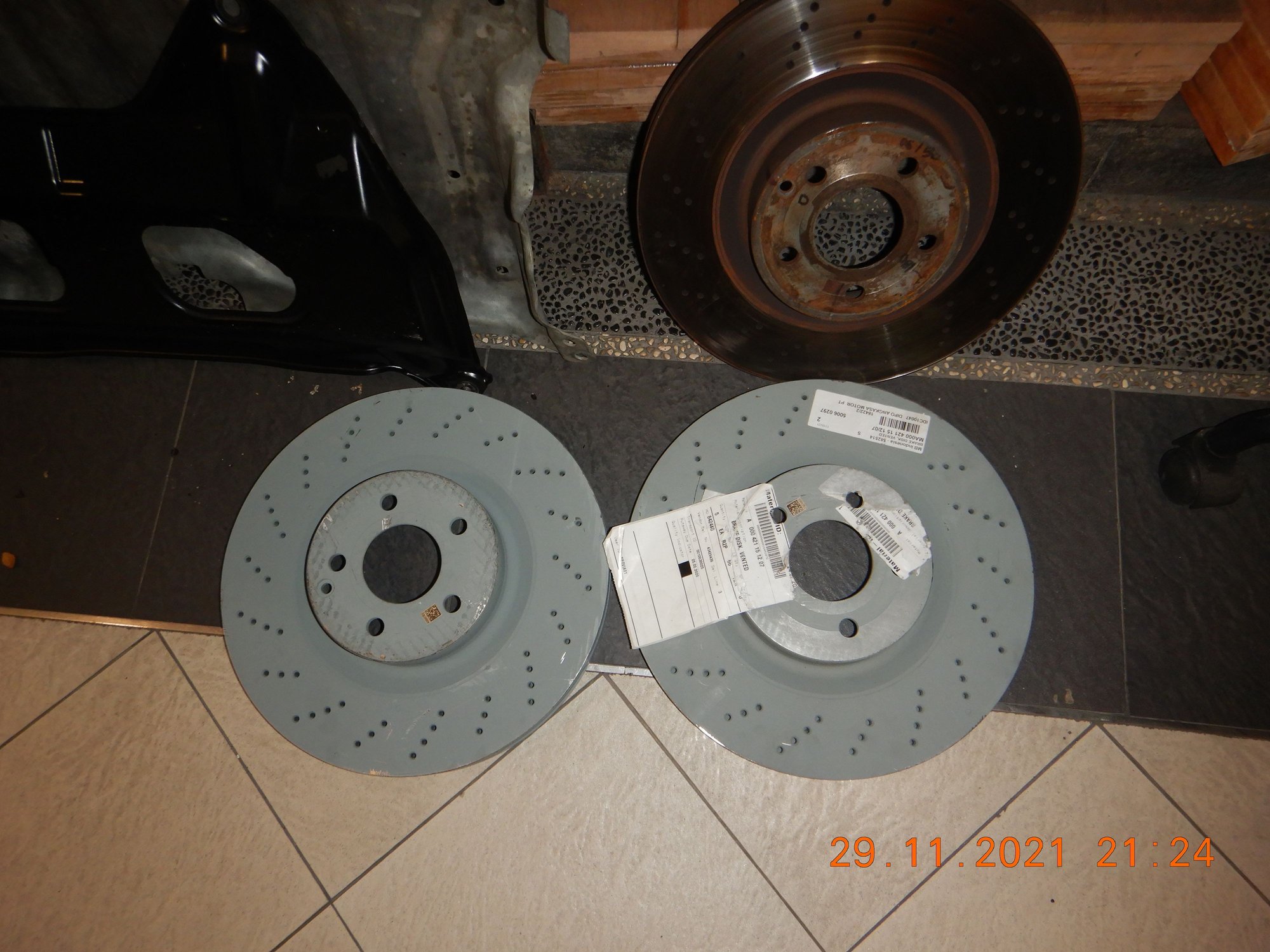

FRONT : The old first rotor
I hate these un-even surface
I replaced the rotors with new ones. MB genuine. Made by Brembo if I remember right.
