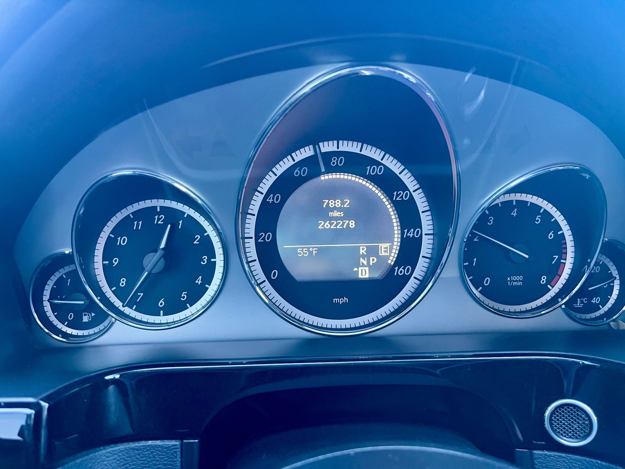

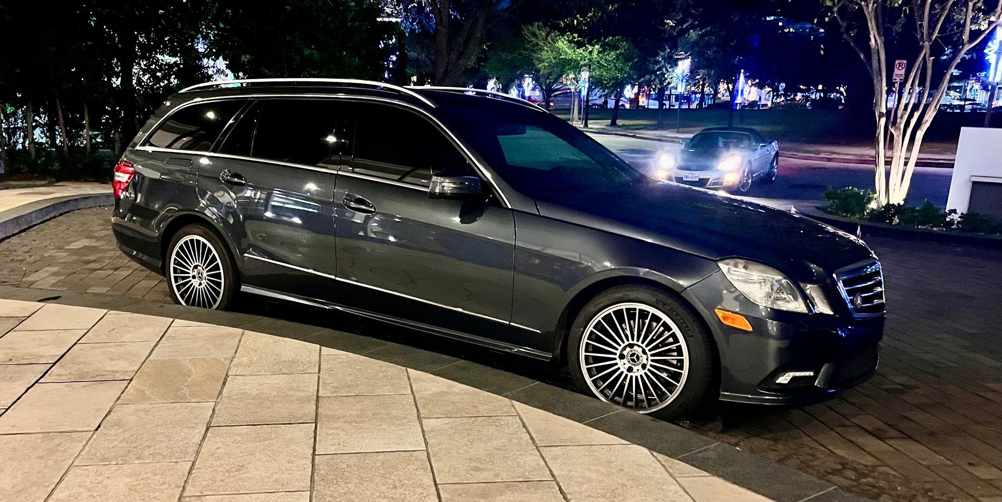

My 2011 S212 E350 has over 262k miles and going strong. Not gonna lie I’ve had quite a few repairs from air bellows to driveshaft to oil leaks and even a torque converter replacement. However, the M272 engine itself has been nearly bulletproof.
I do drive mostly highway miles, but I attribute much of the longevity to warming up my engine every time I start my car and let it idle at least long enough for the revvs to come down, and not accelerate too hard until the engine is fully warmed up. Of course doing 5k to 7.5k mile oil change intervals with premium oil is a given. I also use a liqui-Molly friction inhibitor every other oil change.
