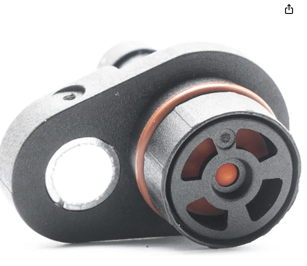

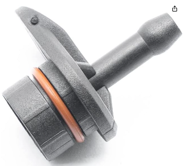

New pads should not cause these symptoms, so it’s probably just a coincidence. Honestly, the hard feel is somewhat “normal”. There is also the vacuum pump valve that may need replacing.
https://a.co/d/6pkNCbF

It’s also easy to pull the line off of the vacuum valve and see if it is spitting oil. But imo this was a leftover result of pumping the brakes then starting the car.
