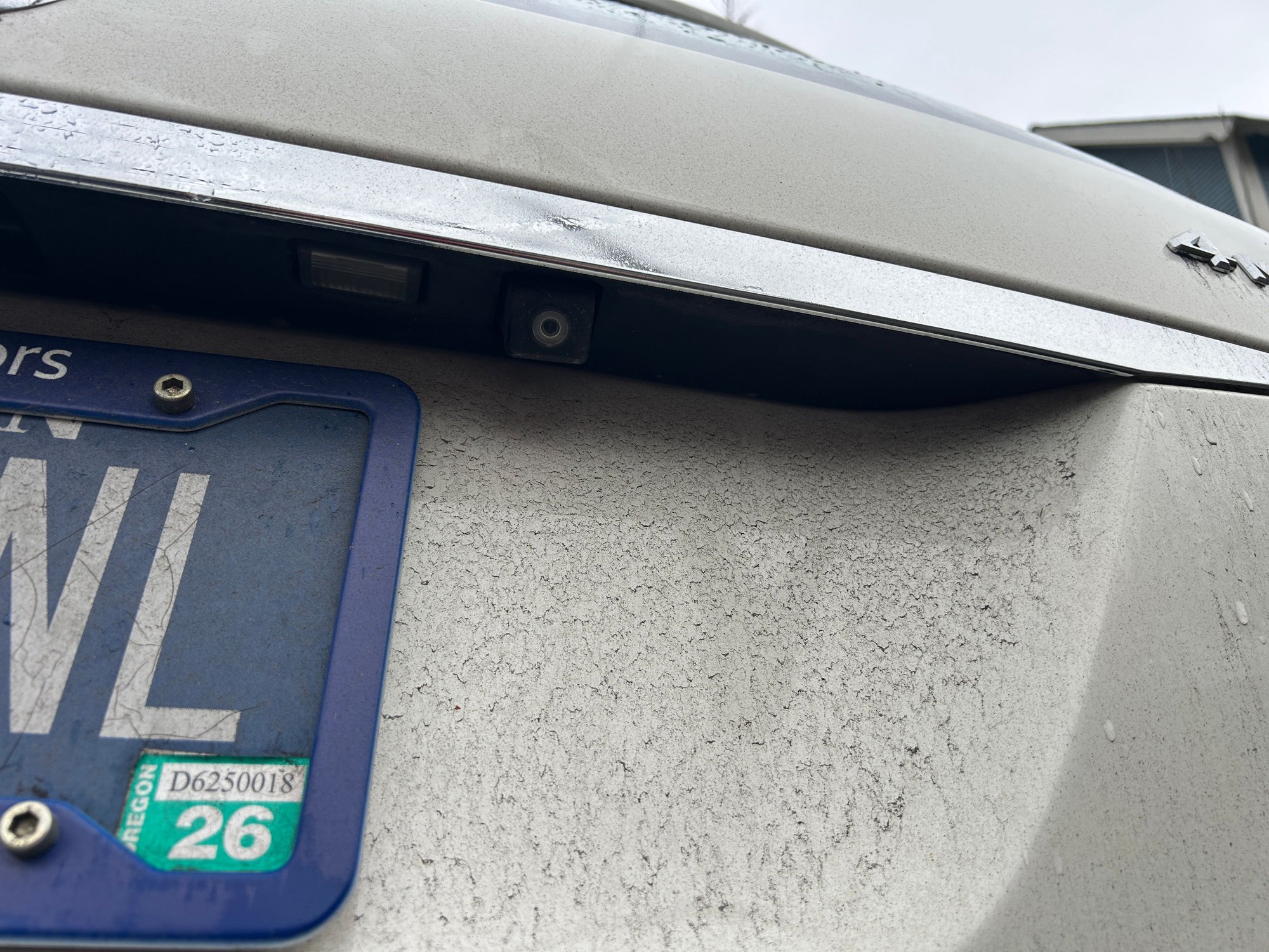

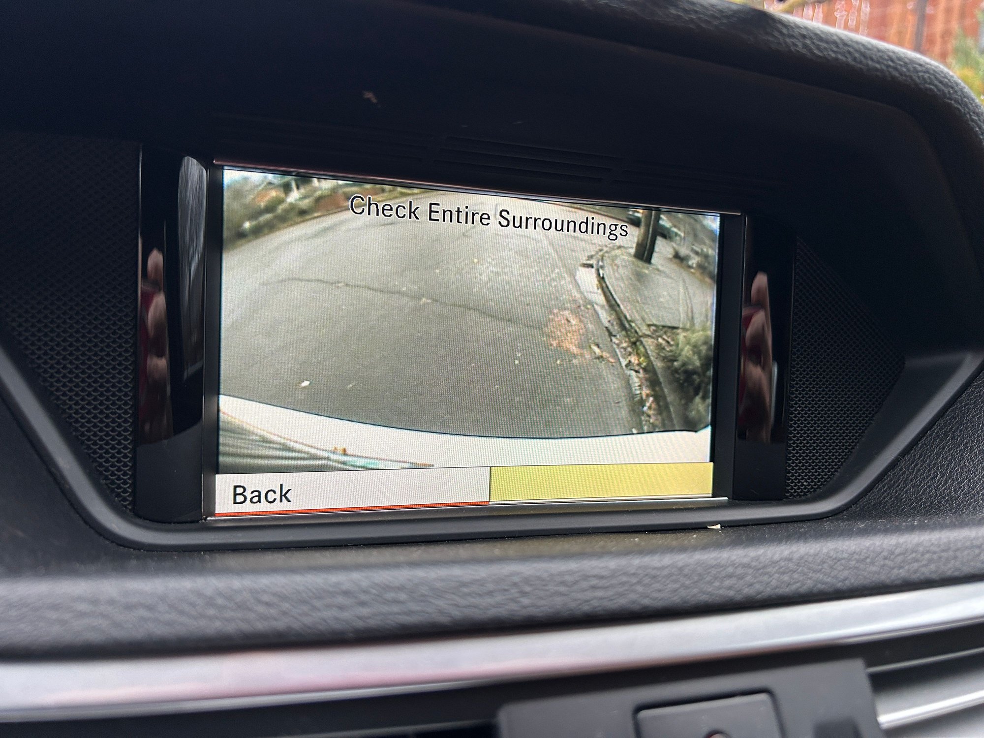

Here you go.
I think the rear view camera in our 2011 Wagon is awful. The camera in our 2010 ML350 was much better. This one seems distorted and it's really hard to know where the edge of the car is without the lines. I'd love to upgrade it.

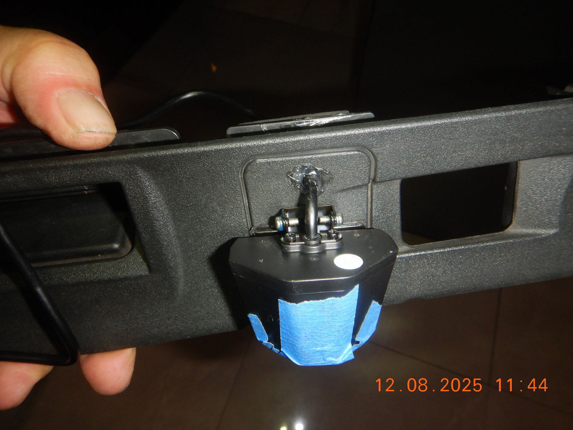

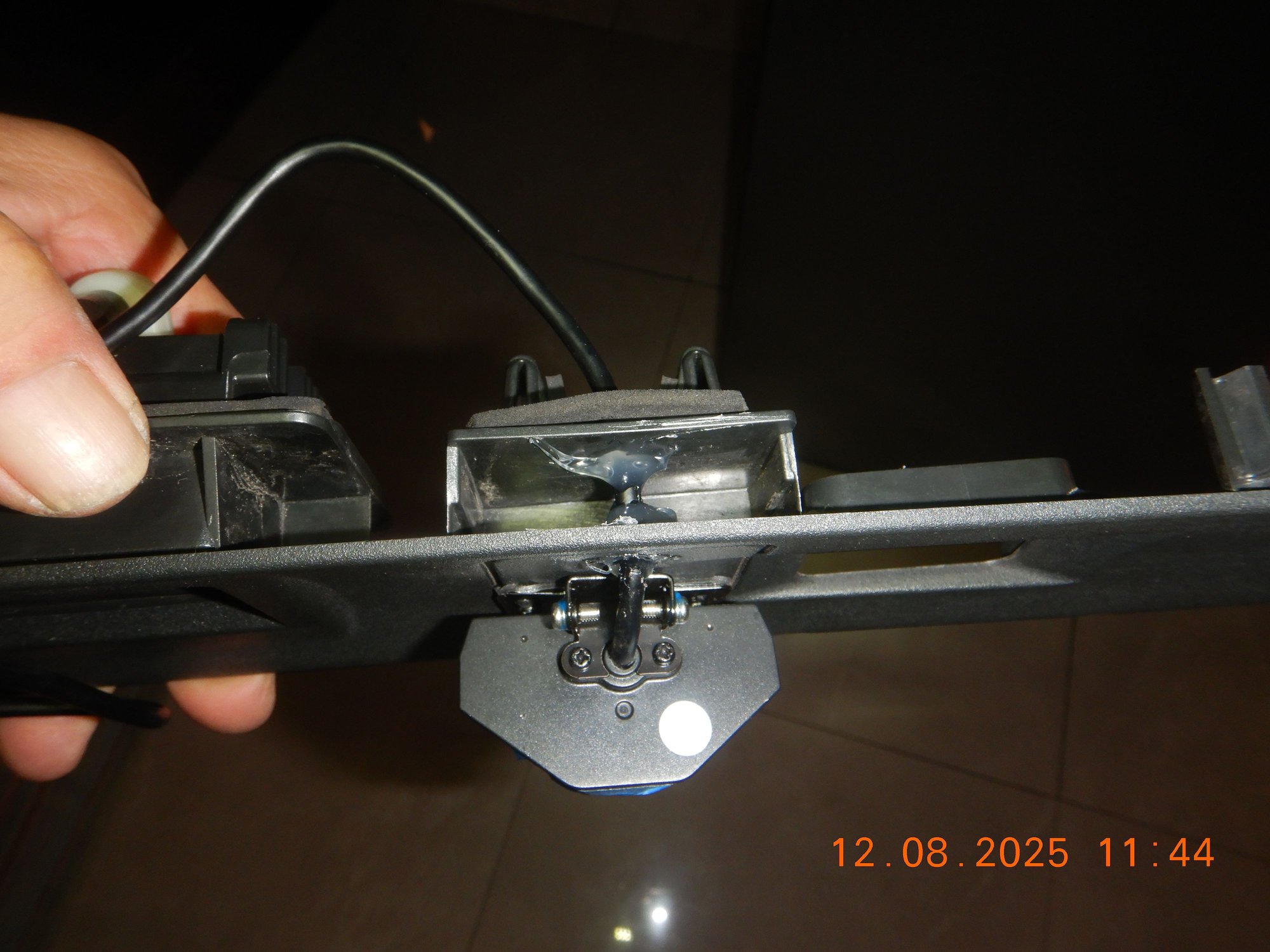

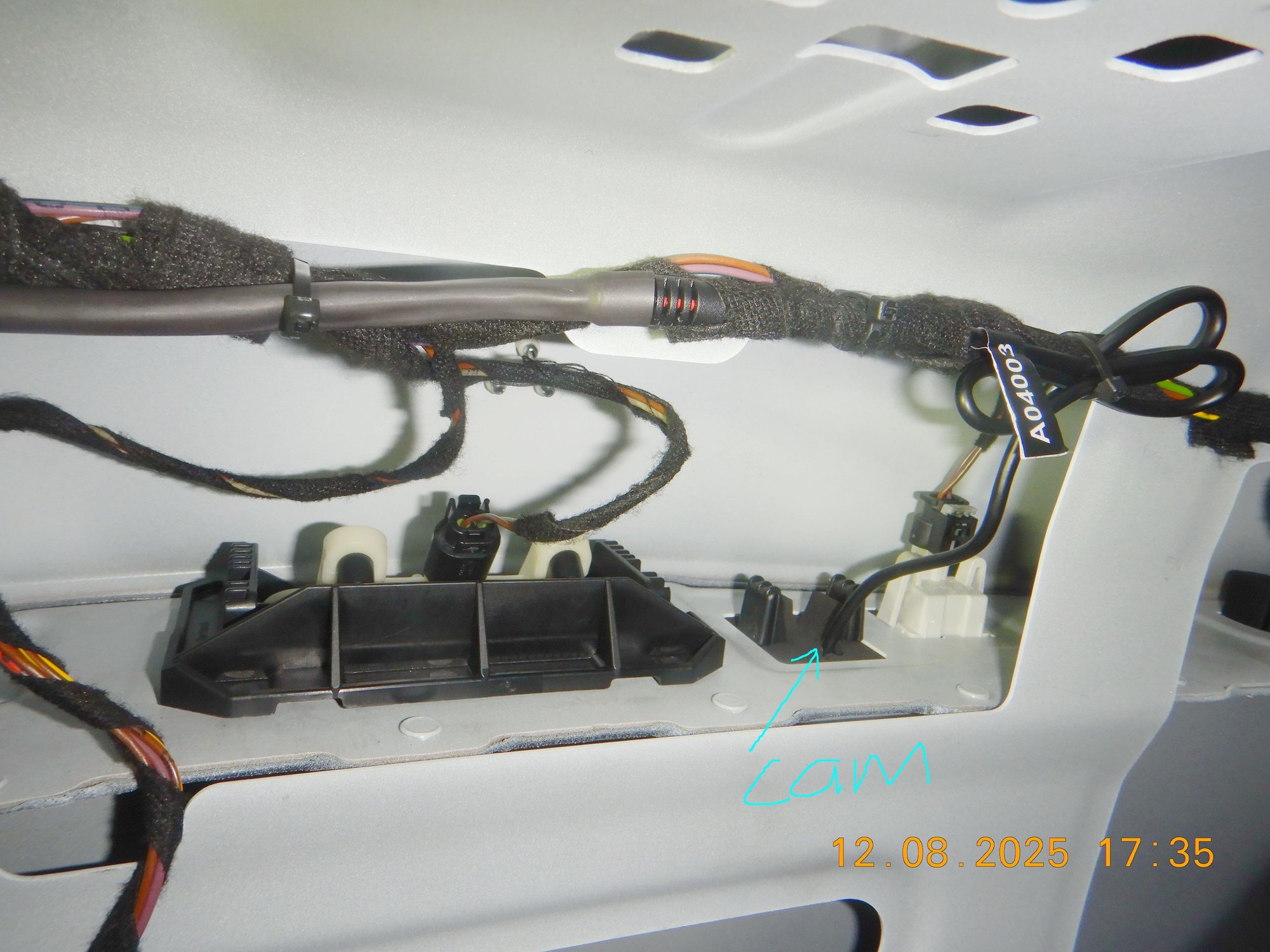

This is aftermarket too. I DIY the install. Mine is sedan, but I think the plastic above the number plate would be similar in the wagon.
Mine is NOT a reverse camera, it is part of a tripple camera dashcam. 3rd one is front bumper cam.
