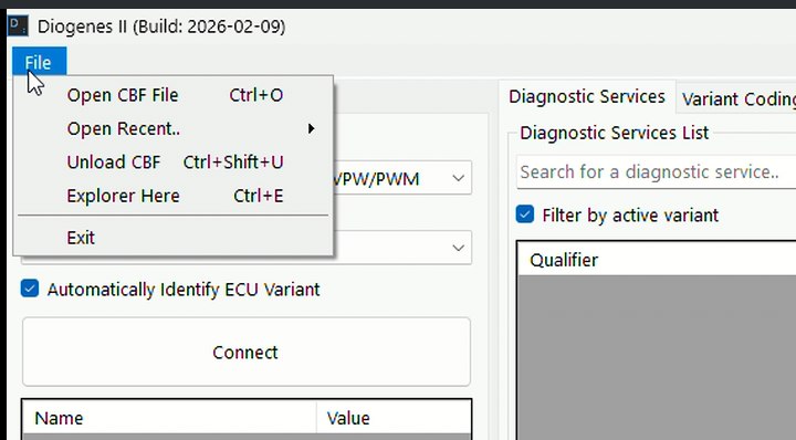

1. start Diogenes and open your CBF file:

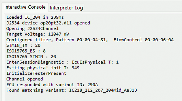

2. Click the big connect button. At this point, the interactive console pane should look like this:
This means we're talking to the module!

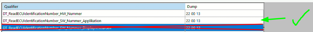

3. Find out our SW0 version. Select DT_ReadECUIdentificationNumber_SW_Nummer_Displayre sourcen from the Diagnostic Services List. Click the row, then Execute, and take note of the SW version:
4. Gain read/write access.

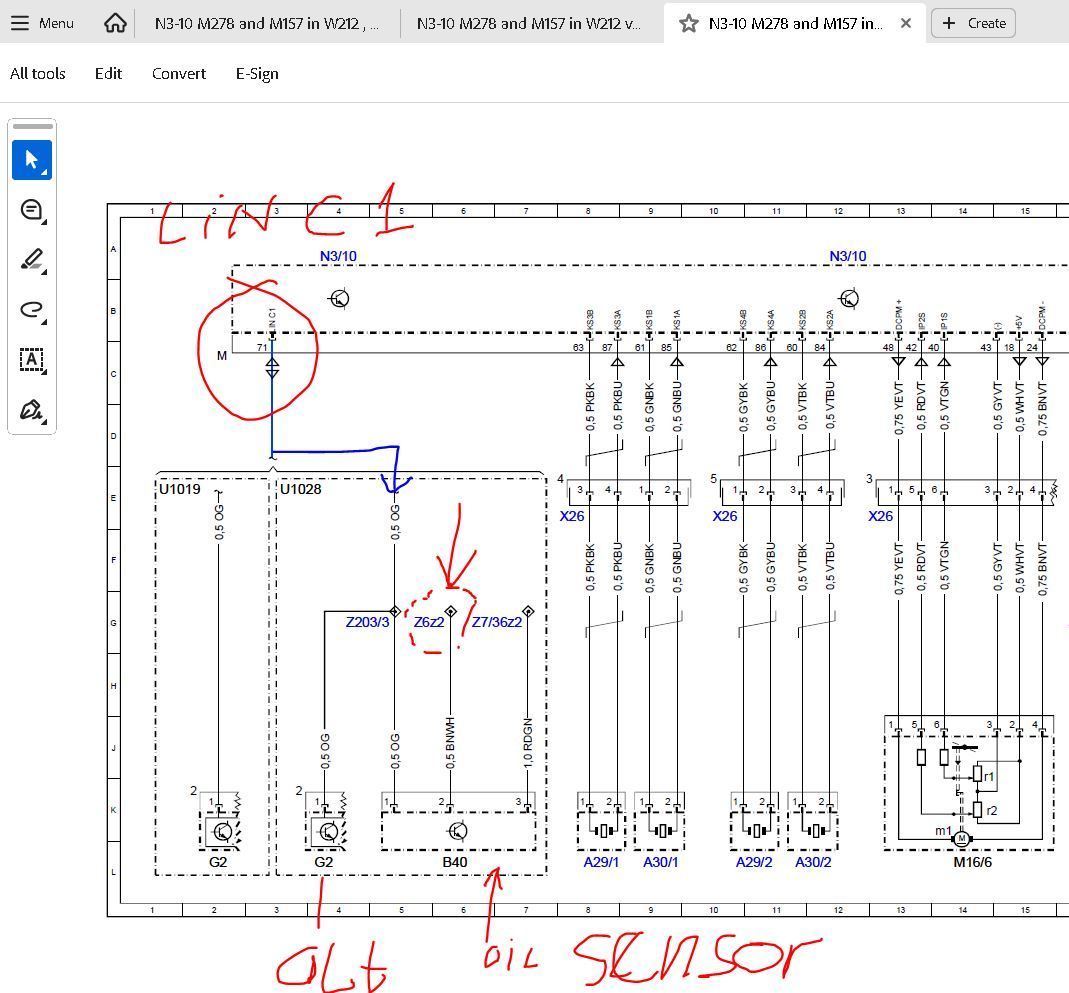

Just so you guys know, the oil temperature reading is a calculated value and not a true value, because there is no oil temperarture sensor on most engines, except on M157.
This is the oil level + oil quality + oil temperature sensor for M157
Picture 2 of 7
In the wiring diag, it is called B40
If the AMG numeric coolant temperature value is true value as per OBD2 standard, it is then very good and you guys best not be shocked that it is much hotter ( the truth ) than the
white liar needle type gauge we all have.

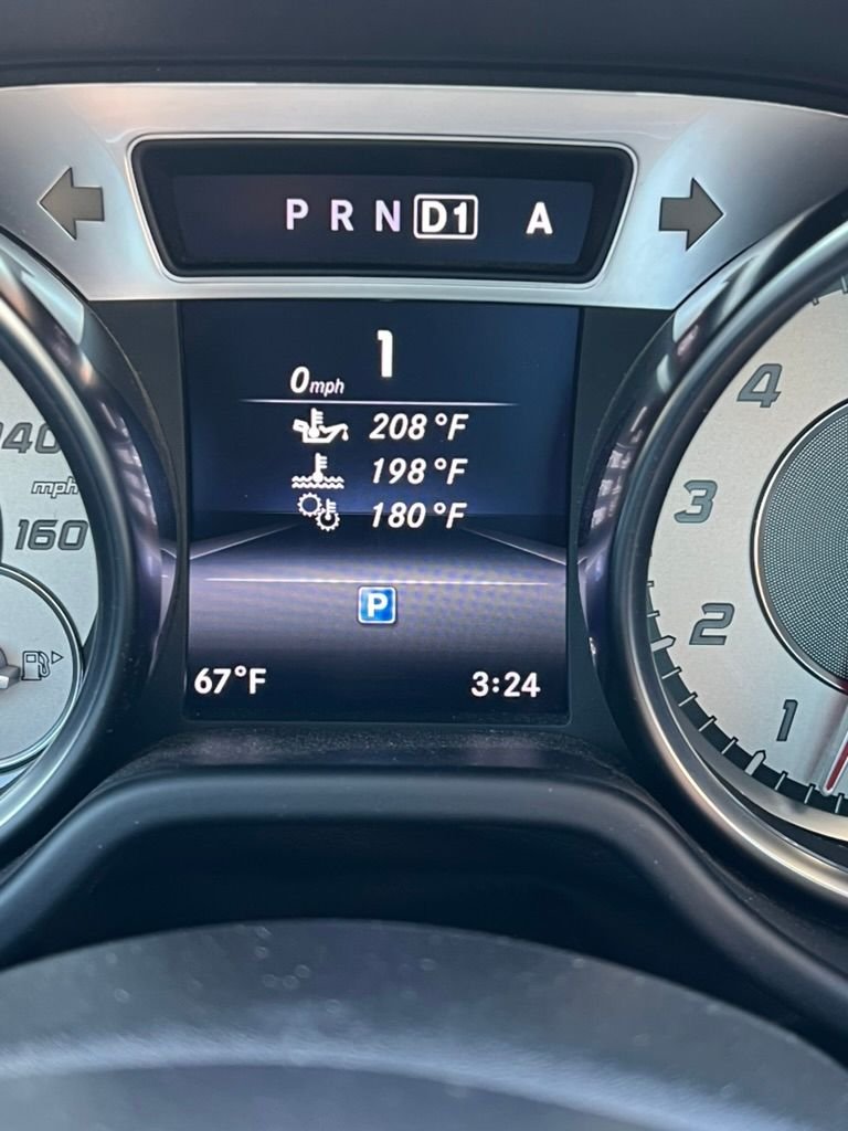

Depends on the car and transmission. On my SL, I do get tranny temps. But not on my C-Class. I don’t know why.
AMG Menu — SL-Class
AMG Menu — C-Class
AMG Menu — C-Class

Hi @beater_x204 , I made a mistake in instructions, we don't want the "display resources" sw number, we want the "application" sw number. (if anyone could tell me how to edit the original post I would be grateful). Likely, your application number is 2129026108, which is available for seedkey generation
You are correct. That is my application number. I'm running into some warnings. Maybe it is my clone openport? Also, Is it correct that everytime I send 27 09, the reply is different?
Yes, that's the logic of a seed key. Every time is different.
27 09 is the request and the answer should be 27 0A....
Old Mar 24, 2026 | 08:30 PM
beater_x204's Avatar
Joined: Mar 2026
Posts: 4
15 X204
I some how got it done! Now to find instructions for Agility mode.
