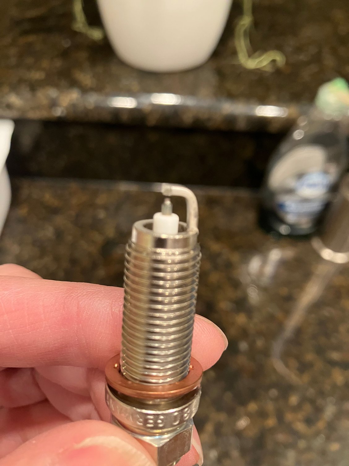

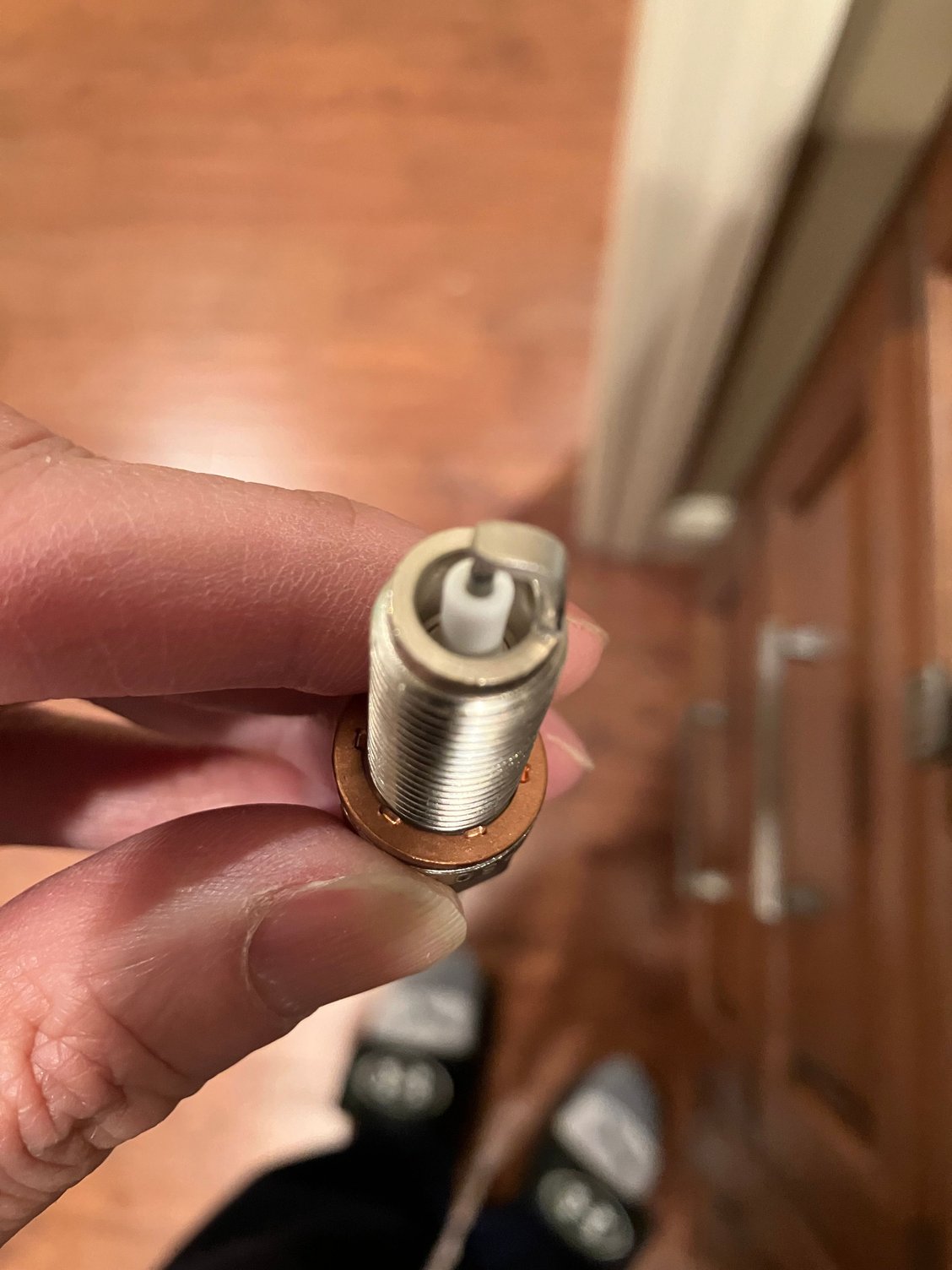

Here are some pics of one of the new plugs. They all look the same to me I bought them from FCP Euro.
Old Mar 11, 2026 | 10:46 PM
CaliBenzDriver's Avatar
Joined: Apr 2019
Posts: 12,225
Likes: 6,902
From: Silicon Valley
W212 MY'14 M276-3.5NA @75kMi
This is a sample of one plug from the new set.
You want to review each plug individually.
inspect for burr protruding from ground strap... file it round.
inspect for burr protruding from ground strap... file it smooth round (not the firing surfaces).
center electrode: not to thin + not too stubby
This looks more like a dual-platinum rather than dual-Iridium needle

Those are not NGK 96427's, I'll assume those Bosch plugs are for a non flex-fuel car
Old Mar 12, 2026 | 09:06 AM
Joined: Apr 2019
Posts: 12,225
Likes: 6,902
Stock NGK (Bosch??)
As Pierre hinted Bosch in this flex-fuel engine are not usual vs. stock NGK parts.
Now triple-check the plug reference sold by retailer.
Search what MB references for your VIN
