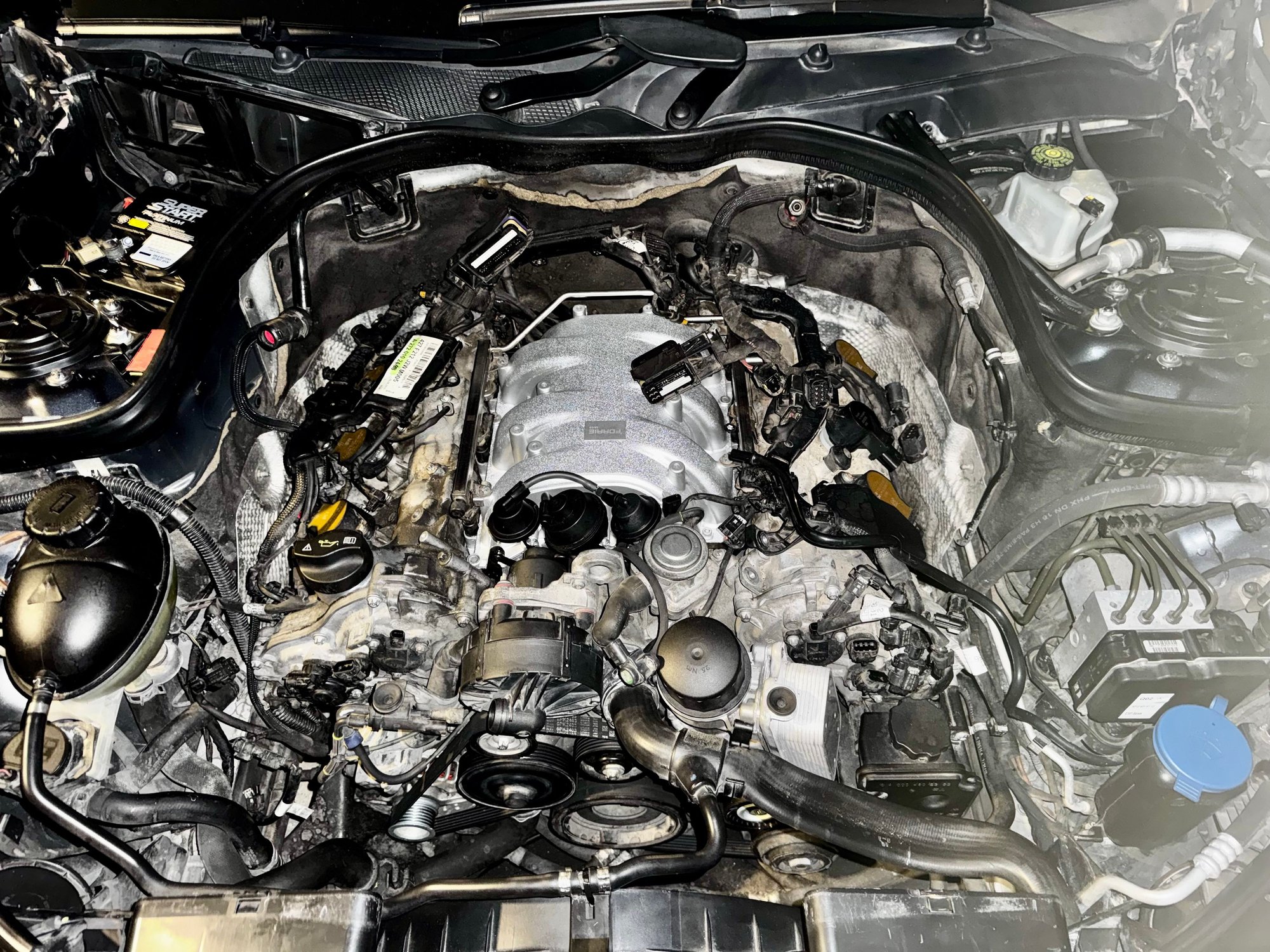

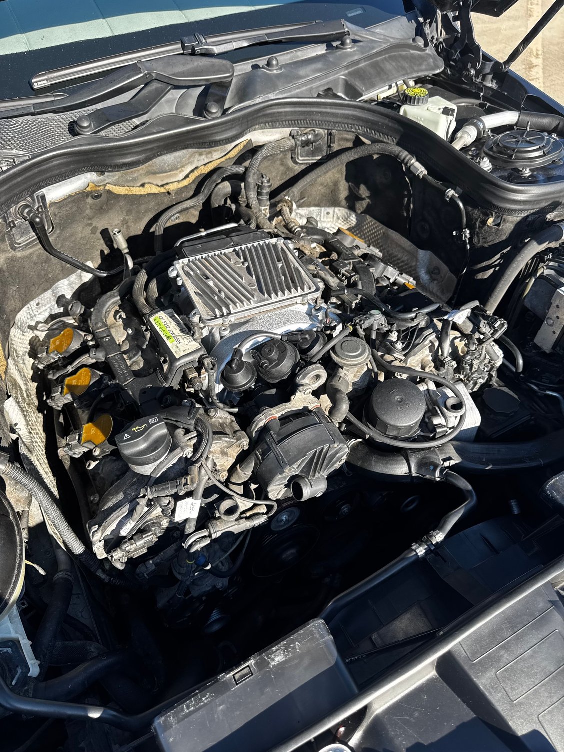

I replaced my intake manifold over the weekend and after a few hiccups it’s running beautifully! I did snap off two m7 bolts in the manifold that secure it to the head, but there didn’t seem to be any adverse effects as of yet, but I’ll be extracting them out asap just in case.

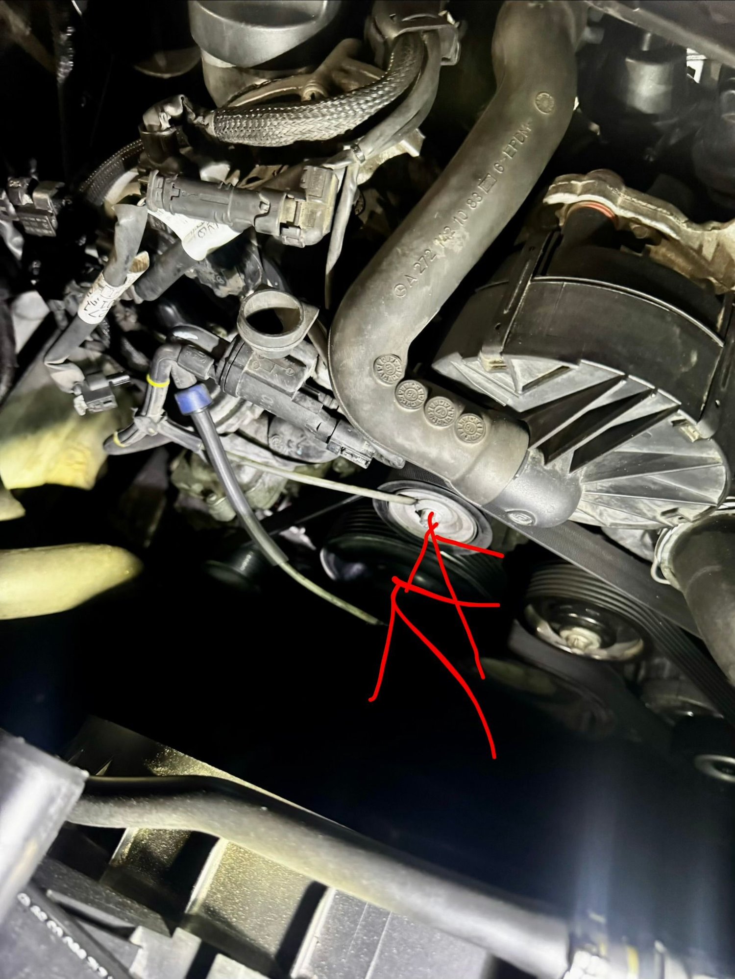

Make sure you don’t leave vacuum lines near the engine belt! Good news is you’ll know immediately that something is wrong!
I was wondering what that burning smell was lol
