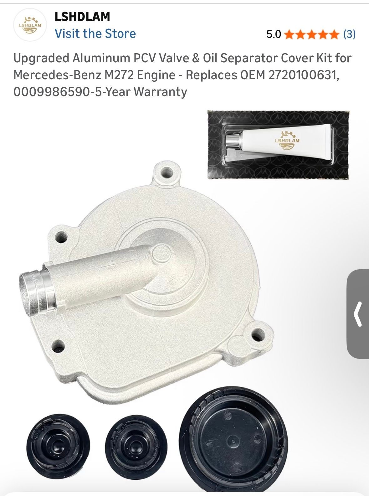

I replaced my centrifuge cover and cam plugs (only the 2 smaller ones) less than 800 miles ago. However, I did use an aluminum unit that required rtv sealant as the gasket unlike the usual plastic.
Why did you opt for the aluminum unit? I don't think it would be any better or worse honestly. The separator drip pan (2730100162) sometimes gets wobbly and it is a good idea to replace it at some point as well. Of note, the bolt in the middle is reverse threaded.

no reason in particular. I just thought it to looked kind of cool and different. The kit which included the cam plugs, came with a small tube of RTV sealant, which I also used on the cam plugs as well, in addition to the centrifuge cover.
After doing a little research, I may install an oil catch can as well. Once I replaced everything, I sprayed brake cleaner to get rid of any oil residue so if there is a leak still present somewhere I’ll be able to tell where it’s coming from.
You’re right I probably will end up doing the drip pan eventually as well as the other cover by cylinder 4 which I’m not sure it’s been replaced or not.
