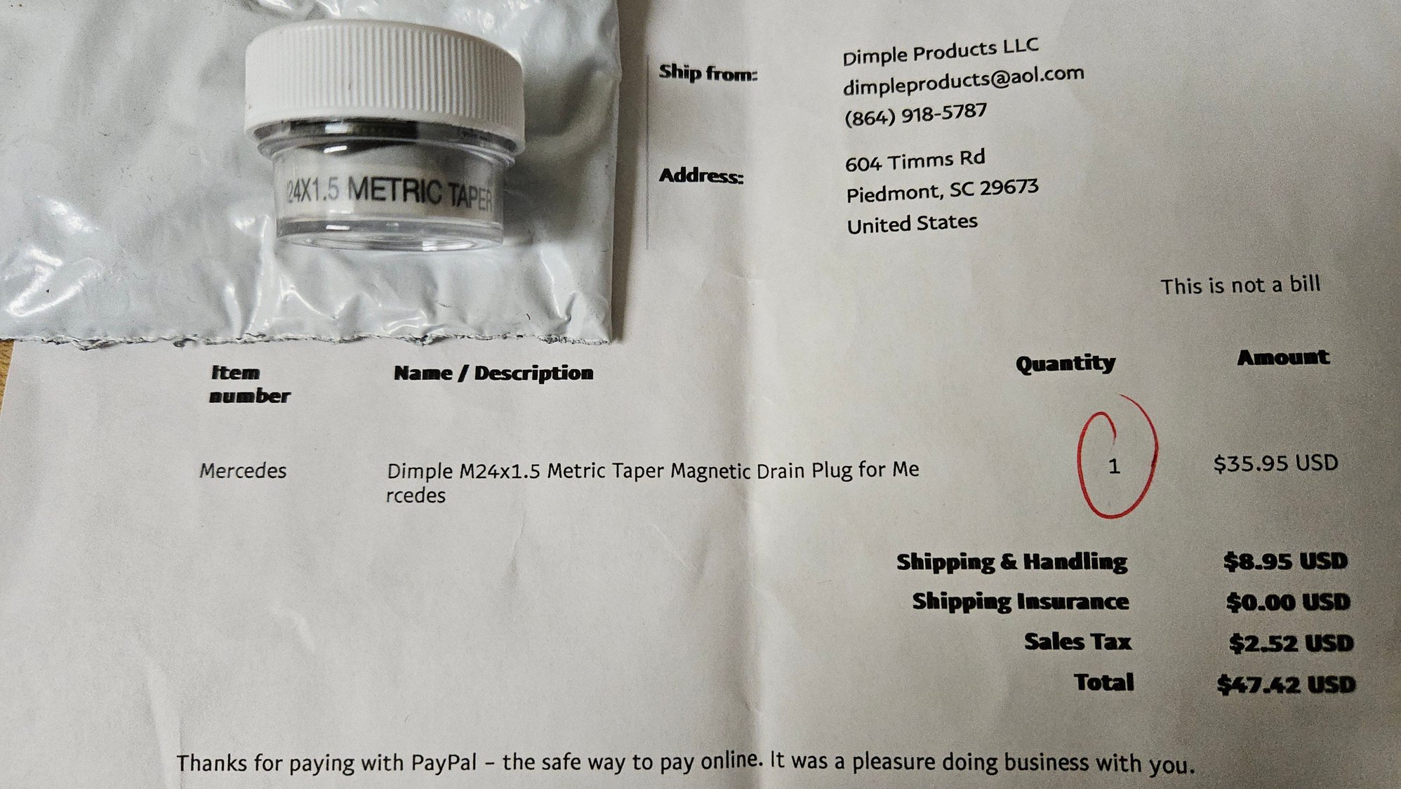

Hey @CaliBenzDriver ,
I would definitely be considering upgrading to magnetic drain plugs myself.
Where can they be purchased?
Thanks!!
- Andrew

MAGNETIC TAPERED PLUG 👍🏻
Thanks!!
- Andrew
Hey Andrew here are all the info from where I got mine for nearly $50 USD.
diff.magnetic.plug by Dimple Co.
Company named DIMPLE Products in SCarolina.
Type is a M24x1.5 tapered shape
This stock design self-sealing ie. no washer in use.
There may be other manufacturers and distributors selling comparable products. Not easy to come by matches.
I'm going to pull my diff plug for service in the near after 30k.Mi - I dont mind how much contaminants
my diff is shading as they are no longer chewing up diff bearings.
Old May 2, 2026 | 10:03 PM
andrewzam8365's Avatar
Joined: Jan 2026
Posts: 26
'15 E400 4MATIC sedan, Eurocharged Stage 1
Sounds like a plan! Thanks so much I actually just replaced my front or rear differential fluid a couple thousand miles ago (I can't remember which one at the moment, front or rear haha-whichever one Mercedes-Benz does not come right out and tell you that you need to change periodically for the W212)
- Andrew

Thought MB wants you to install new plug and seal washer with every oil change?
FCP always gives ya one in their oil change kit.
