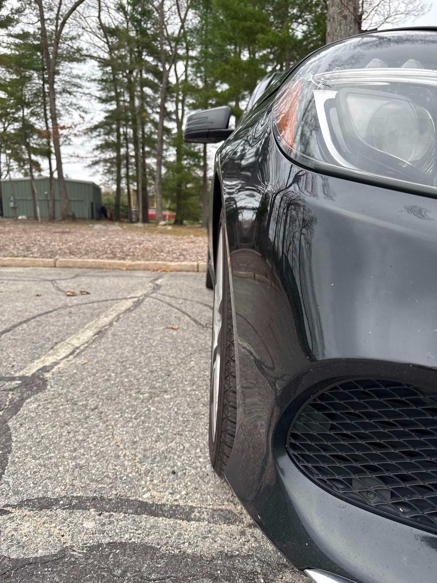

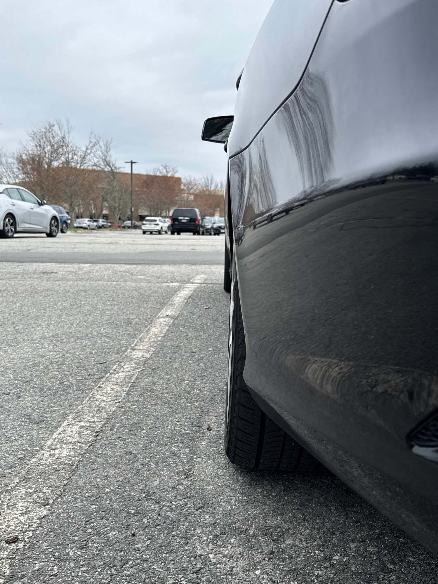

I have a 2015 E400 4MATIC Sedan. About 3 weeks ago, I noticed negative camber on both of my rear wheels. Shortly after, I had both of the rear suspension springs replaced, and the car was supposedly aligned. However, the negative camber is still present on both rear wheels. Today, I also noticed negative camber in one of the front wheels. (Pics attached.) Over bumps, a "squeak" noise has been coming from the suspension. The ride is unstable and "loose" feeling, not as tight as I knew it to be many years ago, and I am getting a shaking, wobbly sensation at highway speeds. I live in Southern New England and after the awful winter we just had, the potholes were terrible.
- Has anybody encountered this problem?
- What could be the root cause of this?
- In what direction should I go in first to fix this? The camber of the front nor the rear cannot be adjusted with factory parts, right?
Thanks a ton in advance

Front and rear cambers can benefit using non-stock setup to re-gain proper alignment.
What messes up handling like nothing else are loose seasoned bushings.
You mentioned winter potholes... exactly what kills plastic ball joints + soft aluminum rims.
To keep things simple: if you don't DIY be sure to ask for a quote from your trusted MB specialist.
Many suspensions parts are up for refresh. FRONT end :
  • control arms + BJ's
  • (struts) + top mounts
  • sway bar links
  • (tie rods ?)
  • (bearings ?)
  • camber bolts kit
Then REAR end is next to track well.
  • multi-links
  • SB links
  • adjustable cam arm
  • (leaky shocks?)

W212 rear camber is built in, its maximum angle is depending on your car suspension variant.
AMG W212 has more rear camber.
Typical W212 will have at least minus 1 degree of rear camber.
You wrote , in blue :
That is called aging and wear and tear... but on the scarry side, maybe your REAR subframe is rotting ( rust ) already, which is common for W212 and W204.
Not tight is expected as bushings on the arms and subframe get worn out.
Wobbly & shaking IS NOT NORMAL.
You recently had your rear springs replaced and wheel aligned, if there is bad rust on the rear subframe and no one tell you about it...I will be pissed off.
Where is your alignment records.
Show us
