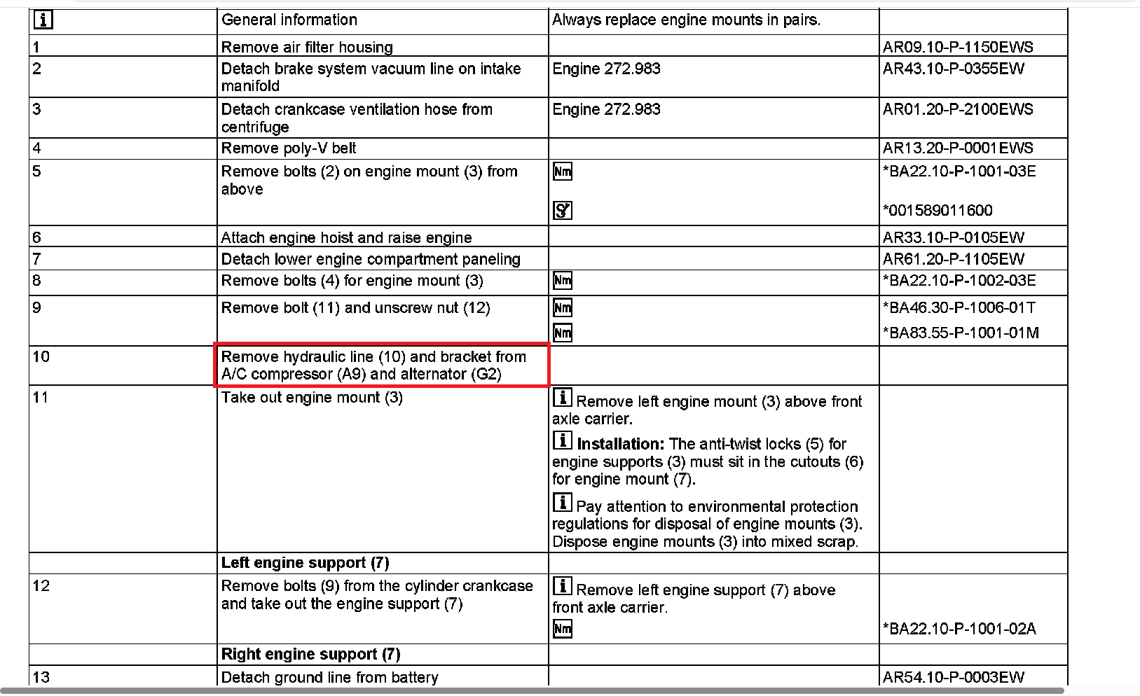

Have you tried to fit sockets or a wrench on the engine mount bolts to see how much clearance you have? I ask because I cant even fit a wrench on my engine mount bolts though I have a W204 and its 4matic. But still the manual shows this being able to be done, but I cant. My exhaust manifolds have to come off which is crazy.
I would first confirm your access to the bolts then plan on how to do it. As far as removing the ac and alternator I dont know why they would need to be, the manual just mentions removing the hydraulic line and bracket from the ac and alternator.
