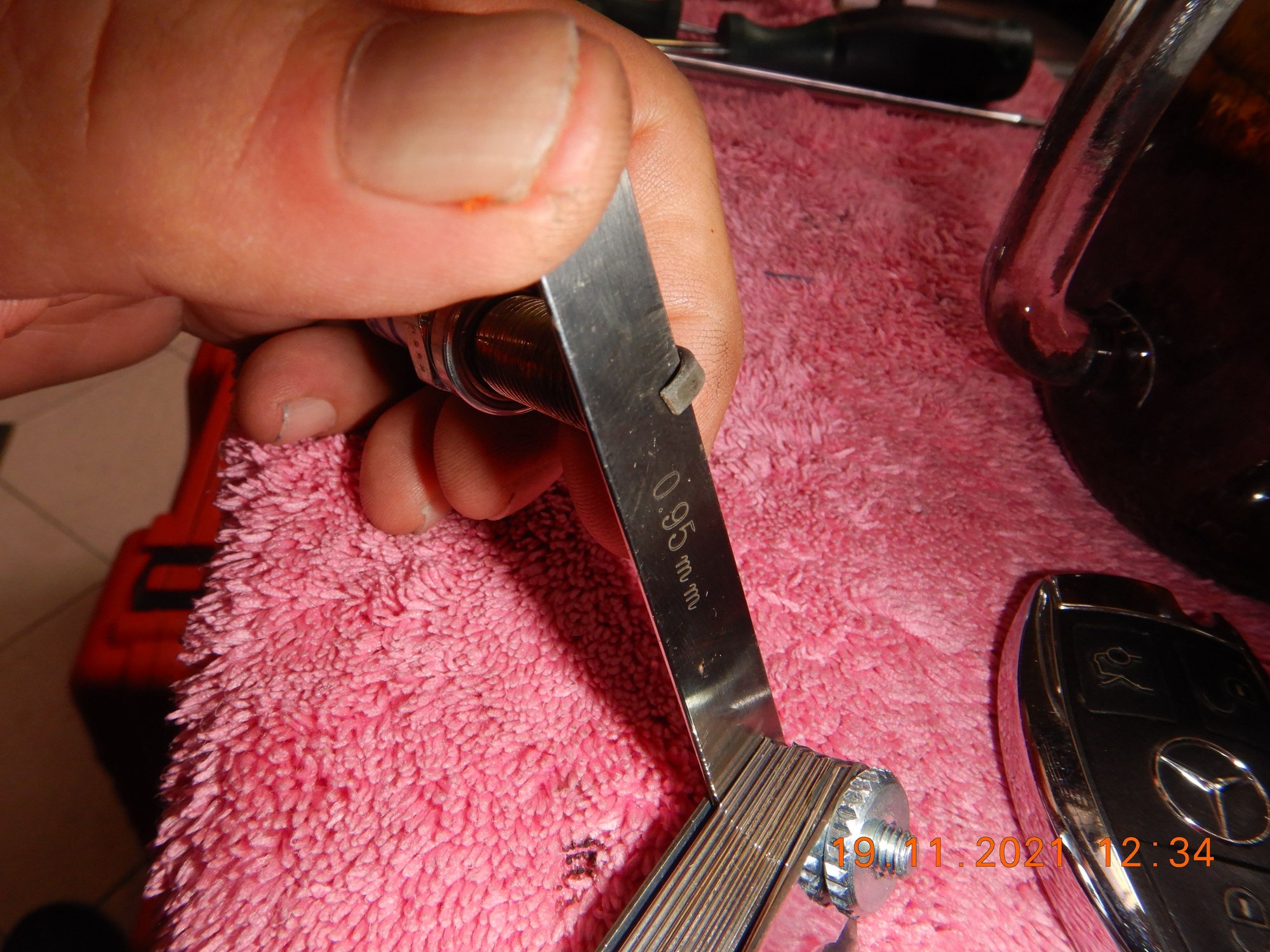

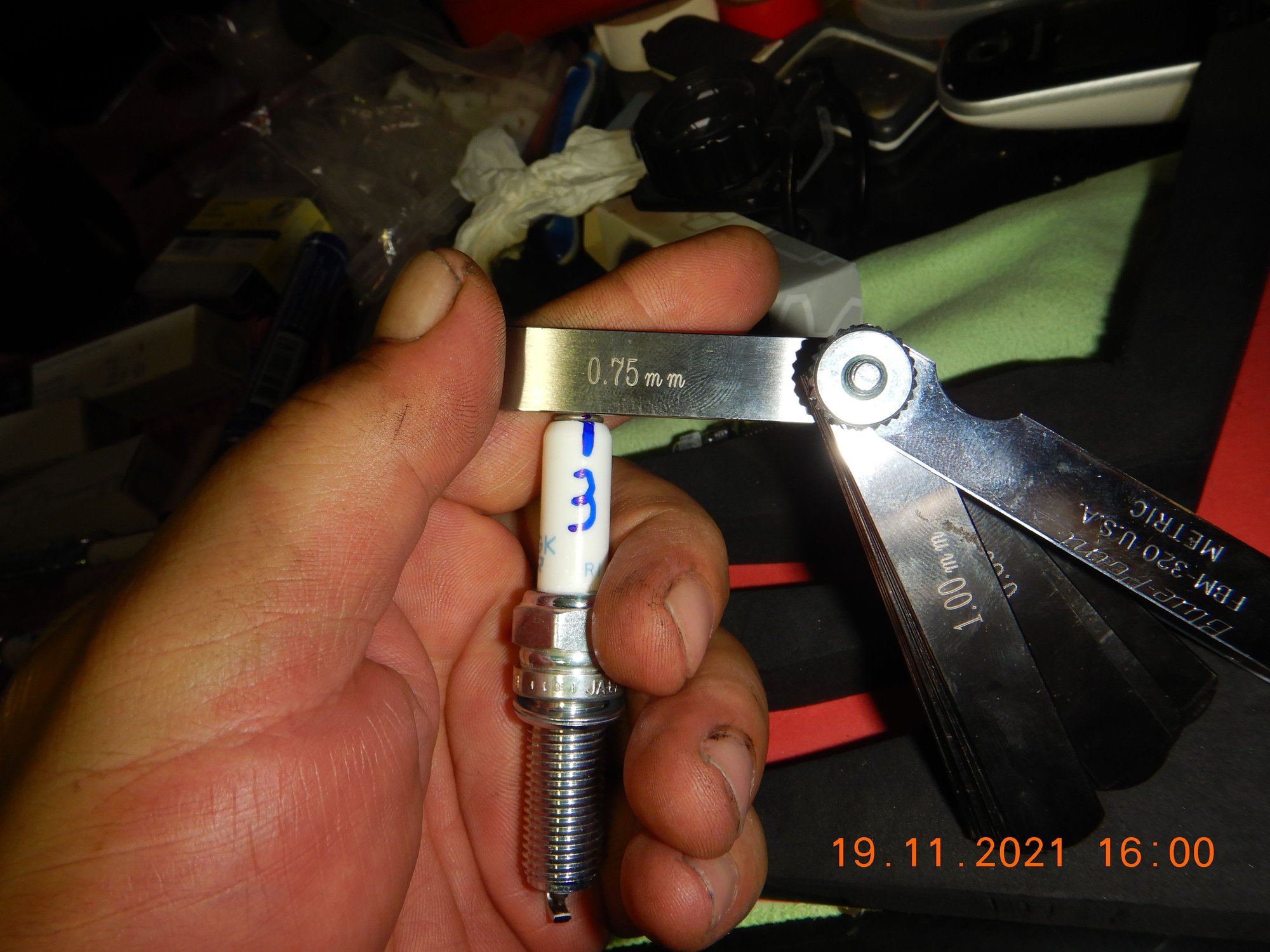

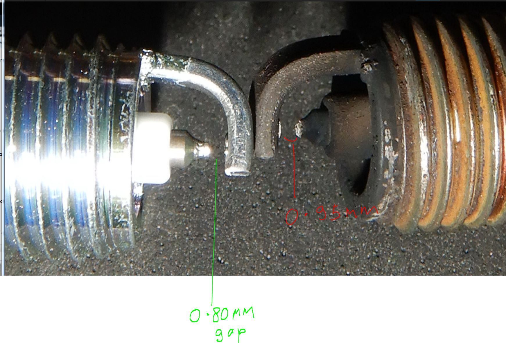

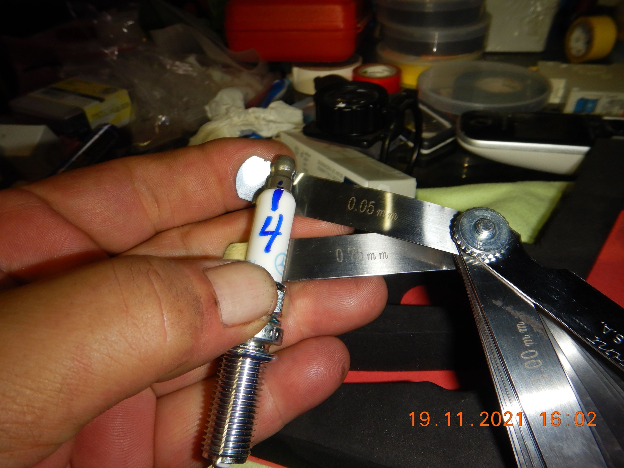

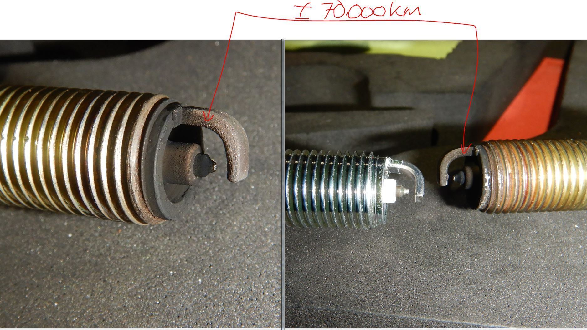

On my friend's M271.820 4 cylinder engine this is how his plugs looks like at 70,000KM. The super small tip is gone already.
This is GDI engine too, but 120 BAR and not 200BAR like M276/M278/M157 family.
Used, +-70,000KM
The 4 new ones are 3 are 0.75mm and 1 is 0.80mm
I bought him genuine MB only, nothing else. It is too low cost to risk.
