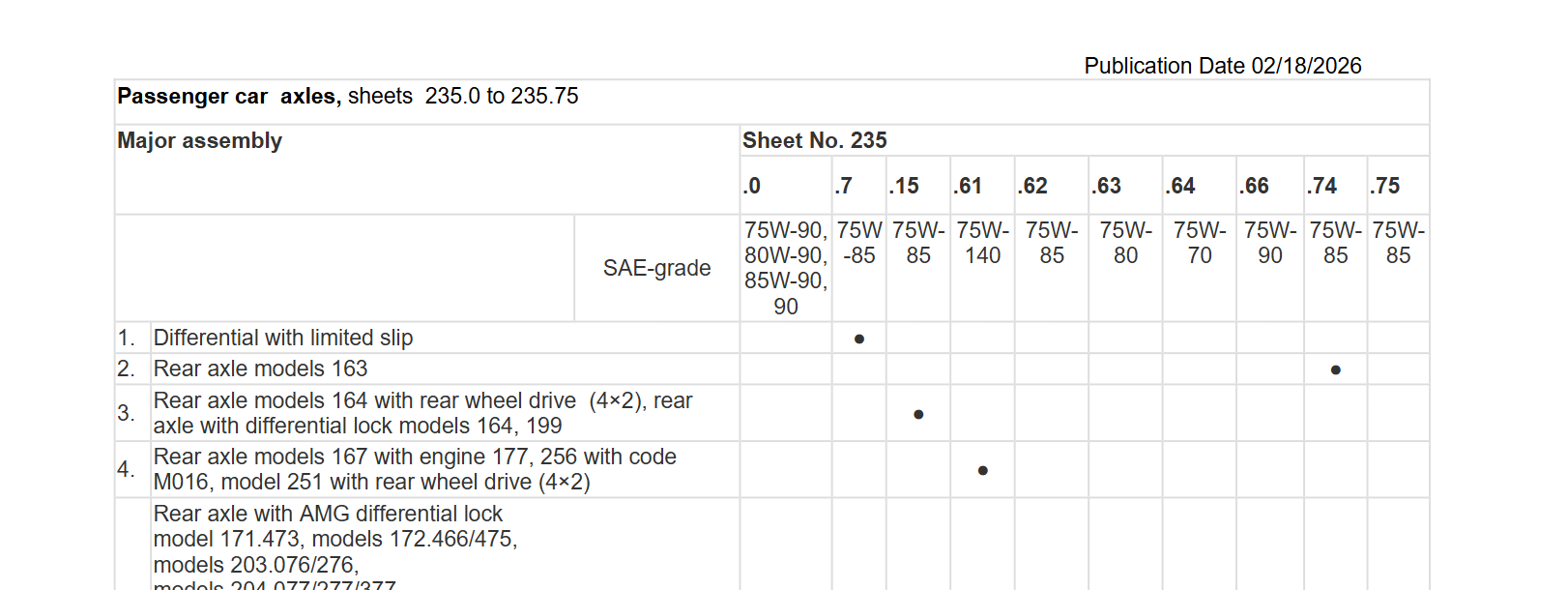

I always use the fluid specified in the Mercedes Bevo website: https://operatingfluids.mercedes-benz.com/
I have a 2010 W204 so should use the same fluids as you.

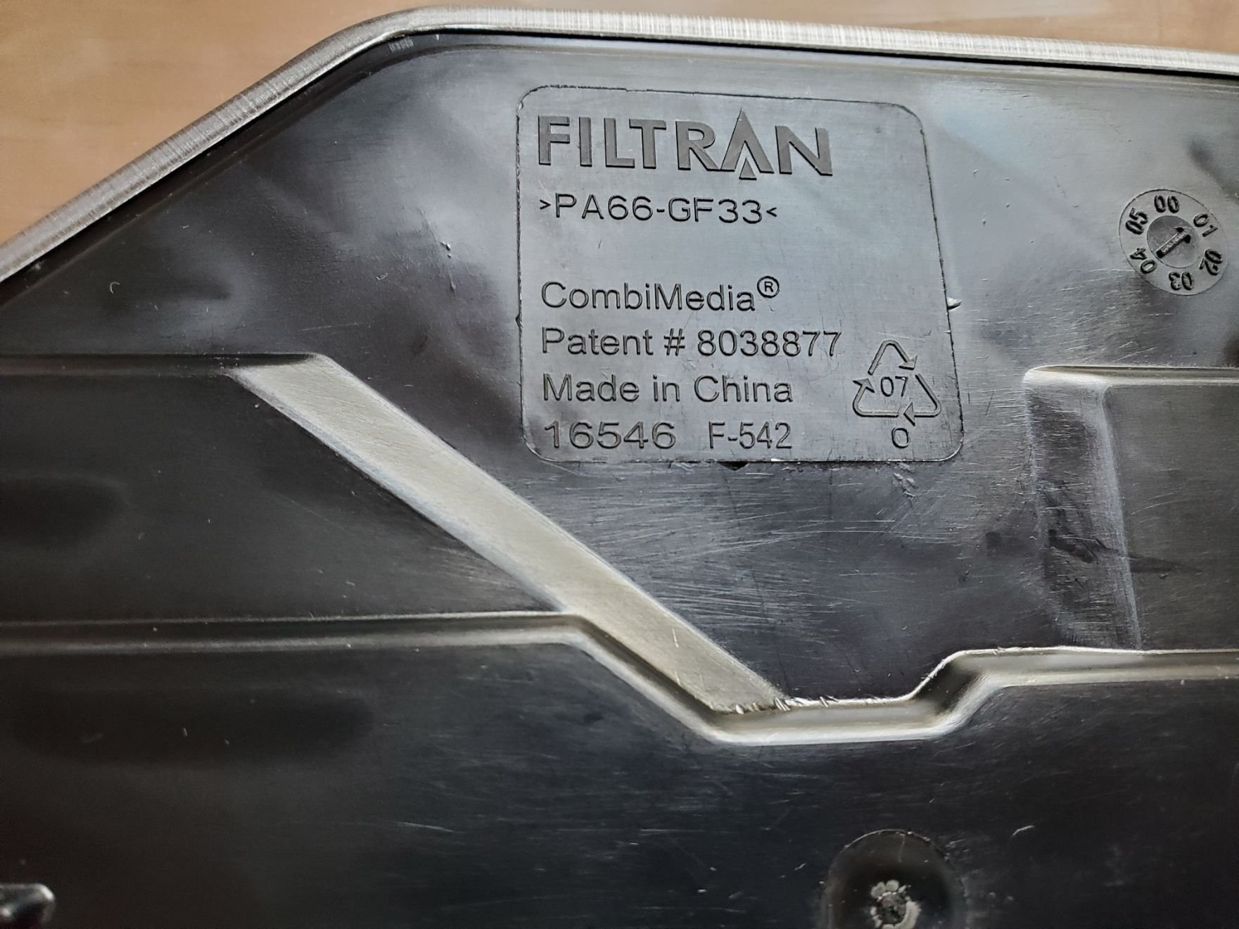

Transmission filter I bought a Filtran brand that came with an Elring transmission pan gasket. Filtran makes the Genuine Mercedes filters. Or I would have bought the Genuine Mercedes filter.

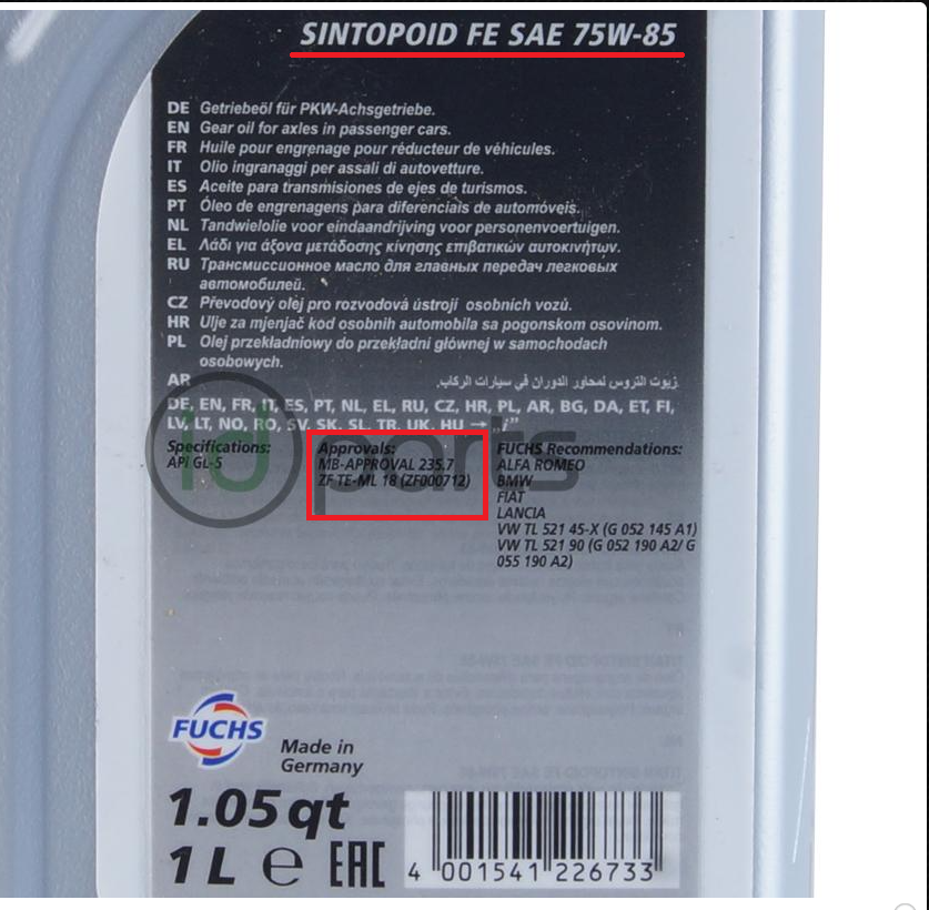

Differential oil I used Febi 75W-85 which meets the MB spec. 3 quarts was enough to do the front and rear with a little left over.

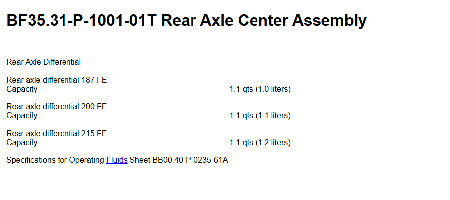

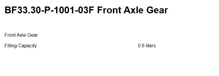

Have to make a correction. I only needed 2 quarts of the gear oil to do the front and rear differentials. I bought 3 but only opened 2 of them.
Checked the manual for the 2010 E550 and it says the same capacities that I used.

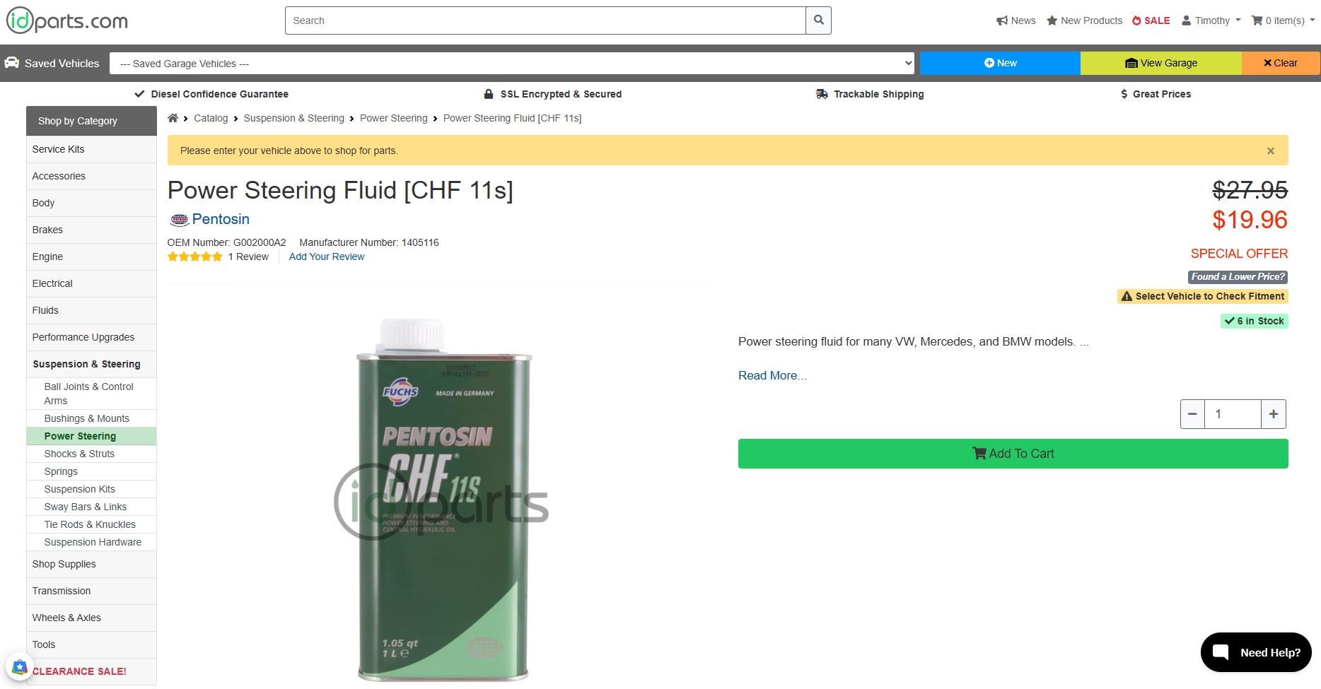

In case anyones interested I was looking on that IDParts website and they have the Pentosin CHF 11s power steering fluid on sale for a good price.
2yrs ago I bought 1l and swapped out the old fluid. I didnt do a flush but instead every day I sucked out as much as I could from the reservoir then put new fluid in. Figure i'll do it again and should be good for a few more years. The old fluid was really brown.

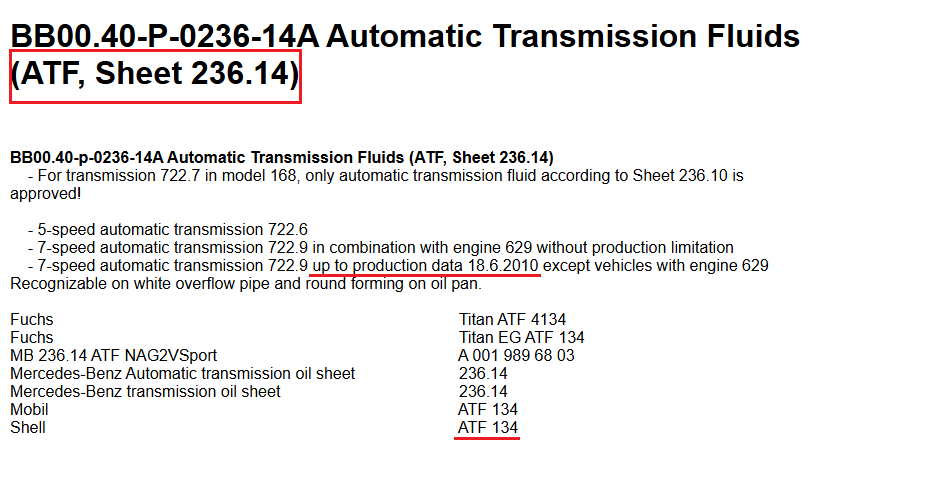

And, I wanted to double check with you see I know you are more experienced, but this is the information on my cars "release date." So I should use the older ATF, Sheet 236.14 Formula right?

Yours is April 9th 2010.
So its before June 18th 2010.
Yours uses the Red ATF134 fluid. MB spec 236.14
