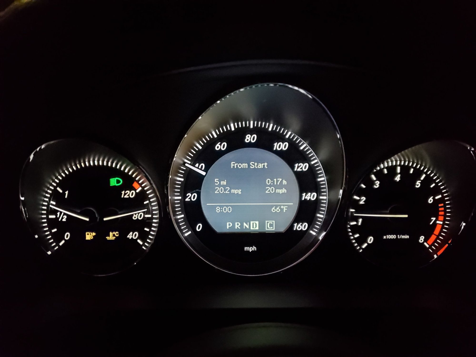

Yea, that screen on the dash appearing to show 12.5v while it looks like the car is driving down the road seems off. Voltage should be more like 13.5v or above.
Temp gauge in the instrument cluster is hard to see though looks around 90 c.

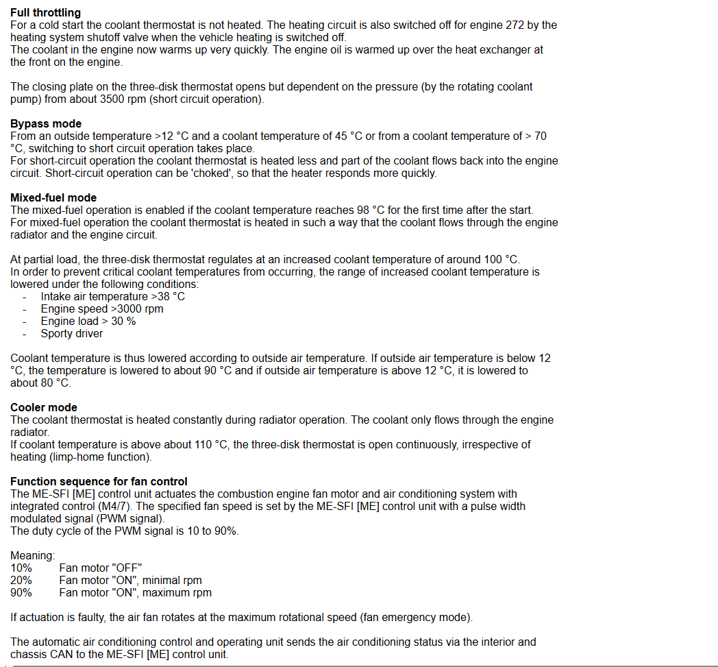

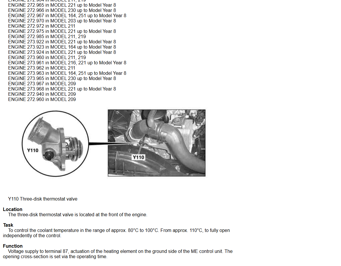

As noted above the coolant temp sensor is located on the back of the left cylinder head. The electrical plug on the thermostat is the heating element used to control when the thermostat opens/closes.

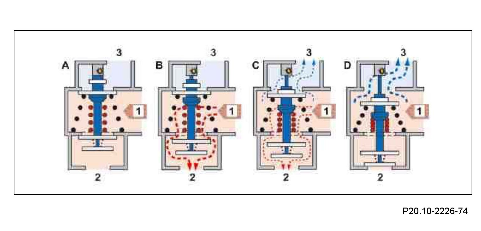

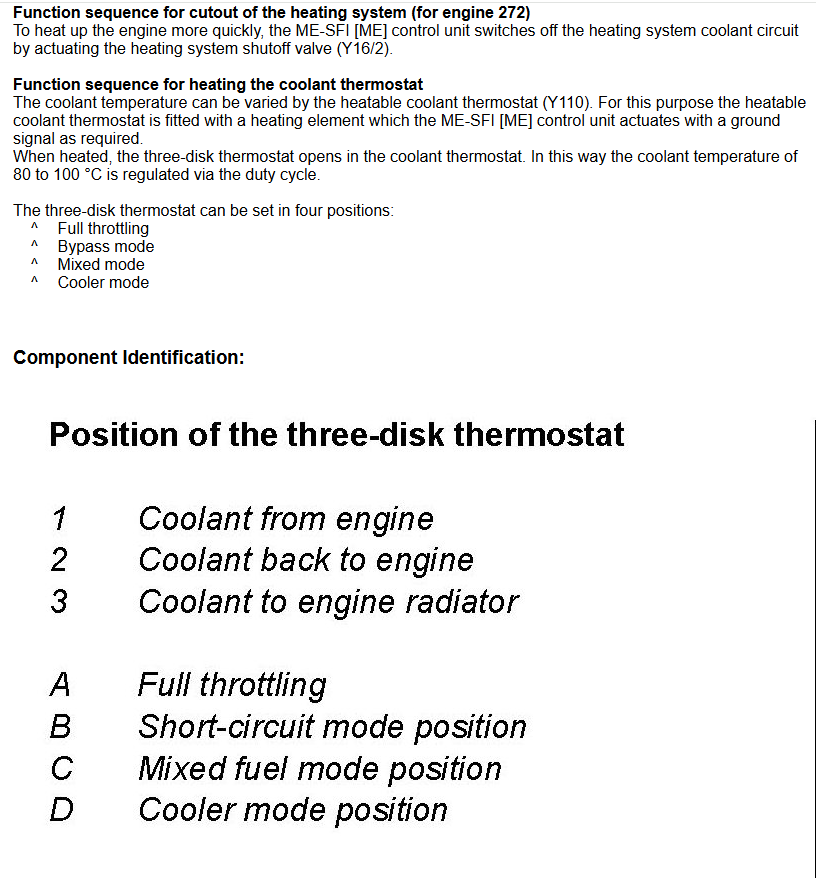

The thermostat operates in 4 positions, not just simply Opened-Closed.

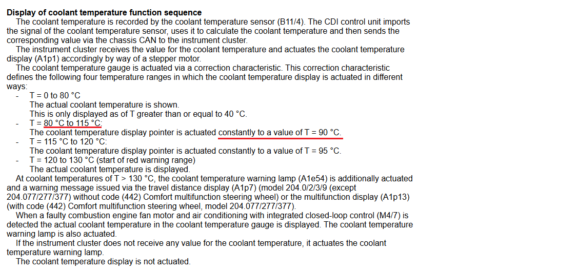

During normal operation the temp gauge on the dash will show a corrected, stable temperature. It will not show the actual coolant temperature read from the coolant temp sensor (B11/4). According to the manual for the M272 engine if the coolant temperature is 80 C- 115 C then the temperature gauge will show 90 C. But then you ask why am I seeing the temp gauge climb up to 100 C before it falls back down to 90 C, my guess is that there is some lag from when the instrument cluster makes the correction. I havent been able to find another explanation.
You can see below how the temp is corrected:
How the M272 thermostat operates:
