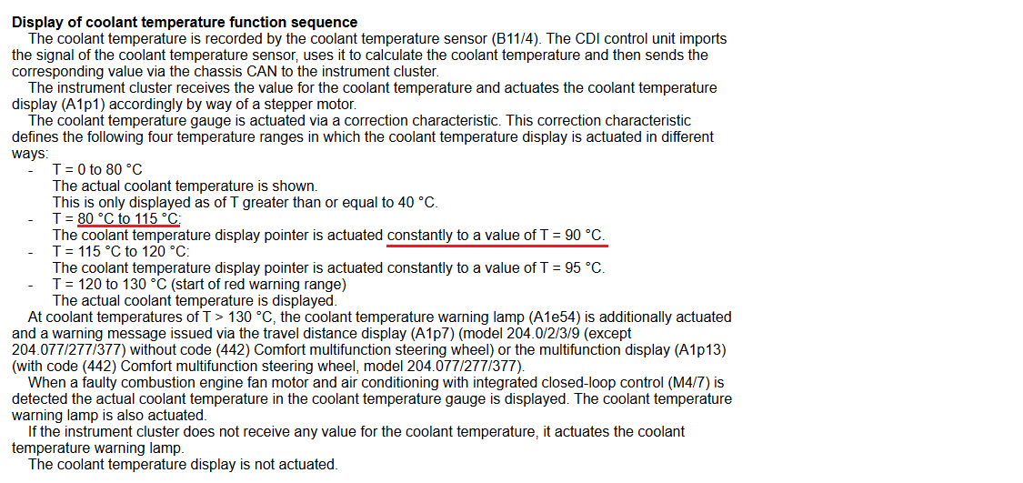

Info on what symbols on the dash mean can be found in the Operators Manual.
If coolant were low it would probably say low coolant. Seems the symbol above may be associated with coolant temperatures.
Document what the coolant temperature shows on the dash next time the warning pops up.
During normal operating temps 80-115 c the system is designed to show a consistent temp of 90 c.
My temp gauge always hangs out at 90 c. If I saw it higher, other than after a cold start and the engine was warming up, I would be concerned.
Below is from W204 but should be the same for w212.
