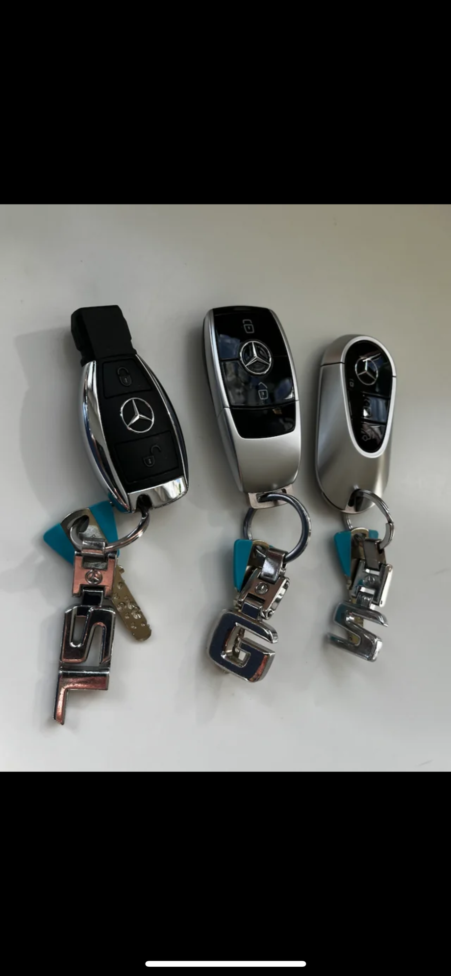

Having had two S213s with this merc key, I can confirm it is 100% the key design to blame.
I had neighbours on multiple occasions knock on my door to tell me my boot was open! Then when parked in my office driveway, the same thing except it opened into the wall, damaging the paint. It didn’t take long for me to correlate bending/crouching and the boot opening.
As I crouched, my trousers would tighten, pressing against the button long enough to trigger the boot to open. This was particularly bad with jeans. With the sloping design of the key, it puts the boot button at the arc allowing this to happen.
I would further confirm it is a design flaw by the fact Mercedes has already changed the key design. As many of you will know, merc had basically the same key design for years. They changed it to this one and have already changed it again. Pic attached of the keys mentioned.
