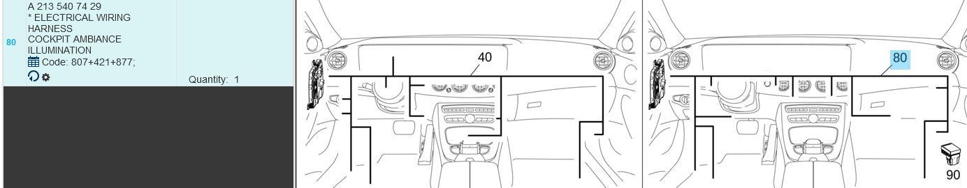

Dealer is referring to diode and recommending harness replacement. See if an independent can identify diode and replace.

As I understand it the chip dealer is referencing is diode (5) in post 57. If you are not covered by warranty what I’m suggesting find someone who can locate an aftermarket matching replacement diode and solder into existing cable. Dealer is recommending entire harness (80) replacement depicted in post 57 because MB does not offer diode separately. Independent shop should be able to accomplish replacement either in house or using their interior electronics vendor.

EDIT: I actually looked up the wiring harness and it costs only 32€? The local dealer told me the cable costs 200€!! I could easily just order the oem cable with diodes attached and just use one of that cable.
