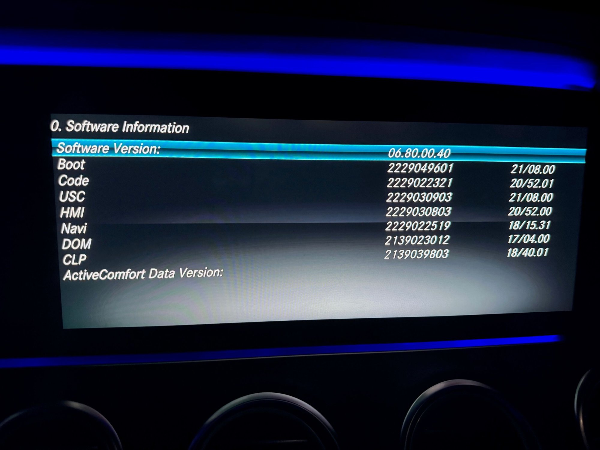

i just came from dealership, updated from version 1.7xxx.
Latest version is still 6.8xx
interesting thing is, that some of us have different versions of DOM and other stuff.
After update, I had some bug with ambient light not comming on after startup, but I managed to solve it by switching it on/off/multizone multiple times.
So there are definitelly some bugs. I am almost 100% sure, that there was absolutelly no change done to Android auto. Also, android auto has sometimes bug that after first connection upon starting the car, sound is desynced and delayed (video is fine). This can be solved by unplugging and replugging it again. After that, works fast without problems.

Just updated my 2017 E300 today. Seems like 06.80 is going to be the last update so far.
Ya for now at least, haven't heard of any update since 2022
