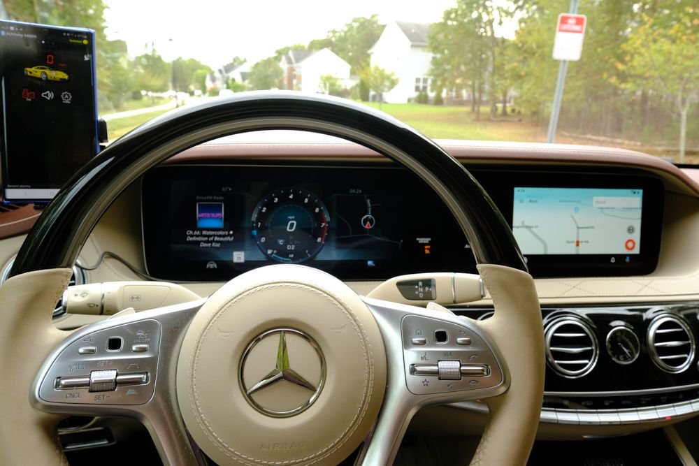

Benz does this with many feature upgrades by model year. I have a 2018 S560 which is hardware identical to the 2019's. Yet, only the 2019's get the "new" Mercedes Me Connect app which can include map updates via wifi, car data, new POI downloads, etc. They don't even allow for an upgrade purchase of the software. It's all to protect the upgrade path to each new model year, but is a bit short-sighted IMO - at least a paid upgrade to new compatible features would make sense and provide more profit, making both customer and company happy.

This is an issue on Mercedes side. They are hardcoding the AA logo and only presenting a smaller viewport (i.e. the video window layer) to AA running on the phone.
AA just sends a video output from the phone and the head unit decides how/where to render this. Unless MB fixes their software to allow advertising the full screen area to AA on the phone, this will not be fixed.
For CarPlay, MB did this already and that's the only reason it works there.

It is indeed unbelievable that the Widescreen possibility is disabled by MB.
Are there people who have access to the Engineering mode? There are many Android Auto and Carplay settings available, and mght be the Widescreen option there. Pity that even my dealer can (or will?) not access this Engineering mode (not to be confused with the Dealer menu, that easily can be accessed). Here a video of this engineering mode:
Could people with Xentry or other systems be able to do this?

Somewhere on this forum I posted an engineering mode menu image. I don't recall ever seeing a hi-res AA menu item on NTG 5.5. Keep in mind that the menus are different for each NTG version.
W213 = NTG 5.5
W212 = NTG 4.5 or NTG 5.1 depending on model year

I'm a software developer myself who has worked on AOSP (Android Open Source Platform) stack in the past with audio/video playback and rendering. Android Auto merely renders a video output from the phone with the touch events on the screen are relayed back to your phone. This keeps happening back and forth. The headunit advertises supported resolutions to the phone during the initial handshake, and both parties finally agree on the resolution. Where the video gets rendered on the display is up to the headunit. How MB has currently implemented AA is that they have a hardcoded AA logo on the left hand side (for LHD vehicles I believe) and the AA output on the right hand side. The video window/layer is called a viewport. MB needs to make changes to change the viewport resolution, its rendered position as well as remove the hardcoded AA logo to allow the phone to use the full screen resolution. Only HD resolutions (1280x720, 1920x1080, etc.) will cause AA on the phone to render the widescreen UI to the headunit.
For CarPlay however, headunit advertises the fullscreen resolution and hence you get widescreen resolution with the ability to utilize the full screen area.
Given how CarPlay is able to use the full screen area and both AA/CarPlay are phone driven with the headunit having to do basically nothing (other than passthrough audio/video/touch-events) this is not a huge change from MB side. If MB really wants to do it, they would. However, I feel MB will not bother updating the software and support the widescreen AA only with the future models (may be 2021??) since it's a relatively bigger change, need to spend QA cycles, may be even re-certify this software version for AA and all of this with less or no returns.
I am however not confident that this is possible using Engineering mode (unless they have some knobs in there to control all of these settings, very highly unlikely IMO).
