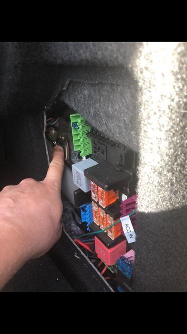

somebody sent me an email via the website, but i received it in the office and had no time to reply to it - and am home now, so no access...
will reply tomorrow, but to answer the question here as well: this is where i grounded the hardwire
@Maniek
