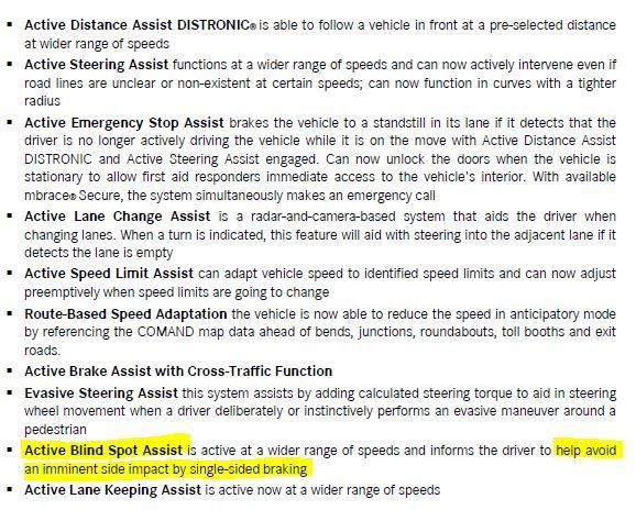

You are confusing Active Blind Spot Assist (illuminates indicator on side view mirrors) with Active Lane Keeping Assist (vibrates steering wheel, applies brakes).
It's definitely the Active Blind Spot Assist, as the blind spot graphic shows up on the screen when it happens (except it shows a car on the right):
In all of these scenarios, I'm fully within the lane. Active Lane Keep Assist is when the steering wheel vibrates when I cross into another lane without signaling.

I don't get that graphic on my '18 E300 US model with progressive instrument cluster setting. All Active Blind Spot Assist does is illuminate the red triangle in the side mirror and sound a chime. I'll try a different setting to see if I can get a vehicle image in the cluster.

Sounds like your system is malfunctioning. Active Blind Spot Assist does indeed do single-sided braking to help bring you safely back into your lane if a car is detected in the blind spot, but it's only supposed to do it if you begin to turn and not if cars are just passing by you and you are minding your business. The single-sided braking is the difference between Active Blind Spot Assist and just Blind Spot Assist. The Active Blind Spot Assist is part of the Driver Assistance package. I'm assuming cars w/o the Driver Assistance package just have basic Blind Spot Assist that doesn't actively intervene. I have the active system in my '19 C63S, which has the latest system and it never does this. I have gotten the visual and aural warnings, but since I always heed them, the car doesn't actually have to intervene.
