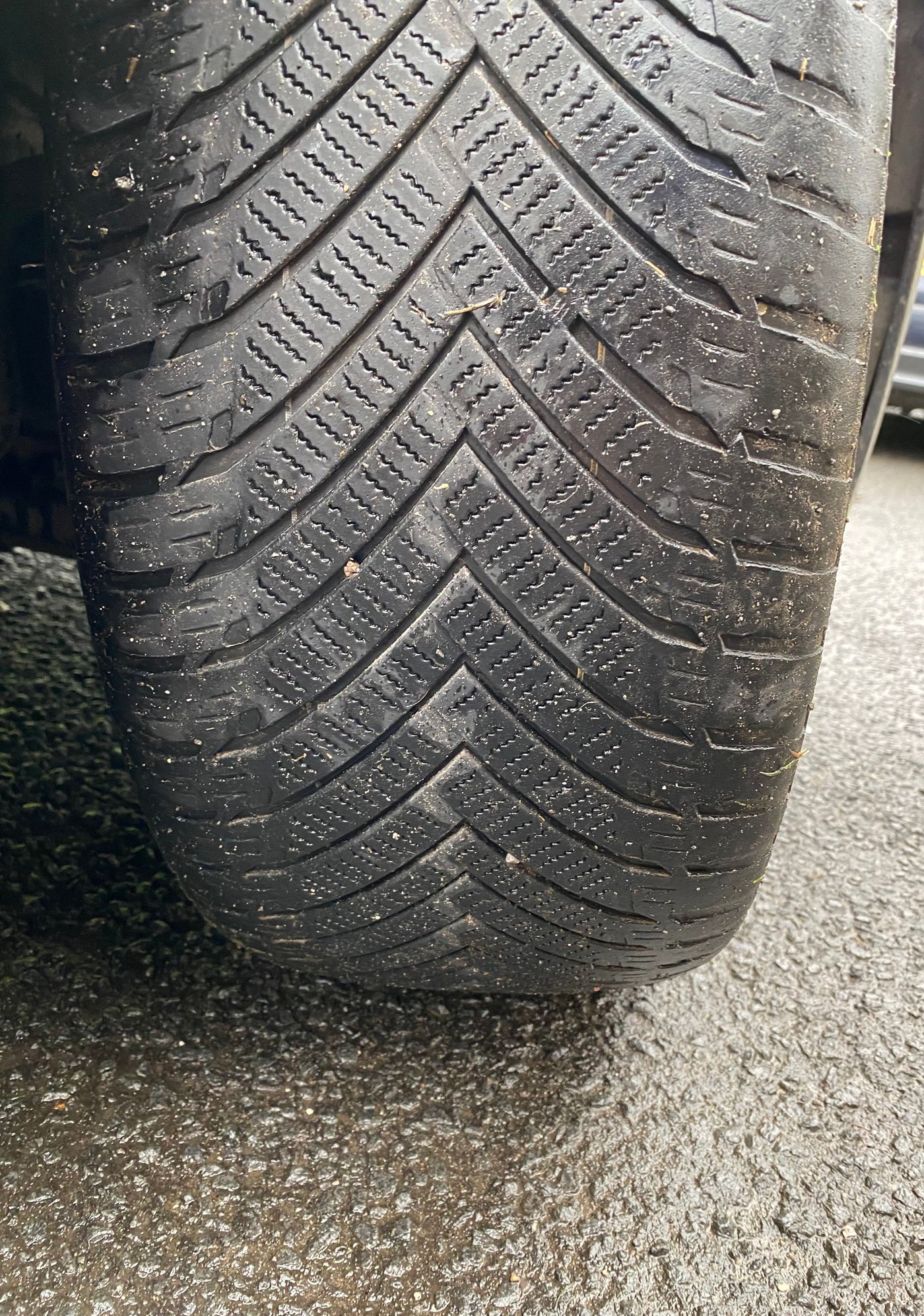

I have attached some photos but because its wet it docent show it as bad. The first photo is a old tyre it still has some tread left in centre but the edges are wearing the second photo is a new tyre I put on(because the previous one was worn to the cord) if you look at the edge you can see some of the imprint tread has gone.

Looking at the pics. Seems it’s too low pressure
The wear is inside edge only. That's not low pressure. It's alignment. My previous MB was going through tires that way and they stated the alignment was within spec. But the camber was at the upper end of the range. I had them realign it using the lower end of the camber spec and the problem was fixed. And there was no difference in handling. (It was an AMG so handling was important.)

I see wear on both sides...

I also see wear on both edges, which is typical wear for underinflated tires. What tires are these anyway? I've never seen the tread pattern and clearly the two pictures above are two different tires, with completely different tread pattern. I'm guessing these are not the OEM tires. Do they have the same load index as the OEM tires? The fuel door recommended pressures are good for the OEM tires and tires that are close to OEM, but if you go with a completely different tire you may need different tire pressures.

They are imperial, They are all seasons they are different because I had to put a new tire on one of them because it was down to the wire. The load index is 98 y xl
I had them at 225 kpa and that what it says in the fuel door. I will be changing the tires to the same ones next so they will both be brand new I will add more pressure and see if it is any better and if not it is sounding like the camber

Never heard of Imperial. Had to google them. Looks like a cheap budget tire. Up to you, but tires is the wrong place to save a few bucks. It's the only thing between the car and the road and is what keeps you on it. Are these 19"? 98Y XL would be suitable for 245/40R19 as far as I can see. Also, are these Run Flat? The OEM tires are RF as far as I know. RF tires are stiffer and MB may have recommended slightly lower pressures for added comfort. If you go non-RF, those pressure may be too low.
